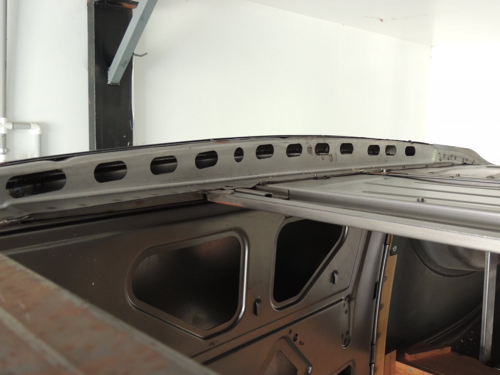

    Anyone know of a good tool or a way to get paint into those hidden areas where you just want some covering but not worried about appearance? I was thinking of some type of flexible hose with a spray tip that shoots radially .

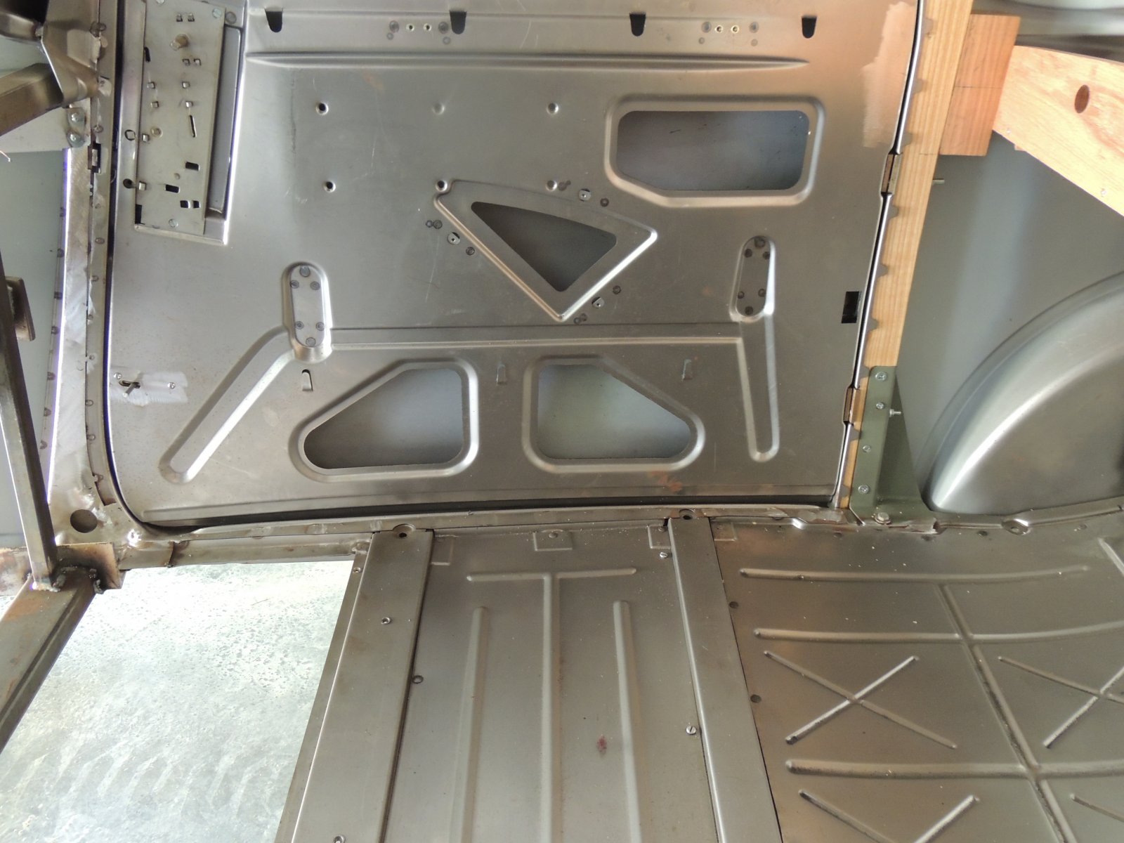

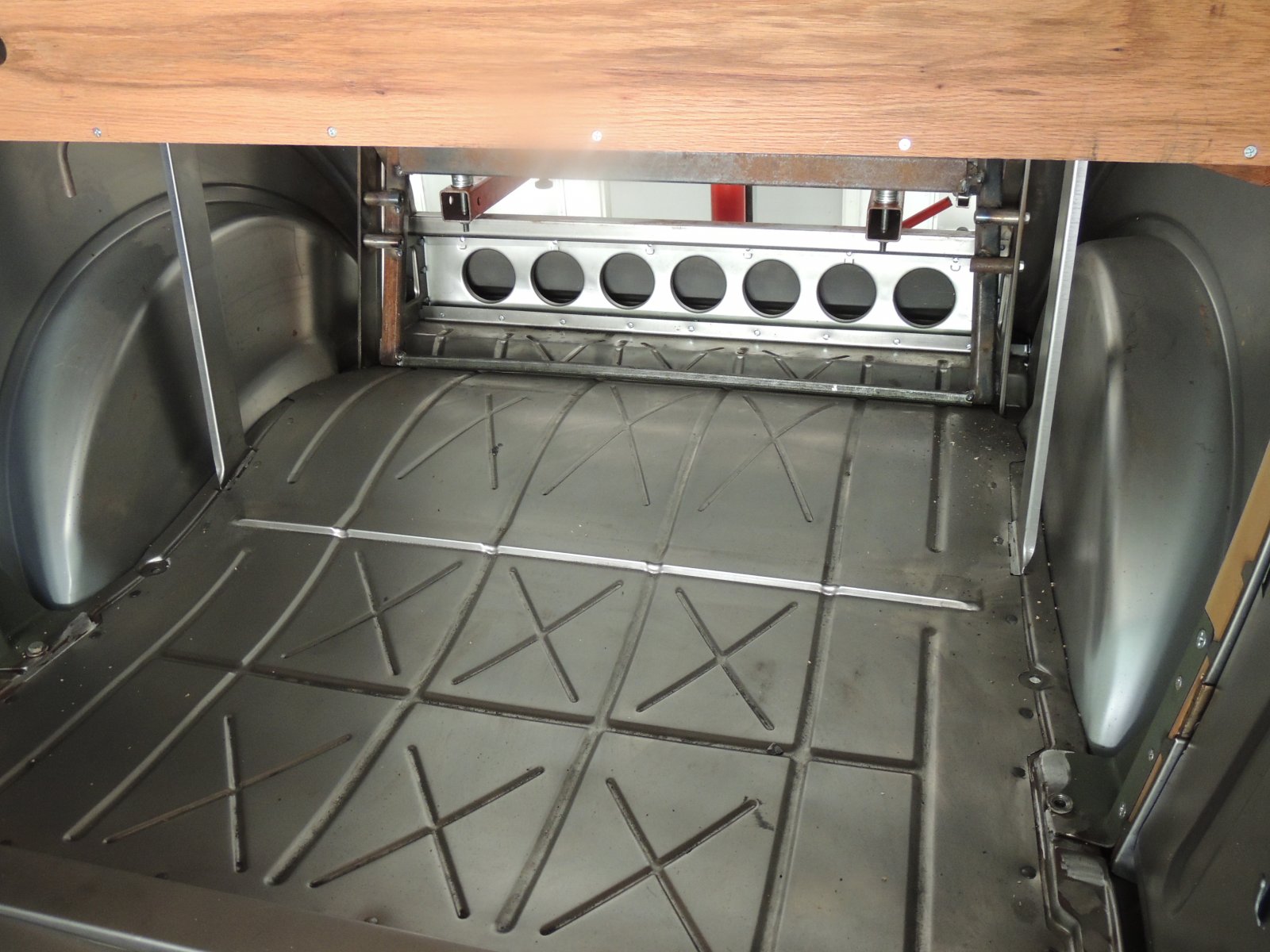

    I have a few of those I bought a while back, but they won't get inside like I want. Here are some pictures. DSCN5932.JPG

    Here are some pictures and explanation of what seems to work pretty well for getting paint into those hard to reach places. Won't be any show quality, just gettin paint into and onto those inner panels that will immediately begin to rust if not coated with something. Even inside a boxed frame. My pictures above show some of the places I was trying to get some paint on. I ended up using an undercoating gun with a flexible hose and a nozzle in the end of the hose. At first a lot of sputtering or nothing. Tried thining the paint which makes it run into crevices more easily.....and also out of the crevices and onto flat panels. Be prepared to wipe the run off up with some cheap lacquer thinner........but paint does get into a lot of unreachable places. I had to drill the nozzle holes larger even though I thinned the paint. I found that holes in the nozzle of appx .110 diameter seemed to work well with a viscosity cup time of about 17 seconds. So if you try this, those two things should get you flowing.........
