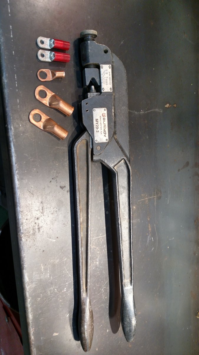

  13. chevy57dude
    Joined: Dec 10, 2007
    Posts: 9,913
    chevy57dude
    Super comprehensive description, Steve.
    This is the adjustable Burndy crimper I use on cable up to 250Kcm cu. great for welding cable and battery terminals. 1540891069590-1636895673.jpg
