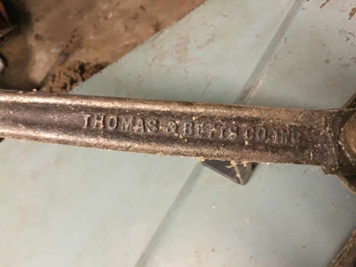

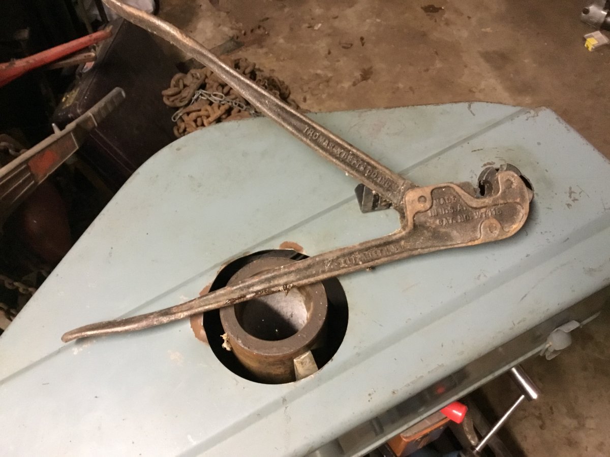

    16807918-5CAC-4E13-8E90-7B9B80D342C3.jpeg 74423A44-AA30-49BD-8820-59A09A40F1D8.jpeg Thanks Steve, that’s the way I have been crimping for years. It’s so simple, I thought I must be doing it wrong. I have the Klein 1006 crimping tool for small terminals and a Thomas and Betts for the larger battery cable type terminals. I know we disagree on soldering, but I recommend people follow your way.
    The picture is of my larger crimper, everyone know what the Klein’s look like.

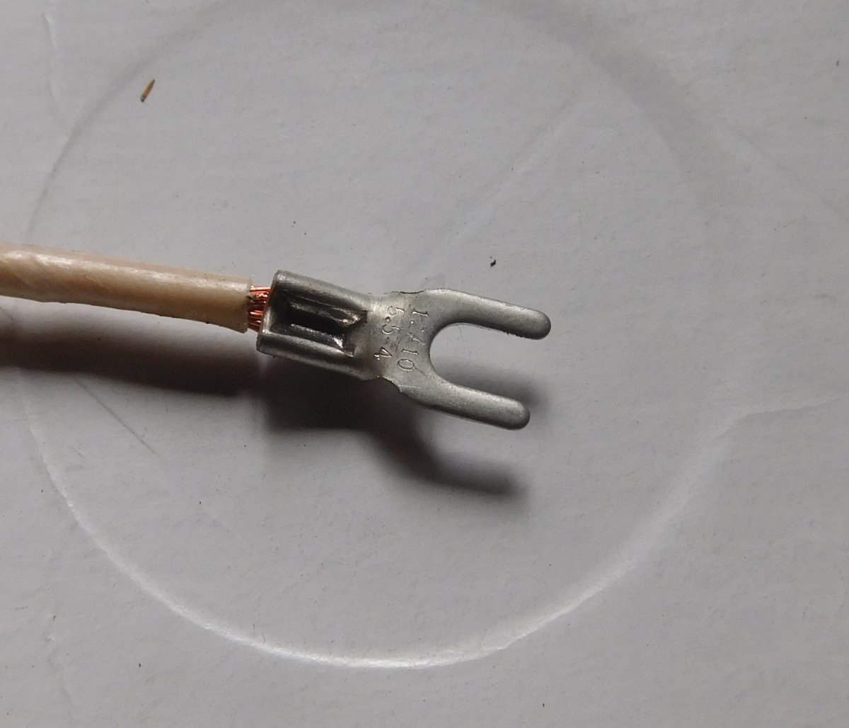

    I learned the technique from Mark over at MAD Electrical several years ago. I've wired a couple of cars this way and haven't had a problem...….yet. It's a little different from yours, Steve but it basically garners the same result. Are there any negatives with this approach?
    Excuse the funky pics, I copied it off Mark's handbook...…………….
    Most terminals have a slit down the middle (this one was opened up with an awl for some reason). Place the tip of the crimping tool adjacent to the slit...………….
    ……….and crimp that side.
    Next, fold the other side over the part you just crimped...…………….
    ………..and crimp that side. That should give you a good solid crimp. Wrap the terminal barrel and part of the wire with Scotch 88 electrical tape and finish with a length of Polyolefin heat shrink tubing. Steve, do you agree?
