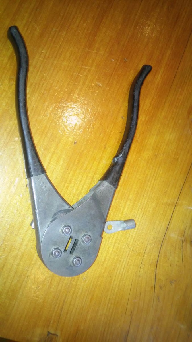

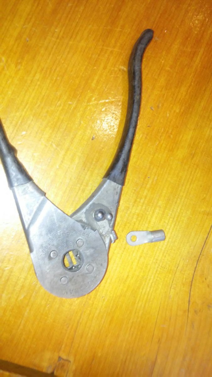

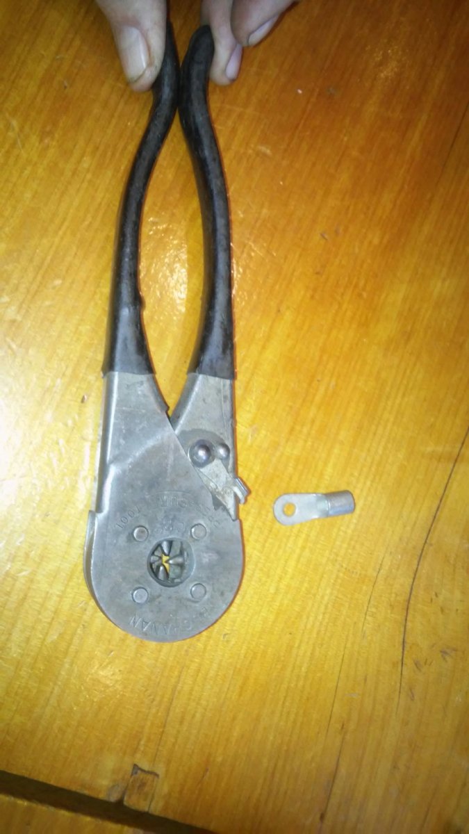

    Friend just got these at a garage sale for 2 bucks. When you squeeze the heads spiral in. Made by Buchanon. Offered to double his money, no soap.
    theHIGHLANDER, loudbang and TagMan like this.
  28. Haven't seen one of those in years...
    These aren't really what you want for 'standard' crimps. These were designed for a specific type of crimp (made by Buchanan, natch) that was a precursor to wire nuts for splicing multiple wires together, with a limited series of terminals available. Once wire nuts came on the market, these fell out of favor. You can still get the splice sleeves and terminals, as some manufacturers still use them for factory ***emblies. I've never seen them used for field connections other than old installs.
    http://www.idealindustries.ca/produ...rminals_crimps/crimp_connector_splice_cap.php
    http://www.idealindustries.ca/products/wire_termination/terminals_crimps/termend.php
    They only come in raw copper so aren't very corrosion-resistant, and the sleeve is pretty thin/soft (you can squash a splice sleeve with your fingers). I've got a handful of the splice sleeves floating around somewhere; their main advantage is you can mix wire sizes in a single connector, not something easily done with 'regular' crimps.
    VANDENPLAS and loudbang like this.

    The Buchanans are p***é in the field for the most part. They came in under the MS3191 spec around 1955 IRC. Which has been replaced by M22520 around 1970 and is still the standard today for military crimp tools. I have at work a cross-math between the Buchanans and today's Daniels crimp tools. Any 4-indent Buchanan I have seen has a positioner attached to it. Buchanan was eventually acquired by Astro, we have some of their tools at work and are able to keep the certifications up.
