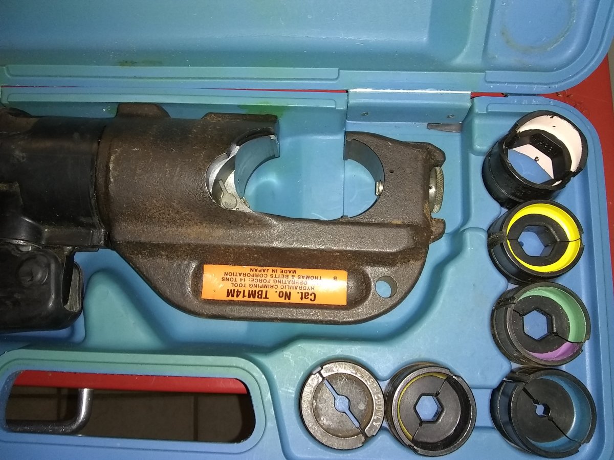

    I work in the electric utility business, and reliability to the customers has come down to correctly crimping terminals, and just as important are quality terminals. Brazed terminals are a must at work. Also, we use a inhibitor call "No-ox-ide special a"
    Awesome stuff. I warm it and it turns liquid, then dip lugs in it. Attached are some of our hand crimps. We only allow rachet style on 10 guage and smaller.
    Larger crimpers are good from #8 to #2 awg 20181212_121949.jpeg 20181212_122009.jpeg
    Sent from my LG-LS993 using The H.A.M.B. mobile app
    Truck64, loudbang and stanlow69 like this.
