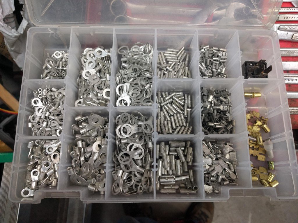

    Not Steve; but I looked at kits and most contained way too much of the wrong stuff. Ordered appropriate quan***ies of the terminals I usually use from Dell City and put them in a hardware store box. For the few odd terminals like bullets, etc needed; I pick up small packs of the insulated kind and strip the plastic off.
    Just have to keep up with reordering them as needed.

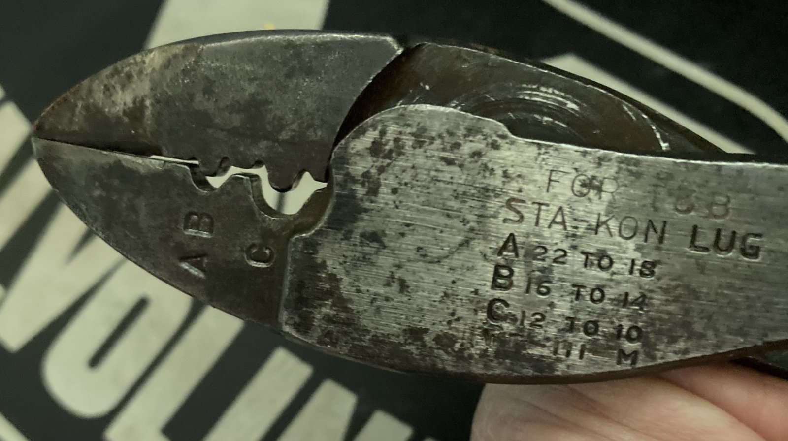

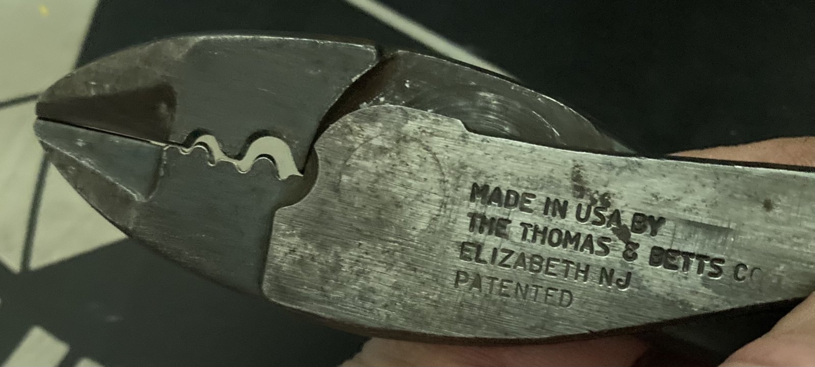

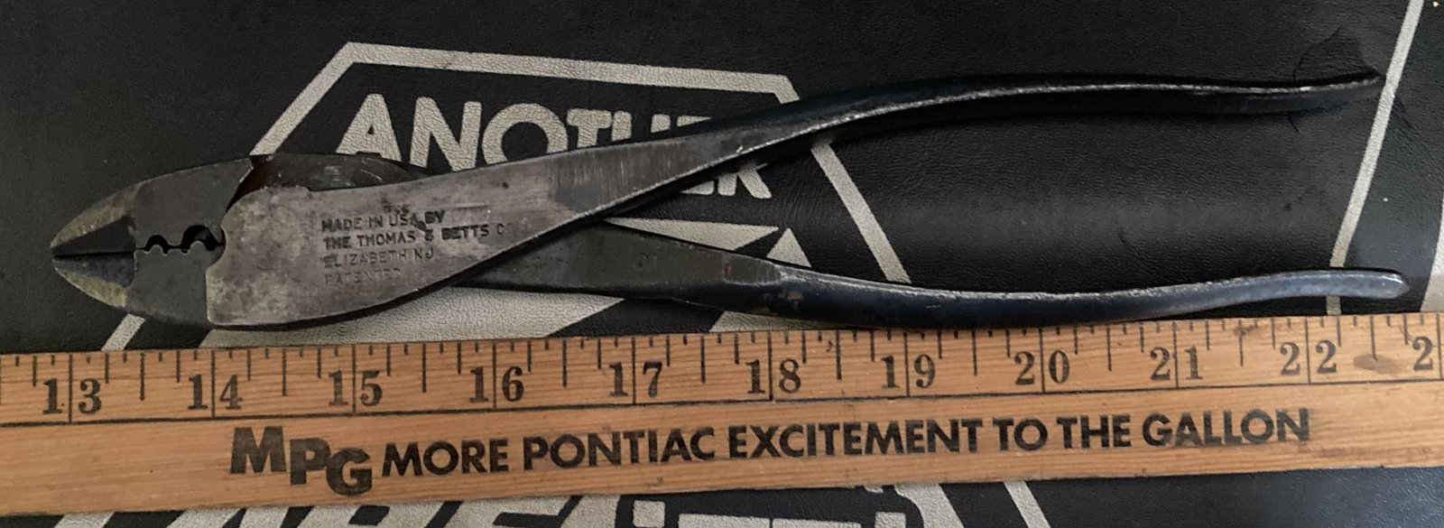

    I like T&B sta-kon crimpers. Remember no insulation on these. Heat shrink has its place …. Right here.
    OahuEli and Boneyard51 like this.

    I've used these for decades, not even close to showing wear. One of the best tools I ever bought.
    Boneyard51 and Cosmo49 like this.

    I just found aT&B sta-kon crimper on Marketplace for $15, swooped it up.:D

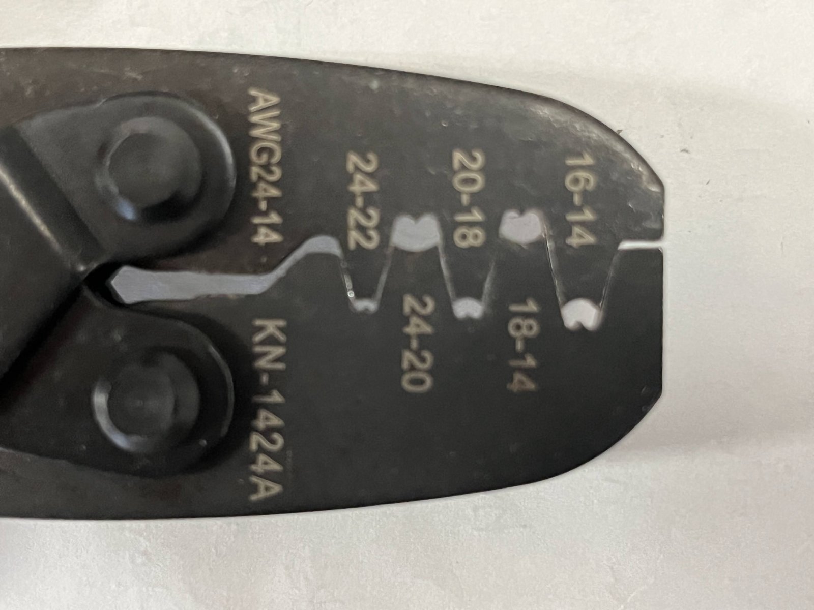

    For Delphi 56 terminals used by GM, these crimpers work pretty well at crimping the stripped wire and insulation at the same time. They are part of ToolAid #189020, which includes a total of 5 dies. I'm on my third AAW harness using this tool and some of its other dies.

    As always, be sure to do some test crimps! The dual crimps dies are slightly different in size, the insulation side of the die being slightly larger, if that makes sense. Therefore, it's important to get the terminal positioned properly, by "eyeballing" it from the end of the tool. Also, as the AAW video mentions, you will need to bend the terminal "flags" inwards a little before sticking them in the die.
    On another note, here's a cheap tool designed for Molex connectors, but I also use it on small Delphi-type terminals, and sometimes to put a "final touch" on terminals. Yes, lots of steps, and I'd find some other tools if I installed wiring harnesses for a living!

    Stay-kon tool for me too. Still using the one I carried at work for 40+ years.
