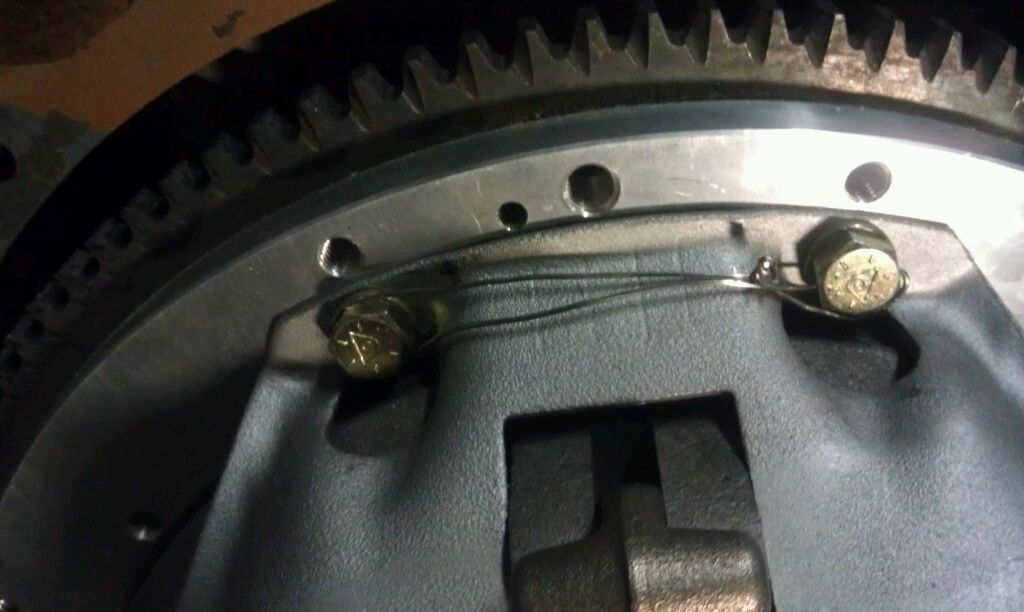

    I've never done this, but I think I undestand the concept. Before I wire the other two tangs on my pressure plate tell me what I'm doing right/wrong.

    Viewing the photos, the wiring is not to aircraft standards. Difficult to tell someone in words how to safety wire since there are so variables. Is there a general aviation airport nearby? If so, head over there and ask the guys in the maintenance shop if they can steer you in the right direction. They will show you some examples. It helps to bring fresh donuts!!

    Eric...I love ya man but that ****s. I will send you some info out of my handbooks on Monday if you want (send me your e-mail) or call me (pm for #). You can do much better than that with a little time.....

    Eric, your safety wiring is terrible. The wire needs to be twisted and wired so that one bolt cannot loosen without tightening the other. Thats the concept of safety wiring. Safety wiring is primarily used by aircraft mechanics. I've been involved with aircraft my whole life and know what I'm talking about. There's even a pliers for safety wiring that twists the wire and has a cutting edge. Flatheadguy's advice is right on. Don't feel bad, you've never been trained to be an aircraft mechanic.

    Google safety wire techniques. Buy a can of stainless wire. Many uses around the shop. Use safety gl***es and pick up s****s immediately. The pliers are nice but if you don't do it every day it's not nessary.

    Man I'm sure glad I asked! Okay, this **** is coming off until either I learn to do it right or have someone skilled do it for me.
    Thanks for the critique. You guys should know by now I'm pretty thick skinned, and I REALLY DO appreciate you telling me it ****s! I'd rather be safe than sorry!

    The real key to safety wiring is to make sure you pull and twist the wire in a direction that will tighten the screw or nut. Safety wire alone won't do the job if it is done incorrectly. That is a great video.

    would never p*** aircraft inspection, or race tech. you need to spin the wire taunt between the two with a wire spinning tool. With the suggestions above you will get it

    A full half of each safety wire installation is figuring out how you're going to make it happen. In the example above, I would start on the bolt on the right, with the wire through the hole, and the open end wrapped underneath the bolt. Then twist the wire down to the bolt head, left over right and keeping the loop tight against the points of the bolt head. Once the wire is twisted, wrap the twisted wire over the top of the bolt on the right, then compare the twisted wire to the bolt on the left's opening at the 4 o'clock position. If the wire requires more twisting, give it more. If the wire is already twisted past the hole opening, cut it off and start again. You may have no more than 1/8" of untwisted wire before the opening of the hole. Then p*** the wire through the bolt on the left, wrap the open end of the wire to the left side of the bolt, and twist the wire tight around the bolt head on the left, again keeping the wire tight against the flats. When the twist is tight and complete, there should be no more deflection than the twisted wire diameter when finger pressure is applied. Cut off the free end of the twist, and give it a pigtail (a 1/2 fold with a 1/2 twist) to keep it from becoming a puncture hazard.
    Rules of thumb - .020" safety wire gets 12-14 twists per inch; larger wire gets 6-8. Use the largest wire that will fit the hole. And exercise caution when safetywiring - the diagonal cuts on the wire make it an easy puncture hazard.
    Some folks swear by safety wire pliers; with practice they are helpful but not necessary. The same results can be achieved with standard pliers and diagonal cutters.
