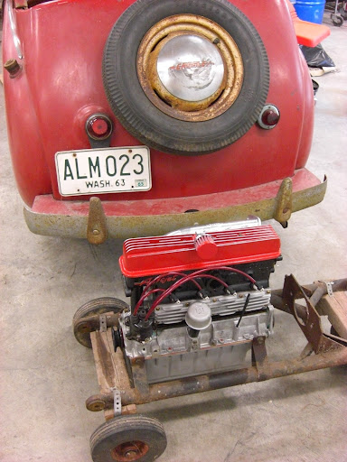

  22. Deuce Chev
    Joined: Jul 31, 2008
    Posts: 191
    Deuce Chev
    from Pacific NW
    Yes. Nick's son Blaz Brajevich will make you one if you want one...
  23. Deuce Chev
    Posts: 191
    Deuce Chev
    from Pacific NW
    Here's a few shots of the car the engine is going in.....
    kiwijeff likes this.
