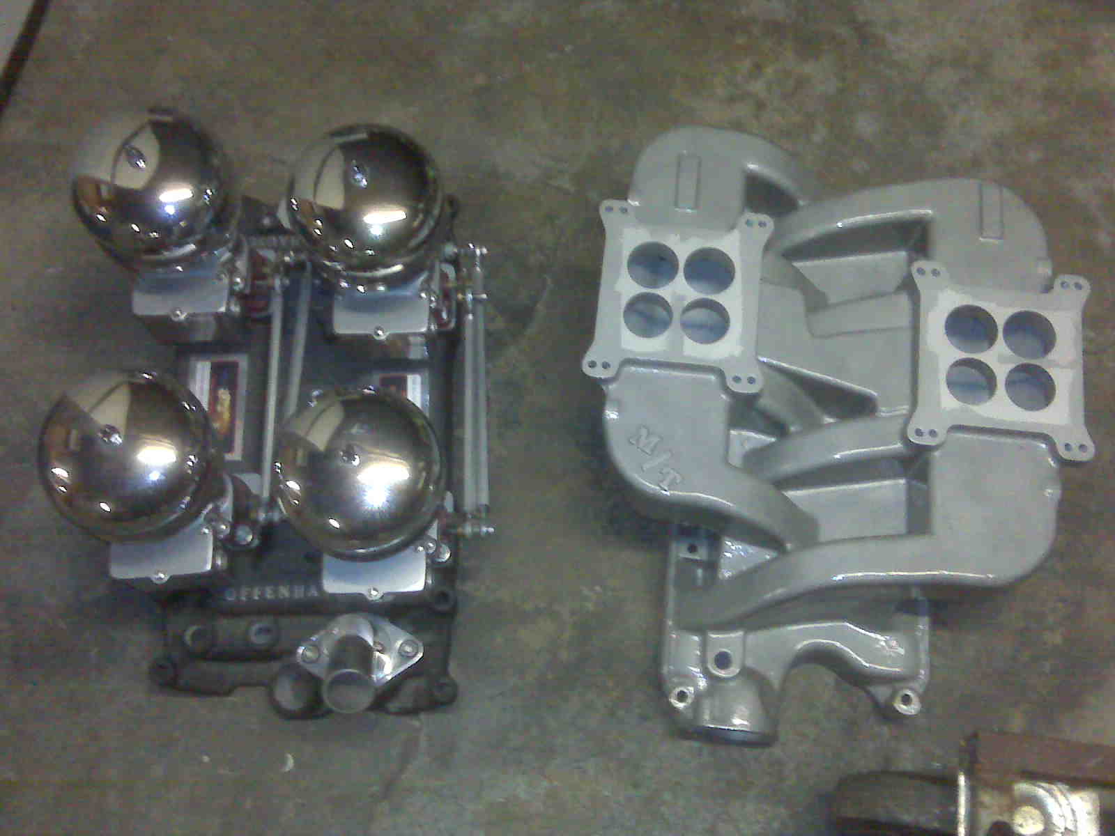

    Hey T-Roy.. That does look like the M/T version. Can't tell but it looks like it has the center joining plenum between the carbs and I think M/T was the only one that had that..but don't hold me to it. Nice piece indeed!

    wow thats an awesome piece ! any more info , who's setup is it ? very nice

    Thanks! I think is the single coolest piece I've ever owned. Actually, this and the vertex mag that's sitting in the background. :)
    It does have the joining plenum between the carbs. Just odd it doesn't have any markings on it. And the "rough" casting is consistent. Doesn't look like anything has been removed, ie: milled off.
    ...I just looked at the pic again and the picture kinda looks like something may have been removed off the intake in front of the forward carburetor. Just enough room for M/T I suppose. :confused: Whatever make it may be, I like it! :D

    I believe M/T is the only one that made a staggered one piece sbc crossram. It looks petty old and dirty. Try cleaning it and seeing if you can find any signs of it being polished once upon a time. The crossram on my Henry J is a weiand, but I was only able to identify it as that off of very subtle clues because it was polished and the name was ground off.

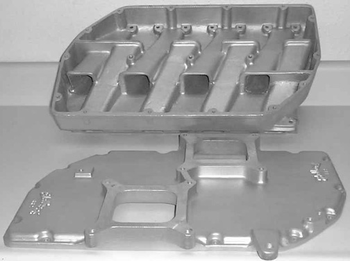

  22. smittysspeed29

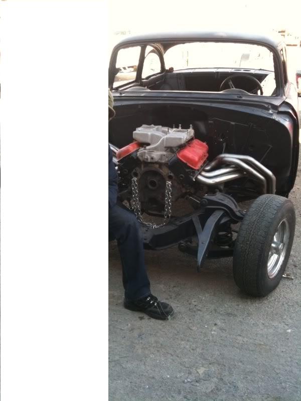

    I'm FINALLY getting my motor togather, 350 block, 283 crank, 140 cam, offy crossram, 450 holley's with Big accelerator pumps, and Spaulding flamethrower. I'm gunna try going a little crazy with tuning, by putting some o2 bungs in my exhaust and trying to dial the va***n in with every port possable
    Any advice??
    Also it's going in a '64 el camino, backed by a m20 and somewhere around 4.11's to 3.73
