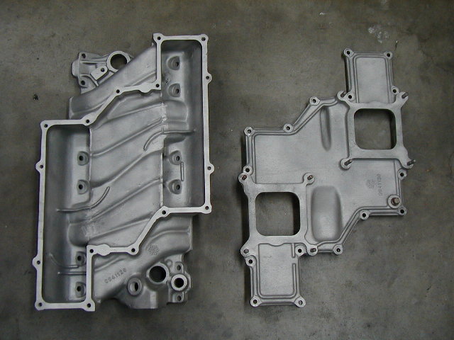

    This is a Camaro crossfire intake, (not like the one pictured in the previous post.) Yes, a regular 4 barrel intake will work on that 305.

    Your half right... The intake pictures I posted were made for Camaros also.... The pic you posted looks like a plumber's nightmare... :eek:
