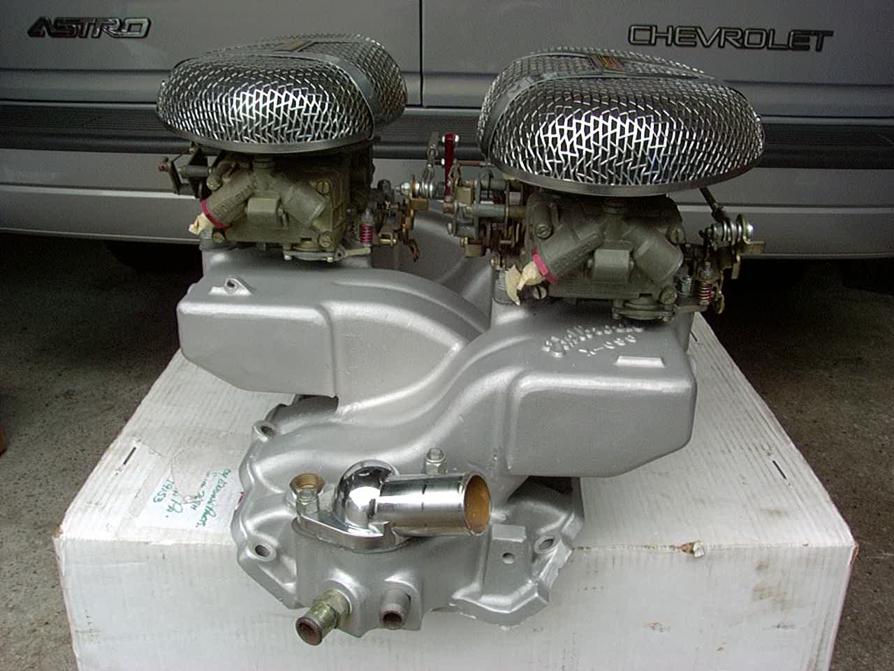

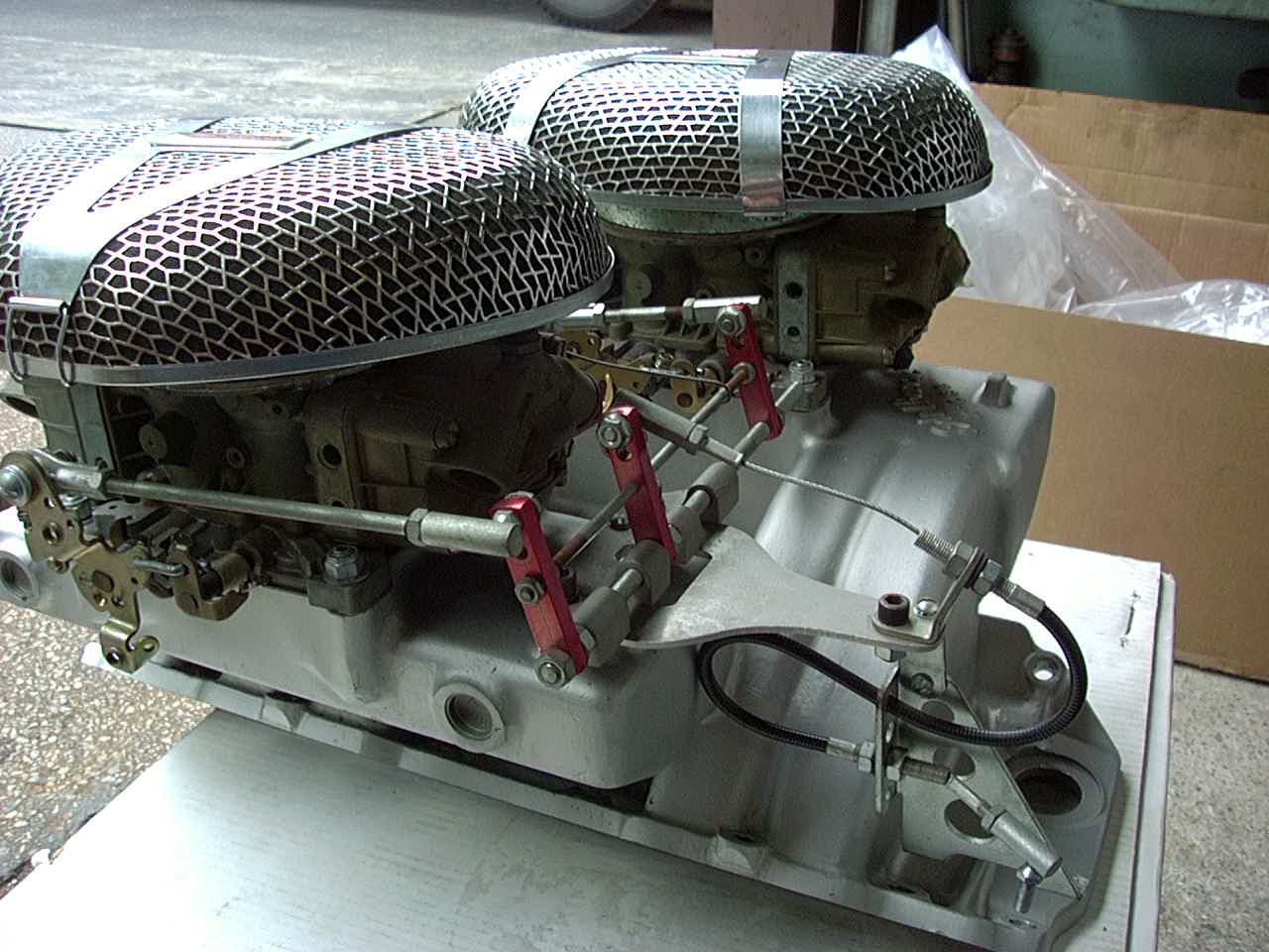

  8. GOSFAST
    Joined: Jul 4, 2006
    Posts: 254
    GOSFAST
    Ran the same setup, same heads, but with different gears, a roller cam and T-400! Same C.R.
    Chevelle, '66, total "streeter", NY registered and inspected.
    Never had a single issue with the cross-ram, only item I didn't care for was the fact you can't fit the "tall" style valve covers. Not enough room between the manifold sides, used "short" covers.
    I worked with some aftermarket linkage and a made a few of my own mods to "connect" the linkage and avoid "slipping" on the shafts (visible in the shots below).
    Thanks, Gary in N.Y.
    P.S. Here's 2 shots of the setup, I still have it here but the ride's long gone! That's a pair of 650 Holley double-pumpers! Simple to tune also!

  10. blacksheep55
    Joined: Jan 26, 2011
    Posts: 84
    blacksheep55
    from jasper ga
    Like that linkage pic GOFAST. That was another issue I was going to have to figure out. Thanks for the info so far guys.
