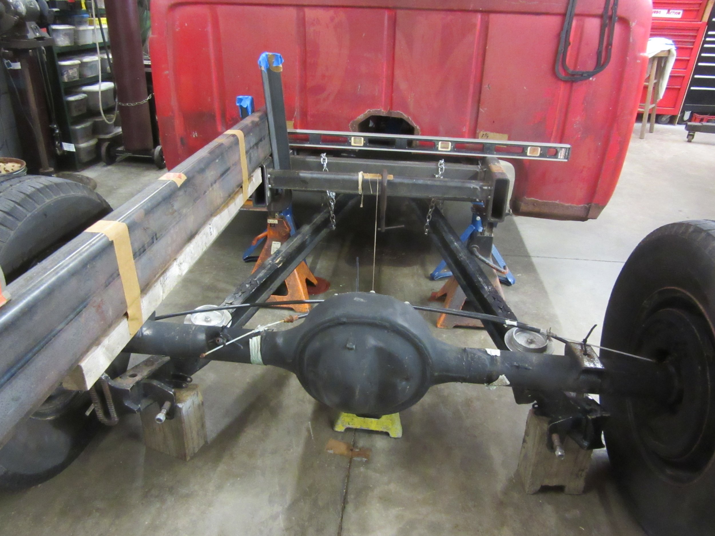

    IMG_1876.JPG We will be ridin next week ! well maybe not. I have got things laid out to see what has to happen next ? The 9in may work offset wise ? I just haven't gotten there yet. I think I want a piece of 2 x 4 for the frame rail instead of the 2 x 6 , time will tell. IMG_1875.JPG IMG_1879.JPG
  24. TA DAD
    Joined: Mar 2, 2014
    Posts: 1,625
    TA DAD
    from NC
    So I have the axle housing centered in the frame and a too short driveshaft slid in the trans and eyeballing it it looks to be about a inch and a half to far to the right ? not a Ford guy so I have some looking to do and see how they offset some other housings. IMG_1882.JPG

  25. Axle offset is real common. As far as I know, that was done for steering apparatus clearance. It's common to shorten the housing and use a different axle on the modified side.

    I have access to more housings both Cup Car full floaters and stockers. The budget plan is to find one to fit as is. Time will tell what I find. The hard part is getting the stuff where you can get to it to get good measurements as I sure can't pick them up any more. Fat man fabricators had a huge pile of them in his auction a couple weeks back. They probably all went to the crusher.

    Pinion does not need to be centered.

    That would be correct, but it needs to be centered to the output shaft of the trans. That is what we are after here. On the cheap, without cutting or buying a new housing , but there may not be a stock 9 inch with the right configuration .
    The floaters which are Cup Car pieces are pinion centered .

    It does not have to be centered to the transmission.There are many Ford and probably others that came from the factory like that.
