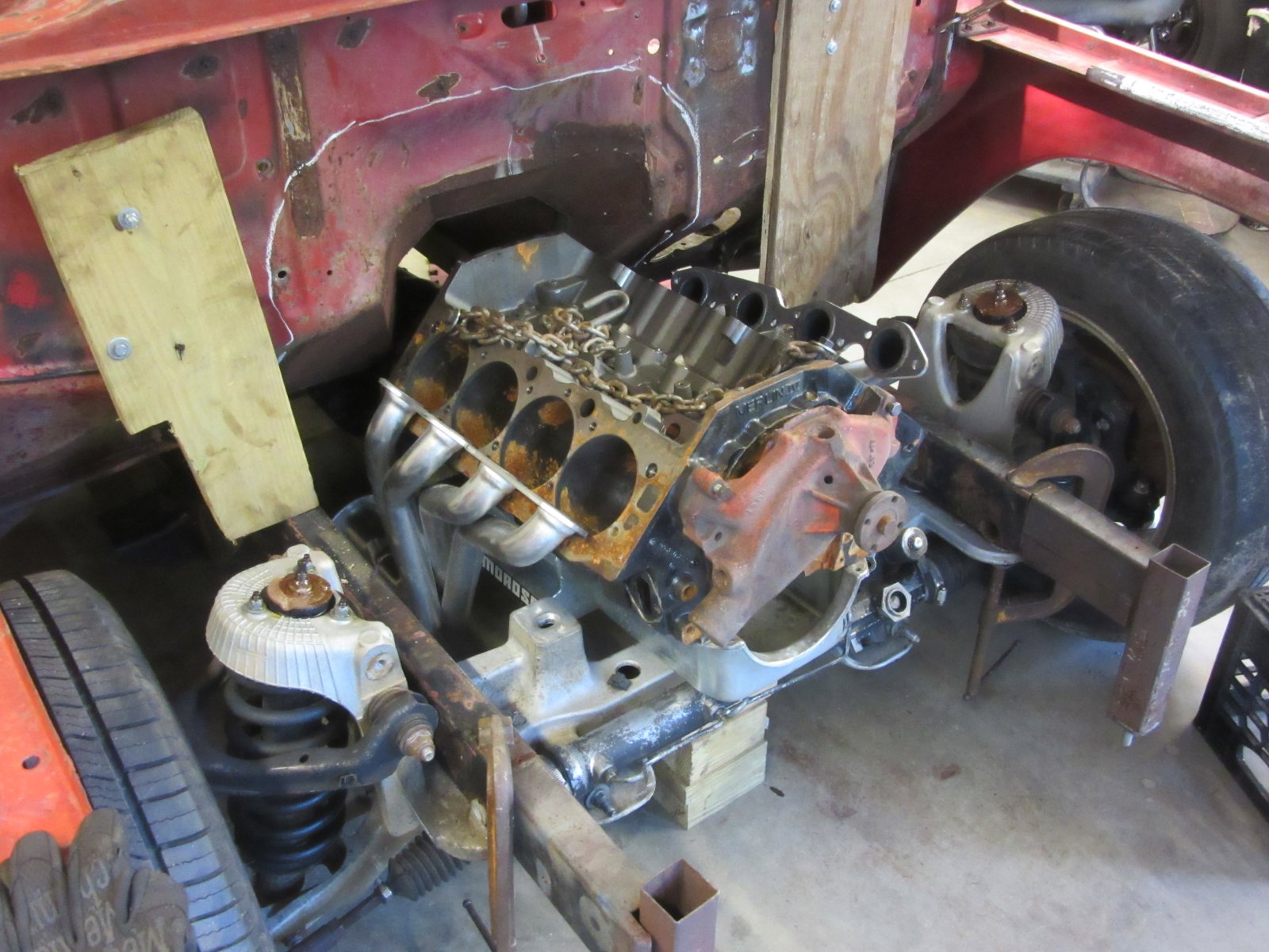

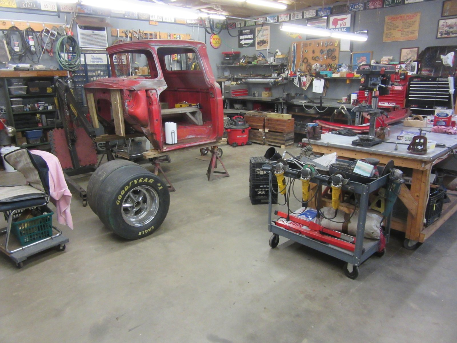

    Slowly getting things done, next is to drag this old frame out of the shop. IMG_1456.JPG

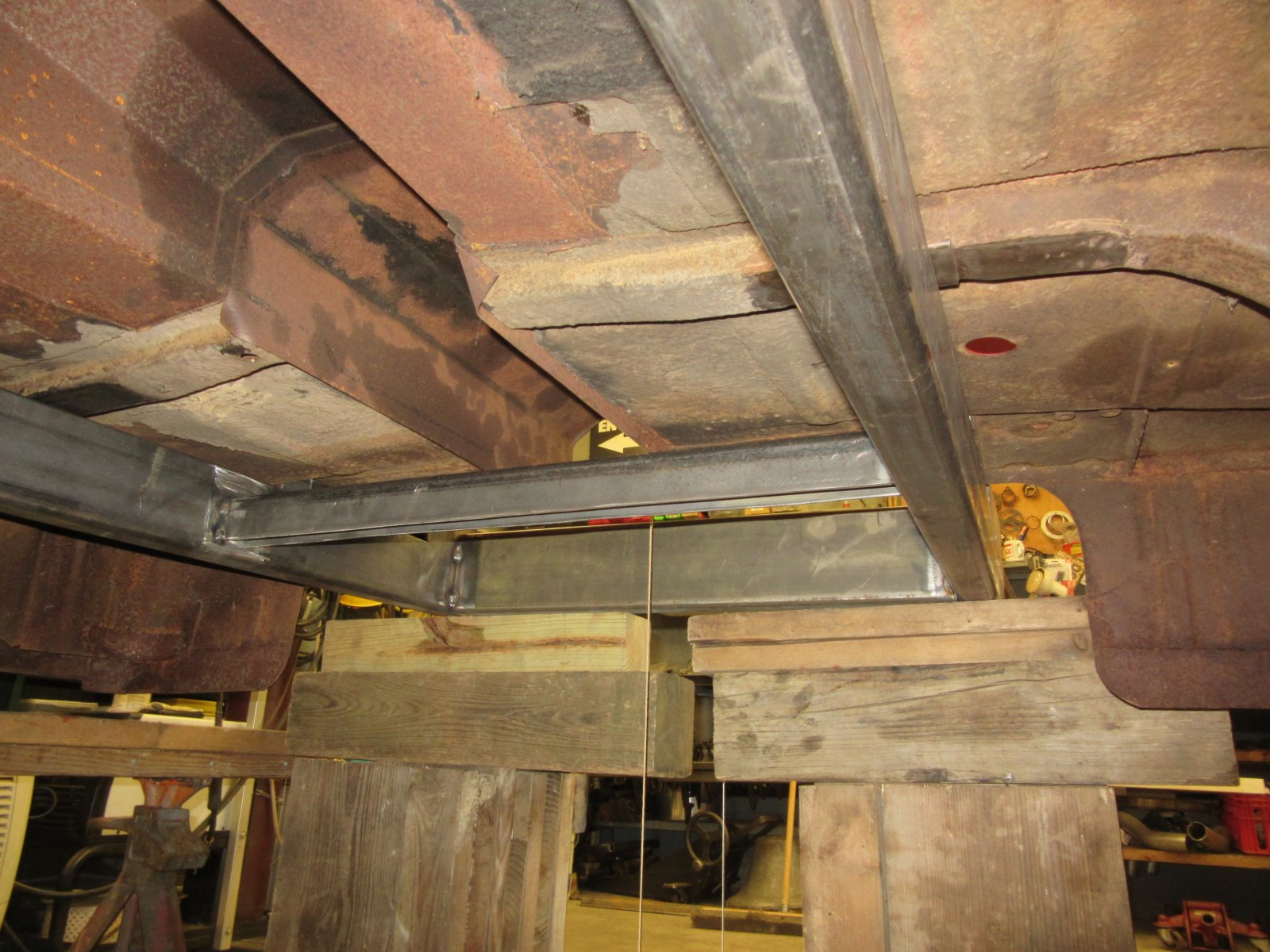

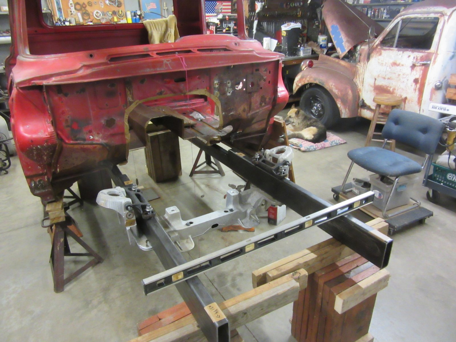

    IMG_1502.JPG I have the Crown Vic crossmember installed along with 3 temporary ones. The cab is sitting square on the rails within a 1/8 of an inch. The frame is within 1/16. So far so good. Now for some cab mounts. IMG_1508.JPG IMG_1507.JPG

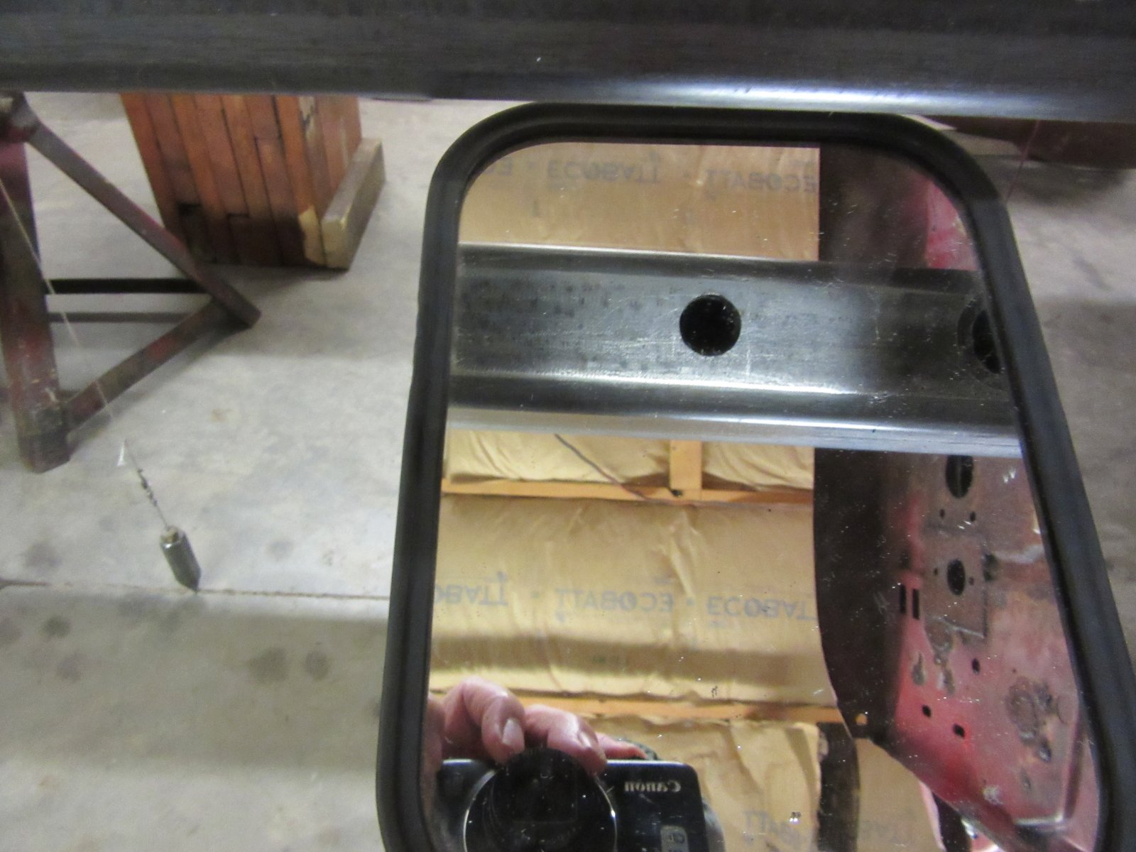

    Drilled the holes for the locating dowels in the bottom of the frame rails and added a couple gussets in the front corners. IMG_1516.JPG IMG_1512.JPG IMG_1513.JPG

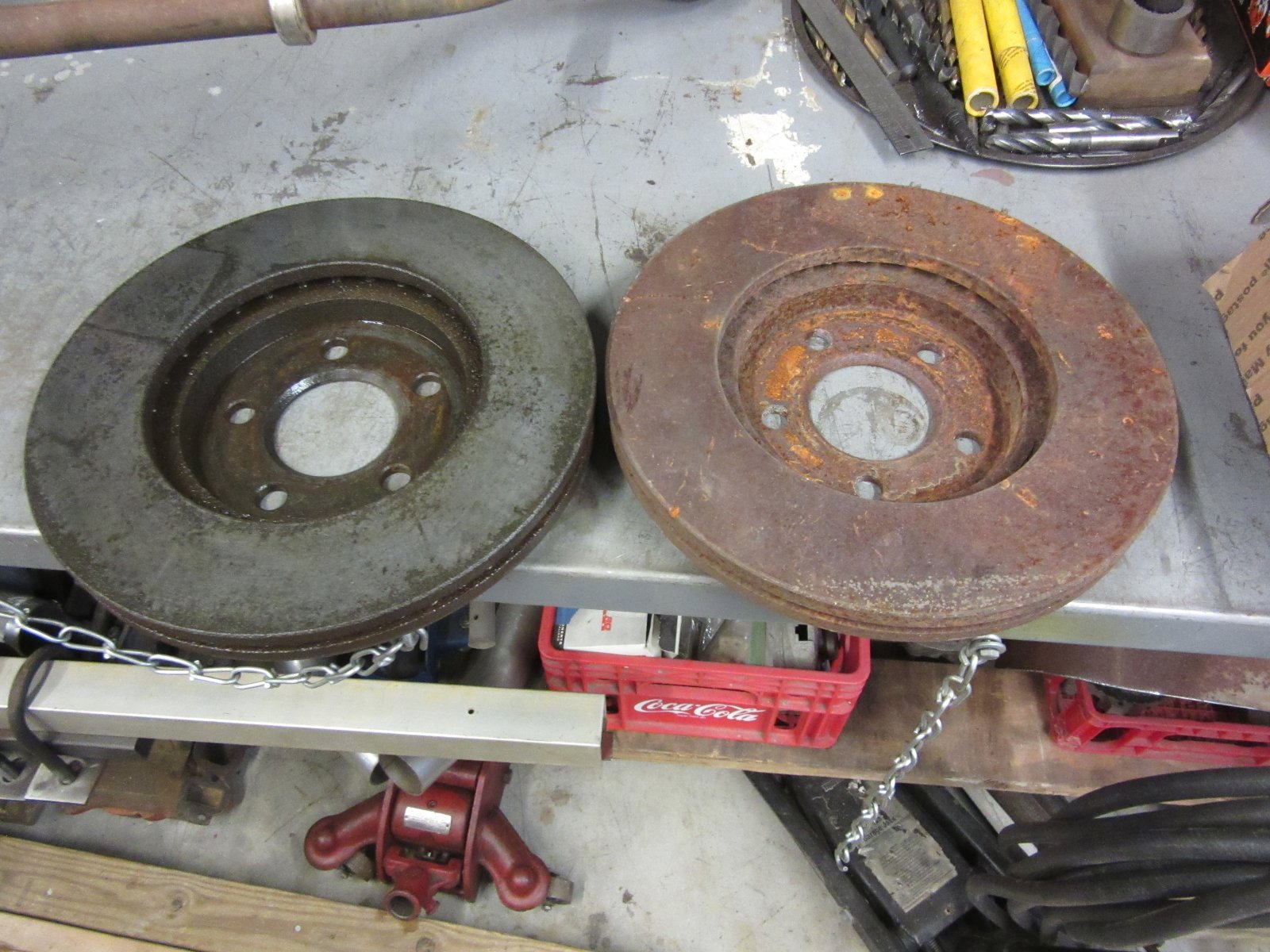

    I have been knocking all the sharp edges and casting flash off of the crossmember and then sandblasted it. On a side note the front rotors where super rusty from being out in the weather for ever. So I put 16 oz of vinegar along with 32 oz of water in a pan and after 24 hrs and a couple scrubs with a wire brush I believe we can get some use from them. IMG_1519.JPG IMG_1518.JPG IMG_1520.JPG
