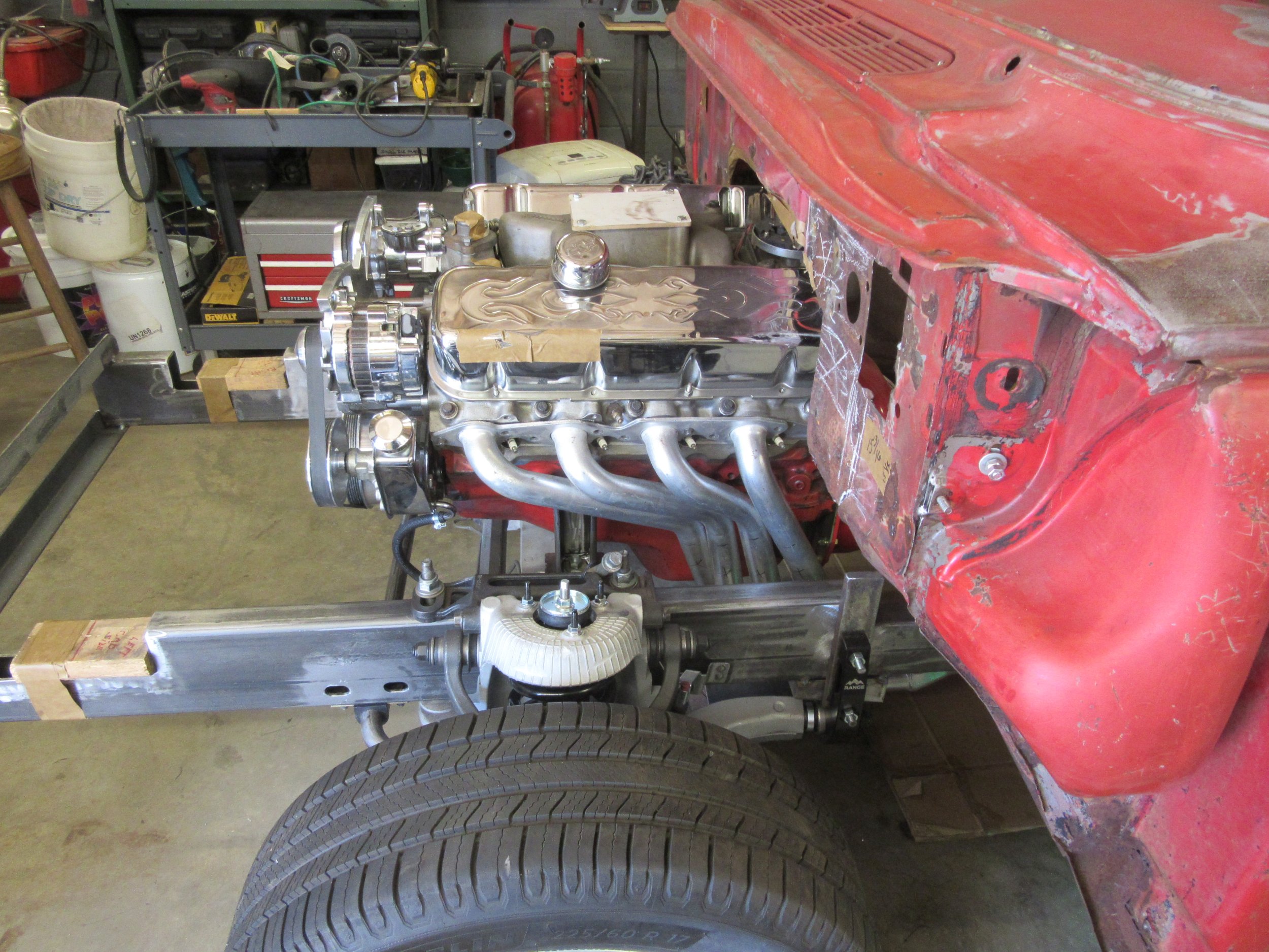

    from NC
    IMG_1748.JPG The crossmember is finished and bolted in, Grade 8 Flange/Frame bolts and nuts using crush sleeves in the frame. Motor mounts are done. I have been working on the mounts for the trailing arm bushings ( rear of the lower control arm ) the plan is to get those mounts tacked in place and see where the caster setting is and go from there. IMG_1746.JPG IMG_1782.JPG IMG_1783.JPG IMG_1790.JPG IMG_1791.JPG

    from NC
    I worked on the piece of tubing for the bottom of the LCA mount, boxing the ends and adding a crush sleeve. Checking the alignment on the right side just To get an idea of where things are and it looks like zero camber and four degrees of positive caster with no shims. I can add shims under the black LCA mount and that will increase positive caster. So I am pretty happy with that. IMG_1799.JPG IMG_1796.JPG IMG_1798.JPG
