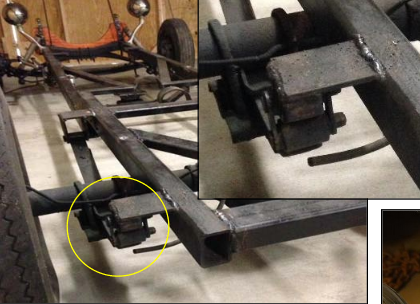

    BB Mopar powered 34 Dodge coupe, tubbed frame rail supports behind the axle coil overs with wide offset rims. That 3/4 depth notch for ladder bar clearance doesn't leave a lot of strength above (2"x1") given the depth of the notch. That diagonal brace doesn't really do a lot either and is pretty agricultural.
    alanp561 and chryslerfan55 like this.

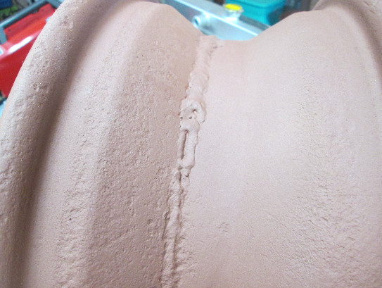

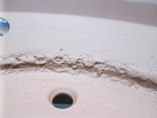

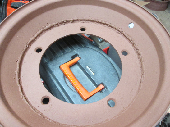

  7. A pair of old Stock Car wheels that were halved long ago.
    I am in a quandary with this do I fix them to race on my vintage car, or leave them alone and use them to put the car on and off the trailer?
    I don't dare use these for real racing!
    upload_2019-4-13_17-15-15.png upload_2019-4-13_17-16-56.png upload_2019-4-13_17-18-2.png upload_2019-4-13_17-18-54.png upload_2019-4-13_17-20-17.png upload_2019-4-13_17-21-21.png upload_2019-4-13_17-22-9.png

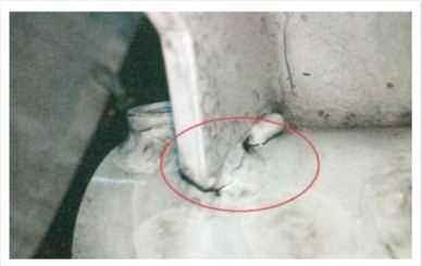

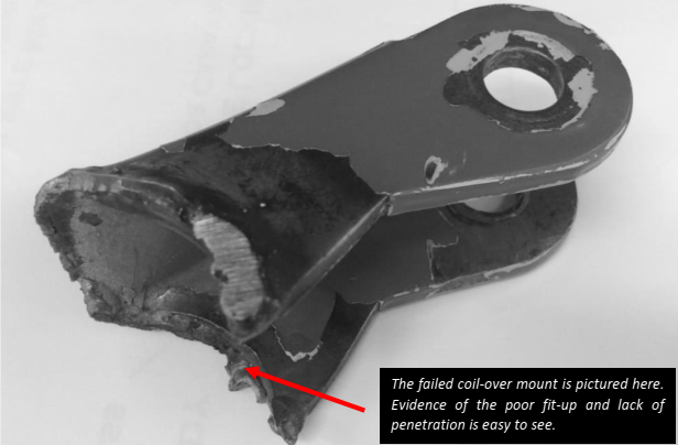

    Steering column shaft

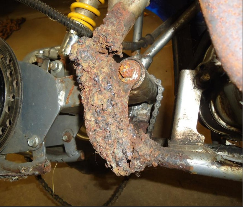

    Motorcycle frame repairs
    Driveshaft
    Leaf spring shackle mount
    Welded brake pedals
    Brand name IFS. It just goes to show that even the professionals sometimes get it wrong; poor quality (Inadequate) welding, design and fit up.
    Jet96 and chryslerfan55 like this.

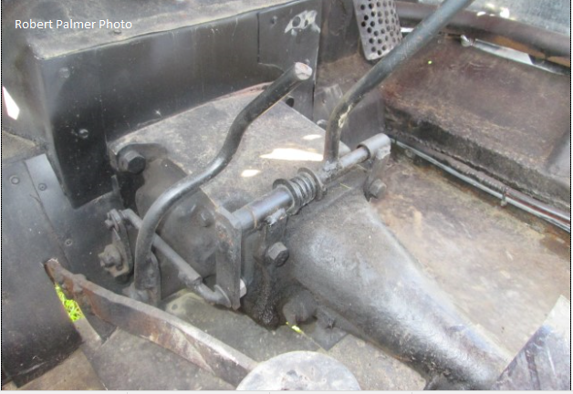

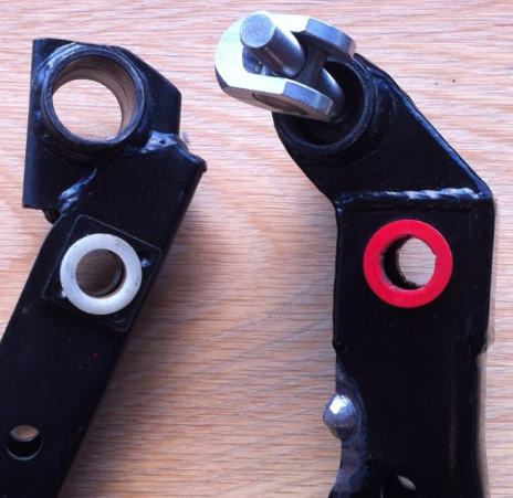

    Can you belief this brake push rod!!! :eek::eek:
    That's only a seat cushion hold down bolt!!
    Lowered coil springs, a little bit of heat will give you the desired ride height:D:D

    Wheel spacer ring
    Brake pedal push rod
    47ragtop and Dave Mc like this.

    Clean up the welds in pics 3 & 4, run a hot p*** of 7018 over them, run them. What's the problem?
  20. alanp561
    Joined: Oct 1, 2017
    Posts: 5,688
    alanp561
    X 2
  21. I know I can fix them, it's the fact they have been this way 20 maybe 30 years before I was born. (1981)
    They have history this way. A true pioneer did this, I am just a guy trying to emulate the past what gives me the right to change it?
    427 sleeper likes this.

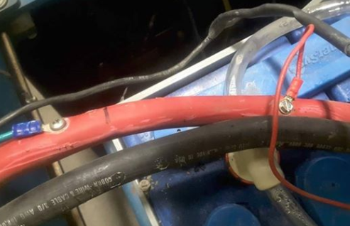

    Wtf is that? Sheet metal? JFC
  23. Surely you can’t be serious.
    VANDENPLAS likes this.
  24. DDDenny
    Posts: 22,964
    Yeah, that one needs to be in wiring books under "don't do this"!

    WTF in the world are people thinking
    chryslerfan55 and mgtstumpy like this.
  26. They think plenty, just not past the end of their nose. That’s pretty ingenious, needs power out of that wire and gets it. No knowledge or thought of anything beyond that. Sort of like an animal with opposing thumbs,,,
    VANDENPLAS, chryslerfan55 and 62rebel like this.
  27. BamaMav
    Joined: Jun 19, 2011
    Posts: 6,969
    BamaMav
    from Berry, AL
    I think of something like that wiring every time I read somebody talk about running a wood screw into a 12 volt battery to get 6 volts out of it. It might work, but just think, is it RIGHT?
