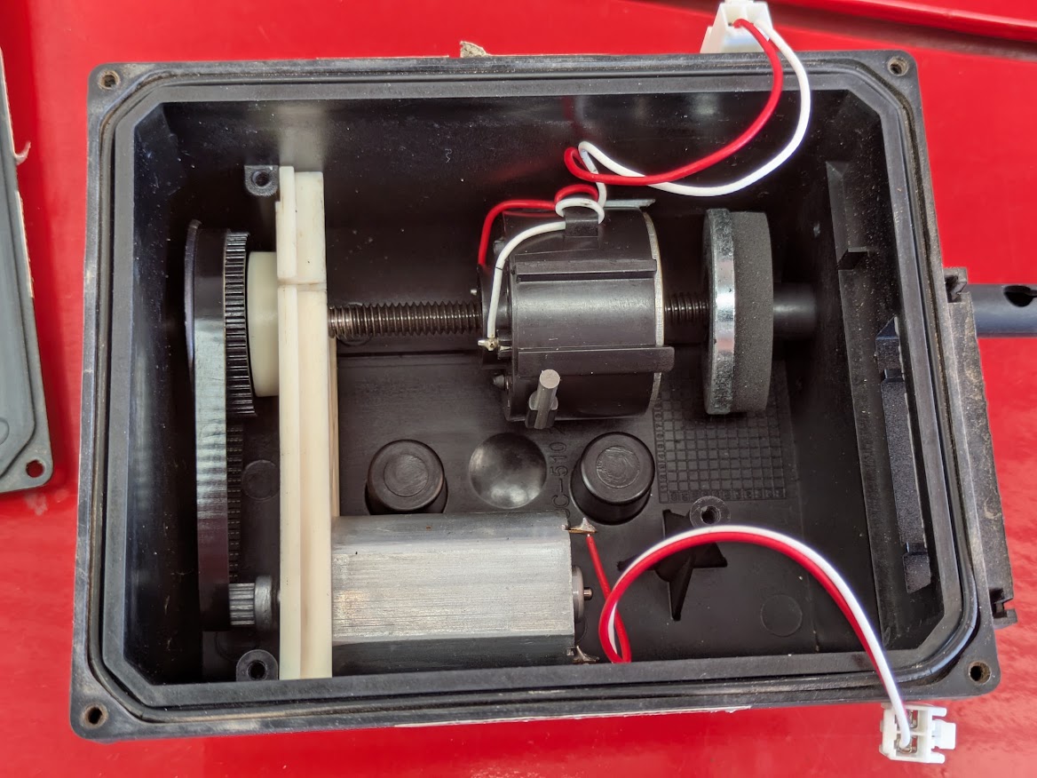

    just so you know, the way the cruise works inside, is that it has a stepper motor, with a belt drive to a lead screw. This moves the nut and cable back and forth, but is not attached directly to the cable--there is an electromagnet that holds them together. When you hear the "clunk" when it disengages, that's the electromagnet popping off the lead screw nut. Could be several different causes for this to happen, including having not enough travel for the cable, or wrong gain/setup timer settings. Also make double sure the speed sense switch configuration is set correctly, it can be confusing.

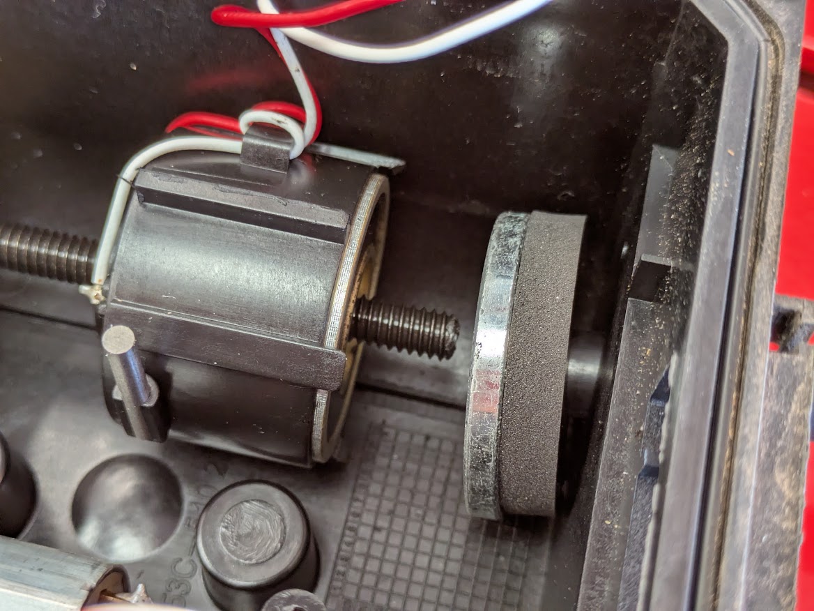

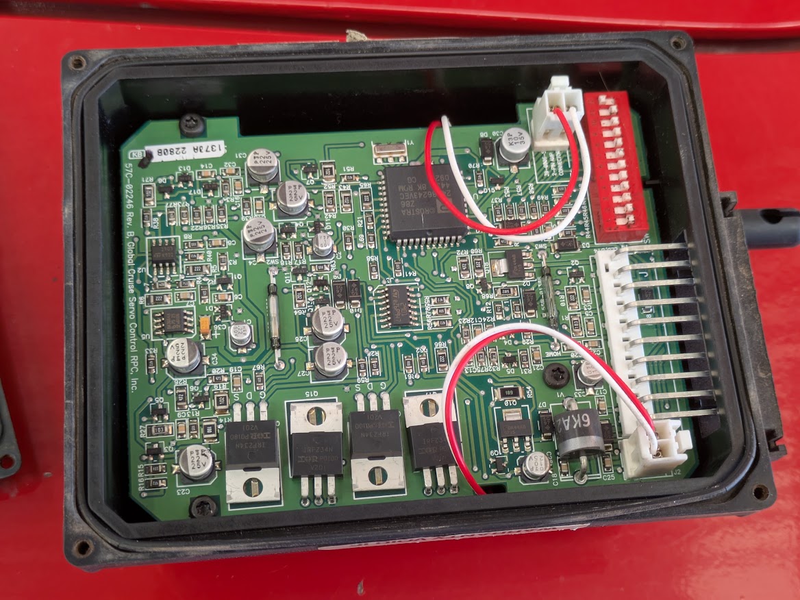

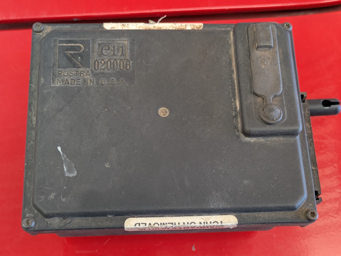

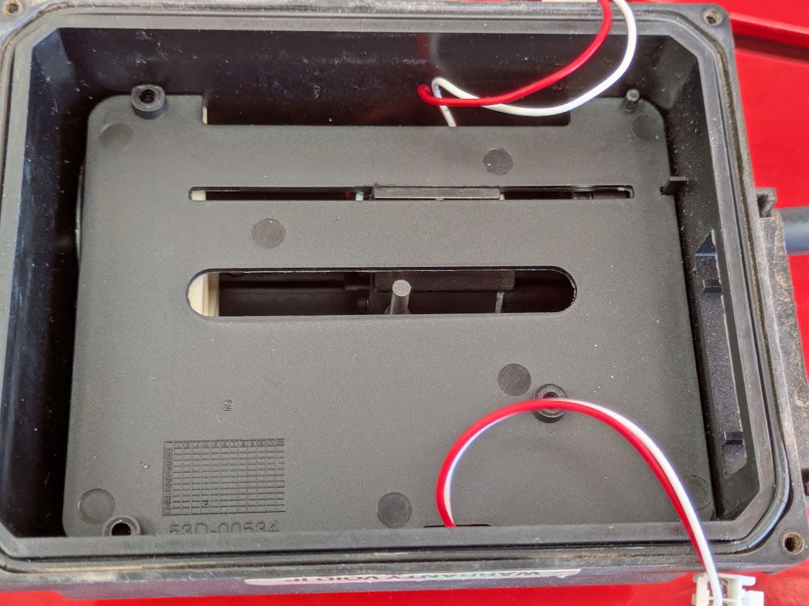

    you made me look...here are the insides of one that's gotten tired. I've had it over 15 years, and had it in at least a dozen cars (lots of them on LeMons Rallys).
    the outside
    The electronics board. Note the little gl*** reed switch to the left of center.
    this shows the magnet on the nut, that activates the reed switch when the cable is fully pulled out. I think it's the safety to disconnect the electromagnet.
    The mechanism. On this one, the motor came loose from the white mounting plate once, I had to take it apart and put the screws back in!
    close up of the nut/electromagnet. The black ring on the right side of the metal plate that attaches to the cable, is just a foam pad to absorb shock?
    Anyways, now the internet has a few pictures of the inside of a Rostra/Dakota Digital Globalcruise, showing the dis***embly.
    have fun!
