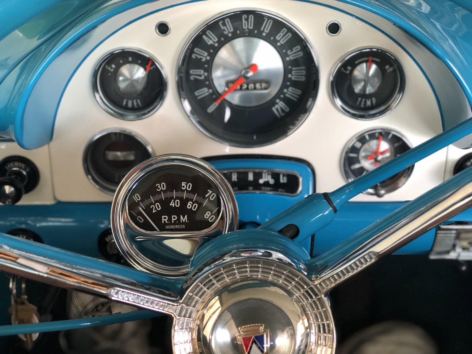

    Art Carrs shop installed a 1962 Thunderbird Cruise-O in my 56 Victoria behind its factory 292. The car had an air cooled trans originally. They ended up using the 56 air cooled converter by changing the hub and water cooled trans body. The 62 used a vacuum modulator for shifting and side control arm is for down shifting only. It was a great addition to the car and allowed me to install a rear end that would take higher gears.
    With a fabricated extension on the column shifter and shortening the link on the trans I was able to add a 6th position on the indicator. It now has green and white dot. IMG_3339.jpeg
