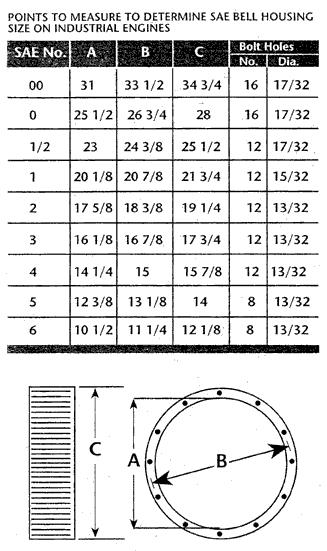

    It does not appear to be a SAE bellhousing pattern, but, check your measurements against this chart.
  7. Just measured. Tough with input shaft in. As best I can tell it is between a SAE 5 and 6. Will set box on a surface with a bored center hole and trace outside diameter and bolt holes to get better measurements tomorrow. I have a 1934 Ford V-8 transmission in our 2 man sprint car mated to a 1949 Ford 226 inliner. I will check it's dimensions tomorrow to see how close it measures to this box. This box was pulled from a well used up old sprinter that was being parted out. Believe it attached to a motor plate. O.K. Thanks again for your help. Will post results tomorrow.
