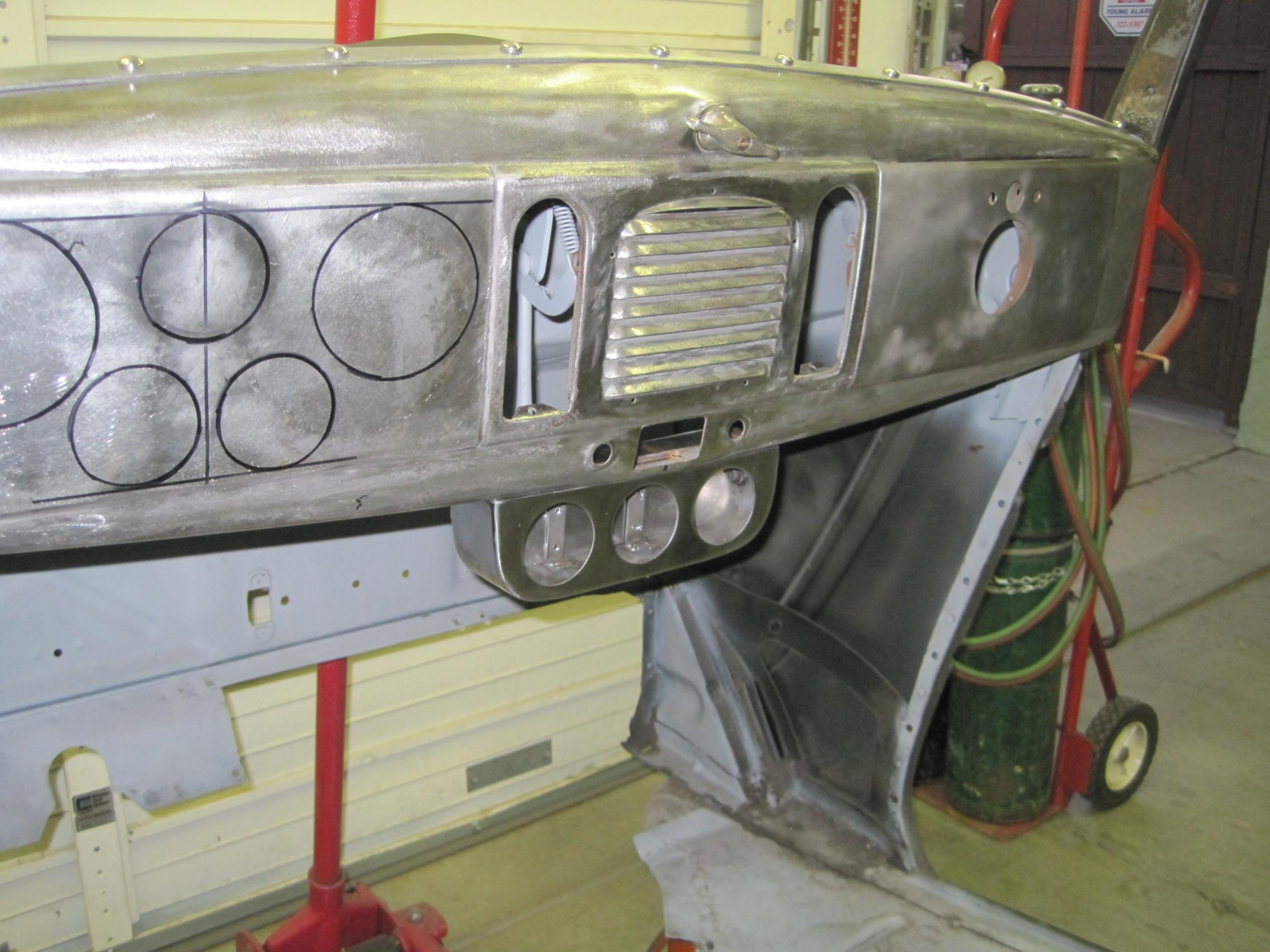

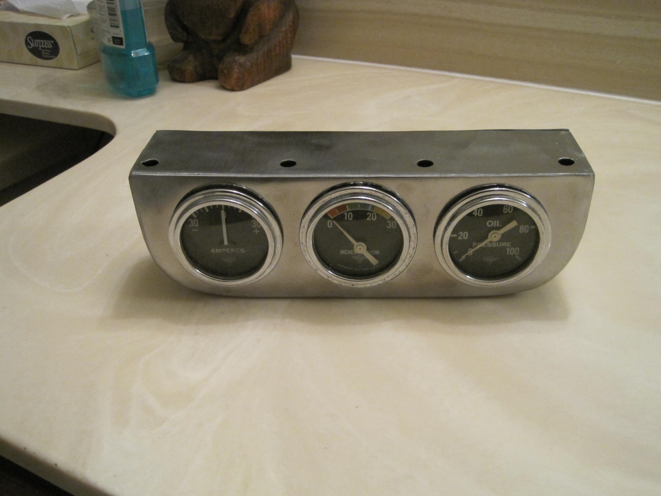

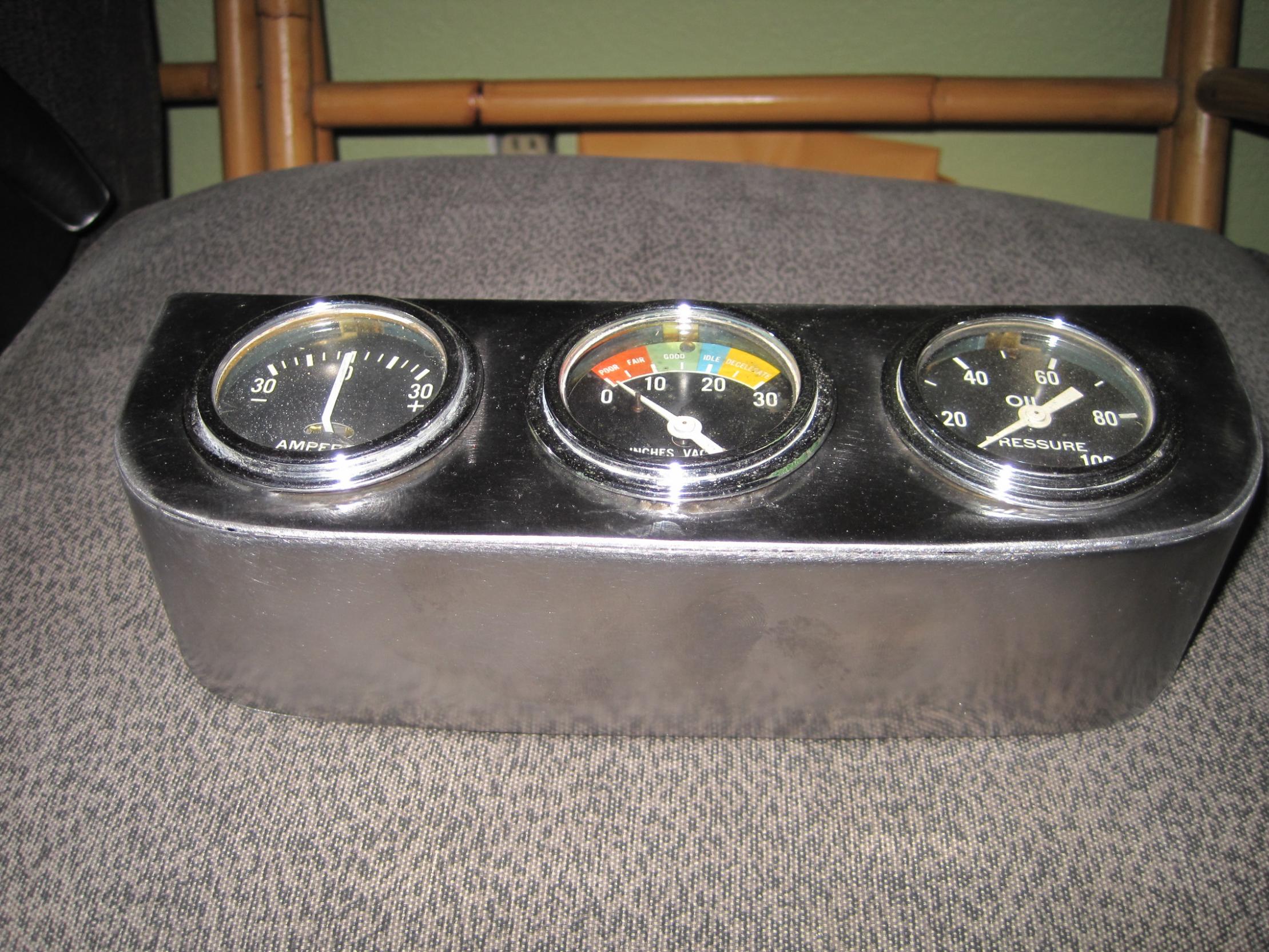

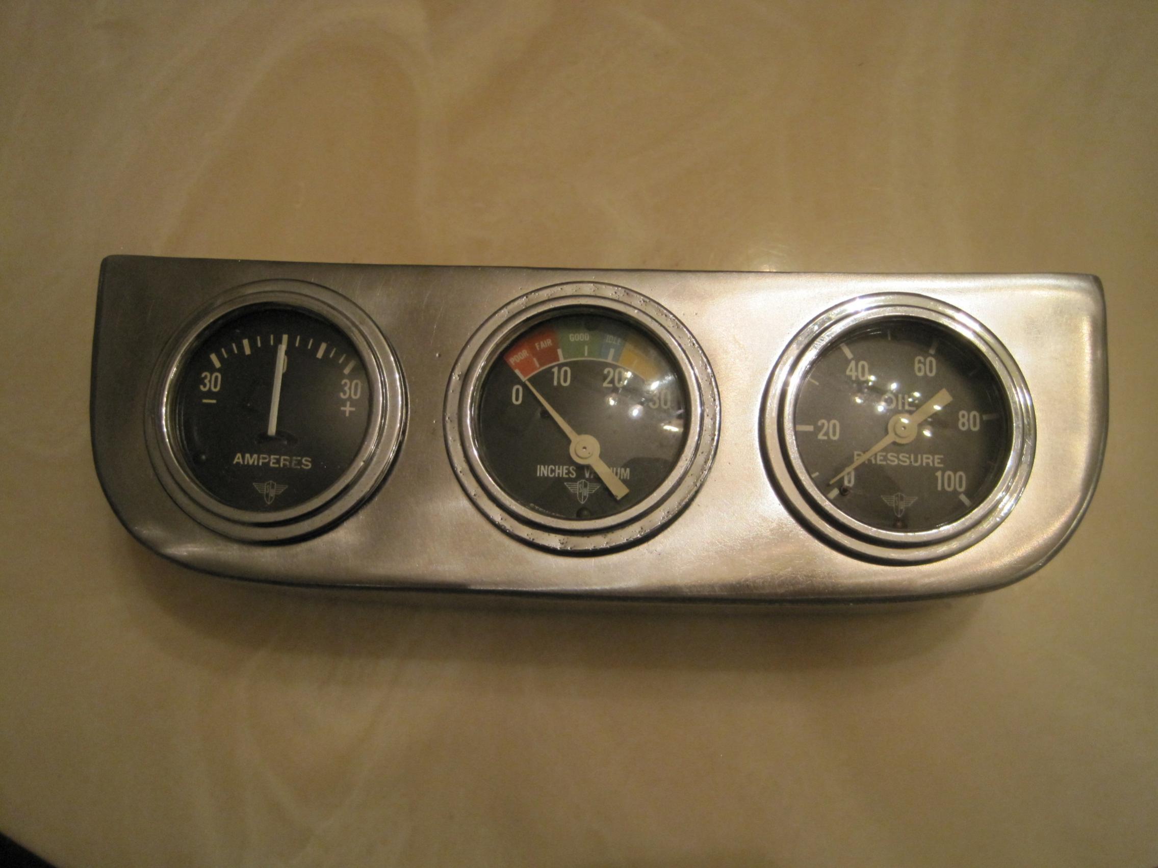

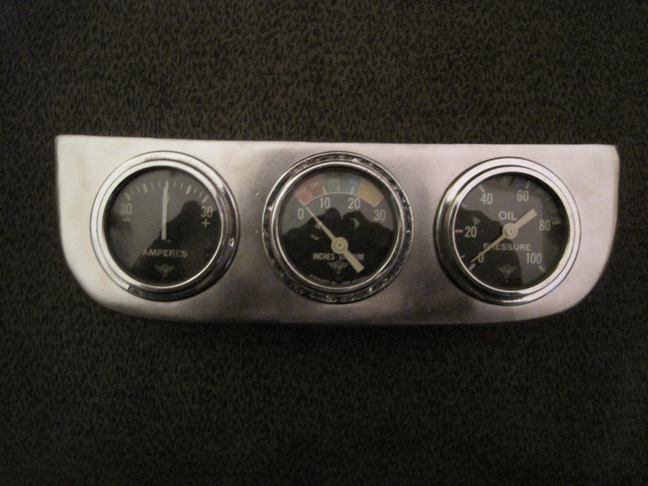

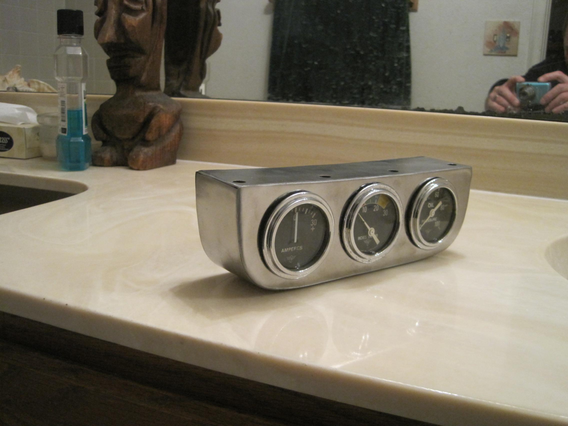

    As I mentioned earlier in my posts I wanted to build an accessory panel to house 3 of the 6 small 2 1/8 S-W winged gauges. Not enough room in the main dash for all the gauges I want to use. Here's what I came up with today. I made this to fit the curvuture of the bottom of the 38 dash. I decided it needed to be simple in design. I will paint this black to match the dash. I made it with a pretty deep housing so it hides the gauges from the side when looking in the car with doors open. I will put some lights inside and it will keep the light from spilling out the back with the rear cover on it. I have not decided what gauges will go in this underdash pod yet so that is why I have not cut the holes in the back of it yet. That will come when I decide what I want where. It's too late to go bolt it under the dash but it looks pretty good. Maybe tomorrow I will get it attached to the dash for a view. This was easy to build and I like it better since it hides the gauge backs totally.

  8. Dirty Dug
    Joined: Jan 11, 2003
    Posts: 3,722
    Dirty Dug
    Copy cat! Nice, but why did you close the backside?
  9. curbspeed
    Joined: Feb 7, 2002
    Posts: 4,917
    curbspeed
    Doug, I will cut out some holes for things to poke through in a bit. When you put lights in these they shine light out the back under the dash. I don't want that. You'll see when I take you for a ride someday(soon I hope) It will be dark and we will be alone. Nuff said.

  12. Dirty Dug
    Posts: 3,722
    Dirty Dug
    The alone part I'm not liking but since the gauges are back lit it makes all kinds of sense. Now I get it. And by the way, that's more sprung weight which is a good thing.

    Looks great! I remember having a car with the ol' underdash gauge deal going on. Looked ****ty from the sides, and light leaking out back was distracting as well. You covered both issues well!

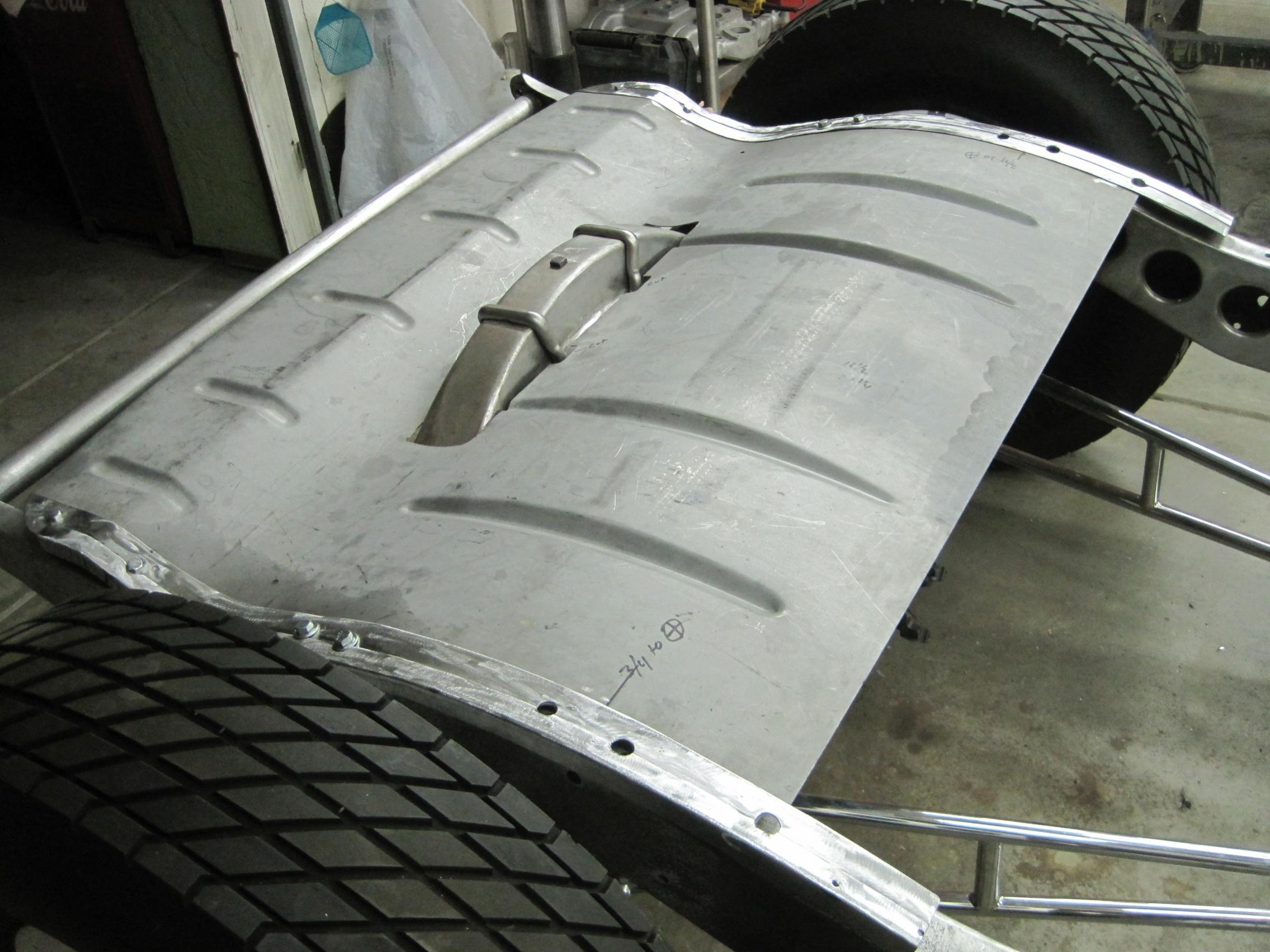

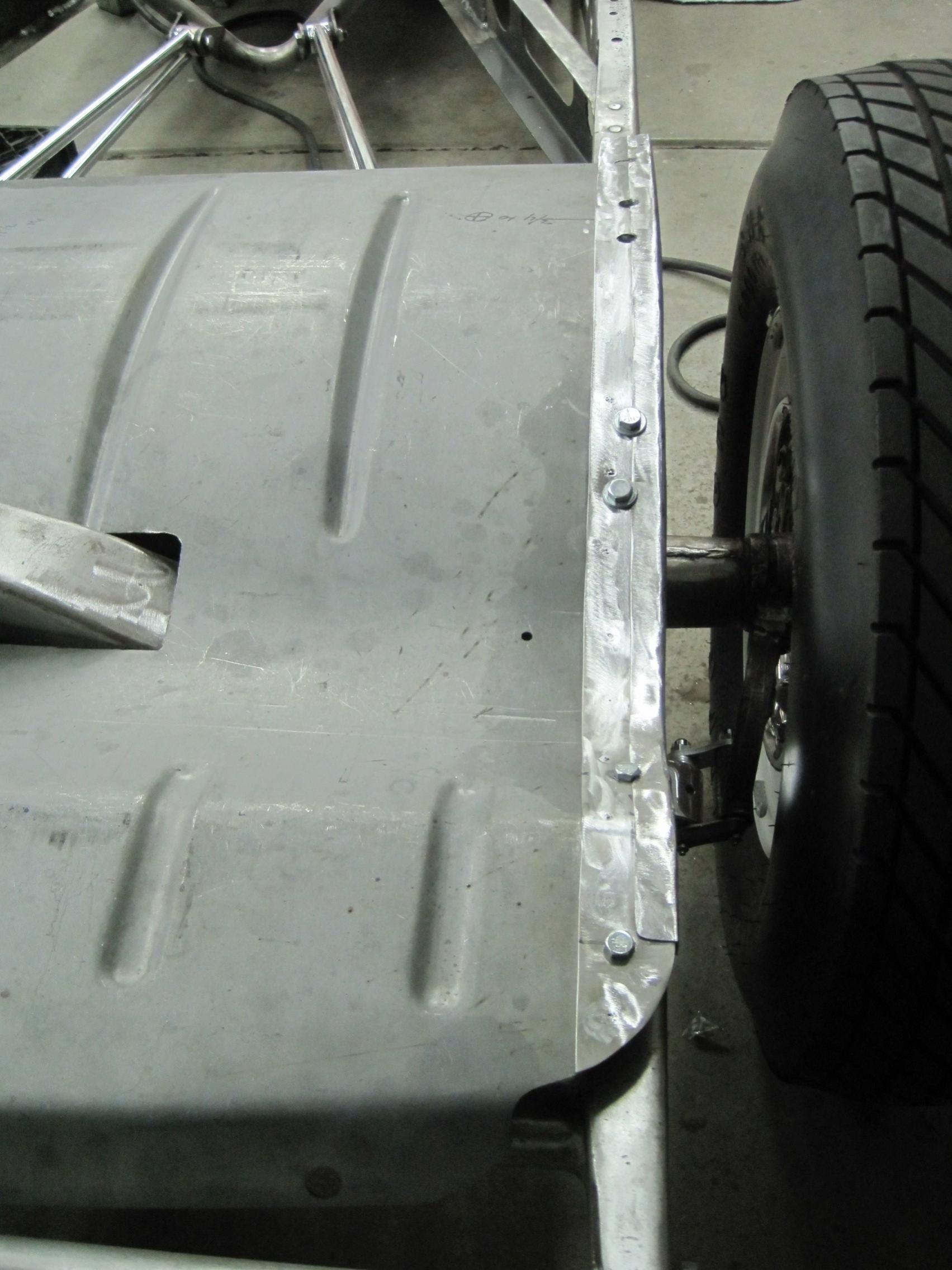

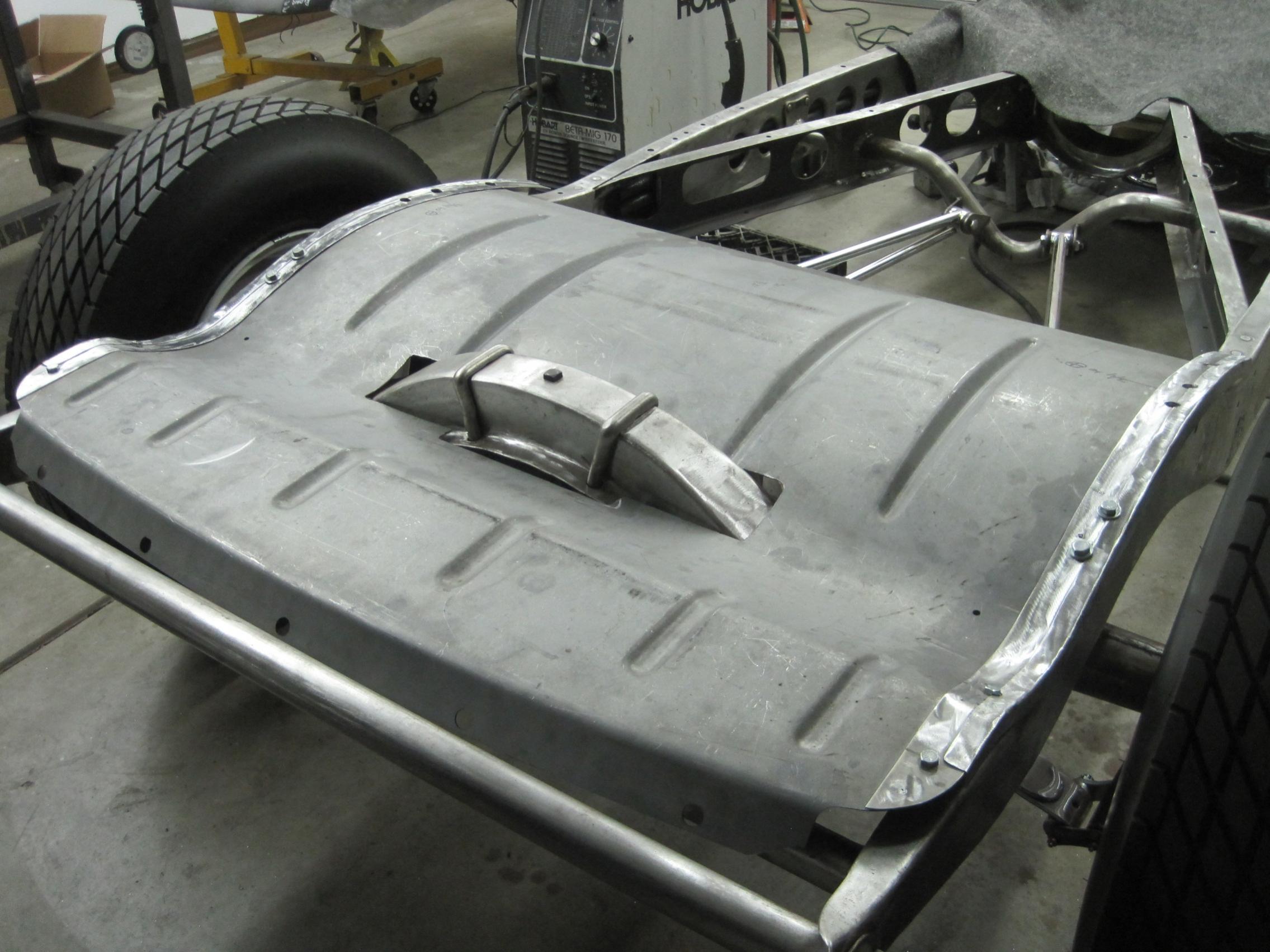

    I mocked it up in the car for a visual. Looks ok to me. Spent a few hours working on the rear floorpan area and making subrails. I still have aways to go but I'm getting something done. I can't wait till this part is over and I am on to other things. I want the body mocked up on the frame.
