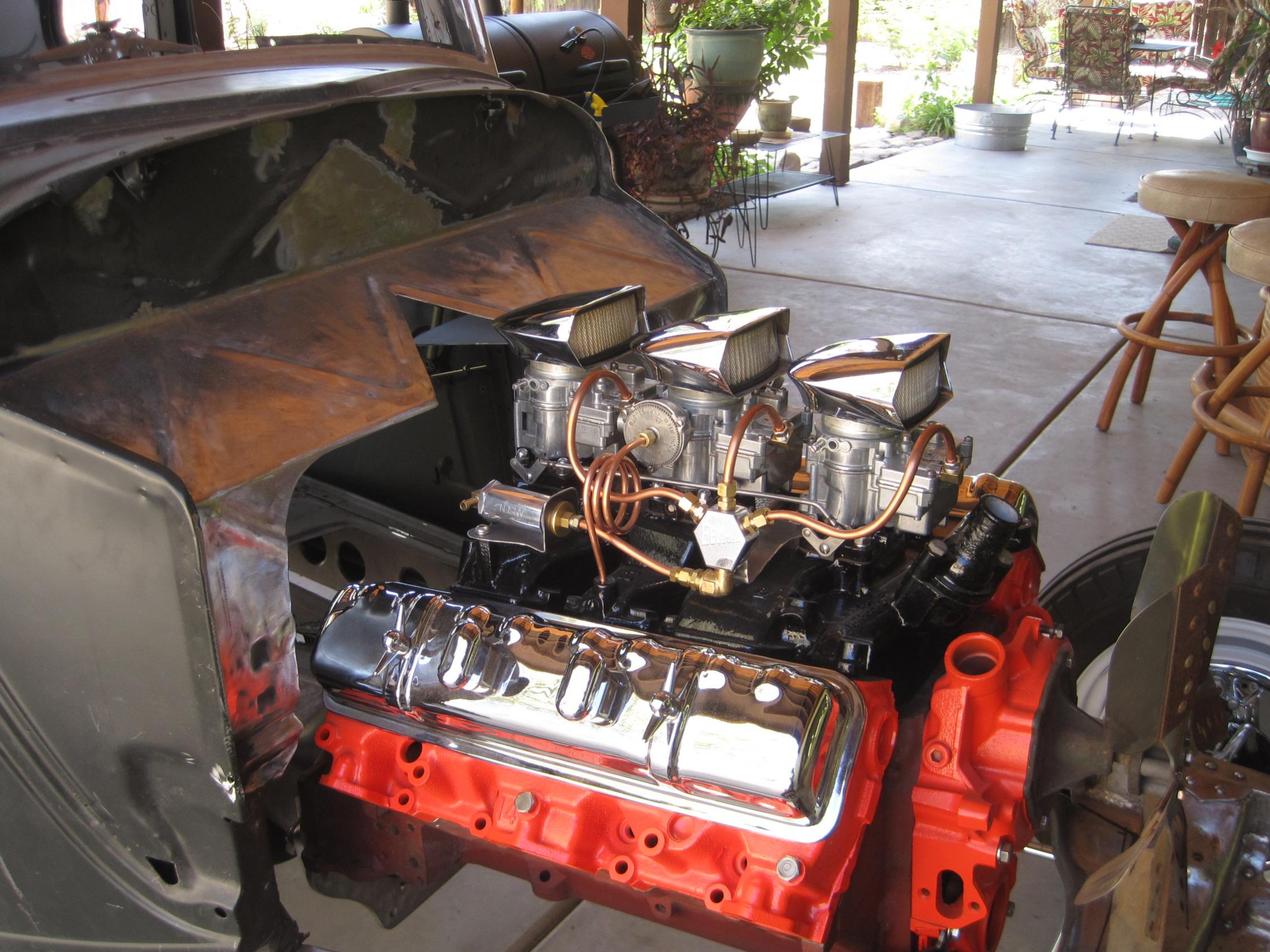

    A little update: I have been getting back to work on my coupe project. Over the last three months I have got very little done as my my father was ill and his p***ing kinda drained my enthusiam for working on cars. My dad gave me the desire for this old stuff and it really hit me hard when he p***ed. I doubt he would have wanted me to stew in my own juices too long so I decided to hit it again. Here is the result of the last 2 weeks work.
    Motor and ****** mounts are fabbed and in. Floors are in. Starting to strip primer off for the chop at the end of the month. Quarter panel was an old repair from the past that was done half ***ed and I had to cut it out. Got new patch panels from Donny Smart to go in. I have cut out the old chit and have one patch mocked up in the hole at this point. I am not done with the firewall yet. It looks like I cut a lot of it out but if you want to pull a head off with out pulling the motor you need all of that room. I have some cool ideas on how to fill the area . I am happy with the stance of the car. It should look really good after a 5 1/2 haircut.

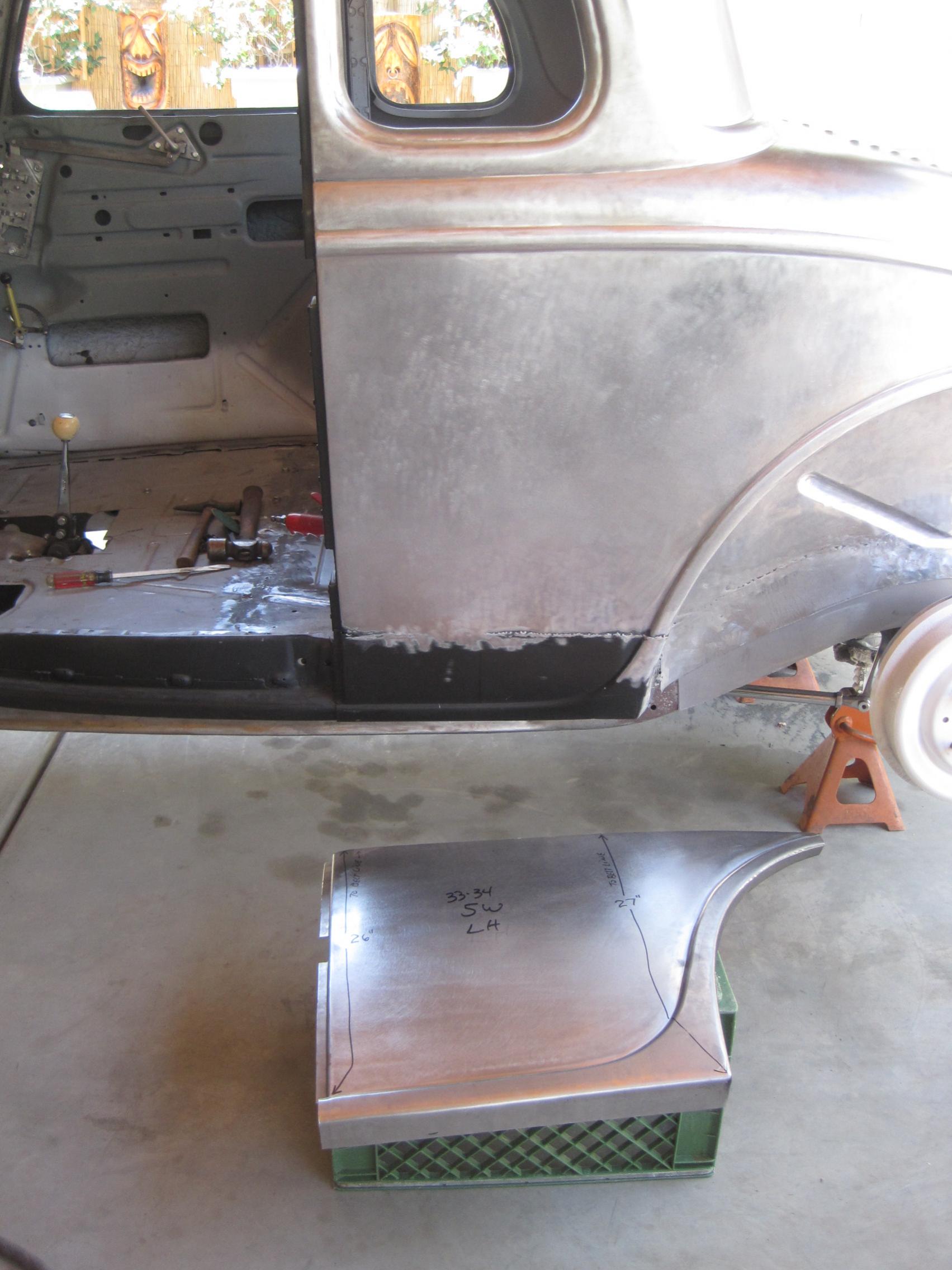

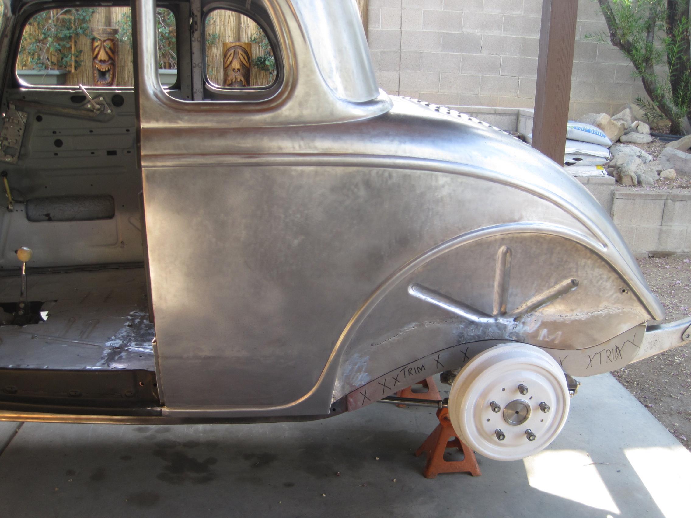

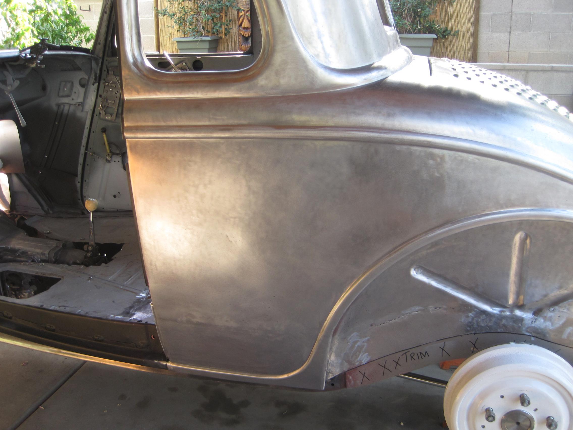

    Worked on fitting and tacking the drivers side quarter panel in today. Let's just say I have a new found respect for panel beaters that know how to put in patch panels into an old body and have them look good. I have a ways to go on it but the wife says I was making too much noise on her day off so I quit for the day. Gotta honor the boss. Photo's tomorrow after I get farther along while the queen is at work. Full speed ahead!
  26. curbspeed
    Joined: Feb 7, 2002
    Posts: 4,915
    curbspeed

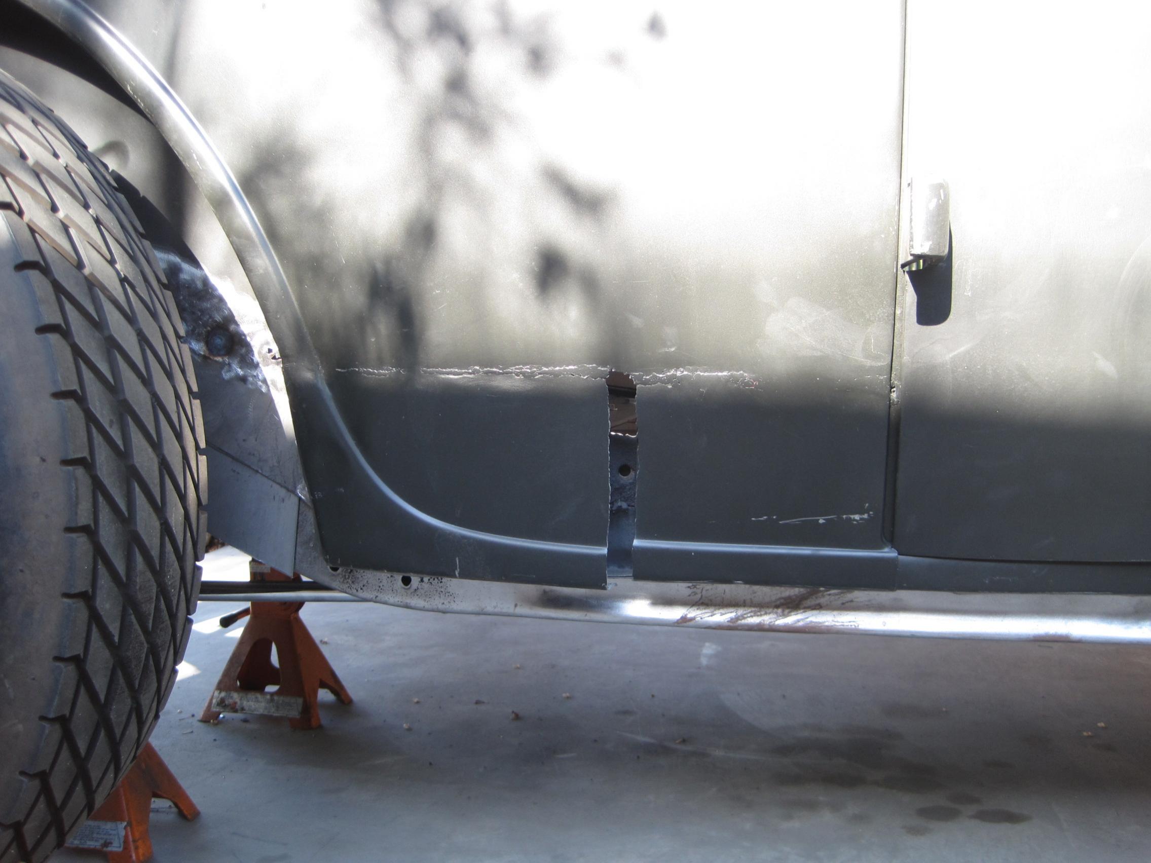

    Finished the drivers side 1/4 panel patch for the most part. It's a little wavy but nothing a little bodywork won't remedy. I don't have the patience or skill of some to completely metal finish to perfection, even though I have visions of once in my life having a patch panel come out really nice. The panel from Don Smart worked out pretty good. Overall a pretty nice piece. Had to tweak the rear body line in the wheelwell area some to fit up closer. Here it is roughed out and ready for bodywork after I get the chop done. I am also posting a pic of the p***. side to show the amateur work from a long time ago(not me). it's kinda weird what someone did. I think they got pissed off at their poor attempt. That's the only thing I can figure.
