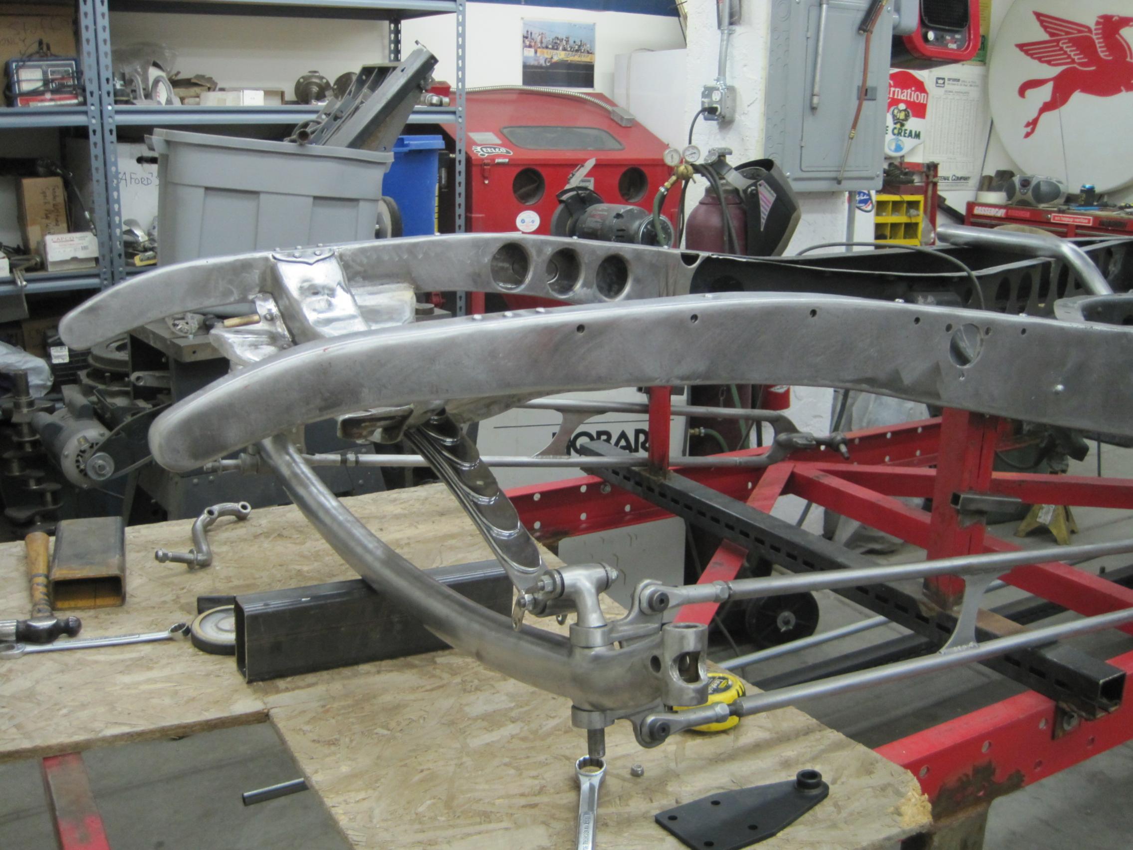

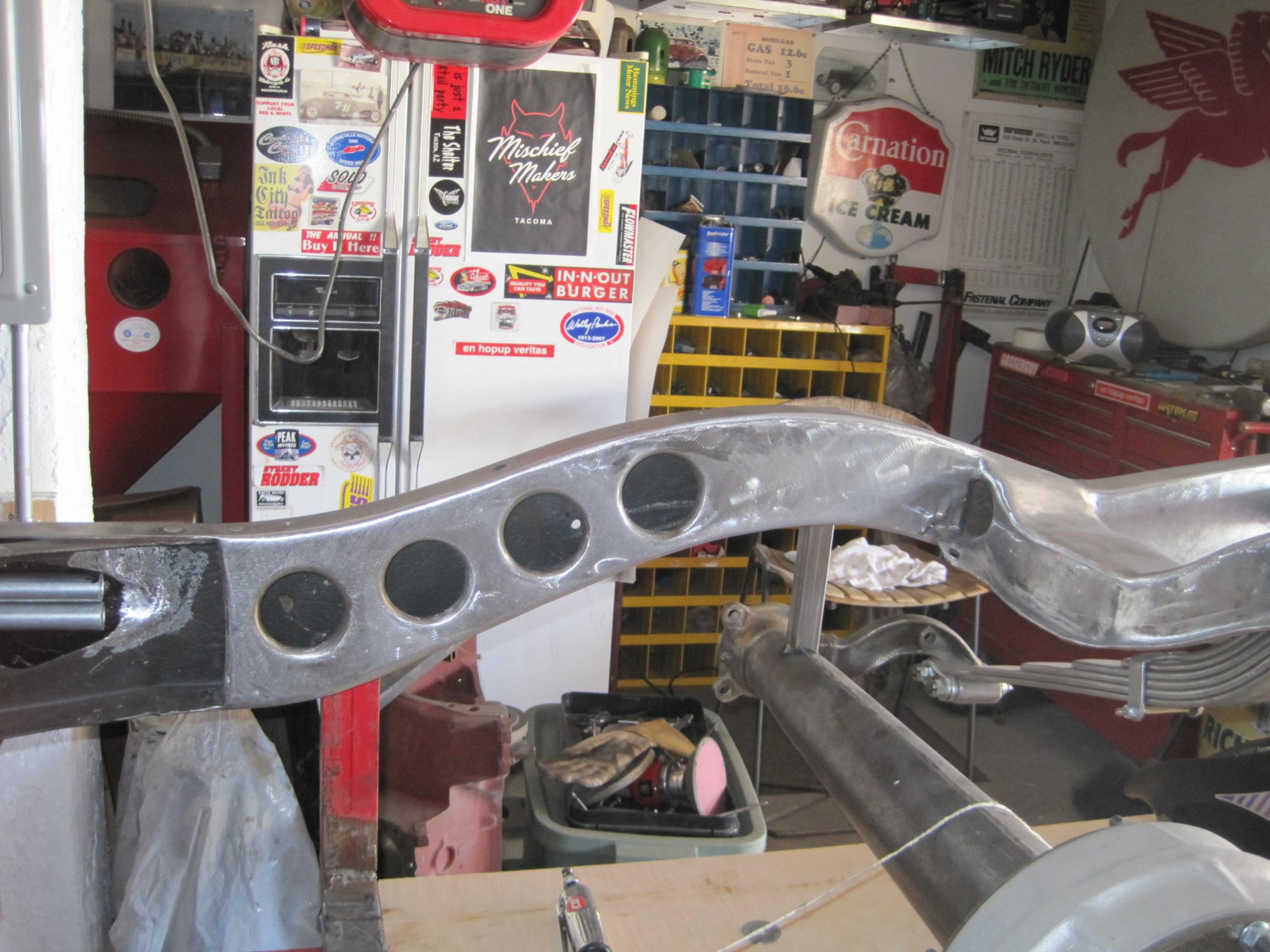

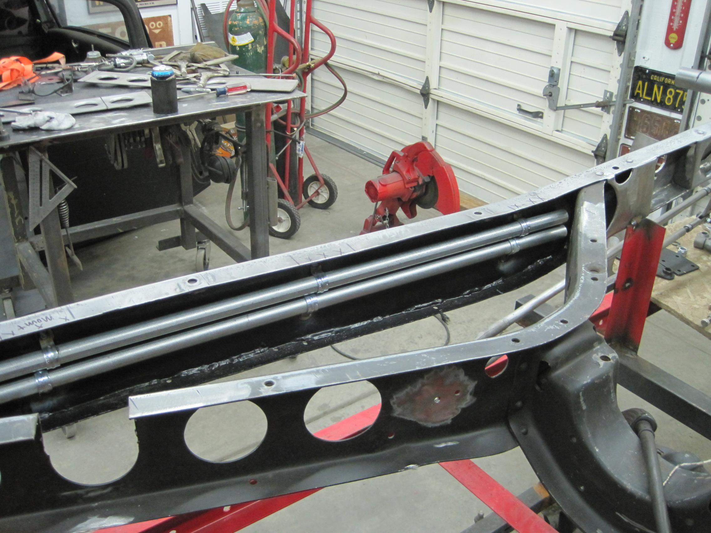

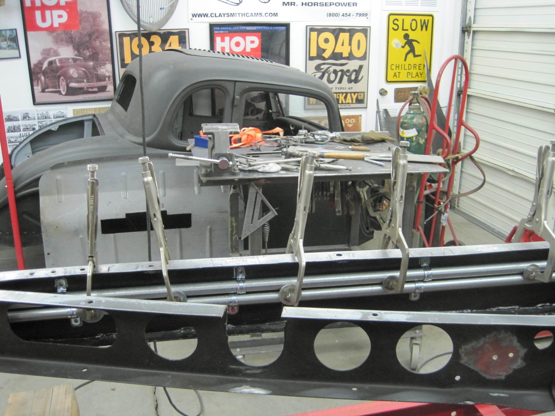

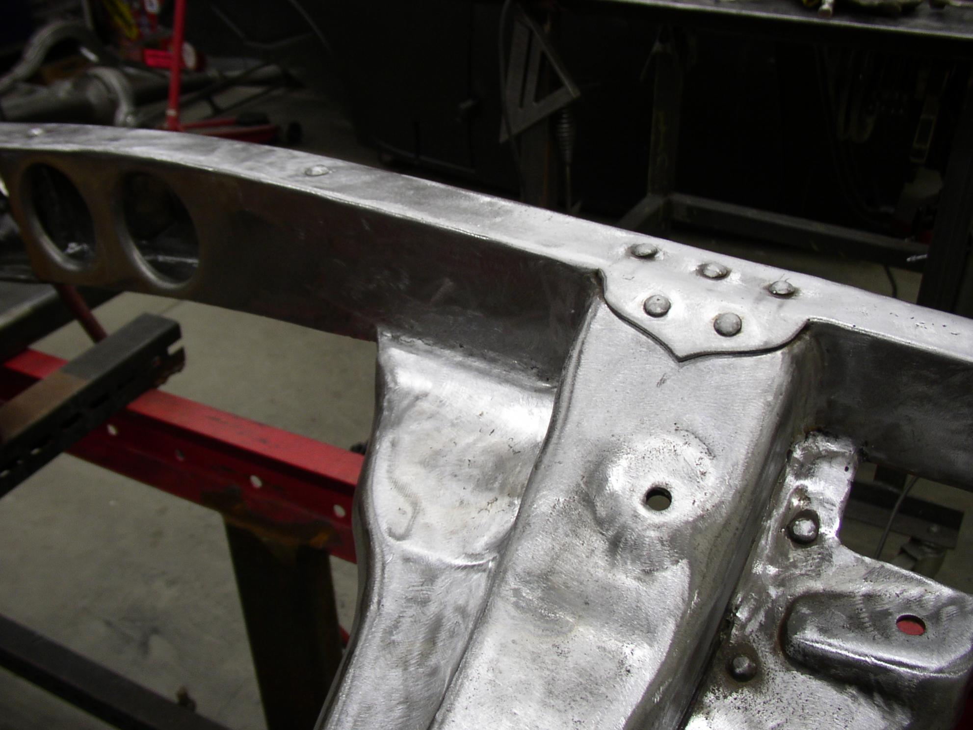

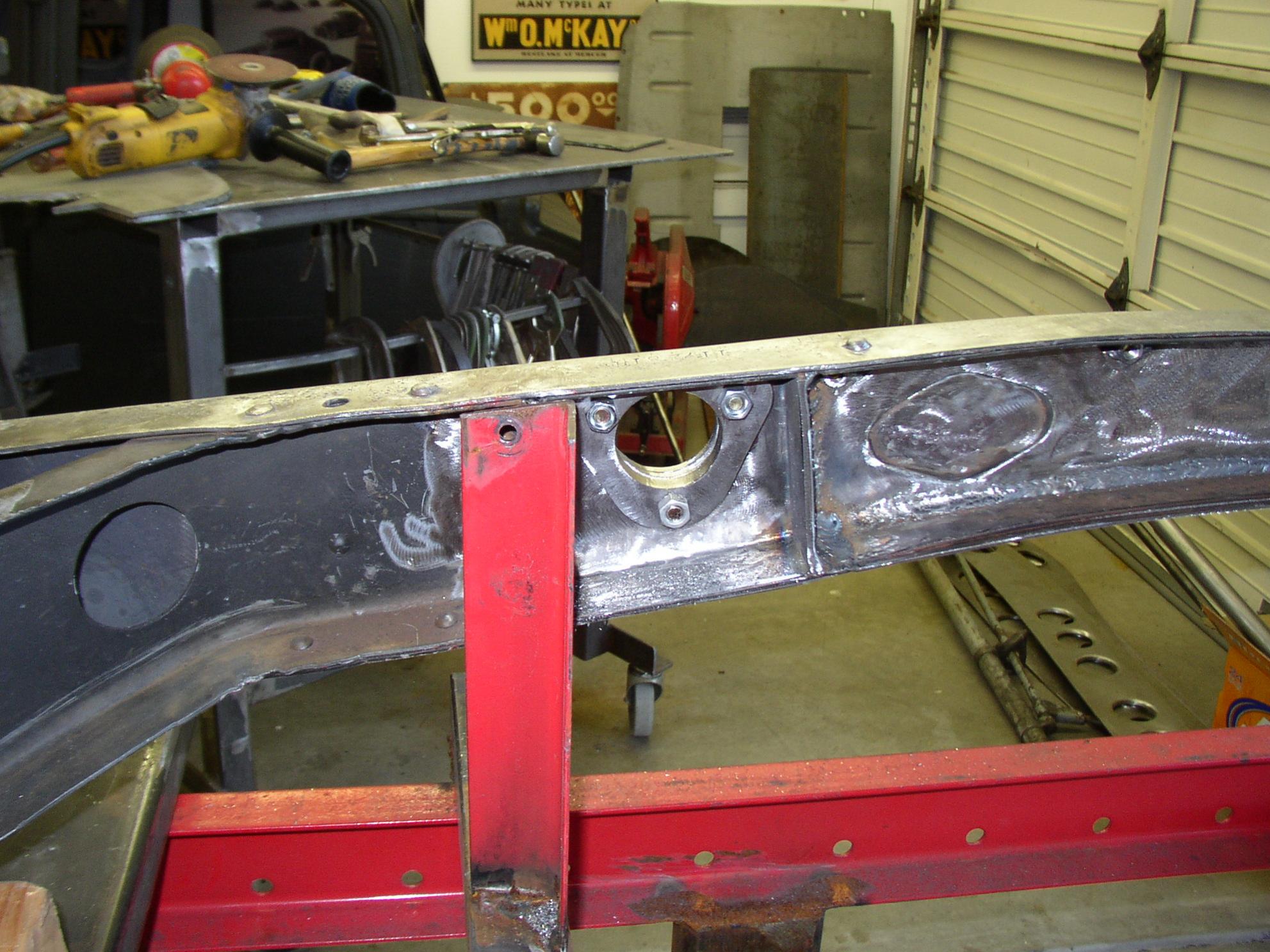

    Update: Been working on the frame a little bit. Boxing with Ionia hotrod shop plates. Having to modify them quite a bit as I have changed the shape of these rail significantly. Adding some tubing inside the boxing to allow for wiring,fuel,battery, and maybe brakelines. Pictures will explain. Tubing will be painted black with undercoating and will disappear inside the belled holes. F-1 steering doubler made. Using the Vern Tardel method.

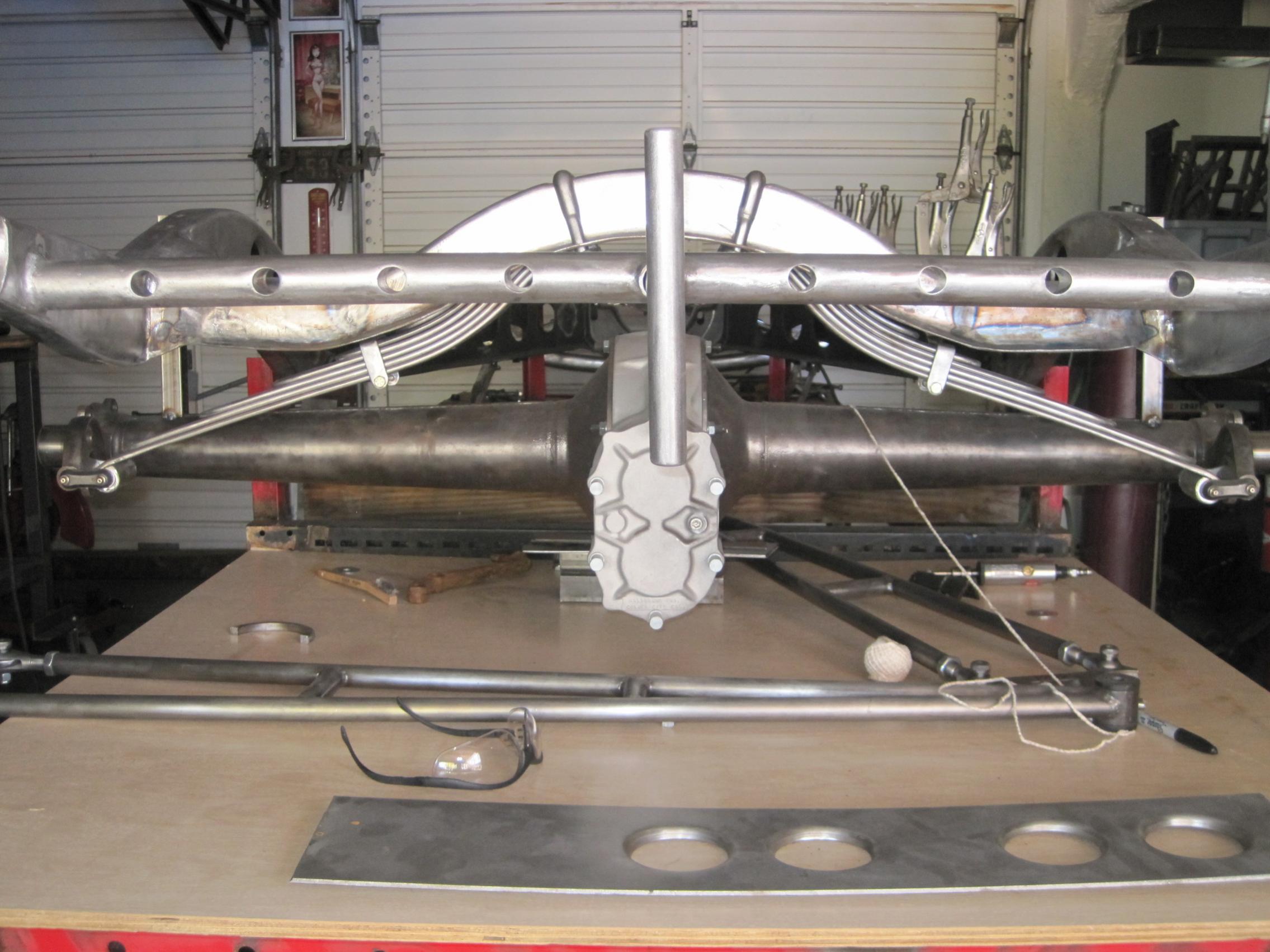

    A few more pics of the messy shop and the suspension mockup beginning.

  11. Looking good man, love the tube axle up front and the quickie out back. What's the deal on the F1 steering doubler? I'm not familiar with this.

    Dubzilla, The doubler is for added strength. It is suggested in Vern Tardels Steering booklet for converting F-1 steering boxes into early Fords. I figured it couldn't hurt. Having a steering box that flexes in the frame does not appeal to me. I need to head out into the lab and work on this beast but am having trouble getting motivated today. I need to push on though.

    Weird. Why does the date say yesterday? I posted this stuff today. I did get out into the shop tonight and got the chases installed and coated black with bedliner. This car will get some salt on it so it needs to be protected inside the framerails.
  17. Yeah, I get it now :) just hearing the word "doubler" made me think that you also did something to change the actual steering ratio. But there's no pics posted of anything like that.
