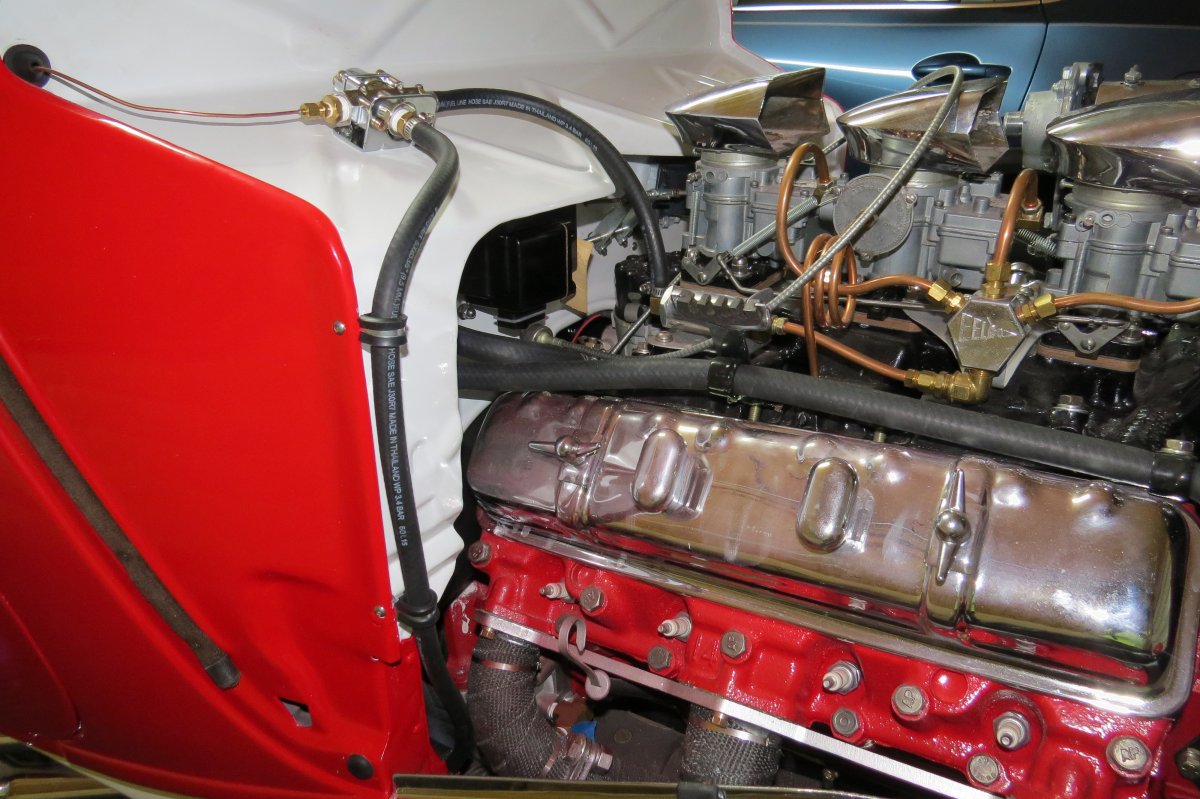

    Fuel tank is a antifreeze tank off a Vietnam era plane. 20 gallons. IMG_1288.JPG IMG_1287.JPG Rob the window garnish moldings are painted red to match everything else. Finished fuel lines completely today. I just need a fuel pressure gauge and I'll be set. Battery, Battery box/AC box(future) and cables are done. Tomorrows job is making up spark plug wires using Seal Tight plug ends and making up my Mallory cap. Then I'll start on wiring my EZ wiring kit. Gl*** is not cut yet. I still need to make up some patterns. I have two patterns done for the quarter windows. I'm picking off my list. My goal is to fire by the 1st of August.

    But the car would be much safer if before you did any "testing" like burnouts :rolleyes: and if you can make some time if you replace the rubber fuel hose in the bellhousing area and rear of the carbs with some steel fuel lines. ;)

    Copper lines are right below this. Firewall to filter needs to be flexible. Rubber hose down toward frame is getting some flame resistant heat shield line wrap near header. It will be safe. I don't want a fire as well. Thank you though. I appreciate it.

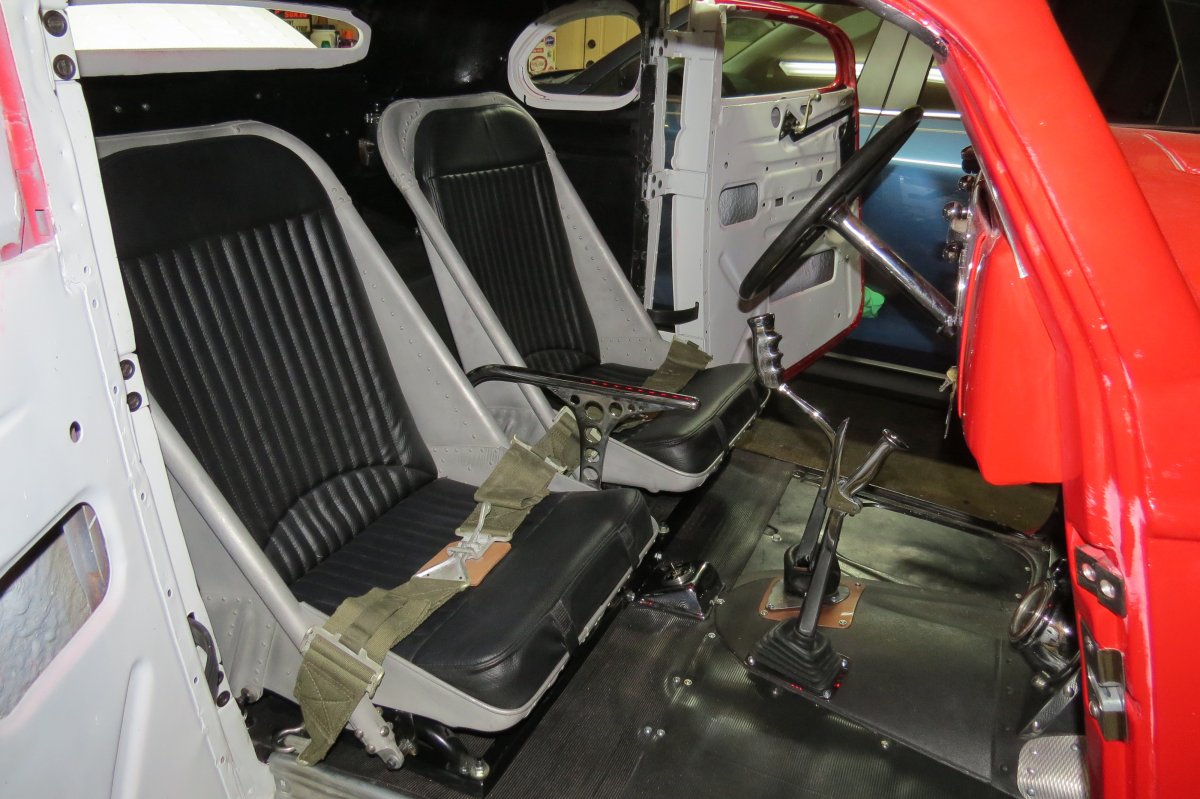

    Tonight's progess. Seat track, seats ,grab bar/armrest, NOS seatbelts from 1953. Wiring starts on Sat. IMG_1292.JPG IMG_1290.JPG IMG_1293.JPG IMG_1294.JPG

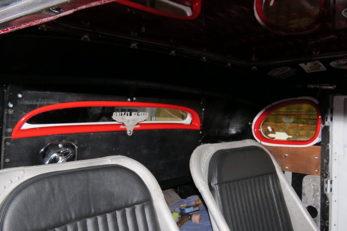

    Got a couple pieces of gl*** in today. Back roll down window(hard to make work on a chop this hard) and a 1/4 window. I'm going to do some paintwork to make them look better later. Ok for now. The white behind the red garnish moldings will go away soon. IMG_1477.JPG IMG_1475.JPG IMG_1473.JPG IMG_1474.JPG

    Does it take about a quarter turn of the rear window winder to lower it all the way?
