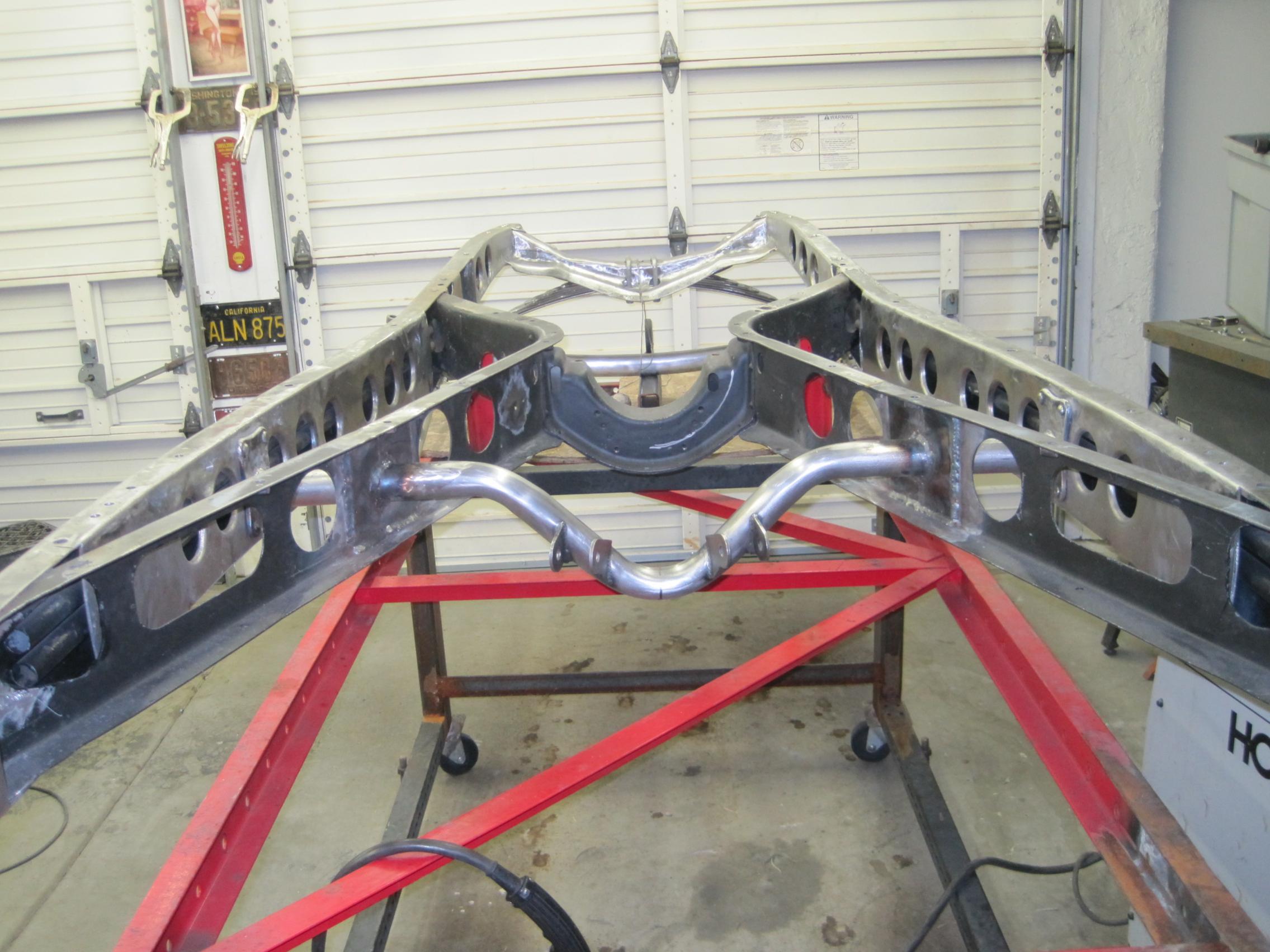

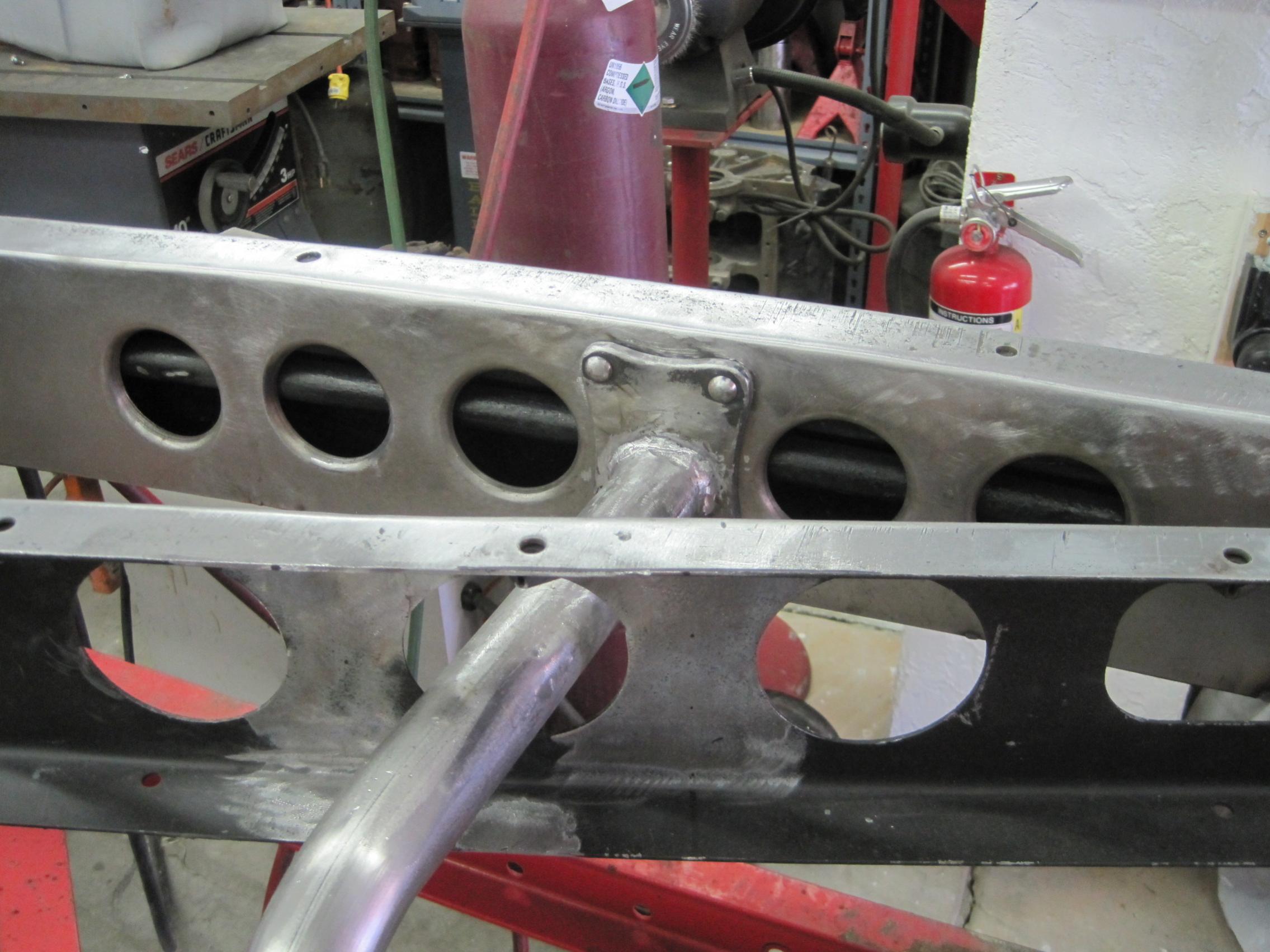

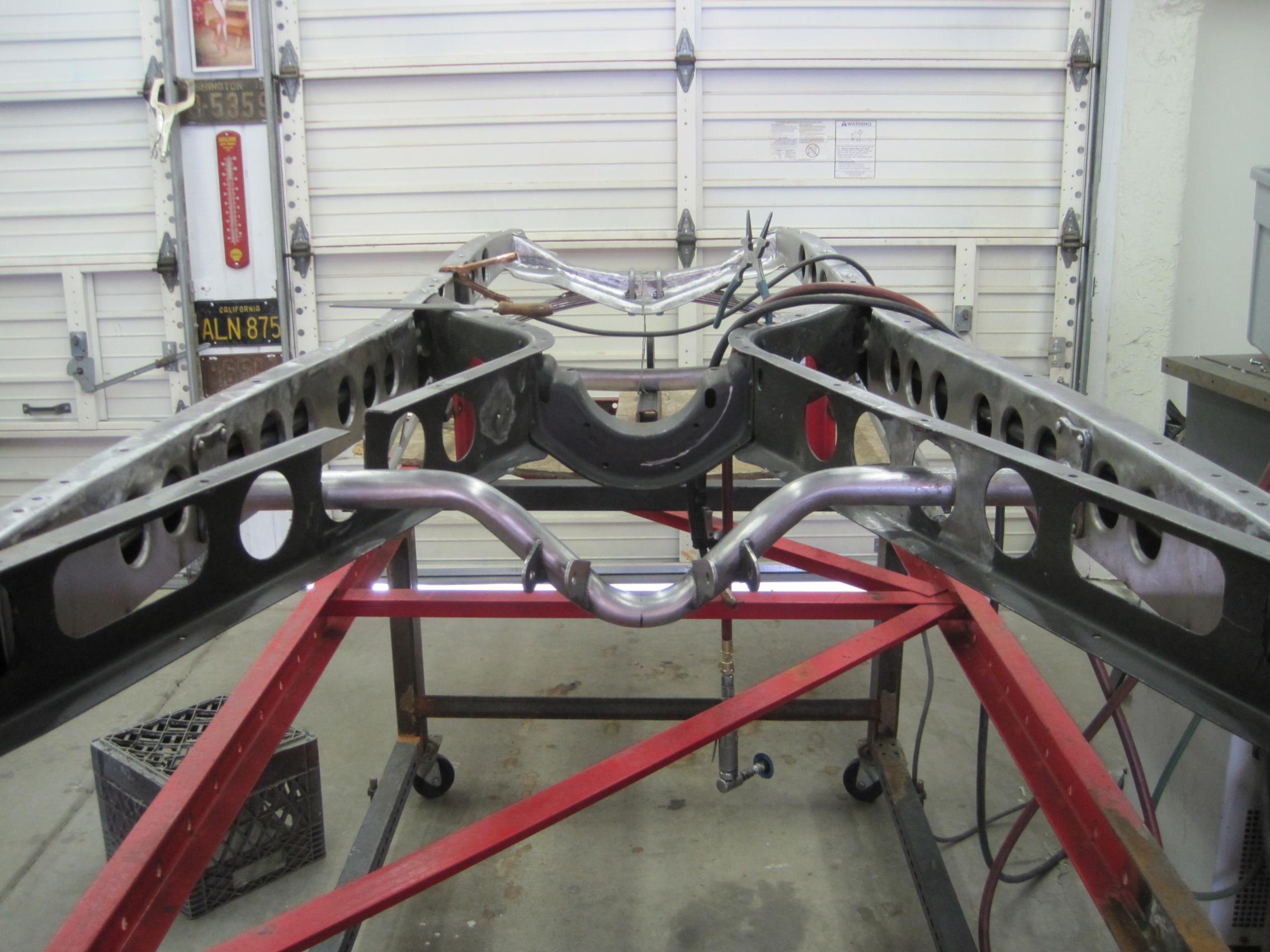

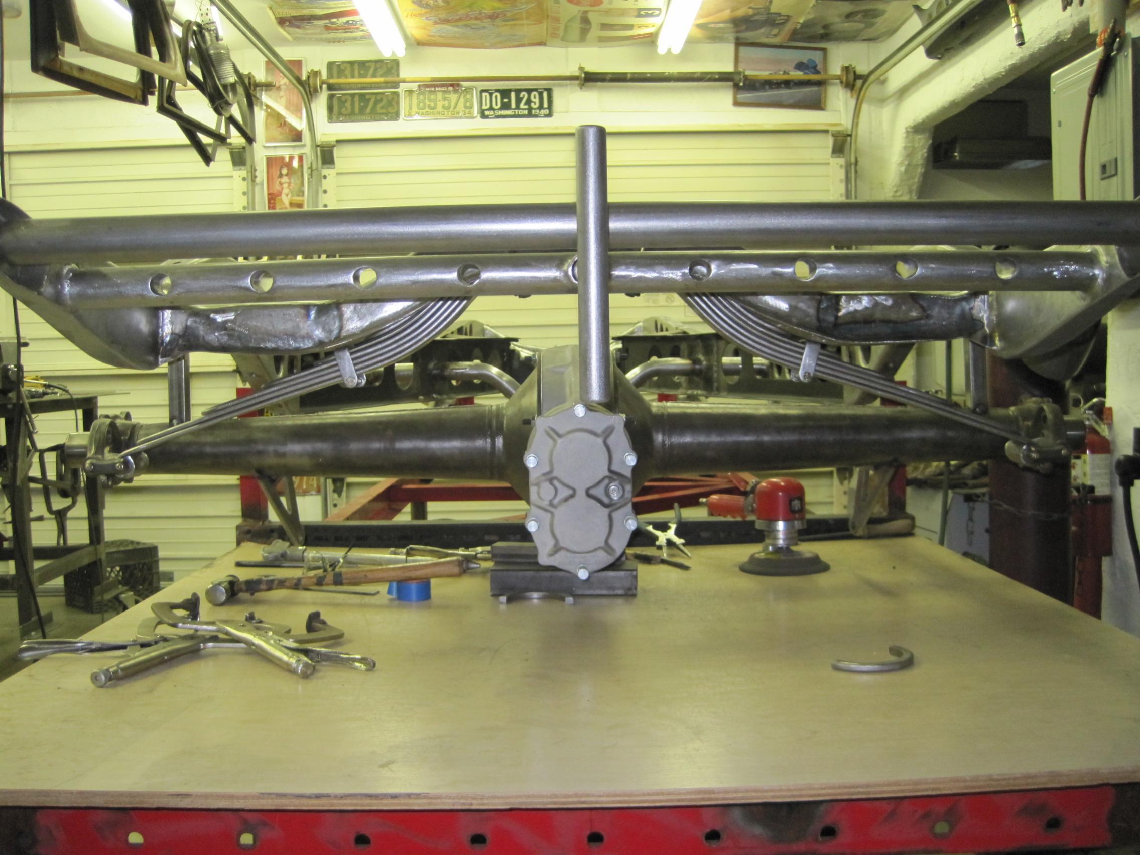

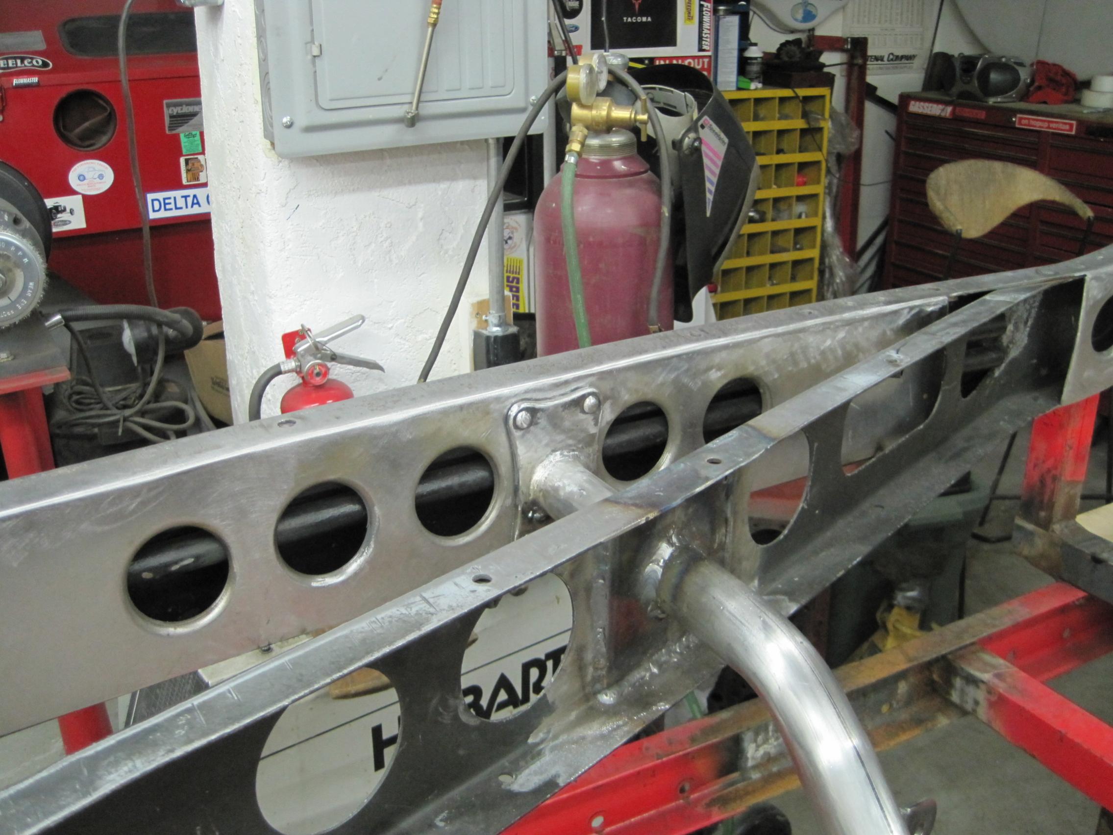

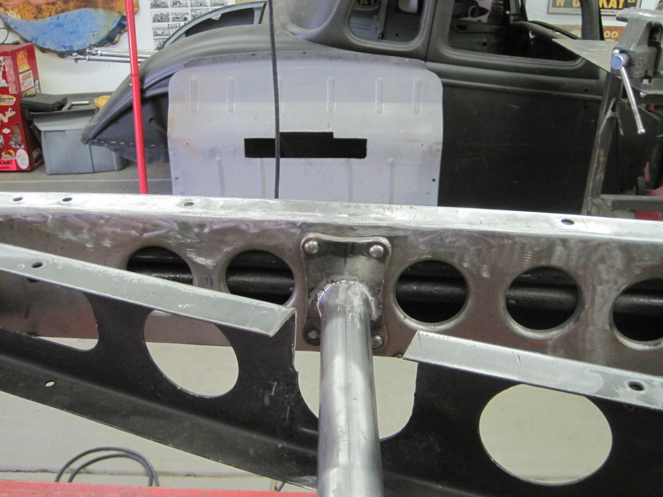

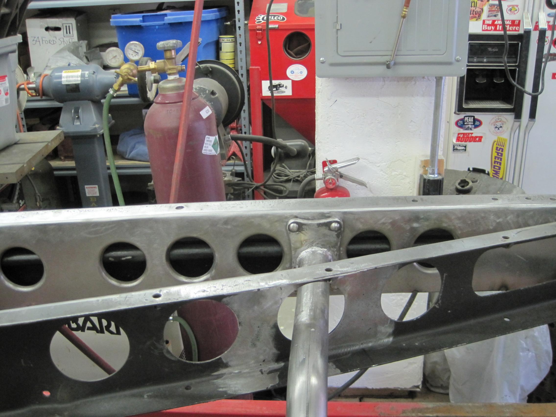

    I got a little done this weekend. Got the rest of the boxing plates put in and added the front mount bar for the Kiwi Konnection ladder bars. Tacked the rear brakects on the rear and will have them TIG welded later. I want them strong. The plates that look like they are riveted onto the boxing plates are actually welded. Rivets are Allen head bolts welded in and made to look like rivets. I will be working on getting the frontend hairpin mounts in this next week. Thanks for looking.

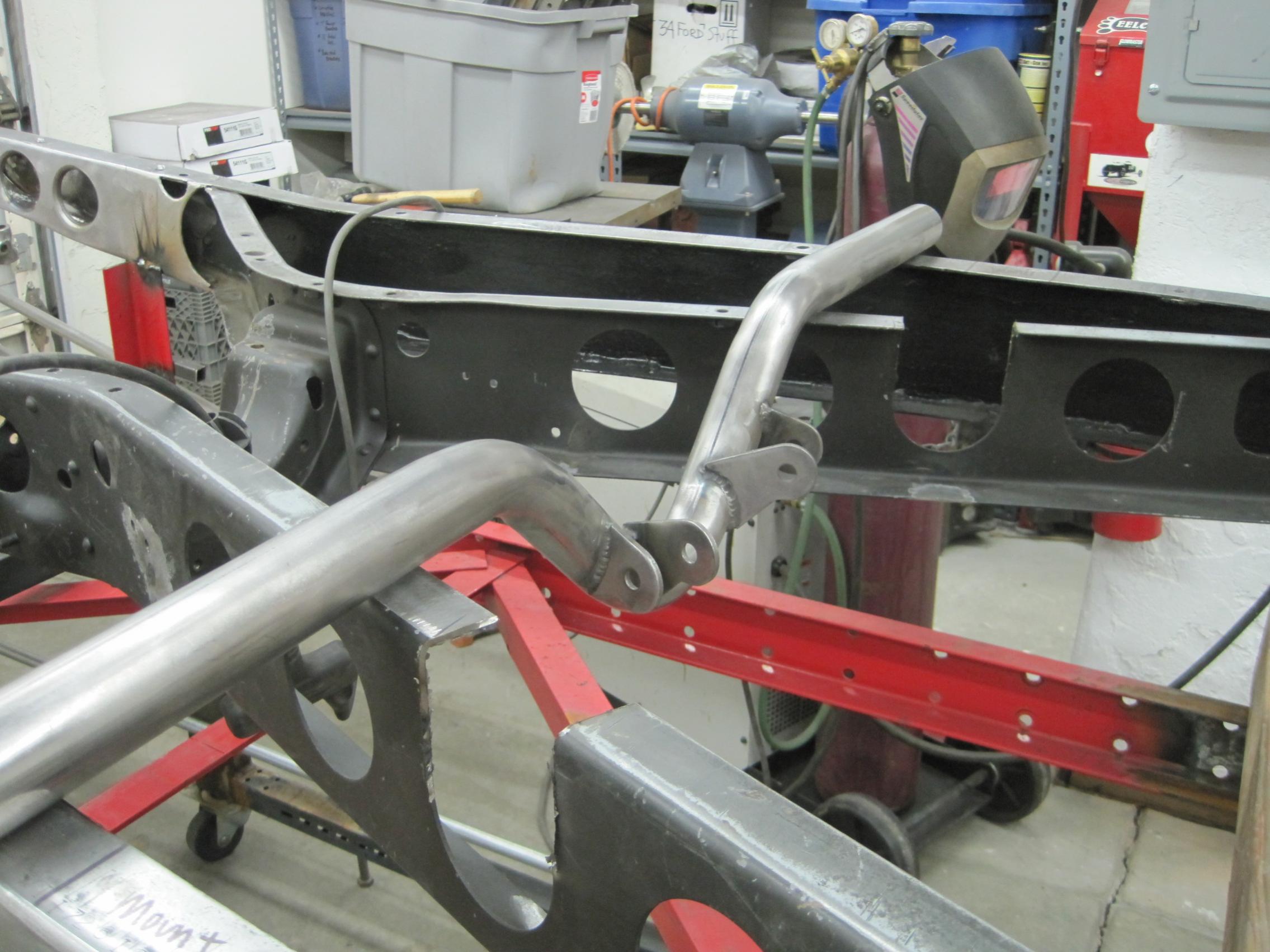

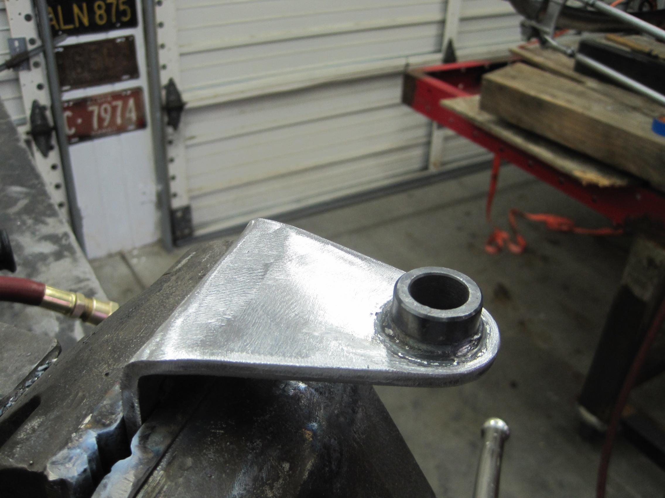

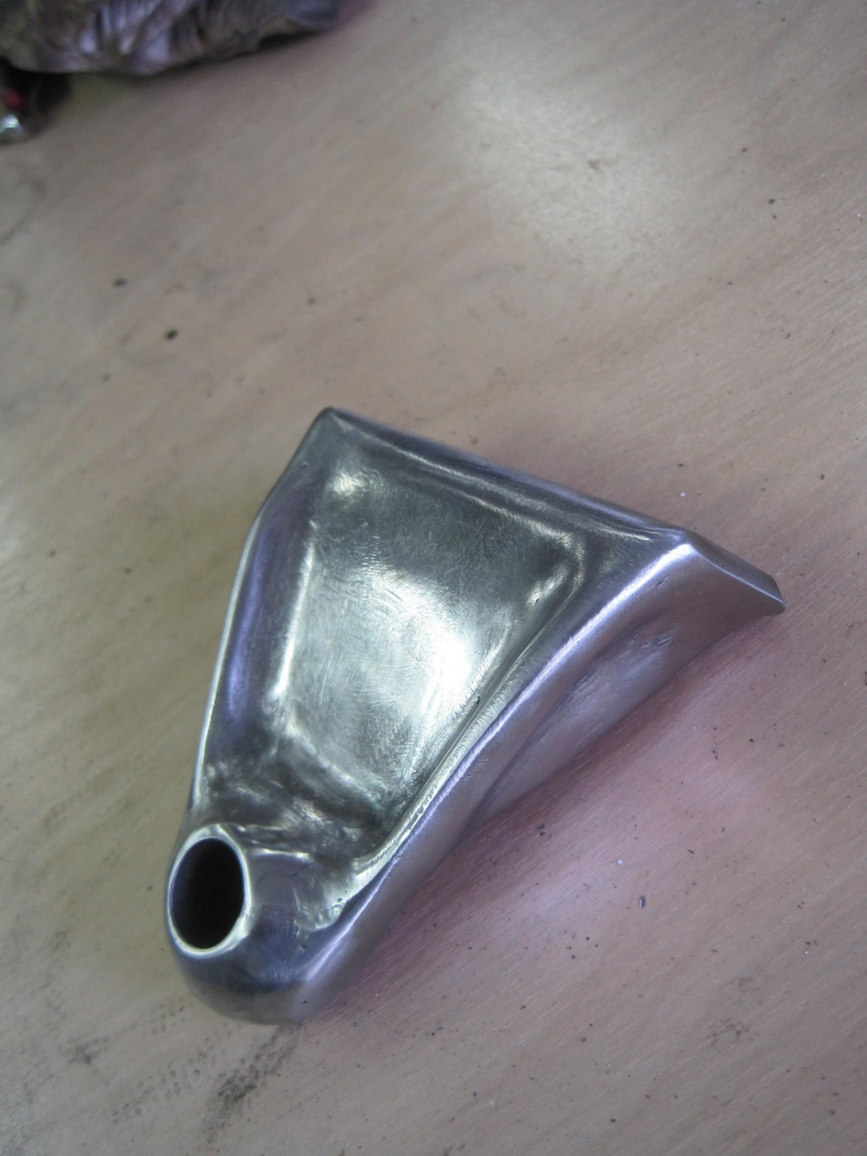

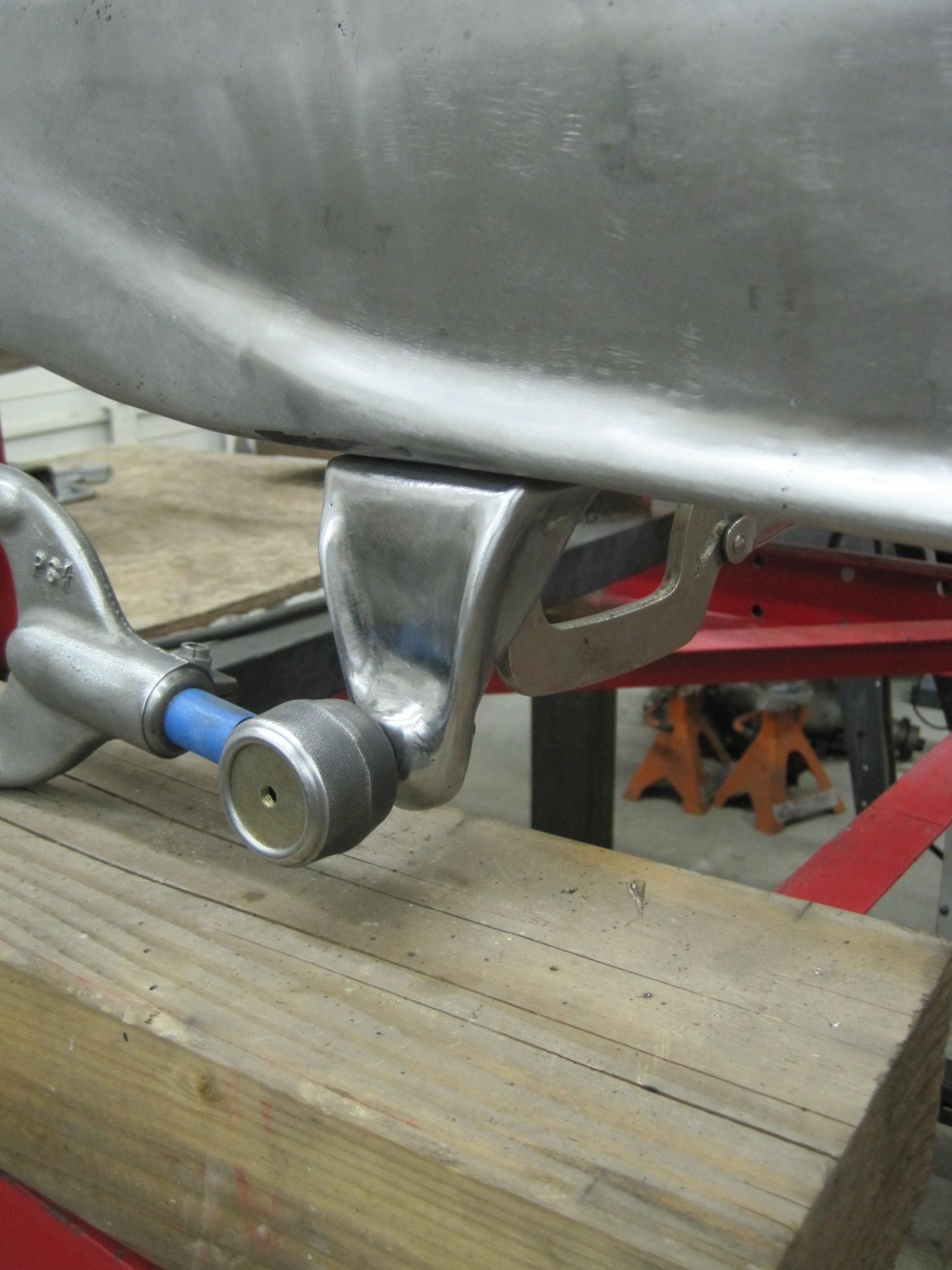

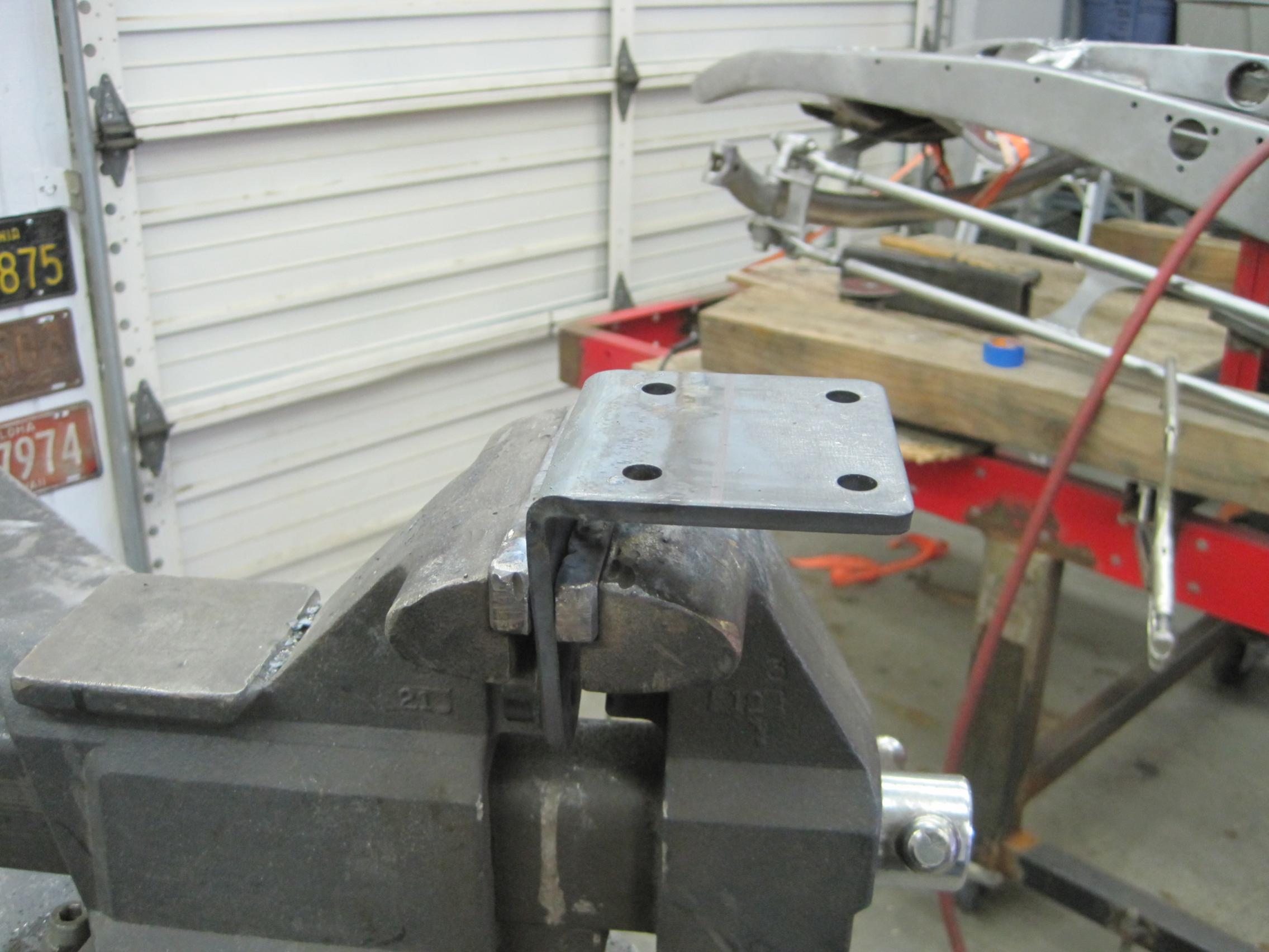

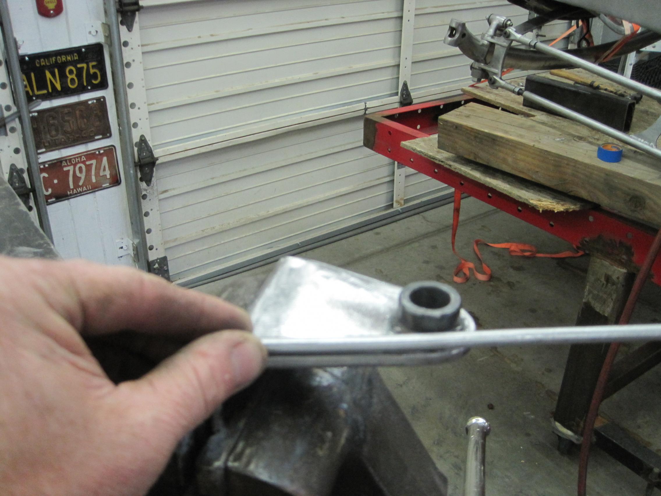

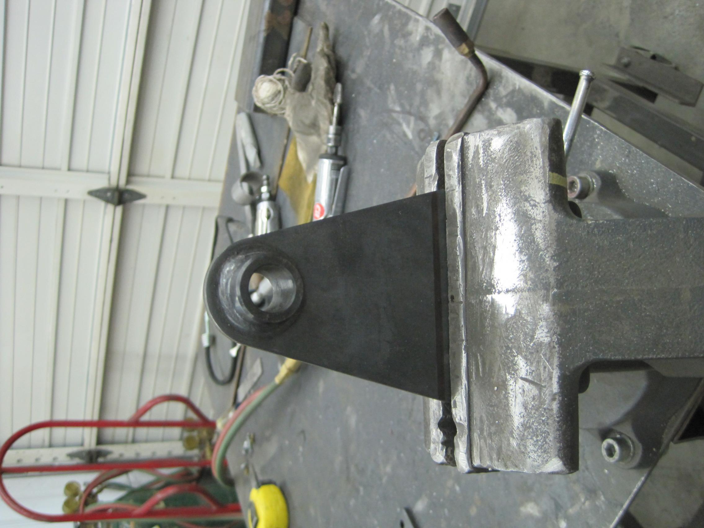

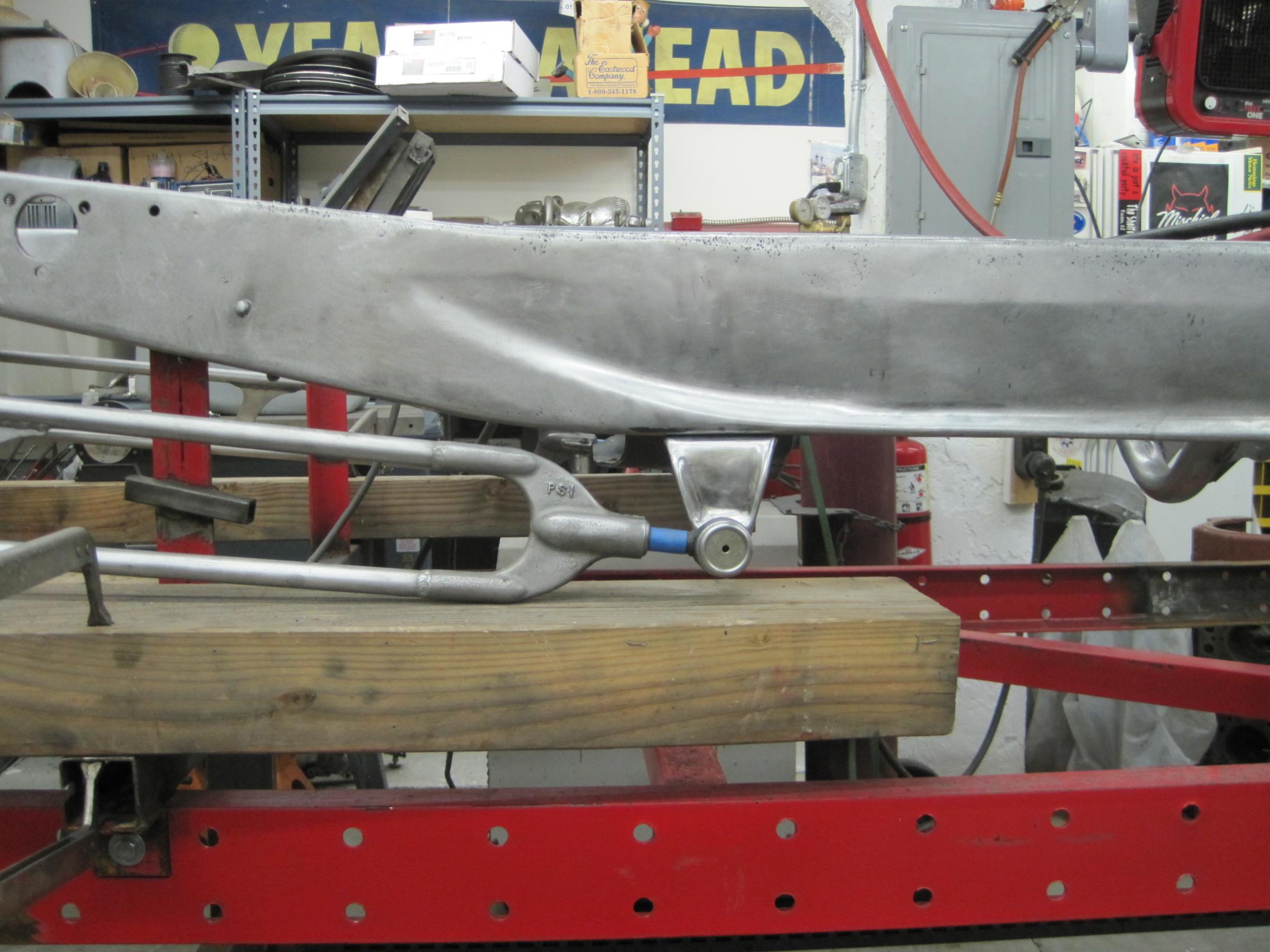

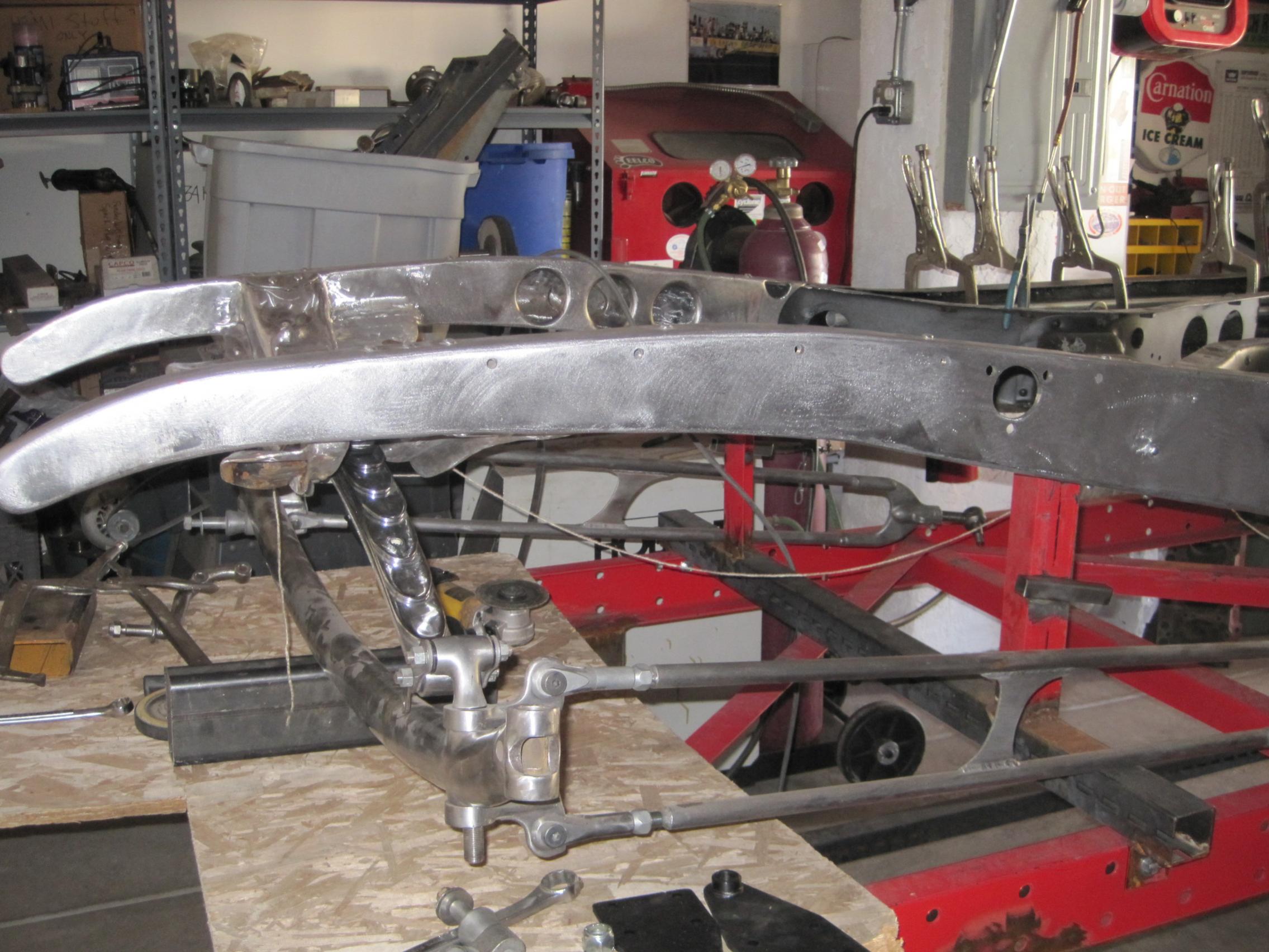

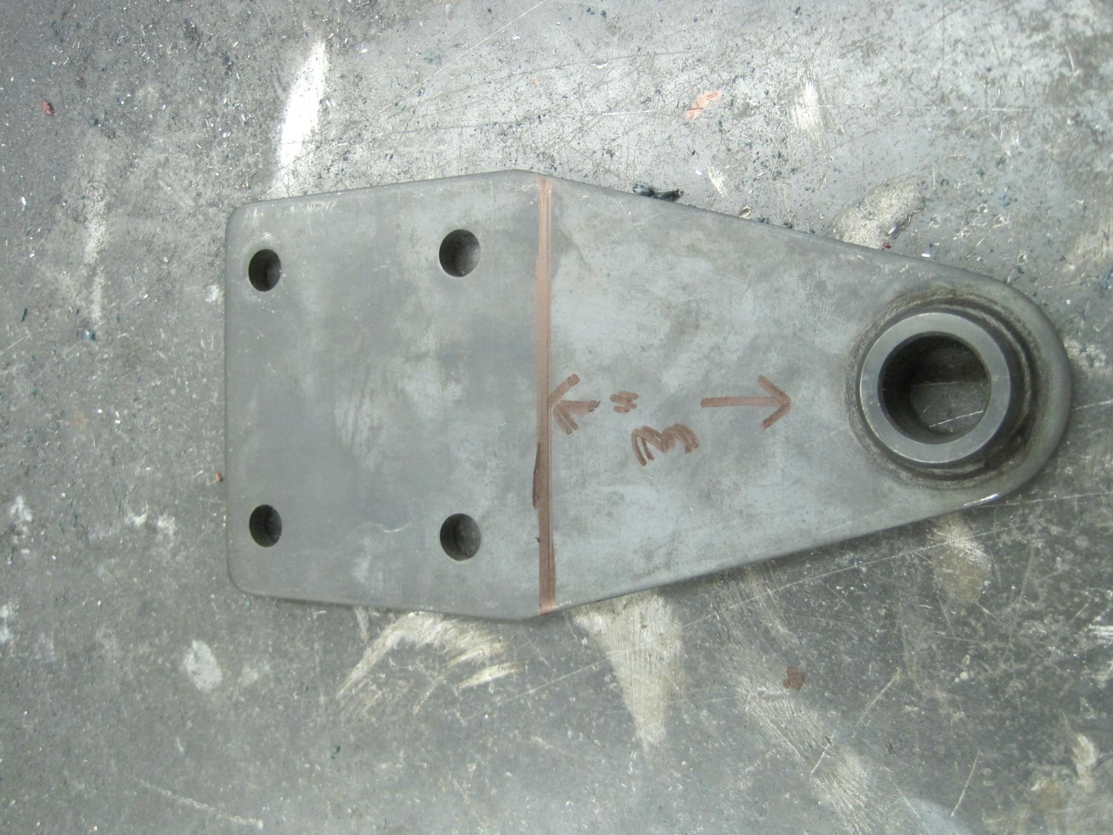

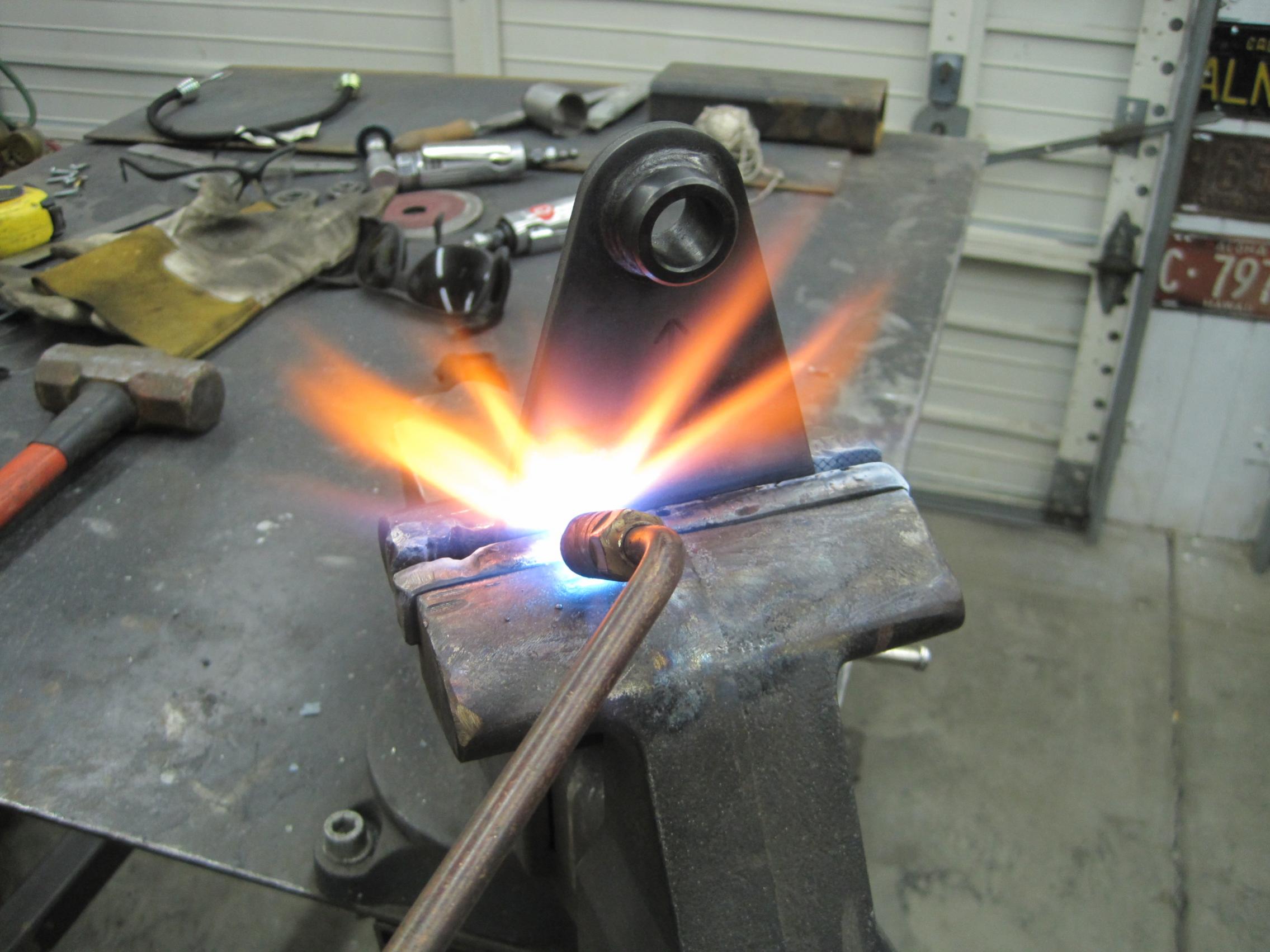

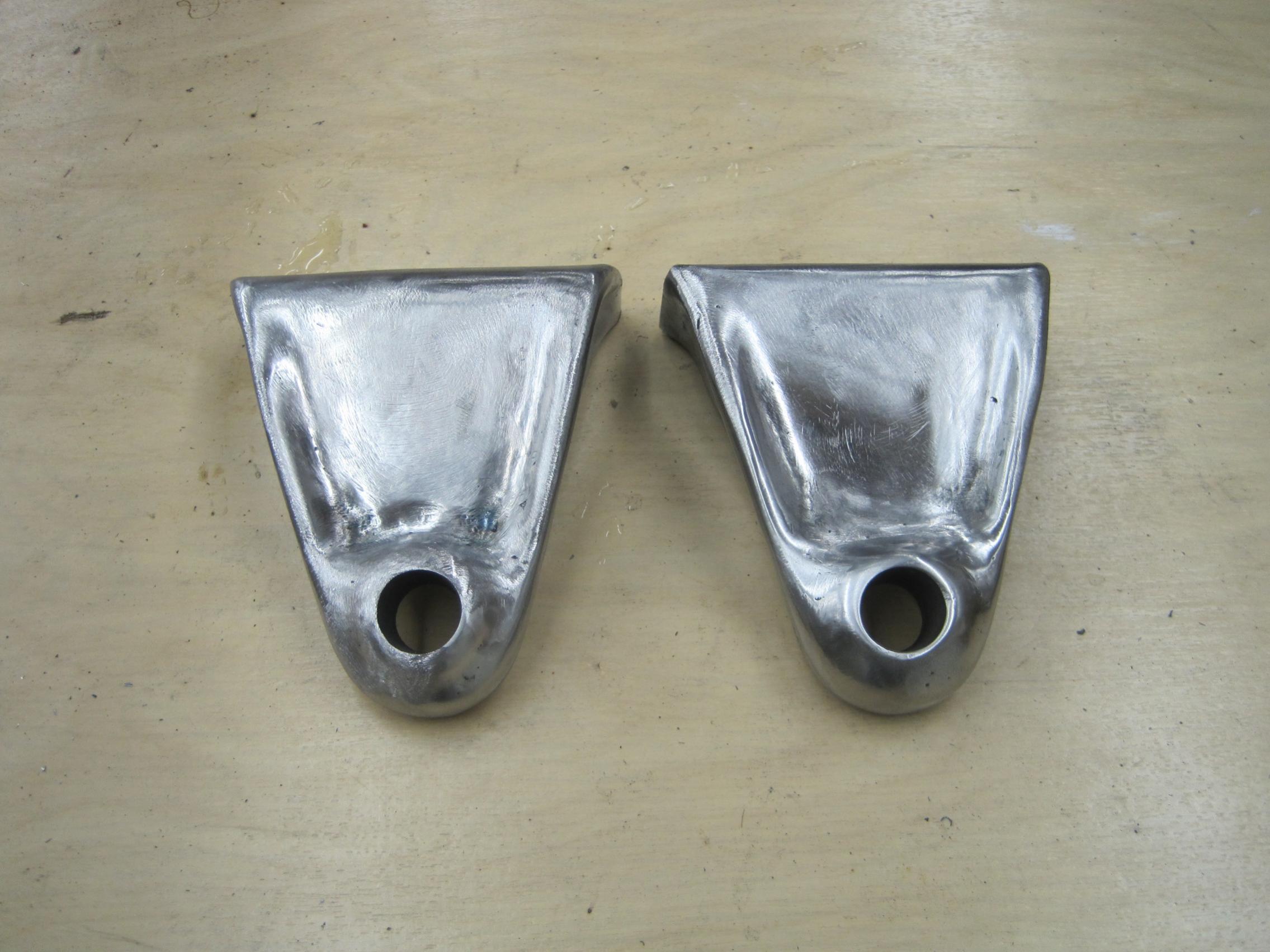

    Small Update: Worked on the front hairpin mounts this weekend. Home duties kept me from getting more done. I had bought some mounting brackets from Speedway Motors awhile back. I went round and round about how I would use them, I think they look really flimsy if just welded on as is so I decided to modify them to my liking. I did something similar on my rpu but decided to make these a little different. Pictures will tell the story on the modifications that were made. I decided that 3 inches would be about right after mocking up the frontend and taking out all the leaves except the main. I compressed the front axle with a strap and eyeballed it for a while. I will make adjustments to the front spring as needed after I get it down on the floor. Here are my pictures.

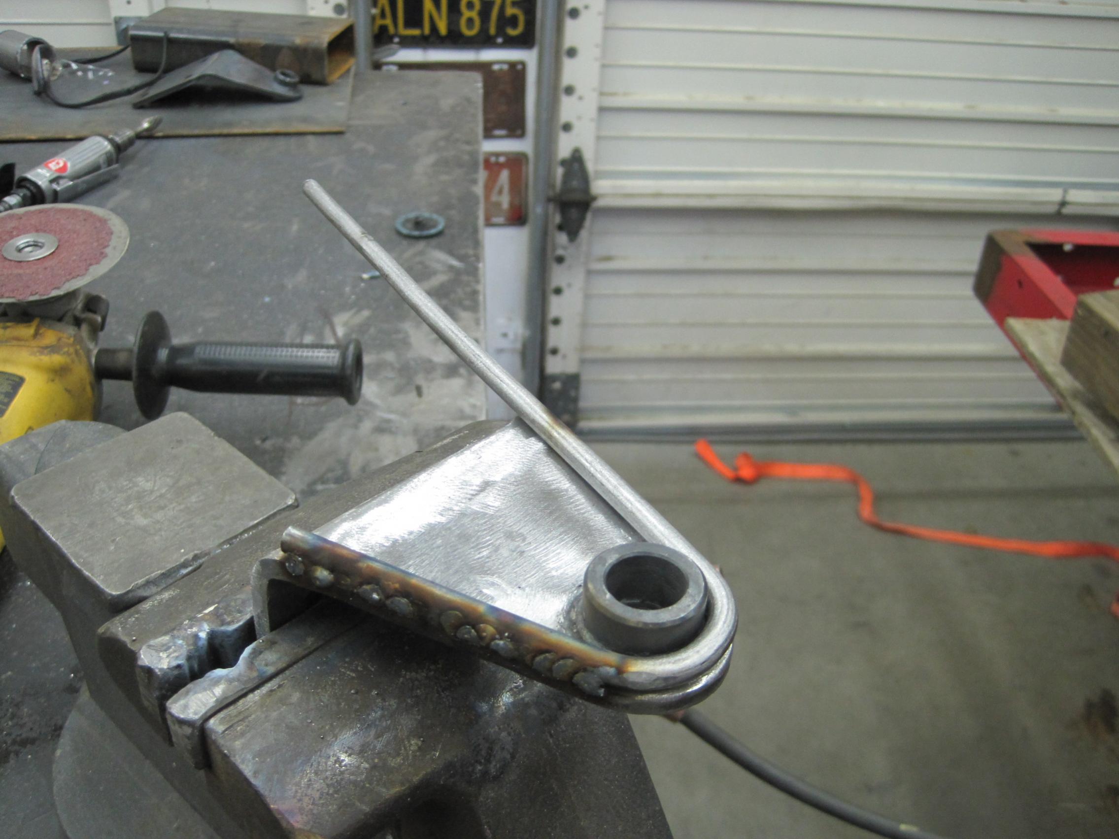

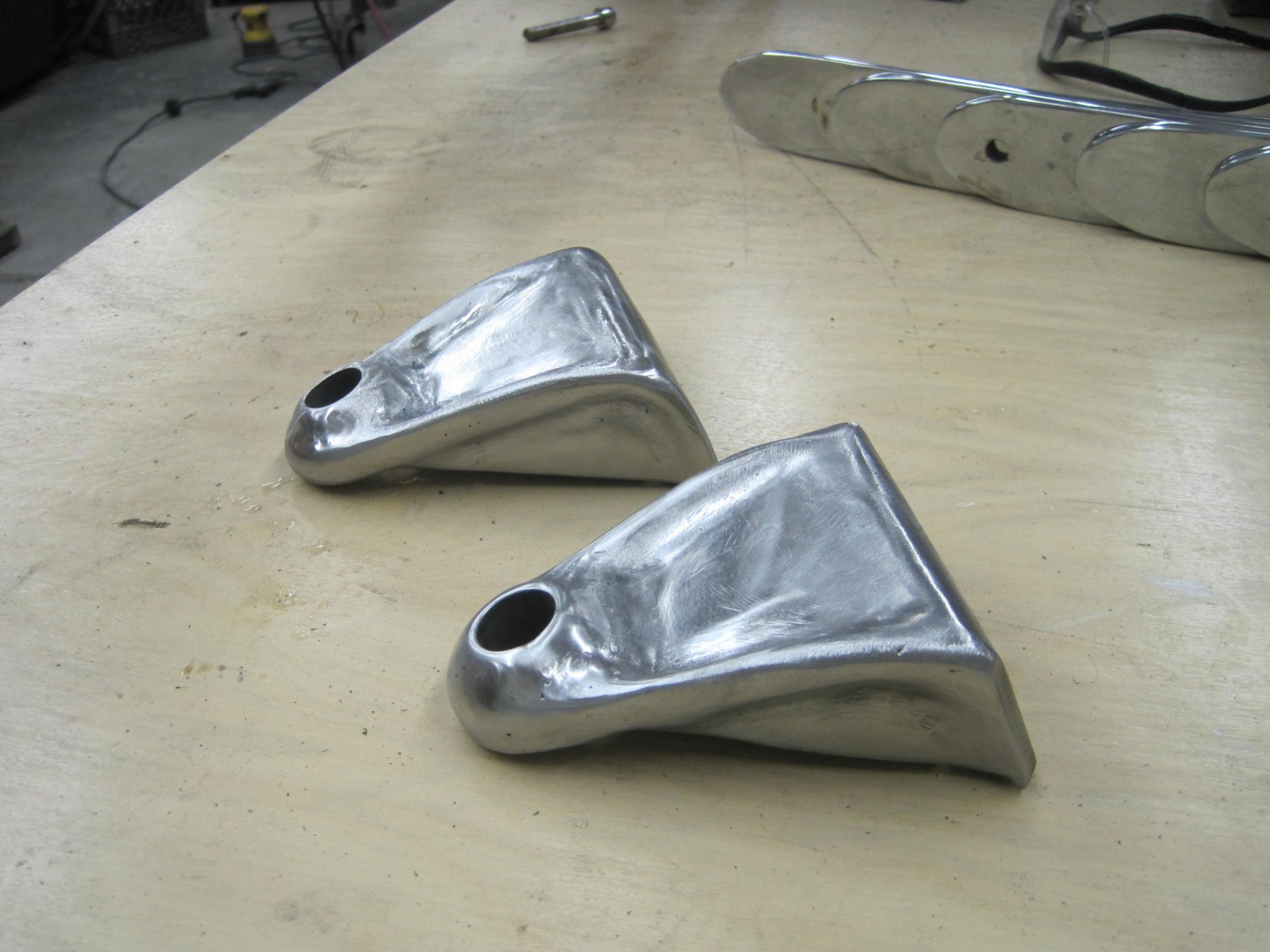

    I used 1/4 rod to make a piece to go around the perimeter of the bracket. I want these pieces to look like they are cast similar to the PSI hairpins and batwings. Here are some more pics of my progress. I am pretty happy with the way they turned out. A little filler and they will be good to go. Don't pay attention to the angle of the hairpin in one of the photo's. It will be right when I get all the leaves back in the front spring.
