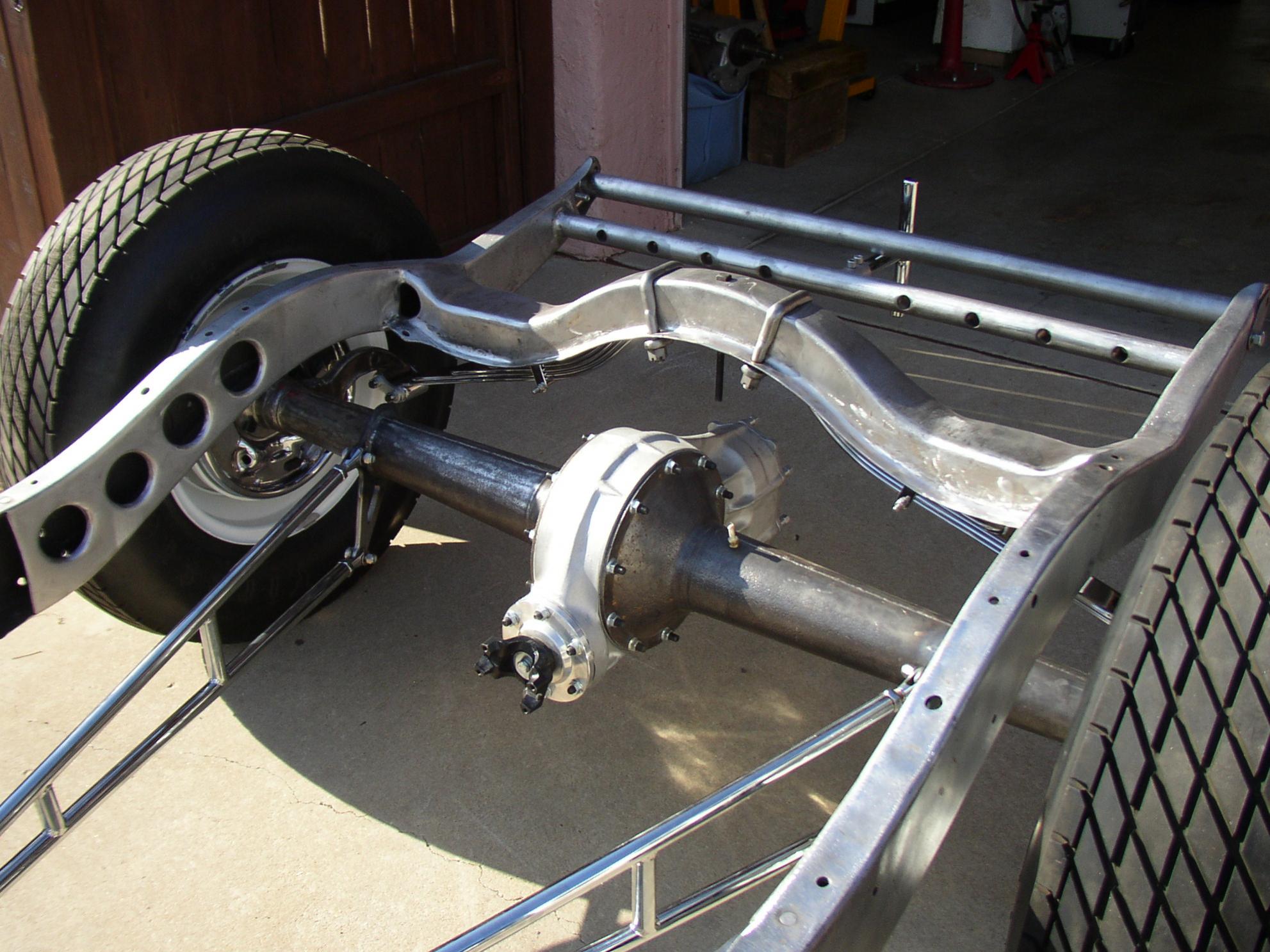

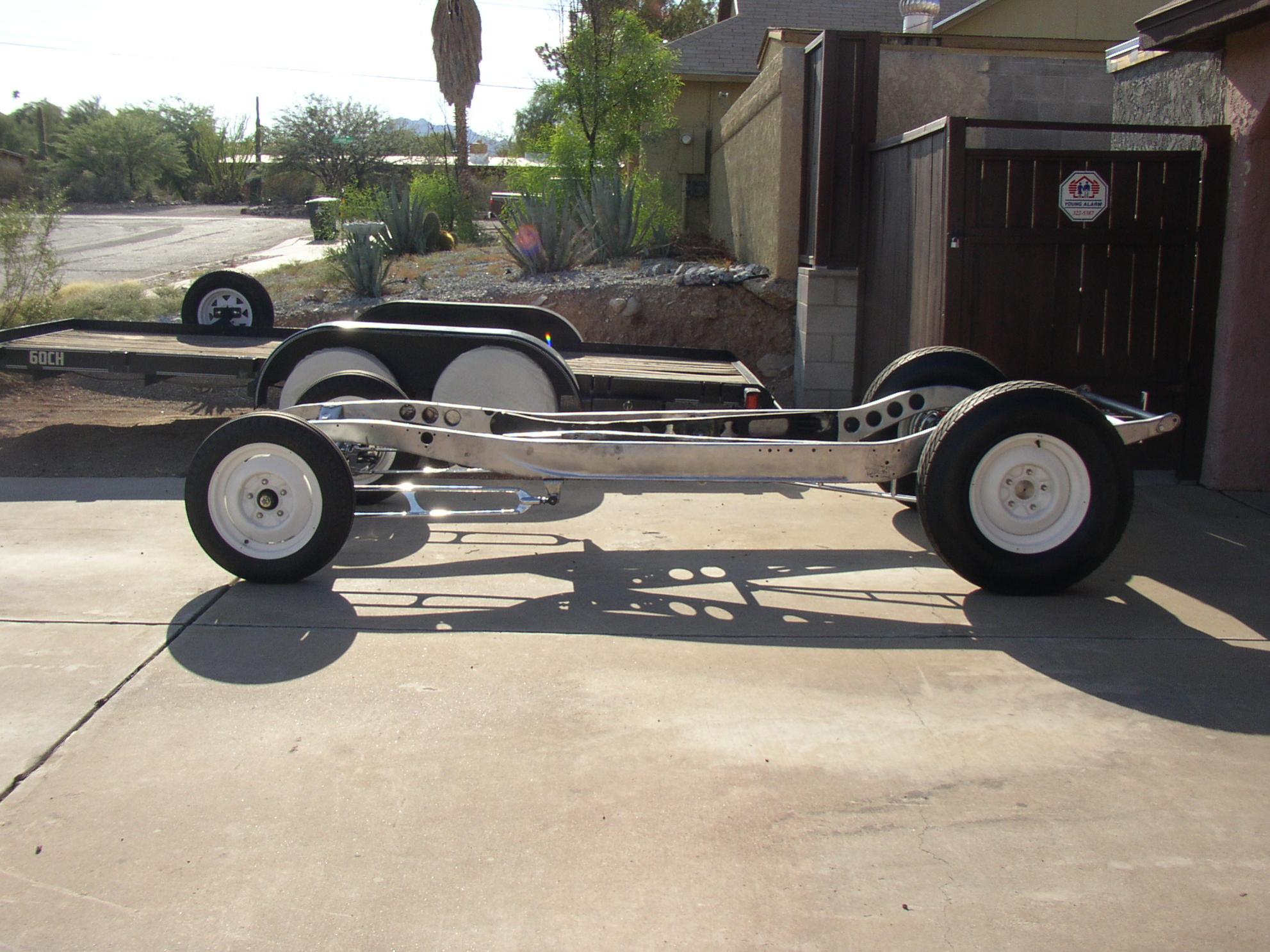

    Got back to business this week. Picked up the quickie from my buddy who delivered it from Bonneville to Phoenix. Thanks Rory!(Sinister Speed here on the hamb) Got the frame at least to roller stage today with help of a hotrod friend here in town(Thanks Kirk Ward). Kirk has been a good friend and has helped me out a lot and I really appreciate it.
    I do have a problem that maybe someone can help out with.

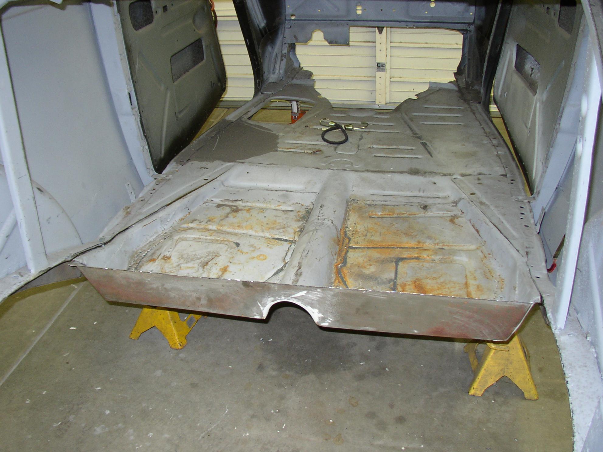

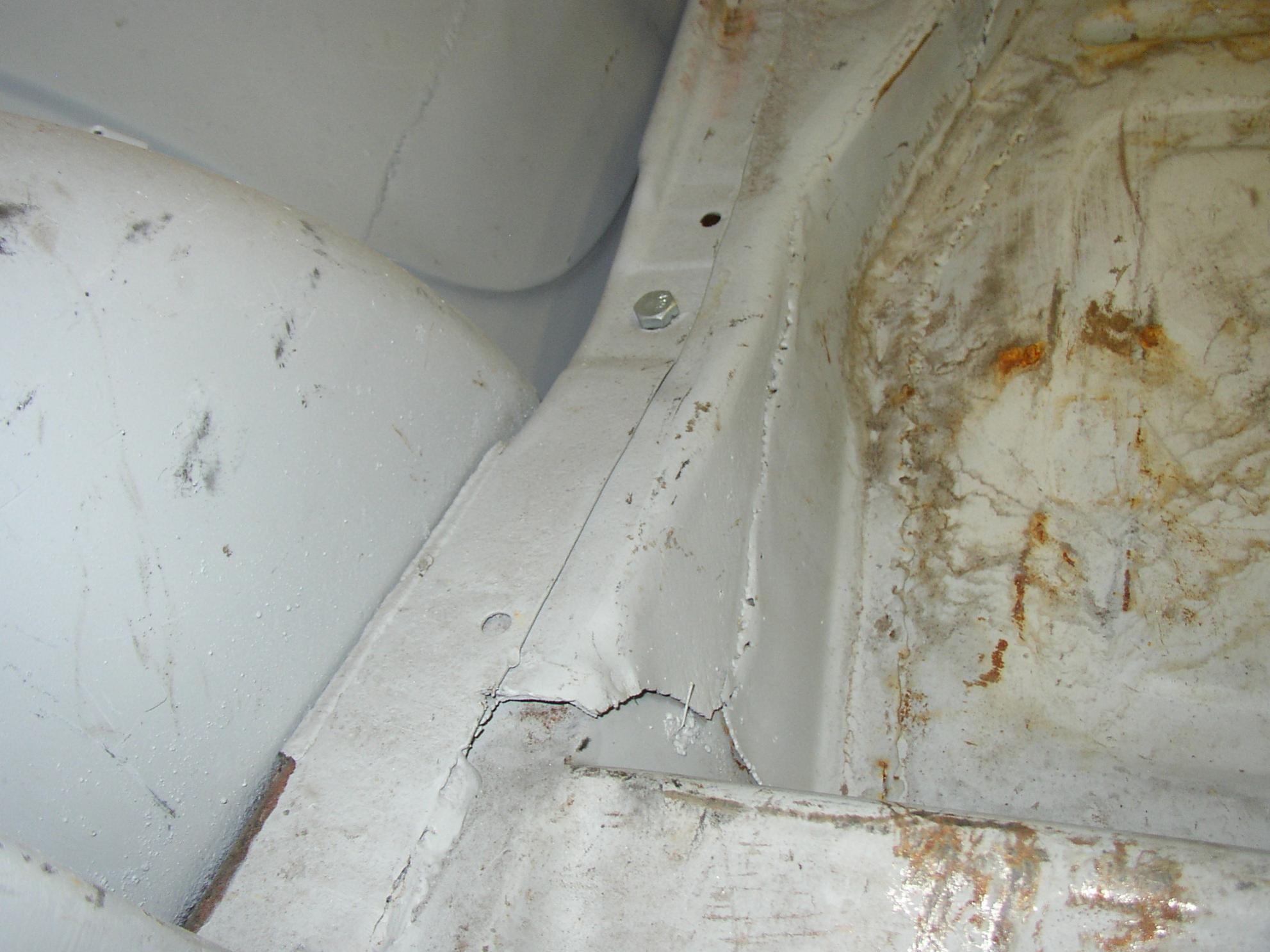

    I seem to have too much camber.(about 4-5 degrees) Are 37-41 spindles all the same? Maybe my axle is bent? Wheels are kinda ******ed. I already chromed the front axles so I am kinda bummed if I need to have it straightened. I should have had it checked out. Do I need 37 spindles to match my V-8 60 axles? Any help in this area would be great. This is the first time with this axle setup. After I got it rolling today I started to tackle the back floorpan area. It had been poorly repaired sometime ages ago by some would be restorer with no metal working skills. Cut out the majority of it tonight but will finish it tomorrow. I have a new rear floorpan section from SAR and will fab up the remainder. It looks like the previous owner used a sedan rear floorpan area .I'm not sure. Here are a pictures of my day in no particular order. Thanks for looking.

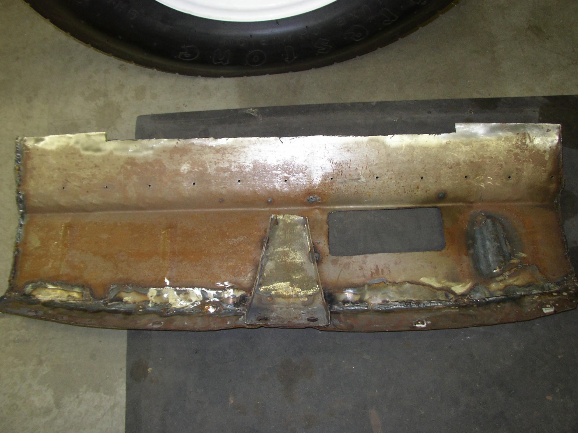

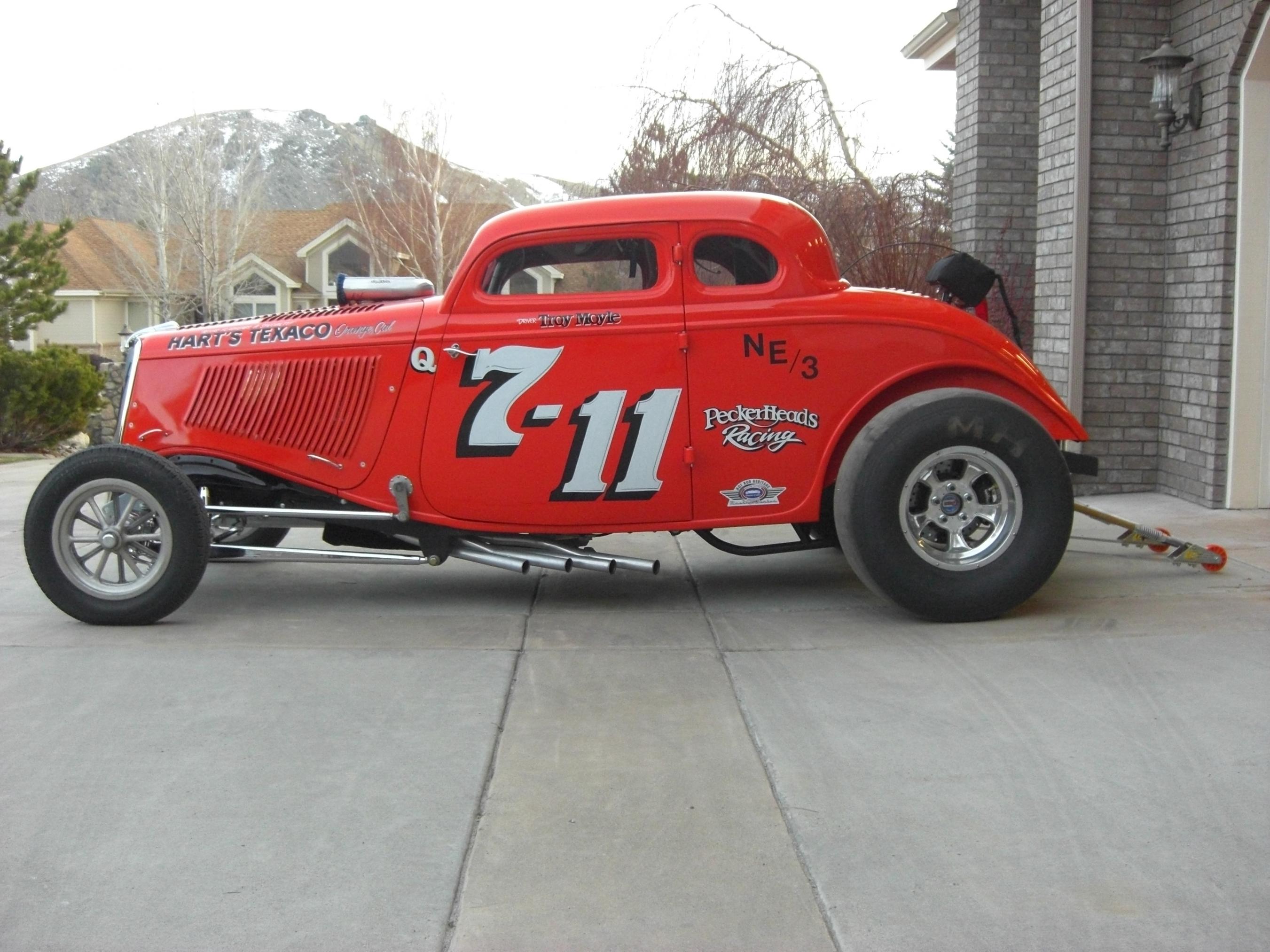

    More floopan pics. Areas will be cut out and replaced that are bad. Pic of 7-11 coupe is the attidude I am going for. That is the reason the ch***is looks high. When the 371 Olds J-2 gets plugged in it will come down a lot I'm sure. You can see in the last picture the horrible attempt to repair the back area. This is the piece I started cutting out turned over to show the carnage.

    Rob, I hope you got your truck squared around. I am going to chop the top exactly like the 7-11 coupe I posted a pic of earlier. That is the perfect chop in my opinion.

    Yes you do have too much negative camber, especially on that one wheel. I'd say the axle is bent. Everybody says big truck alignment places can bend them, so take it there and hope the chrome stays put.
    I think I've read that a half degree positive camber is best.

    Thanks, That's the advice that I have been looking for. I might just have to eat the chroming job this time. That was the conclusion I came up with too. P*** side looks worse than the drivers side. Note to self: Never chrome or use an axle without getting it checked out first!. It looked straight.
