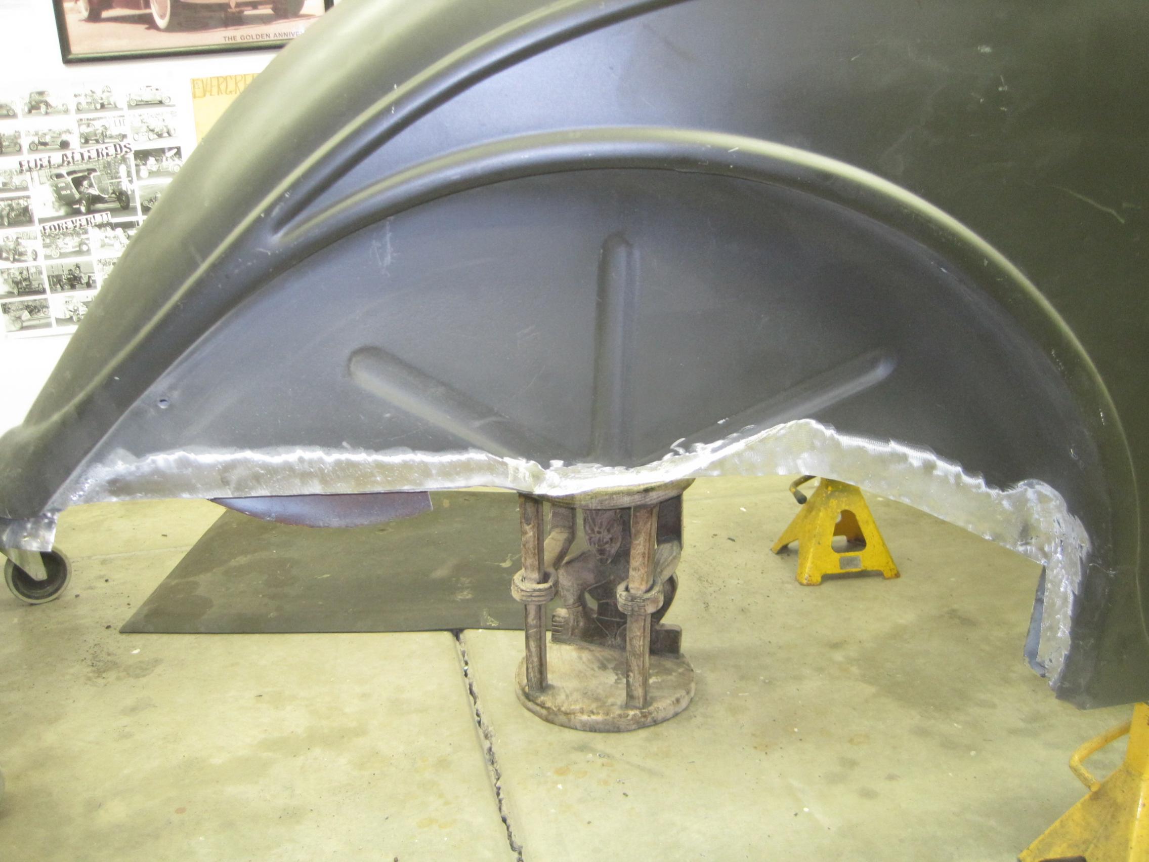

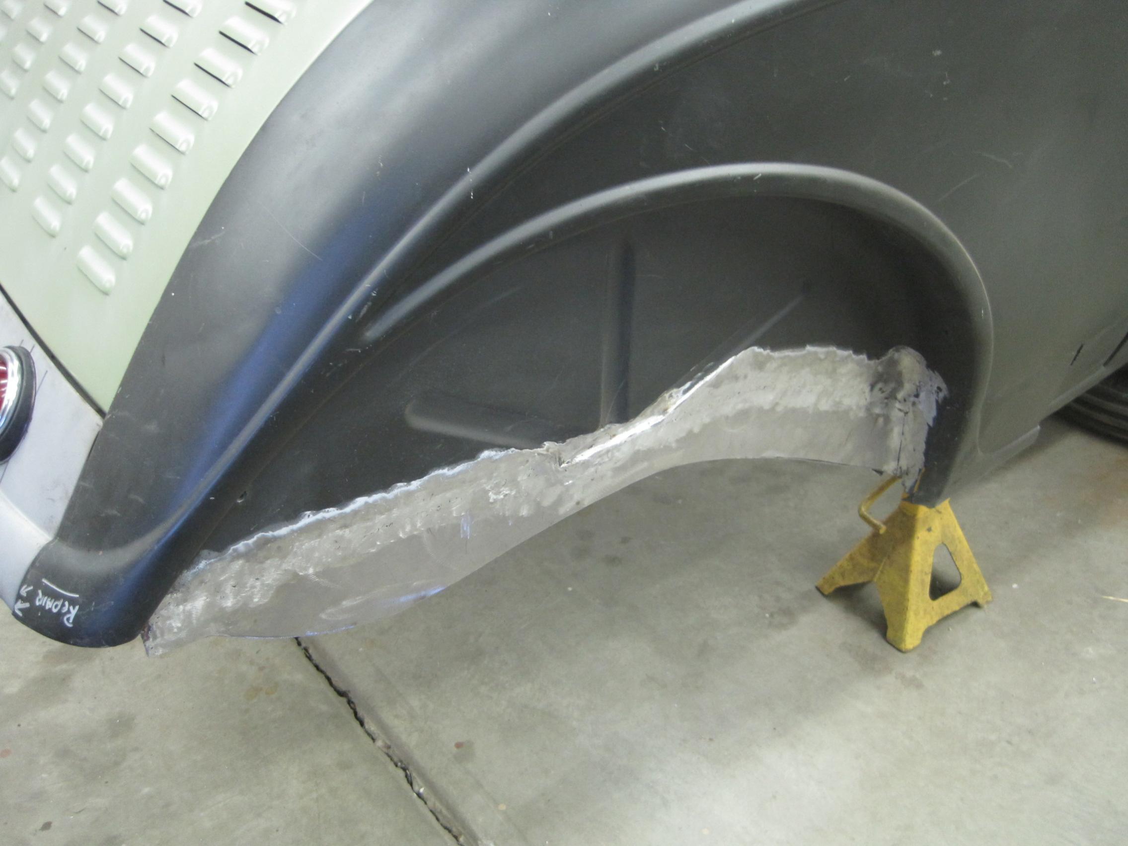

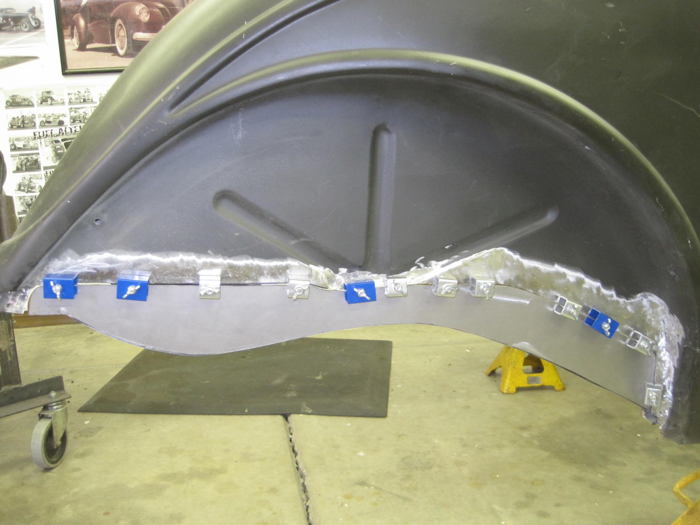

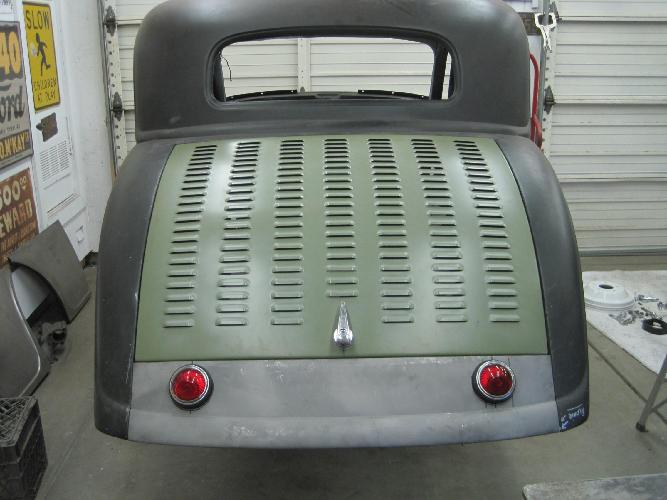

    Worked on the car a little bit this weekend. Been busy the last couple of months doing honey-do's around the place. Gotta keep my wife happy.
    Worked on the decklid fitment and lower panels under decklid. Mounted my 37 Ford decklid handle on the SAR decklid with 152 louvers. License plate will mount on spreader bar under the decklid handle. Chrome T pushbar will help fill out this area.
    Mounted my taillights just because I wanted to see what they were going to look like on the car. They are 41 Willys units. I love them. They look so *****in lit up at night. Never seen them on any other hotrod which kinda turns me on.
    Patched wheelwell are on p***enger side. Need to do the drivers next then I can get the new subrails in the back made and begin to think about mouting the body down for a mockup fit. I have really been lollygagging on this thing and need to pick up the pace. I have been doing a lot of small stuff that doesn't need to be mentioned.
    Got my new quarter panels for both sides from Donnie Smart. Quality stuff for sure. I highly recommend his products. They look perfect. I'll wait to fit those when I have the body mounted solid to the frame. Here are a few photo's of the today. Nothing earthshaking but it was something anyways.

    Dale, looks great. Why did I think it was chopped?

    i like the louvered deck lid for sure

    You would not want them. I am just replacing the ****py repairs from the past owners. I do have some generic 1/4 patches that I will not be using that you are welcome to purchase at a very reasonable price. They are not tall enough for me to repair my mess. I needed bigger ones. Donnie Smart's 1/4 patches are 20'' tall. I wont need all of that but I will use about 12" of them.

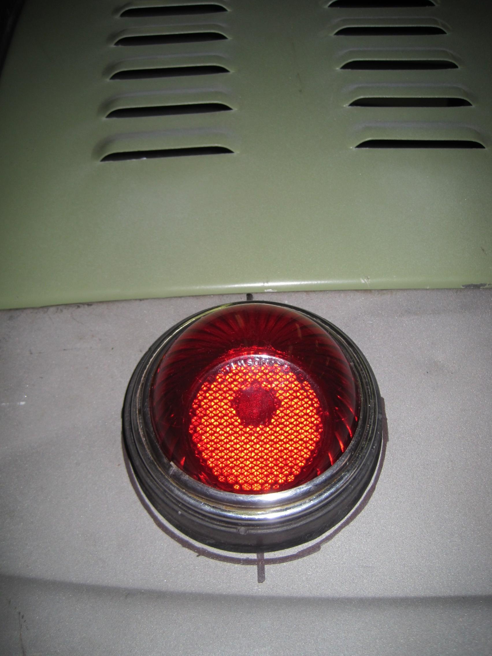

    Chris, The taillights look better in person than in the pics. I kinda lost the detail of the gl*** in those two pics. Maybe I'll take another one tomorrow of them a little closer. I am happy with the placement. I did not want to line them up with the louvers. It looked weird under either one of the outside rows. When the plate and pushbar get lined up it will look downtown. Let me know how your roadster shipping is going. Dale

    Here is a couple of close up pics of the Willys taillight. The rubber mounting pad puts the housing at a good angle. These gl*** lenses really light up nicely .
