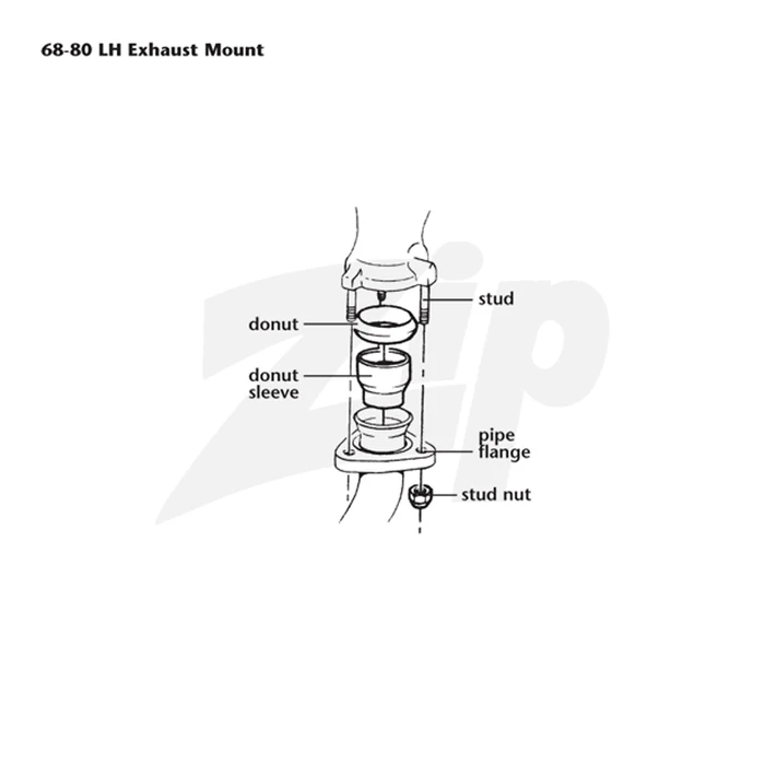

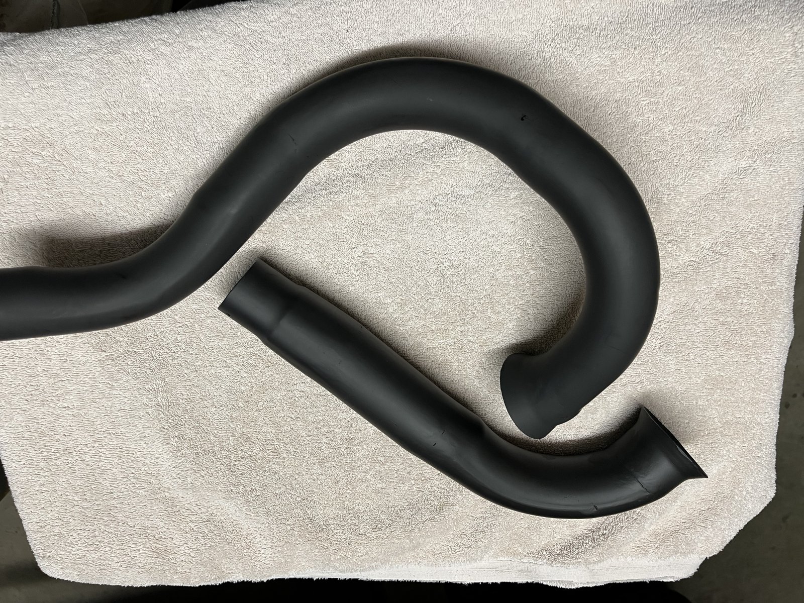

    Did you have a sleeve inside your doughnut gasket?
  4. TomT
    Joined: Dec 11, 2003
    Posts: 4,635
    TomT
    All the sweeter when it’s finally on the road!
  5. hotrodA
    Joined: Sep 12, 2002
    Posts: 7,332
    hotrodA
    @saltflats
    No. Is that recommended? Does it improve the seal? Who has them?
  6. saltflats
    Joined: Aug 14, 2007
    Posts: 13,535
    saltflats
    from Missouri
    Yes it will help support the doughnut. Walker used to sell them.
  7. hotrodA
    Posts: 7,332
    hotrodA
    Thanks for the tip. I’ll check it out.

  10. Tim
    Joined: Mar 2, 2001
    Posts: 20,148
    Tim
    from KCMO
    Looks like what I have on mine.
    saltflats likes this.
  11. saltflats
    Posts: 13,535
    saltflats
    from Missouri
    Yes that is it.
    hotrodA likes this.

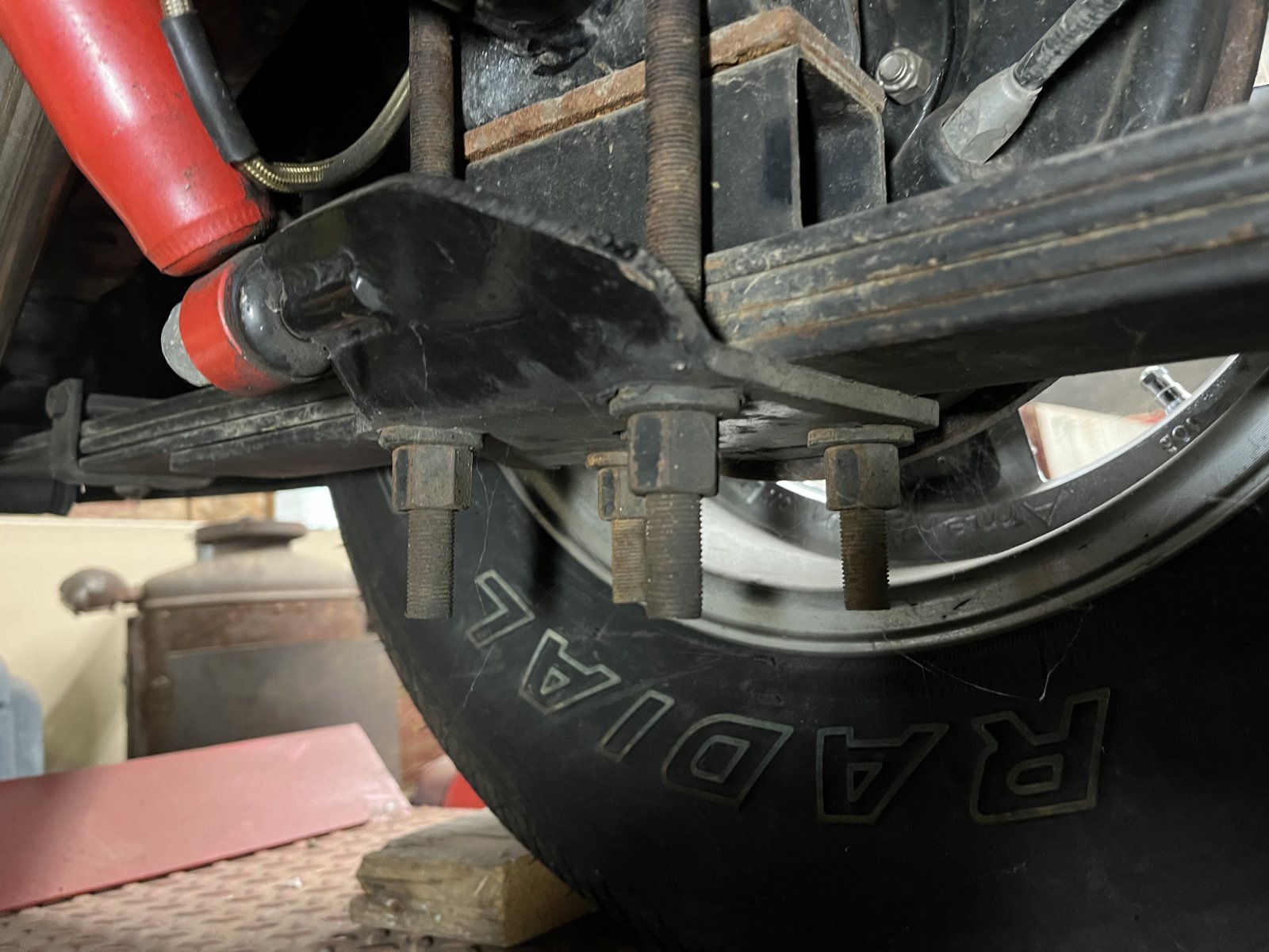

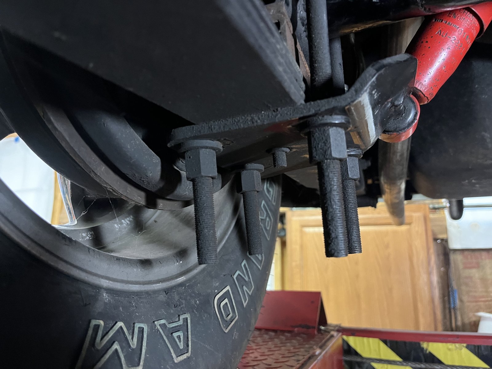

    While putting the driveshaft back in I saw something that needs correcting, but I had forgotten about.
    Maybe dodge a problem down the road.
    Think these U-bolts are way too long?:rolleyes:
    One side is longer than the other! Why?
    Because there are two different thickness lowering blocks!
    I’m figuring rear frame is tweaked:eek:
    Car is level so it’s going to stay. Just trim them off with the Sawzall.
    Right side
    Left side
  15. TomT
    Posts: 4,635
    TomT
    You are using the same rear spring as I am. So far with the new air shocks the ride us great- looking good!
  16. hotrodA
    Posts: 7,332
    hotrodA
    @TomT
    No problem with the ride as long as I’ve had it.
    Those blocks should be the same, not an inch different in height.
    Something’s off with the frame.
  17. TomT
    Posts: 4,635
    TomT
    Are the u-bolts the same length? I know - silly question ……
  18. hotrodA
    Posts: 7,332
    hotrodA
    @TomT Yes, they are.
    Rear end of frame apparently has a twist, high on the left at the rear shackle. The 1” difference in the blocks levels the body off. It measures the same side to side.
    I was just concerned about a flat on the RR and those bolts hitting the pavement.
    T******* them down.

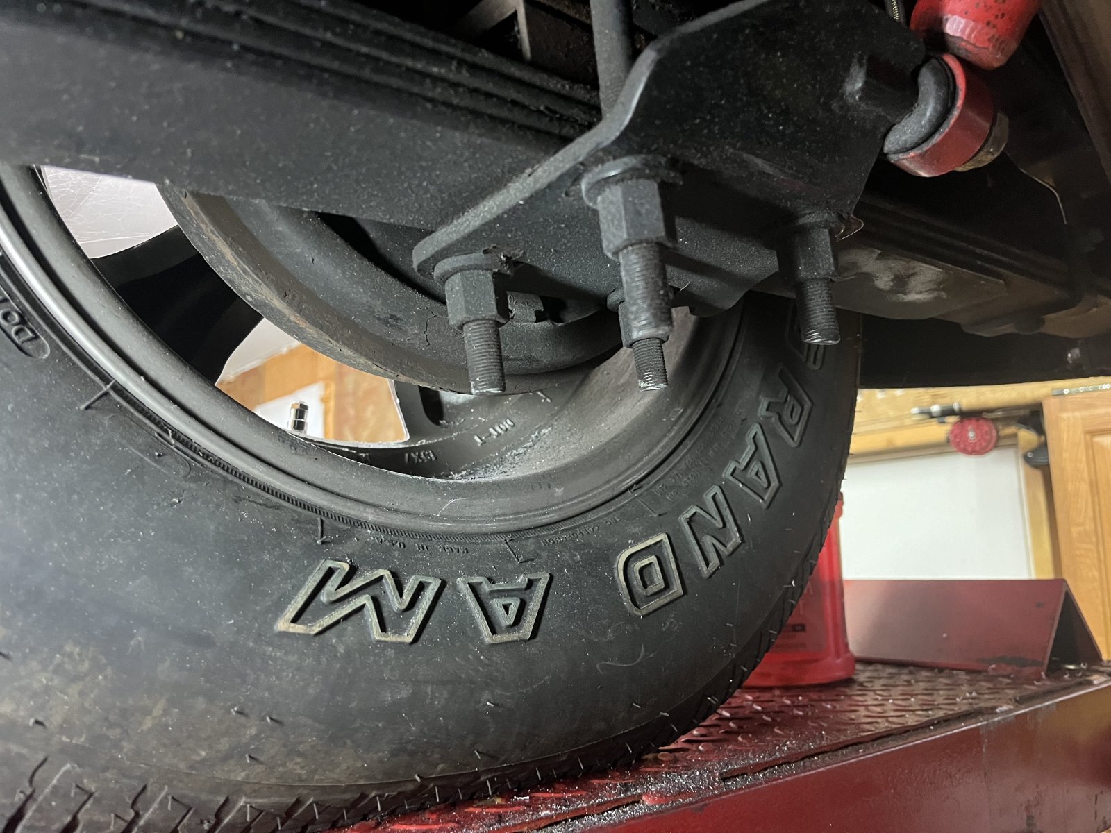

  19. hotrodA
    Posts: 7,332
    hotrodA
    Mo better!
    At least I can get a deep socket on them now.
    Bandit Billy likes this.

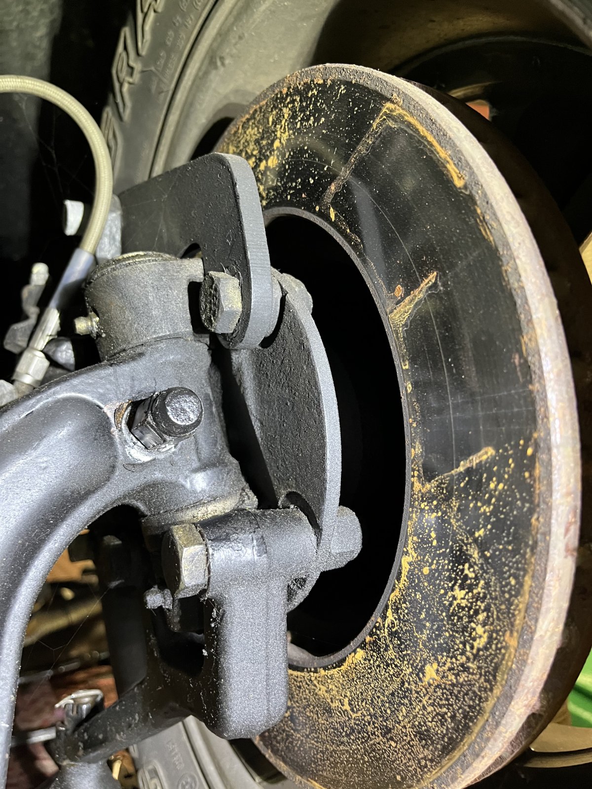

  20. Mart
    Posts: 5,002
    Mart
    --The lock stop is normally fitted at the rear of the axle. If you can't fit it at the rear because of the disc brake adaptor, and have to fit it at the front you might find the wheels will turn too far. You can fix it by using a bigger nut on the lockstop, (I have used a lugnut) or tacking a piece of metal to the spindle to contact the lock stop.
  21. hotrodA
    Posts: 7,332
    hotrodA
    Thanks! It’s a Ford stop nut, so I’ll try it first, and adjust from there. At least it’s easy to access.
    All that was on there was a hex nut. Found the rub spot on the p***enger inner fender panel.

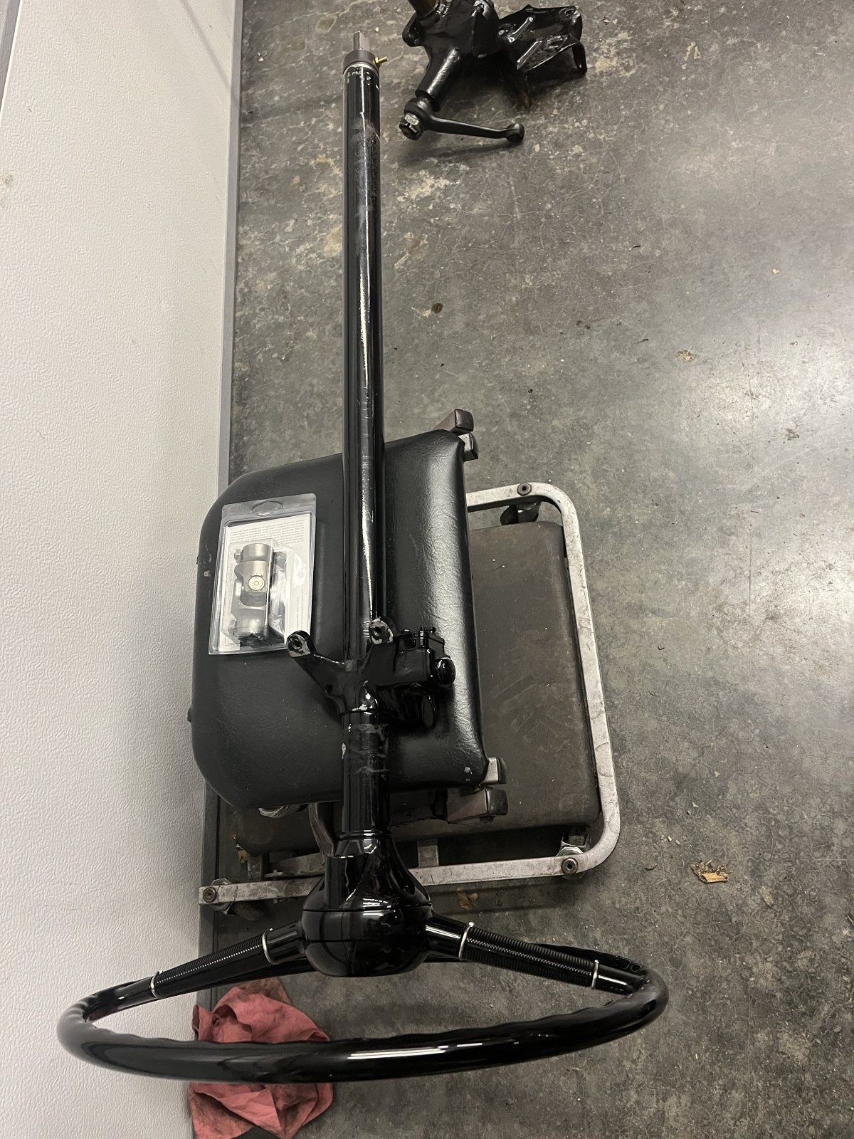

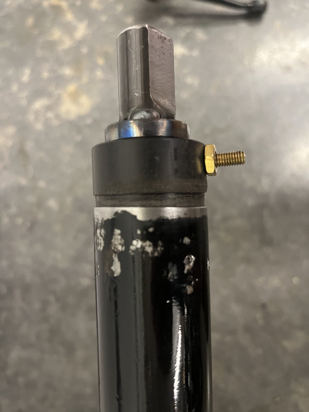

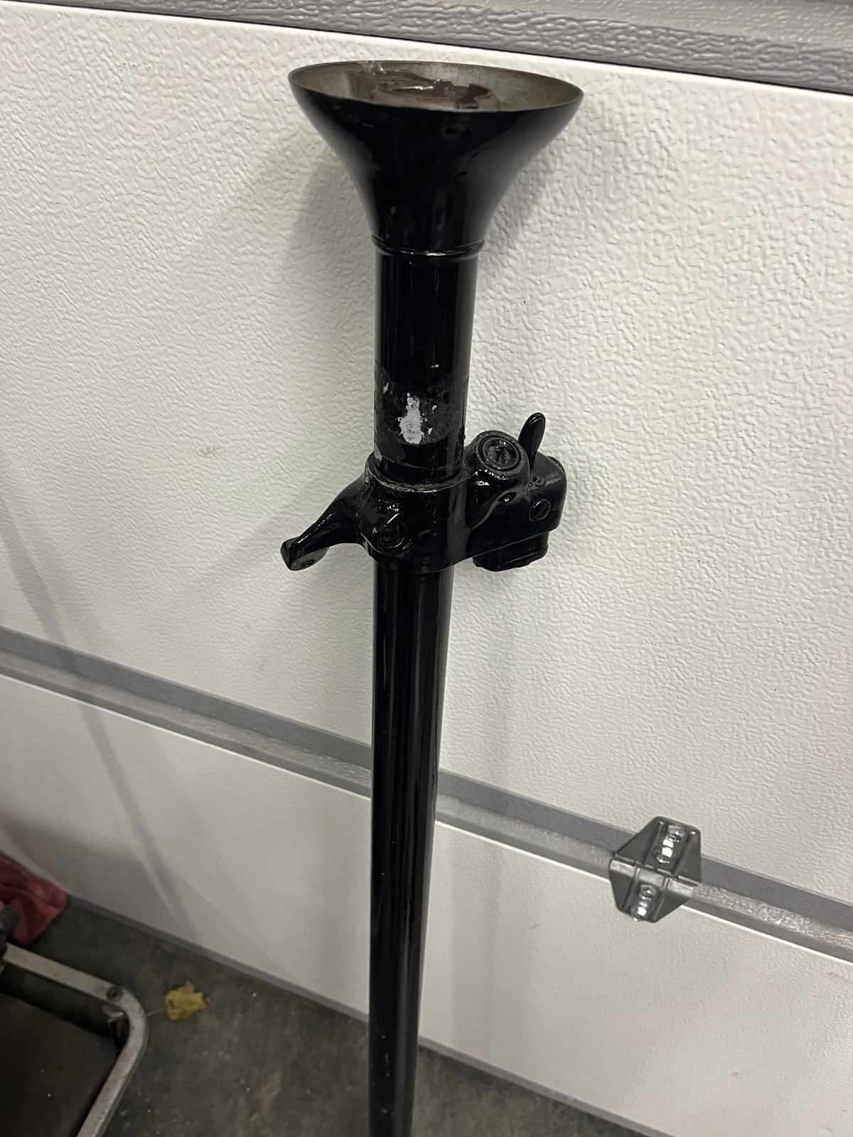

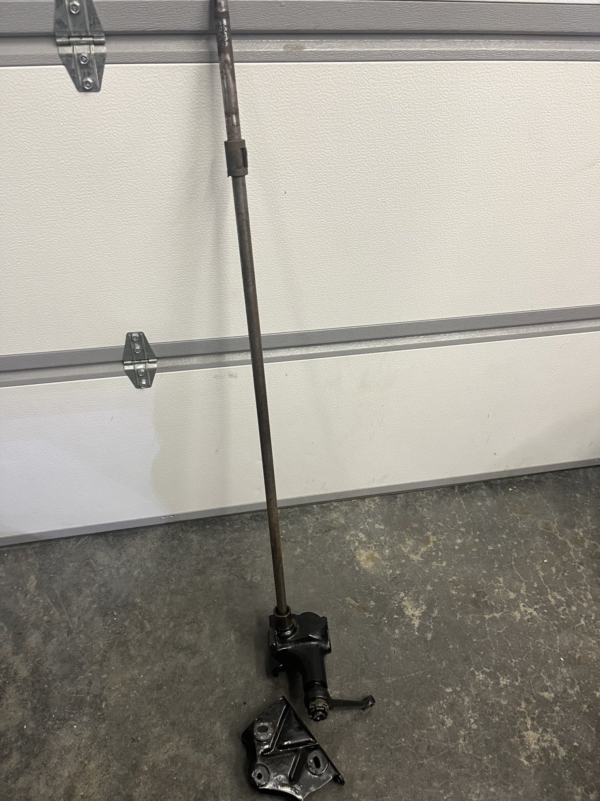

    Anyhow, today I got the tube shortened and the replacement shaft with new bushings from Dale at Weedeter (@Weedburner 40) put together.
    Does the Weedert steering upgrade require the shortening of the steering tube because it moves the steering box?
  25. Weedburner 40
    Joined: Jan 26, 2006
    Posts: 1,115
    Weedburner 40
    No, it doesn't move the box. The tube needs to be shortened to accommodate the U-joint and new 525 box.

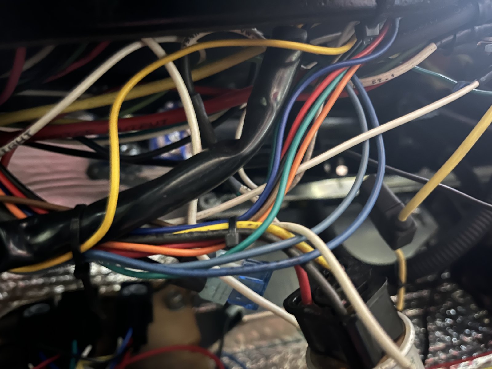

    Checked out electrical circuits today, but accidentally shorted out my ignition switch :mad:
    The MIDI/AMI main fuse I had put in line blew. I hadn’t bought any spares yet, so ran all over town looking for some. Not one parts store carried them. Not my local guy, AZ, ADV, nor NAPA. Not the electrical supply nor the hardwares. Finally found them at a car stereo install shop, in every amperage:D Promptly ordered some spares on line for my kit.
    Anyway, everything works. Hi-Lo Headlights, brake, turn, interior. Went to turn it over and ZIP!
    Nothing thru the new Ford solenoid I added before the Chevy starter. I’m hoping just no ground through paint on firewall. Find out tomorrow.
