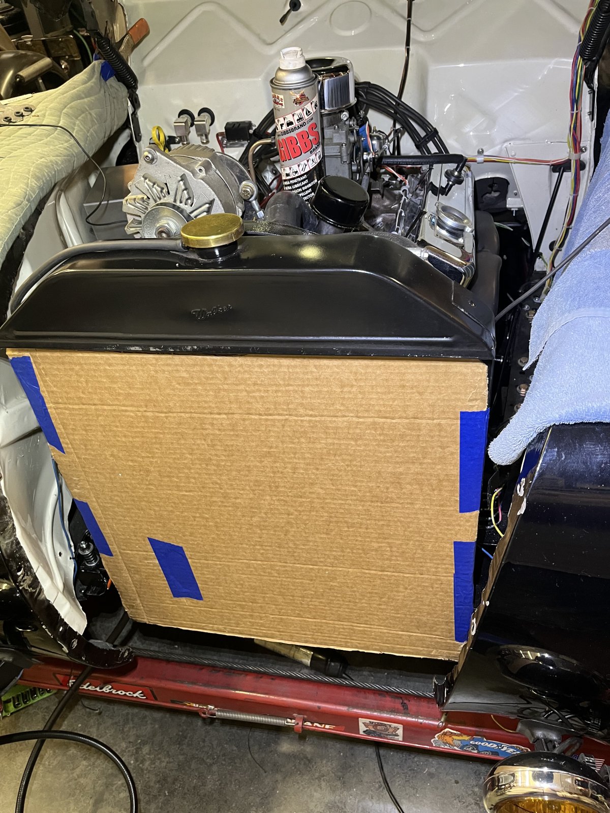

    Got power back on, so I got the radiator and shroud set in. Hoses, side brackets and shroud tomorrow.
    Temp gas tank hooked up to fuel pump.
    Gettin’ close!

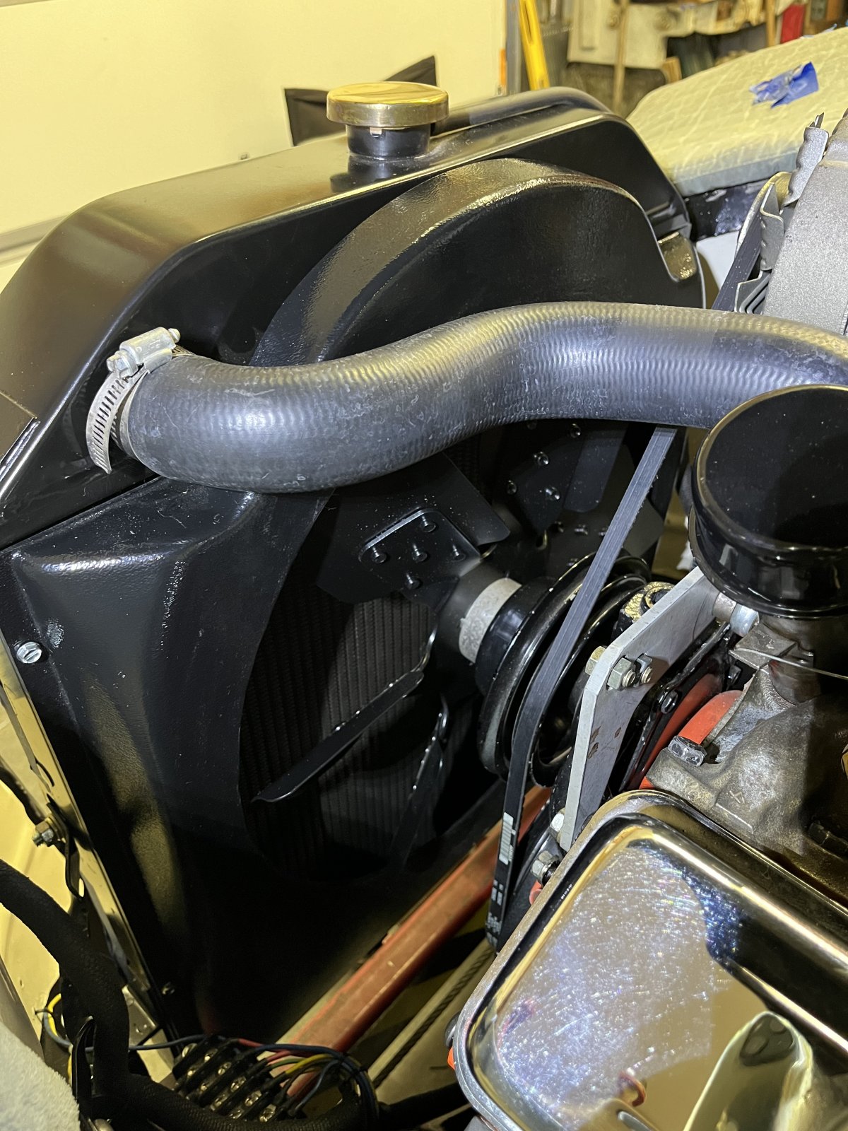

    I had checked and double checked everything but apparently misjudged the clearance between the fan and upper hose. When it heated up it somehow drooped and hit the fan, or I leaned on it and bent it down before cranking.
    We (me and good neighbor Bob) couldn’t find the source of the noise, thinking it was either the alternator or the pump.
    It got louder and we shut her down. Then I noticed the hose droop. Loosened it, turned it to clear and got out the Gorilla tape. It wasn’t cut through, so a couple of wraps for reinforcement will hold it until I get another one. No one stocks it in town. A real DUH !! moment! That’s the tape you see in the video.
    Anyway, it cranks readily, and runs smooth as is.
