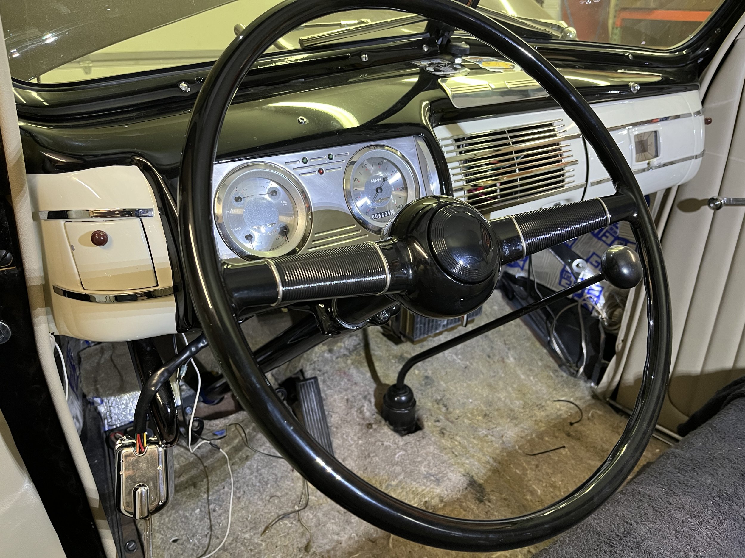

    Had enough time today to get the steering column and wheel installed today. Yes, it was a PITA but I won!:D
    No worries, it’s straight!
    Almost ready for a cruise!

  9. Bandit Billy
    Joined: Sep 16, 2014
    Posts: 15,908
    Bandit Billy
    Lookin good! I like the gauges!

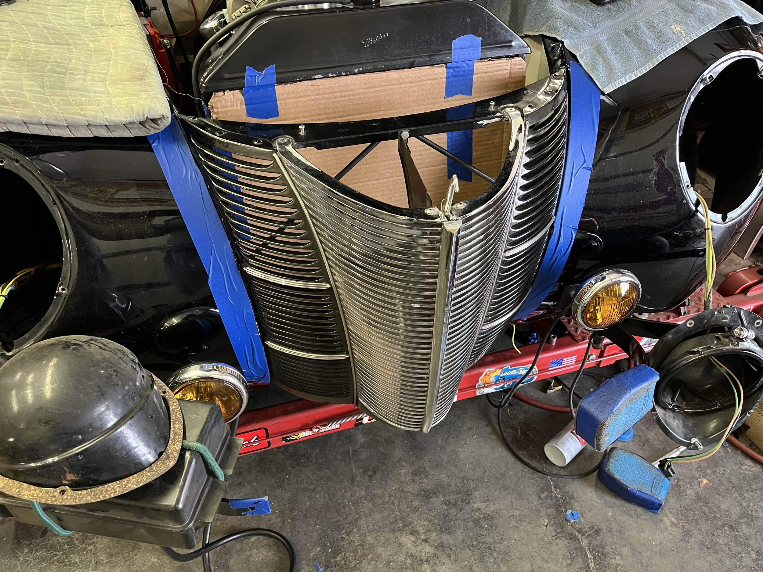

    Spent time today on the grille and installing the two air flow panels on the inside of the grille.
    WHAT A PITA X 2 !!
    One of those angled support rods was bent and missed the fender/grille hole by 3/8”! Couldn’t get enough muscle on it where it is. Didn’t want to hurt the grille.
    Finally got it in by elongating the holes in the panels.
    Good grief!
    Along with the black welting.
    Can’t figure how the PO got it together.
    Tomorrow, tighten it all up, install the two bottom radiator panels and at last, the headlights and bumper.

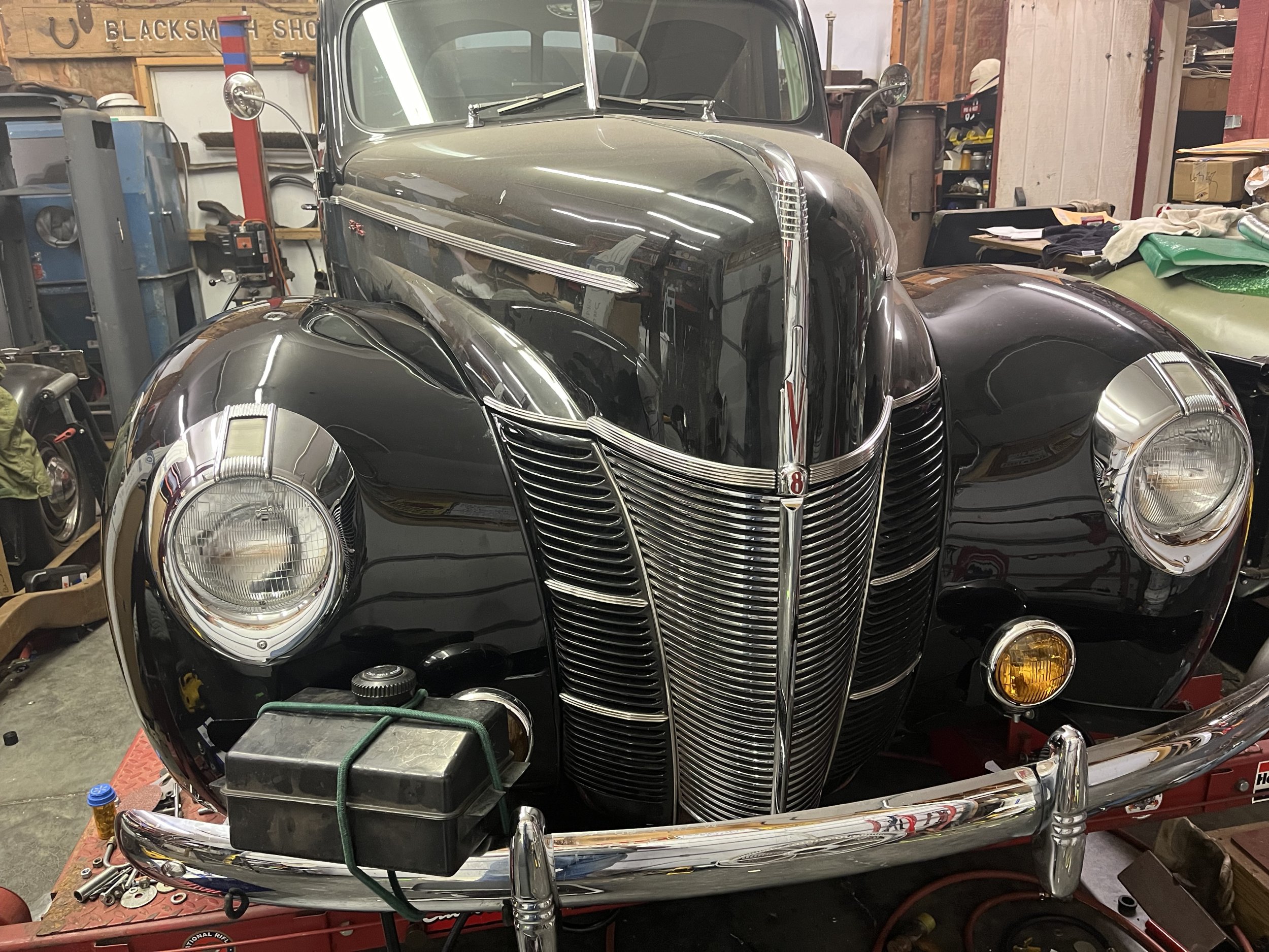

    Well, it’s been a long, frustrating adventure, with many setbacks and toe stubbers. but Fatso is ready(?) to drive at last. (He says, hopefully.):rolleyes:
    Many thanks to all of ya hoodlums for following along, offering suggestions and critiques, and blessing me with the “likes”. I would have thrown in the towel many times, but you kept the flame lit.:cool:
    Tomorrow: Pull it out on the temp gas tank, switch fuel lines and gas up the main tank and try a short spin.
    If it makes it home on its own it gets a well deserved clean up.
    Fingers crossed!:D

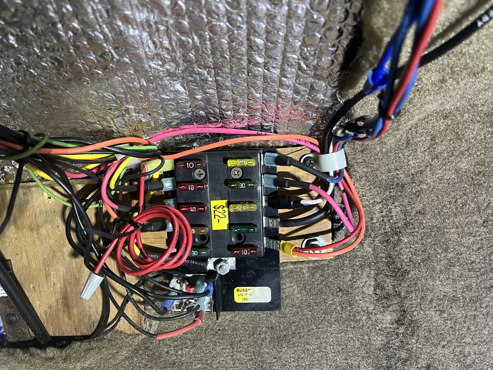

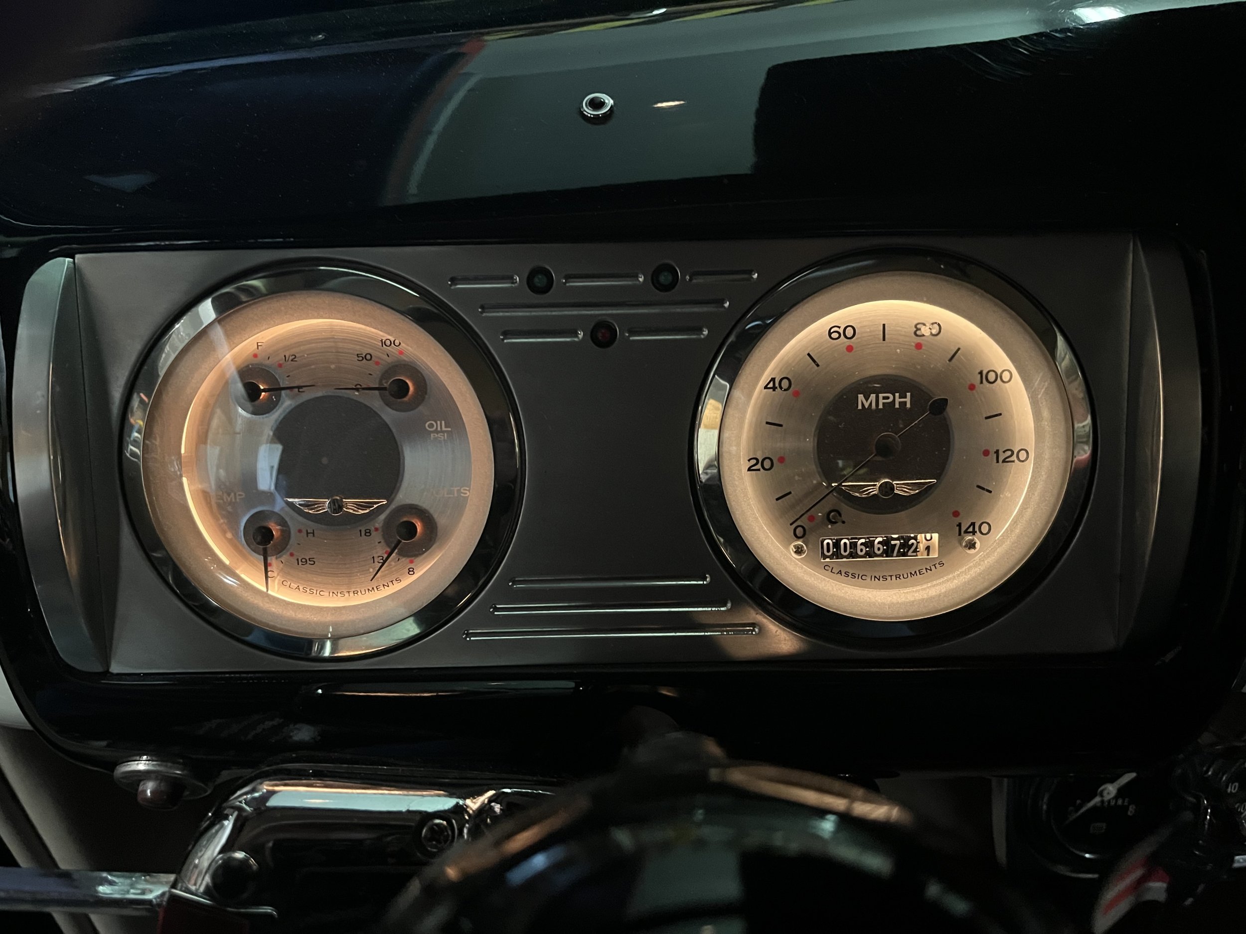

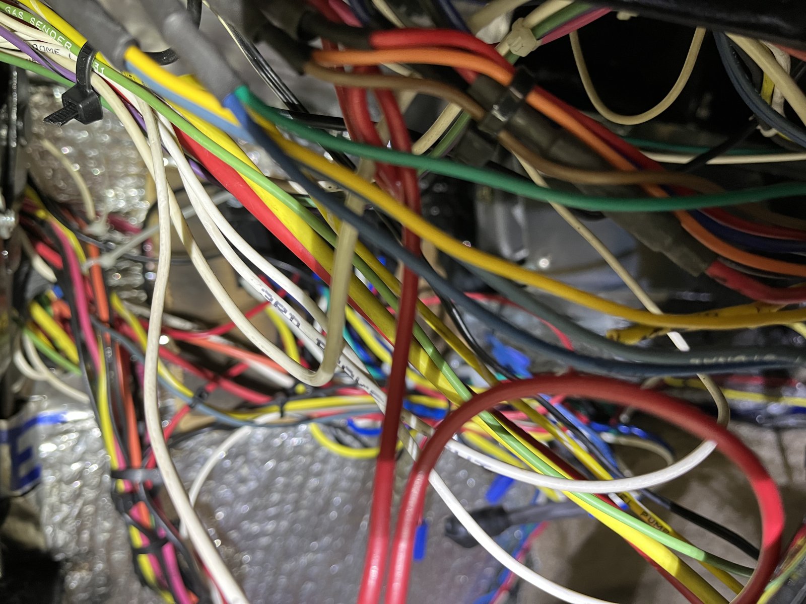

    Dove into the under dash wiring mess in an attempt to figure out the gauge lighting problem, plus the absence of tail and park lights. Torture time! :mad:
    “In the jungle, the mighty jungle, the wire sleeps tonight. Wee heeheehee weeoh aweem away”.
    Apologies to The Tokens.
    I found where the PO had spliced (with a house wire nut) one of his surplus s****s of white wire to a short 2” stub of a 16 ga. black wire coming off the back of the Cl***ic speedometer. Since the other gauge used a white 12V+ to power it, you might think that was power, since NOTHING is labeled, and ALL the other ground wires are black.
    But, nooooo. It was a cut off ground wire to the speedometer. GOOD GRIEF! :confused:
    Cut it off, Crimped the stub to a surplus cut ground wire I found in the snakes’ nest and “Let there be light!”
    Since the electronic speedometer is powered off its own fuse in the panel, that must also include its light.
    I had powered the other gauge cluster light off the new light switch. So the fuse panel gauge’s light is operated from the starter switch, and the other four off the light switch!
    I’ve found that the fuse panel is ALL switched power, with none constant power! For now.
    I will be so glad to tear all that S**T out and install the new wiring.
    YAAAY! So I have ALL lights working!!:cool: For now!:rolleyes:

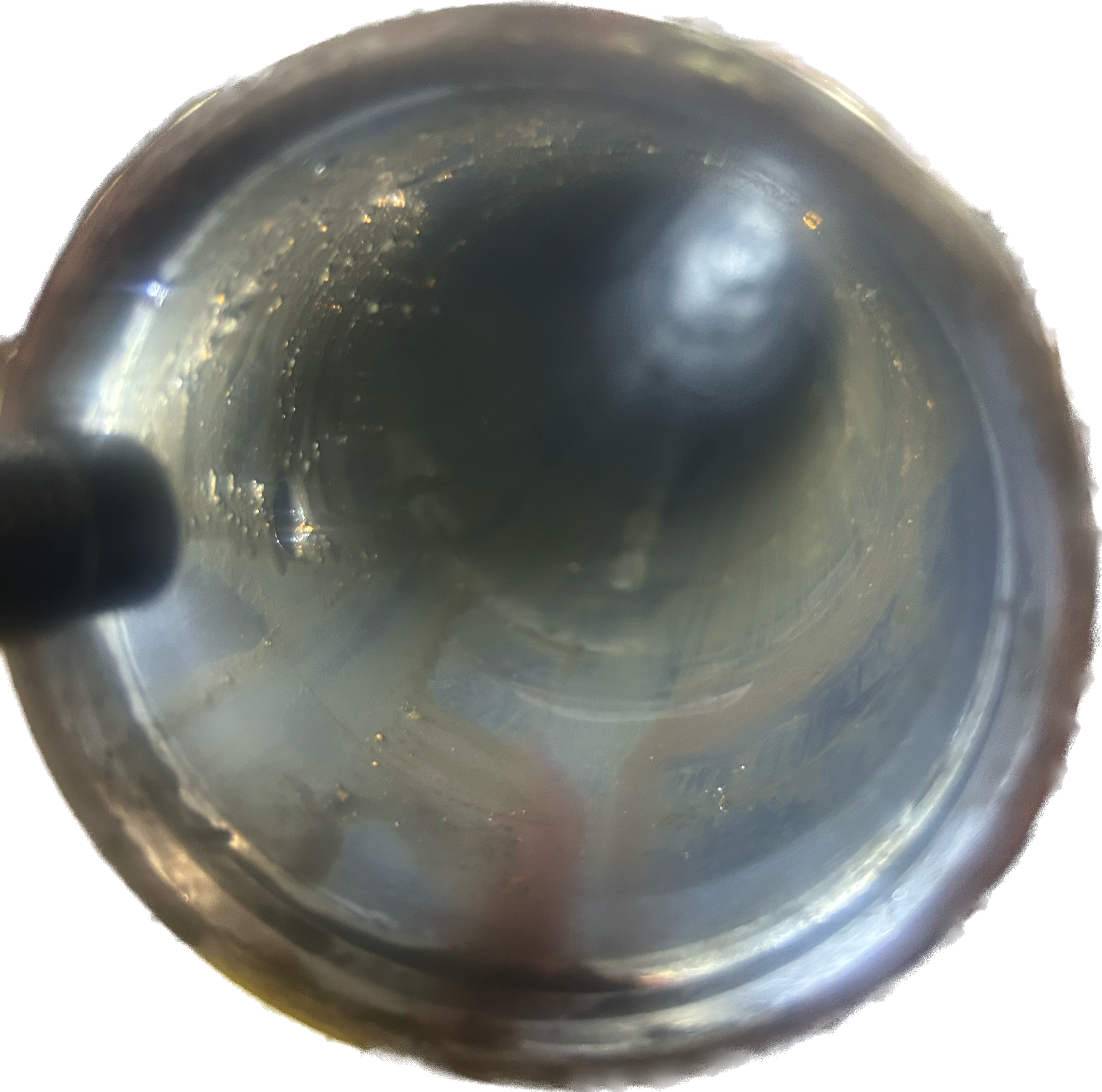

    Well, not good on the cylinder!
    The shop called and said they found metal and grit in the barrel, and the barrel was scratched! Can’t explain it.
    The pump has a filter on the pickup in the fluid reservoir, so I will have to look into that.
    But they were the last ones to have it apart, back in March.
    They will try to hone the scratches out, otherwise it’s replacement barrel time.
    Just ANOTHER setback in this long running and torturous adventure! GOOD GRIEF!!

    Maybe the pump is tearing itself up and sending metal shavings throughout the system?? dang it... good luck

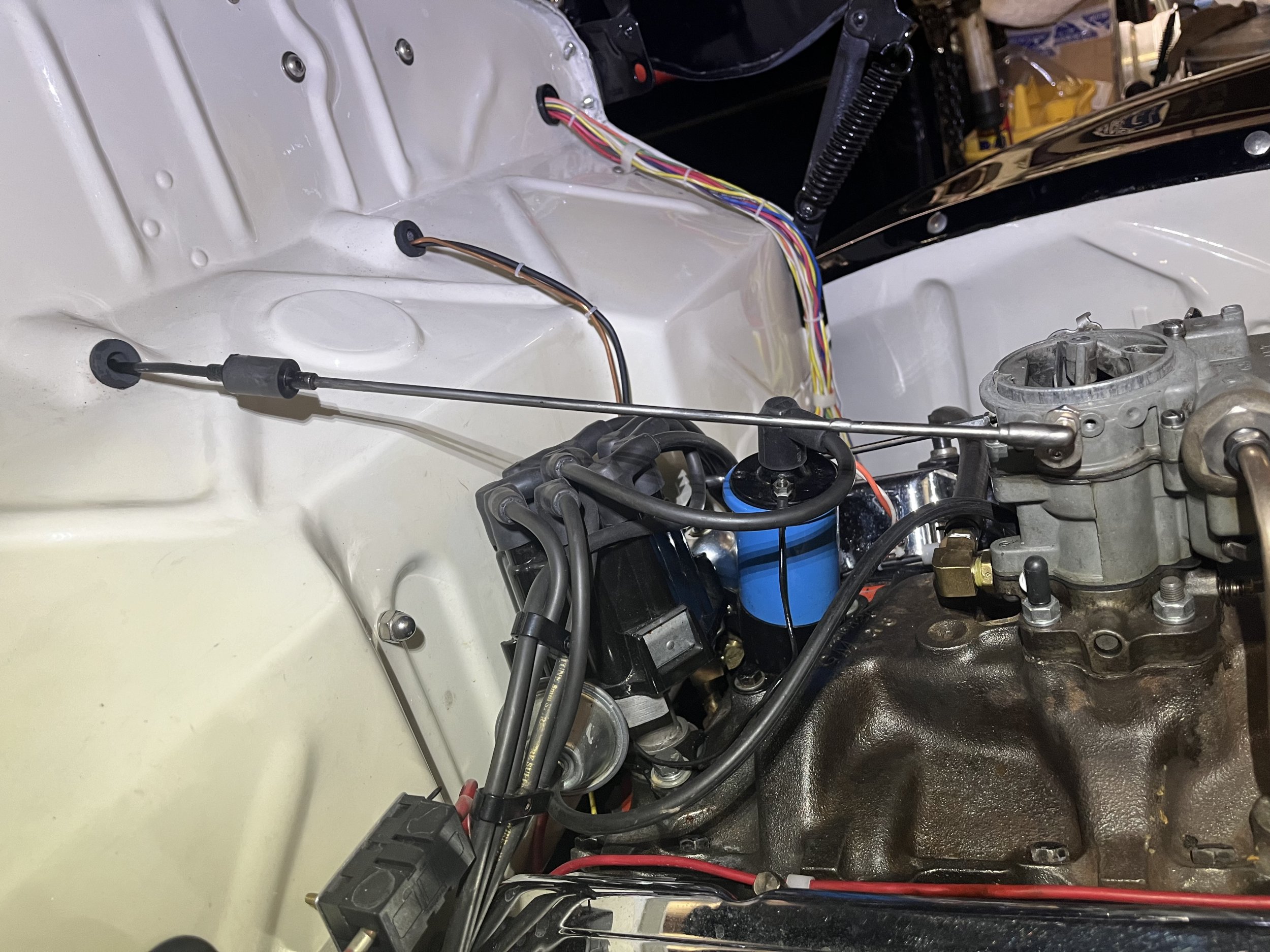

    Managed to figure out how to lengthen the stock 40 choke rod and adapt it to the Rochester 2G manual choke, using a junk rod, a small choke arm and a ball stud.
    All done until the Edelbrock intake and 4 bbl carb goes on, whenever that happens.

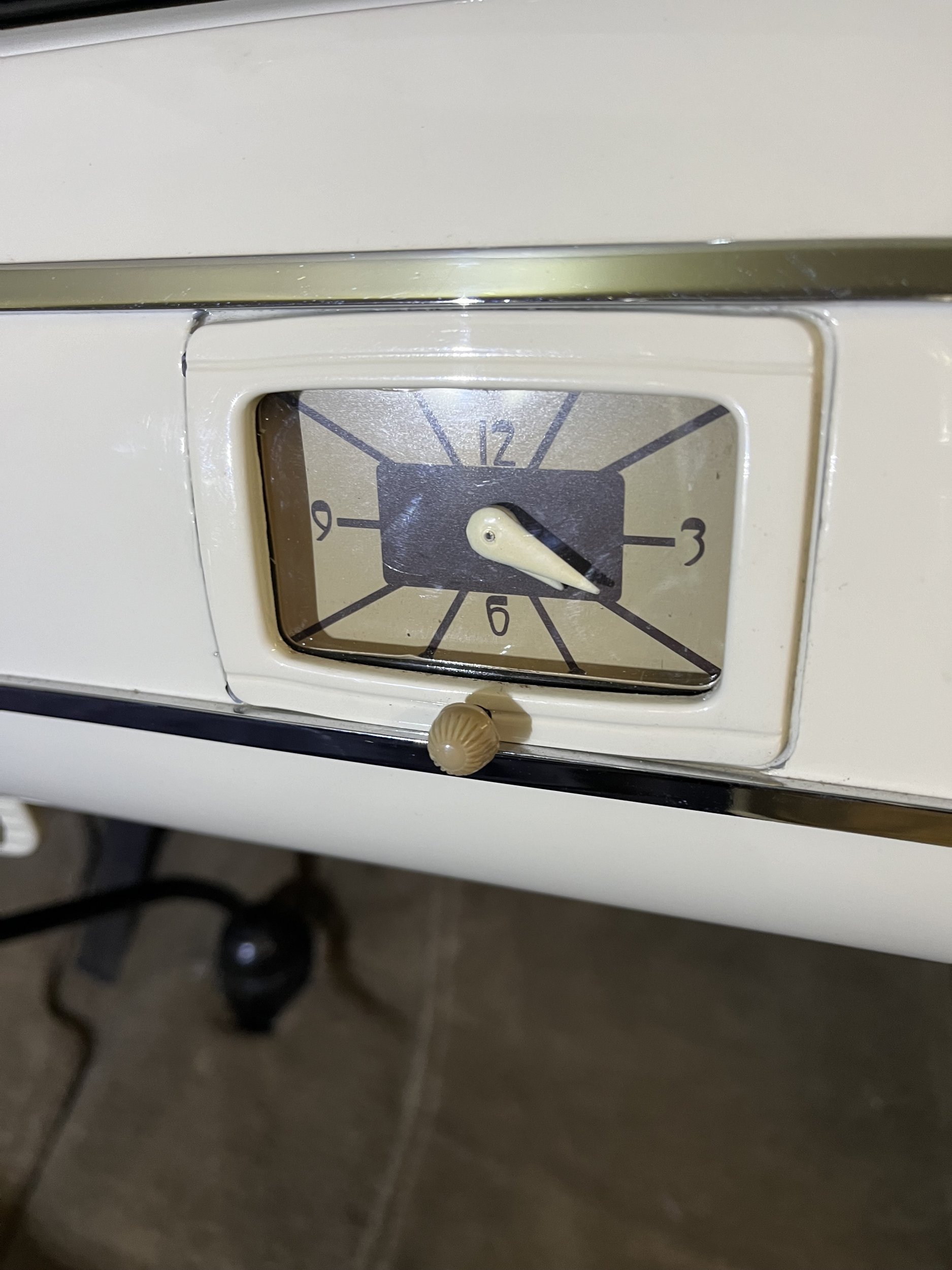

    Also got rid of the junk, rusty, non-working clock and installed a new, lighted, windup and working piece.
    With light, of course.
