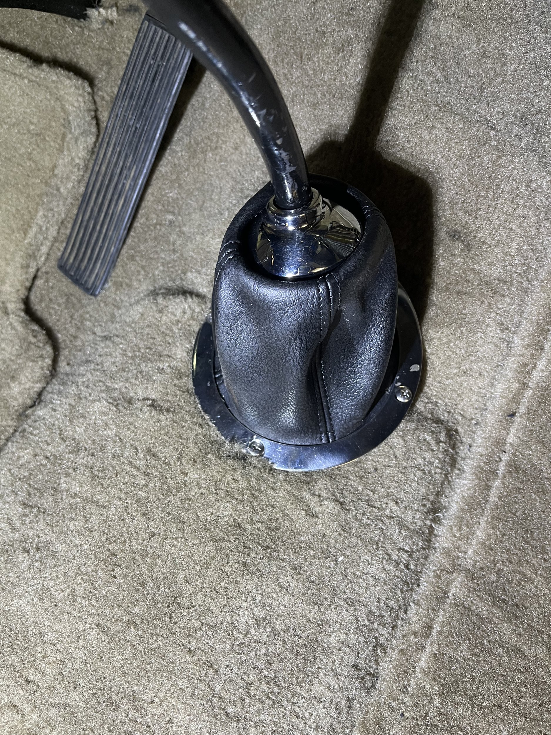

    Did manage to get the Gennie Shifter boot installed.
    Another PITA, even with indexed and pre-drilled screw holes.
    Still doesn’t lay right.
    It will have to do until the junk carpet is replaced.
    Beats the ragged carpet and the oversized hole.

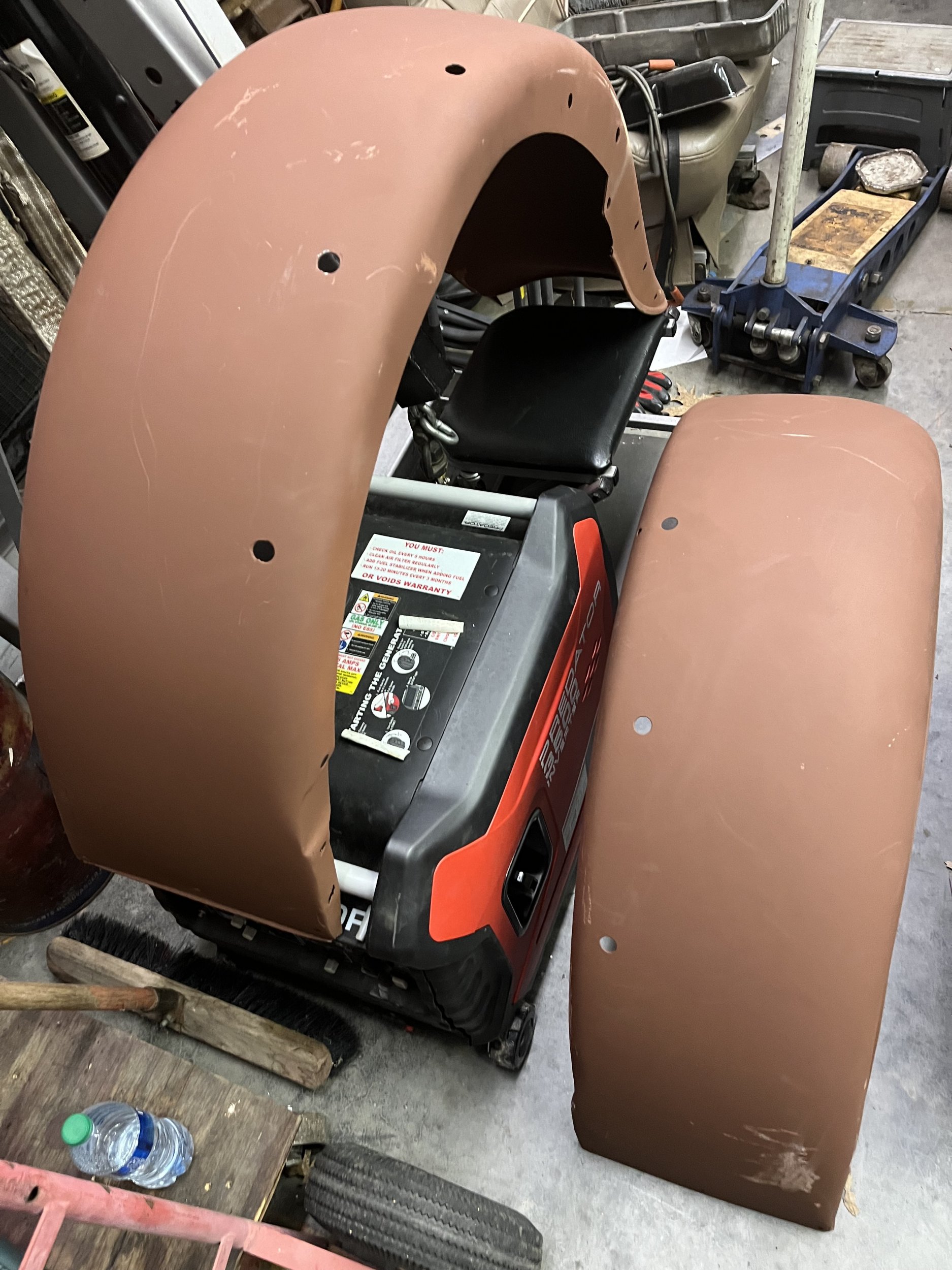

    On another front I picked up my half priced Brookville 32 steel fenders for the roadster that I bought off the HAMB.
    Thanks to BlakeTerry for hauling them from Concord, NC to Elizabethton; only had to drive 50 miles , instead of 200 one way

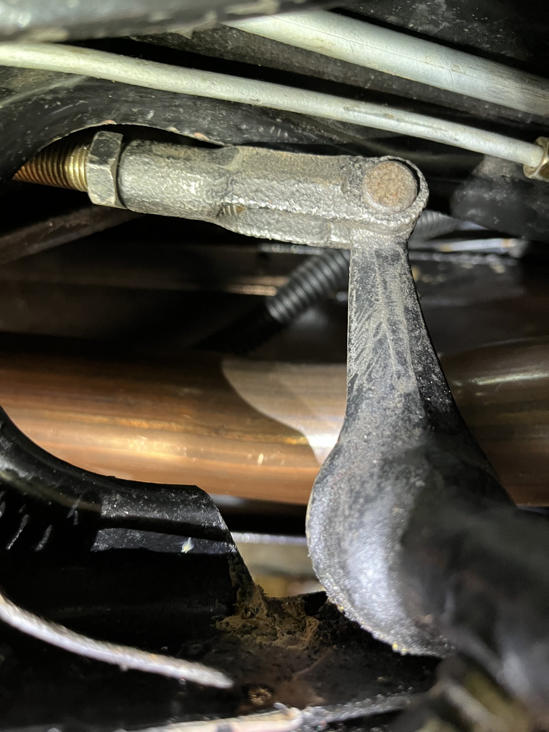

    Well, the lift is working great! The clutch linkage not so much.:mad:
    Extended the clevis on the threaded rod to give some more travel on the throw out bearing, and now it hits the opening in the frame x-member!
    I think that’s from the SBC (CE mounts) sitting higher in the frame that the flathead did.
    Got to pull it back apart and grind the lip on the x-member hole or heat the pivot arm and bend it in a little.
    Still won’t know if the clutch will release until all that’s done!

  16. TomT
    Joined: Dec 11, 2003
    Posts: 4,643
    TomT
    Is thus an up and down or left to right issue? Sorry - can’t picture it in my head.
  17. hotrodA
    Joined: Sep 12, 2002
    Posts: 7,343
    hotrodA
    @TomT Up and down. Ground a little off the clevis arms and bent them slightly. Just enough to clear.
