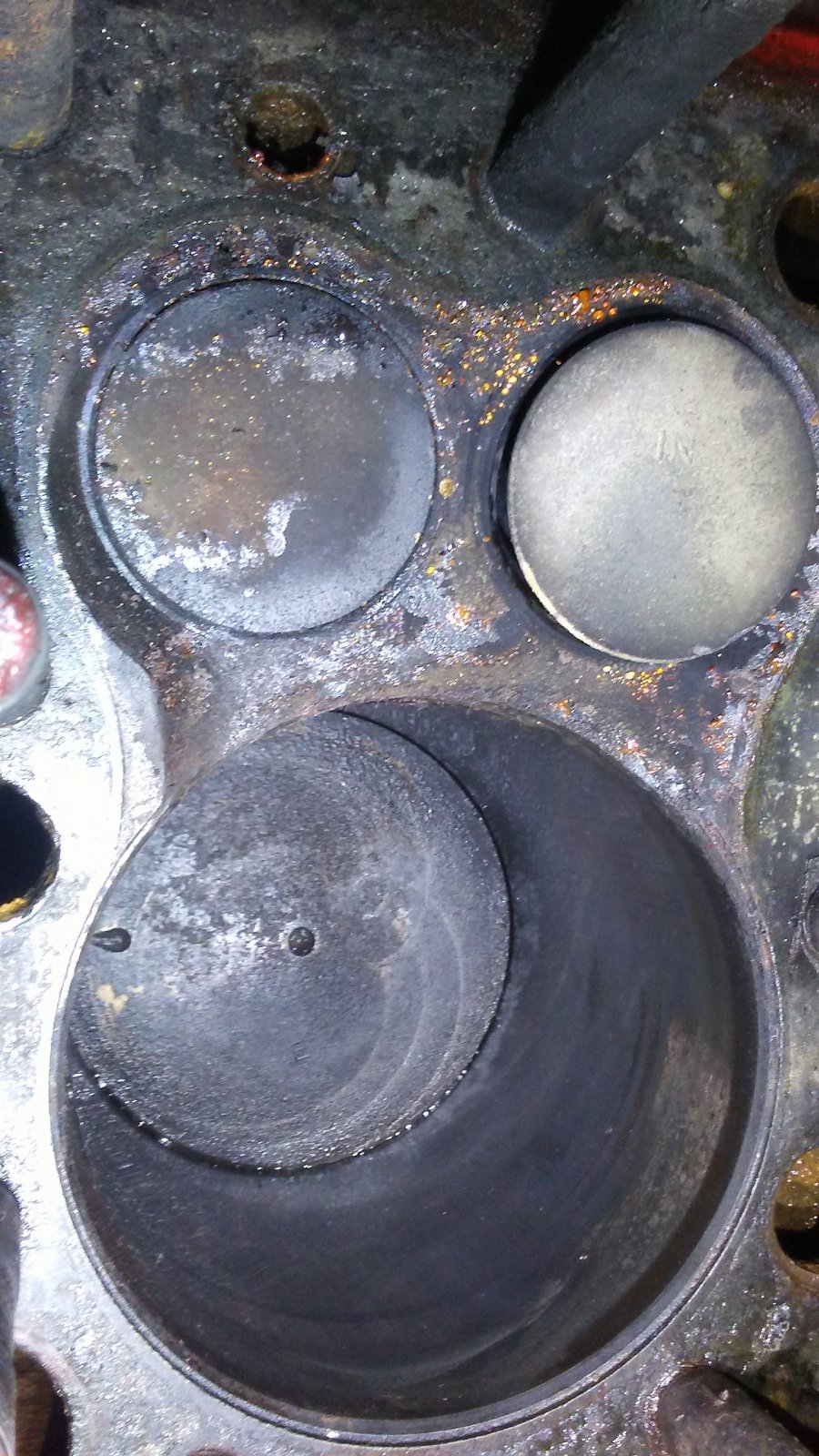

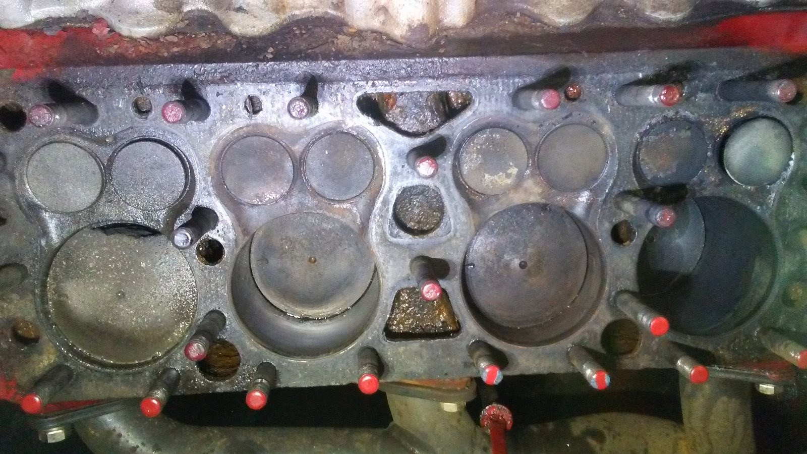

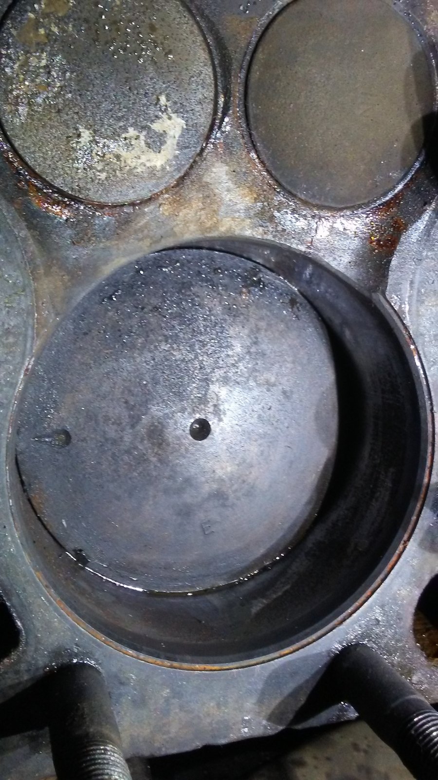

    Well, the forensic autopsy is complete.
    It’s terminal.:(
    Pulled the head today, and it wasn’t pretty.:eek:
    #5 Huge hole in piston.
    #6 burnt piston, rough wall at top.
    #7 crack between valve and bore
    #8 lots of deposits around valves and rough wall at top.

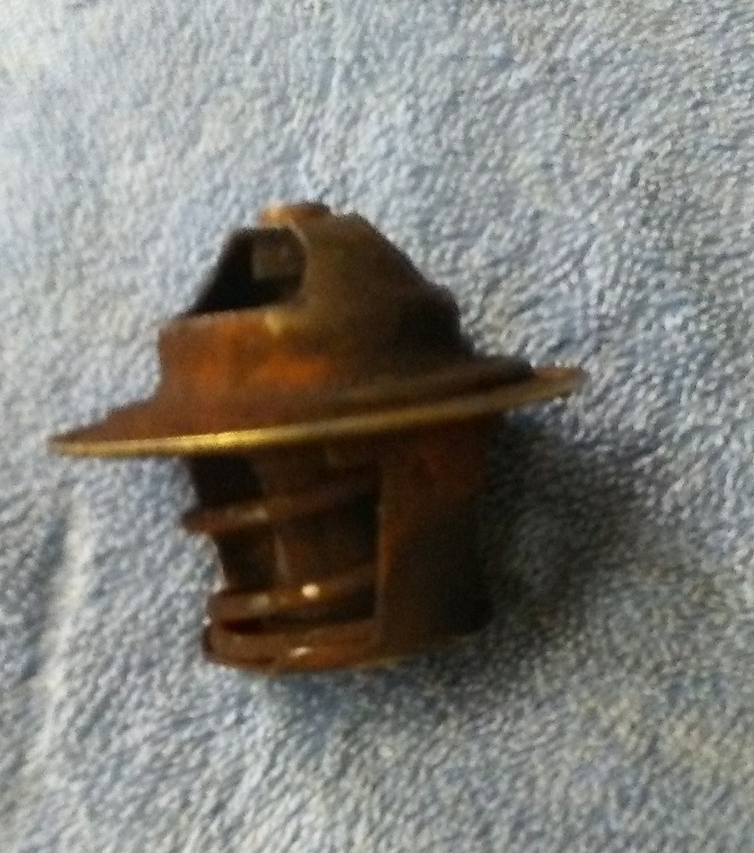

    And an old crusty thermostat up in radiator hose elbow.
    Lots of loose chunks and crud in water jackets.
    From what I can determine, a shade tree rebuild by the son of the original owner.
    Four owners since then.
    Disappointed to say the least.
    Time to move on.:D

  27. HotrodA ,
    I think you will be fine with the SBC,,,,,,they are great engines .
    It’s kind of obvious that you really want that all along ,,,,,,so go for it .
    However,,,,,,I didn’t really see any terminal damage to that Flathead .
    Yeah,,,,it will need an over bore from what it is now,,,,,,but after a good tear down and cleaning,,,,,it might be okay after a very professional hone and new pistons .
    They are not making any new blocks yet,,,,,,,be a shame to s**** it .
    And that small crack can be pinned and should be good to go .
    That’s an interesting poll you have there,,,,,,model trains are fun !
    Lol .
    Tommy
  28. Honestly... it could be okay, do an autopsy before calling it unfixable, if you cant fix it, i would get either another flattie or a Y block/FE
    Edit: Didnt notice the second page... thats not a healthy engine at all...
