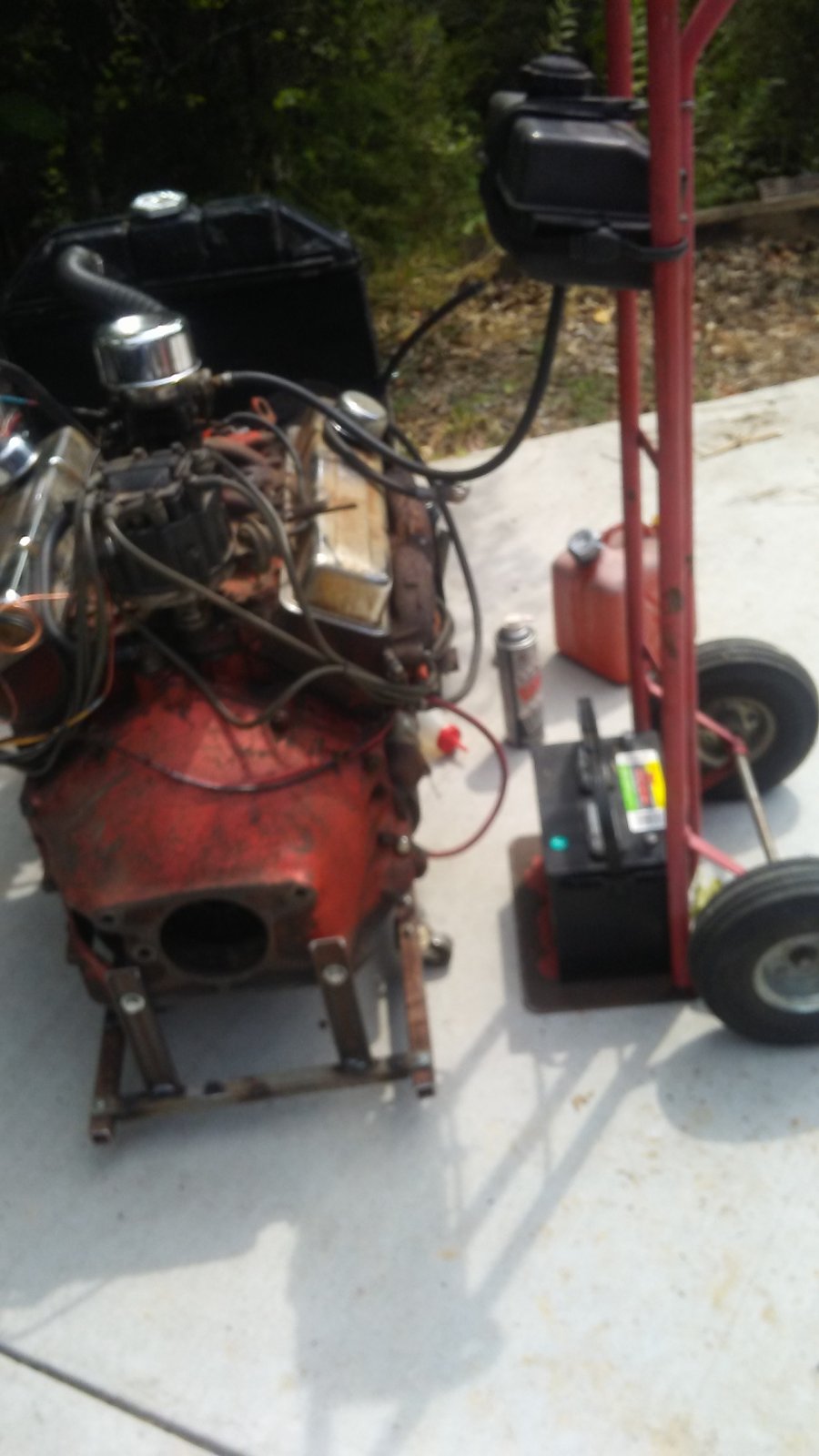

    SUCCESS!! :D
    Started up and ran pretty well, considering the carb has set for 4-5 years.
    Fuel pump is shot, so I had to rig up a gravity feed tank.
    Ran it for 30 minutes or so, Temp held steady at 180, hot oil pressure at idle was 15 psi, climbed to 50 revved up. Very clean exhaust. No lifter noise.
    Just had to richen up the idle mixture a little and it settled down.
    Still needs a timing check.
    And maybe rig up some mufflers so I can listen for noises better.
    Took some phone videos for proof, but unfortunately without sound. “Shore runs quiet, Bubba”:rolleyes:
    More to follow on the 40 rescue attempt. Over a big hump today.:cool:
    Hillbilly, high tech, gravity fed fuel tank and battery combo cart.:rolleyes:

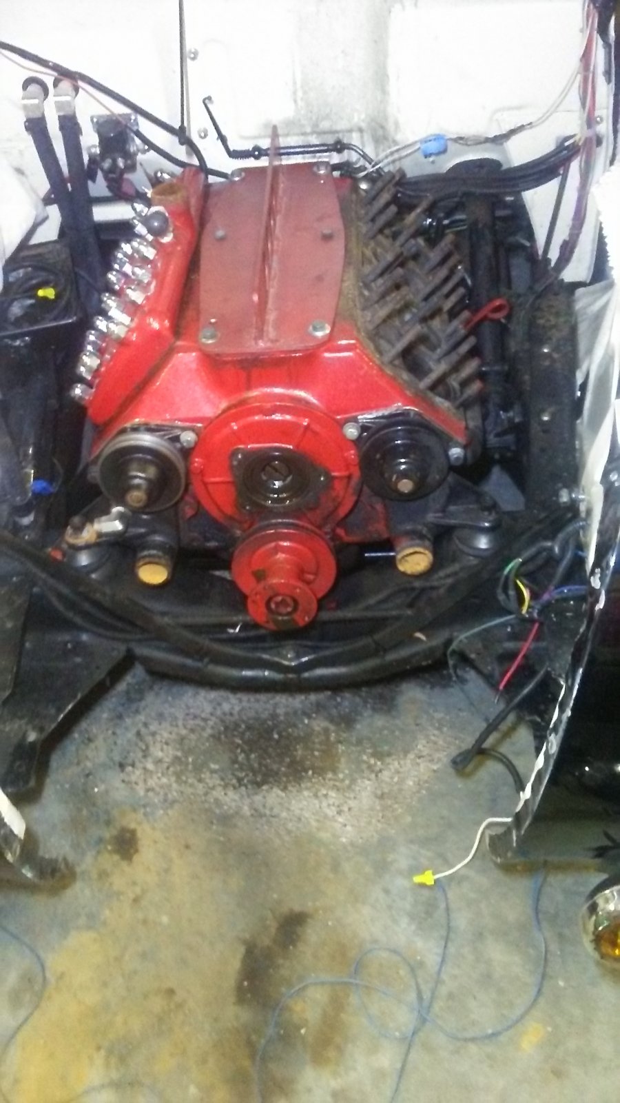

    Figured on one last run up and check out of the 283 before it gets a cleaning, gaskets and paint.
    Got some pipes bent up and belled at the local Farmer's Co-Op today and threw on some used Smithys I had.
    Now it will be quiet enough to listen for any weird goings-on in the engine.
    VROOM, VROOM, yeah it’s got duals, baby. Wanna go for a ride? :rolleyes:
    Meanwhile got everything under the hood off and out of the way, under the car is next.
    Do I keep the residential wire cap and extra two feet of wire?
    More fun later. Stay tooned.

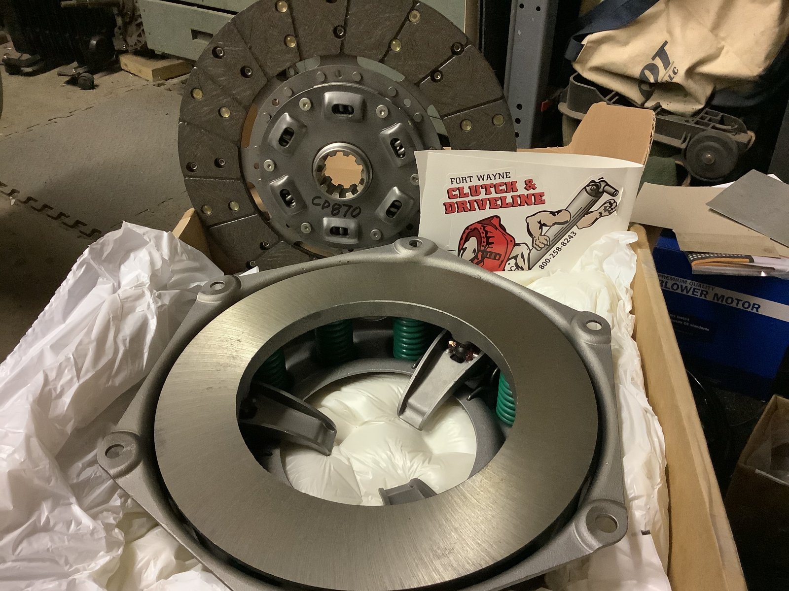

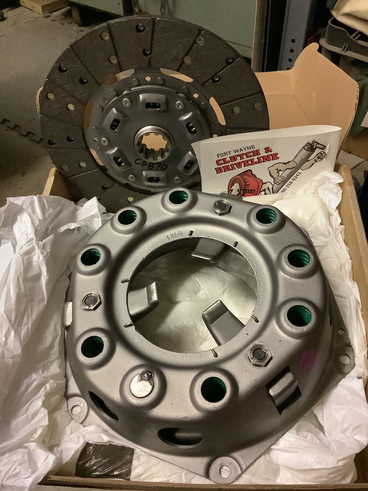

    I also went through all my stash of clutch pressure plates. Found only one B&B but it’s the wrong one needed for the mating of the 283 and early Ford trans. (49-50 Mercury). ****!
    Nothing else to do but call Ft. Wayne Clutch and give blood. Good grief! No core = +$90!:eek:
    WILCAP was cheaper, but out of stock.
    Next, get underneath and disconnect the trans mount, clutch, exhaust and yank the now a boat anchor flattie.
  30. hotrodA
    Joined: Sep 12, 2002
    Posts: 7,359
    hotrodA
    Well, the missing link arrived today in an armored truck. $$$! Plus a $90 core charge!
    The CORRECT Borg and Beck 9 spring pressure plate for this hookup is Model 1310,
    49-50 and early 51 Mercury. Disc is standard Ford 10” with 1-3/8” 10 spline hub.
    Other B&B’s may bolt on and work, but this is the expert’s choice. Not me, Fort Wayne Clutch. Talk to Lou!
