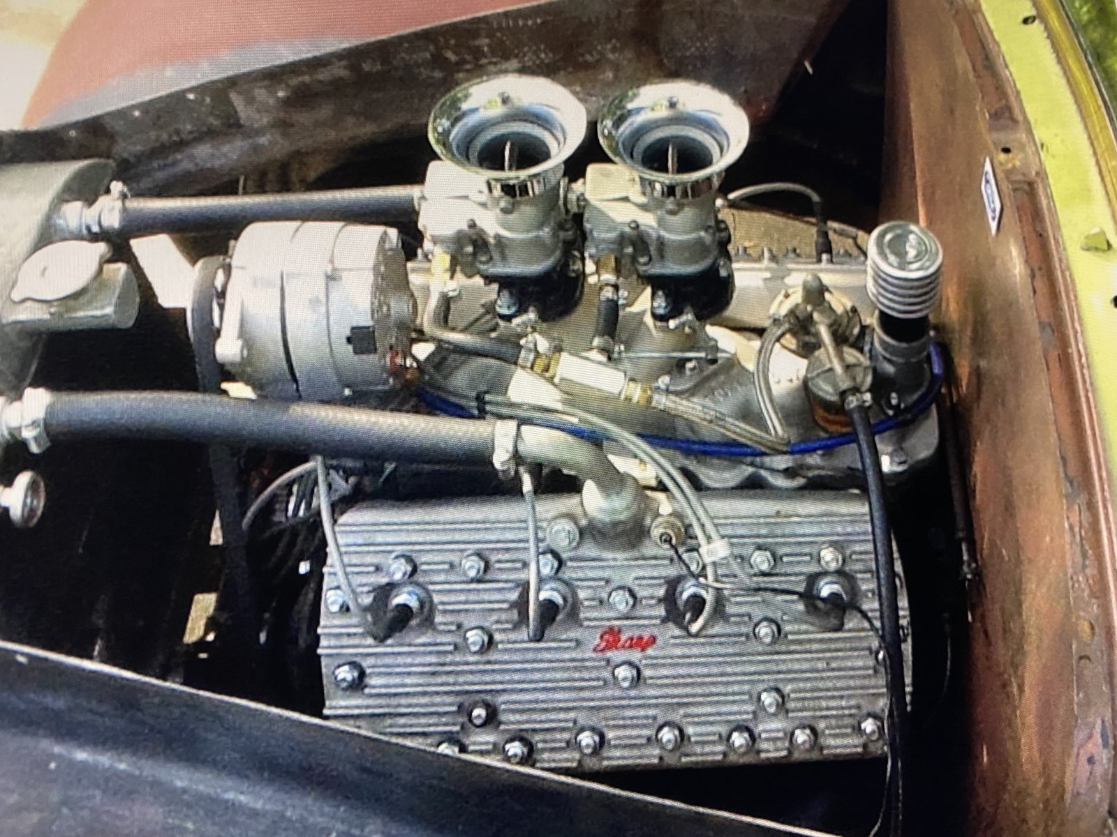

    I really like what you a doing using the 2barrel and all. I see from the rear photo it has the stock PCV system too. It’s nice to double the original horsepower with what Chevrolet used for almost everything from 57 to 67. Cruising down the hyway will probably get 20 mpg too.

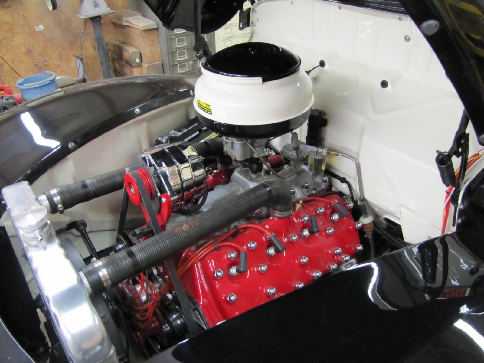

    Been gone for Christmas, but tested out the alt. mount and belt tension.
    A new 45" OD. belt I had adjusts tight at 50% of the slot.
    We'll see when I put it back on the test stand to check for any leaks and put some revs to it.

    Will that alternator clear the front cross member or front fender brace? I couldn't figure a way to mount it down there. I have it just above the valve cover, but have to swing it out of the way to remove the valve cover and adjust the lifters.

    Hmmm. Good point! I’ll double check, before I go any further. Thanks!

    Back to the drawing board, i.e. a top mount.
    Jitney Jake (if available), VintageAir, Alan Grove
    Thanks for the heads up!:( Better now than after the engine’s in.:mad:

    This is a short water pump, right.? Looks like the stock swp ps pump setup would fit right in there from the 60s?

    @TomT. I threw in the towel and ordered a VA upper alt. mount for early SBC. Ran out of patience.
