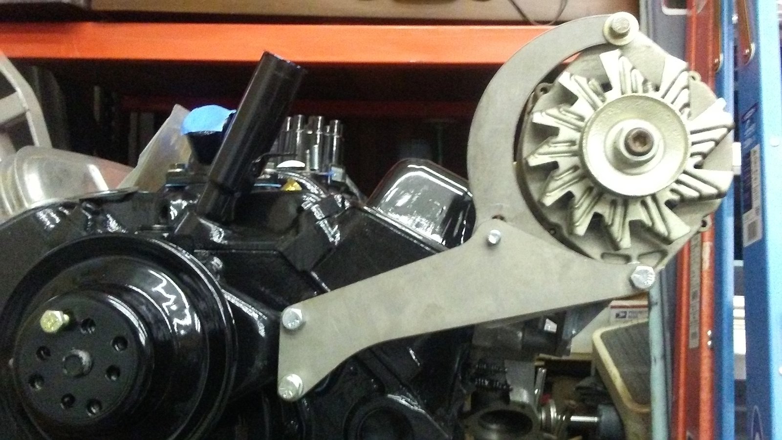

    VA alternator piece came today! Got it mocked up; nice piece!
    Now for paint and maybe some speed holes in that front piece.

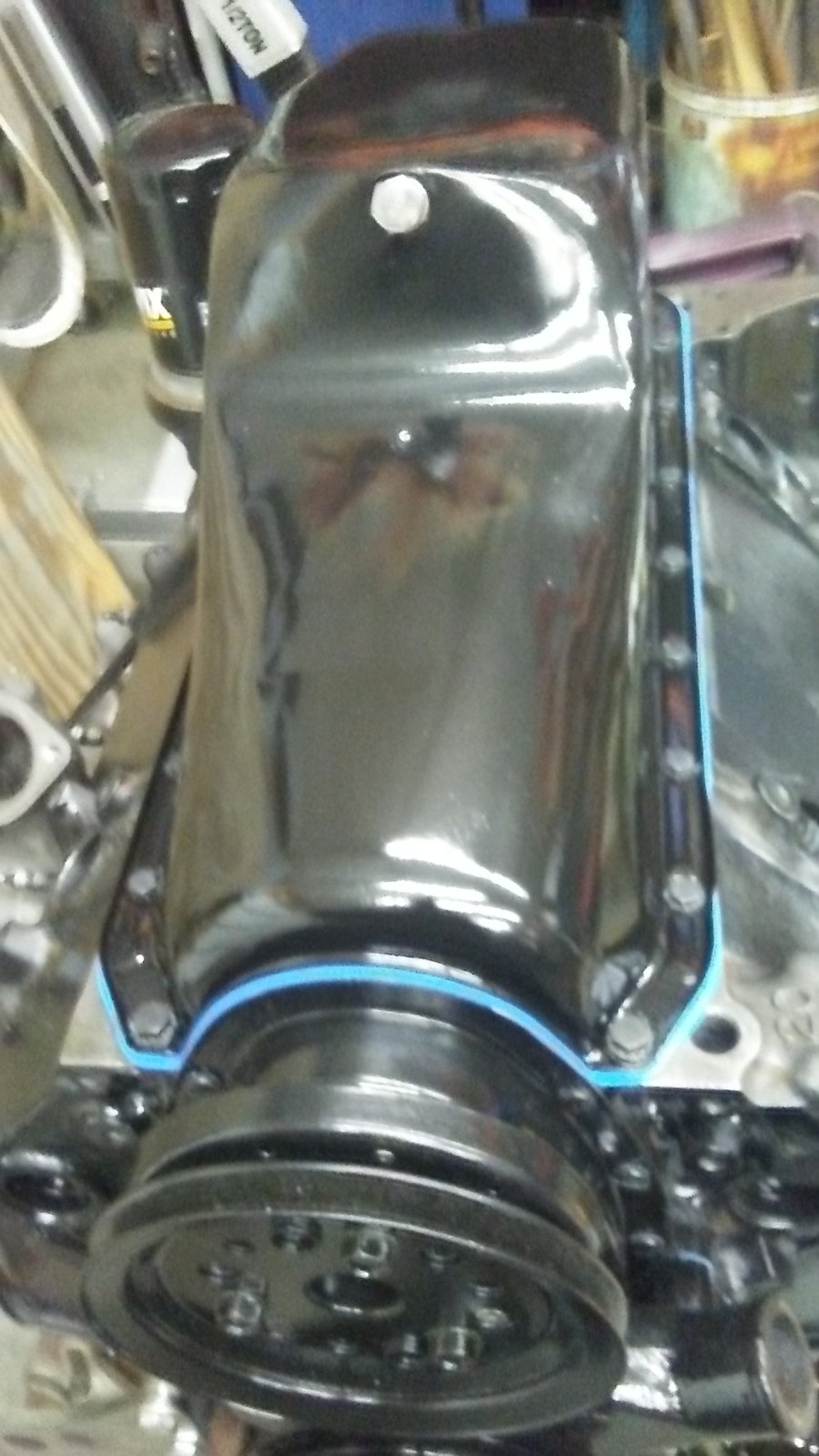

    Finally got the crusty oil pan spotless inside and out, got the oil pump pickup cleaned out and got it all together with one of those fancy FelPro one piece gaskets.
    Looking like an engine at last.

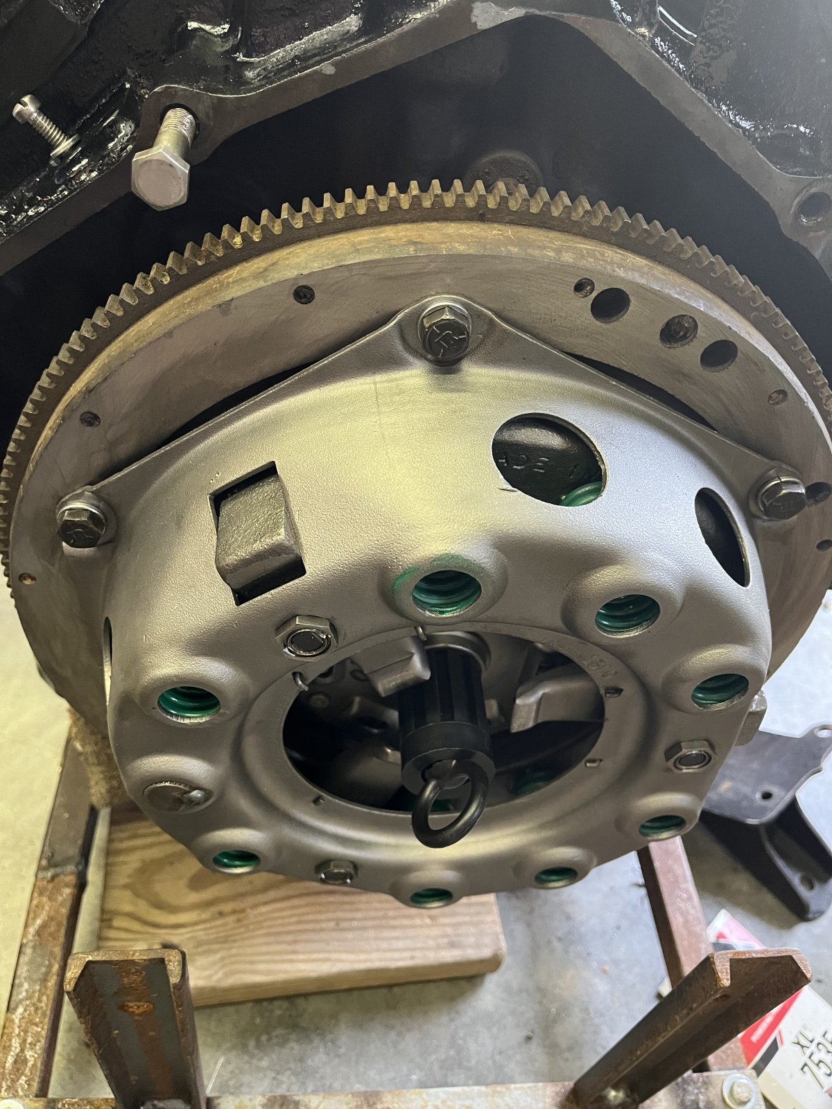

    Got the 283 bomb off the engine stand, on to the test stand
    and the freshly turned flywheel and new Ft. Wayne Borg and Beck clutch on!
    Hallelujah, Julia! Ready for some 283 POWER!
