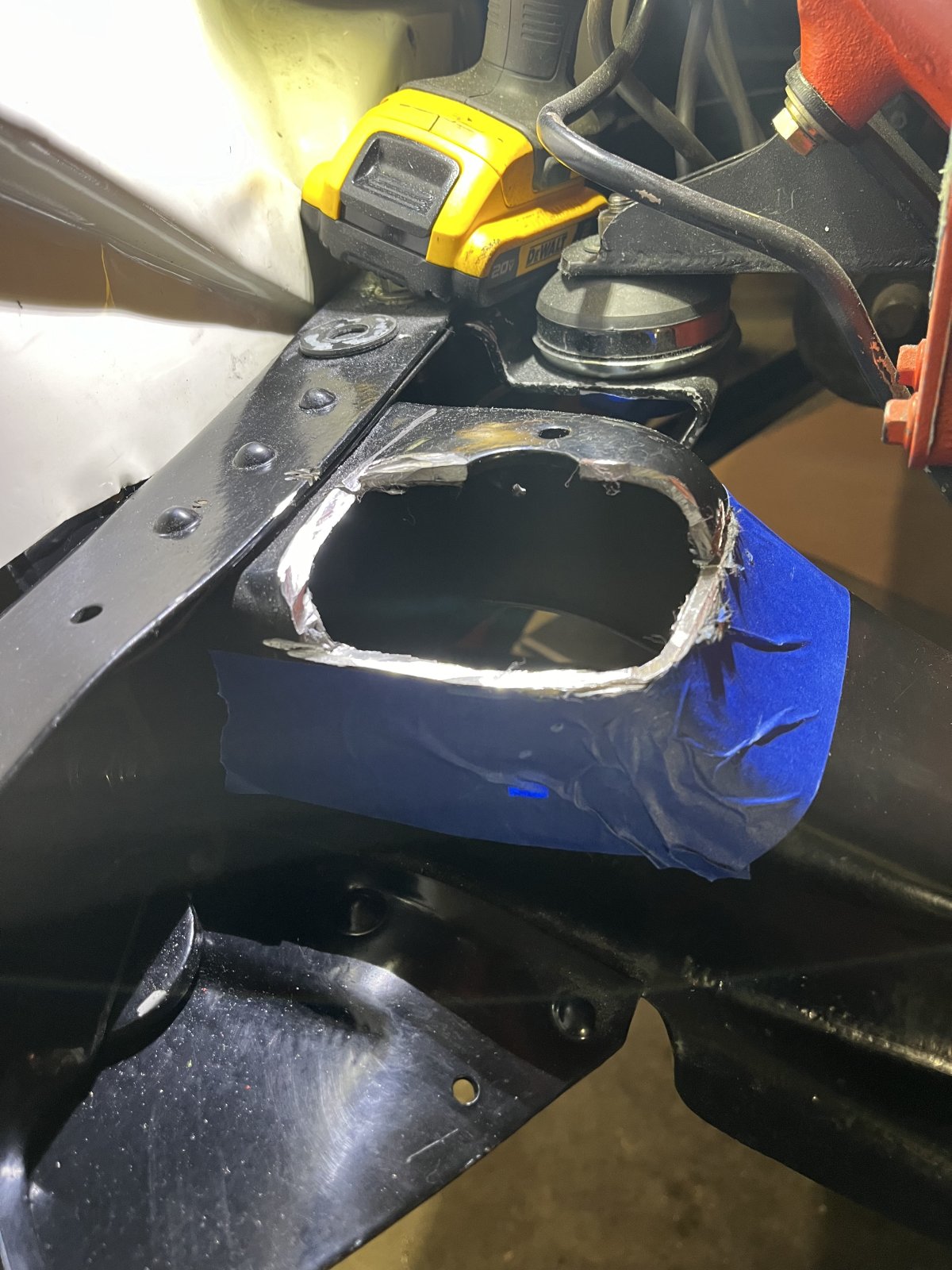

    No turning back now. :eek: Carter M2468 pump it is. :D
    Close quarters for the die grinder/cutoff wheel required cutting it out in a couple of pieces.:confused:

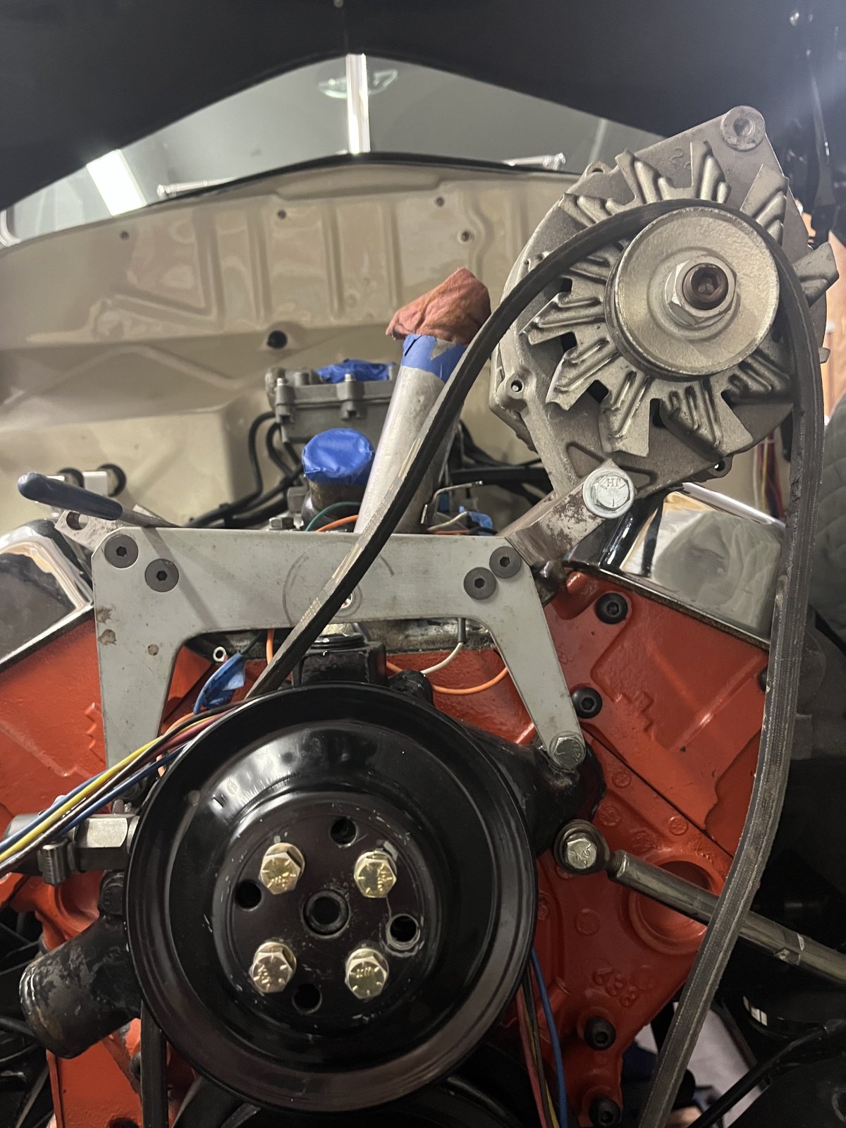

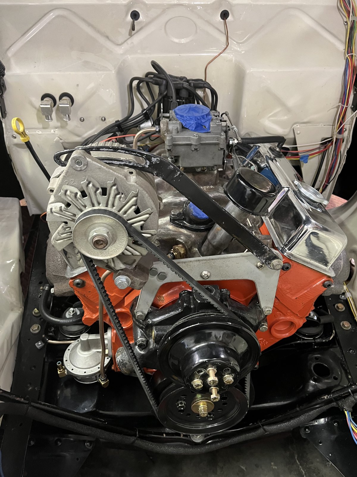

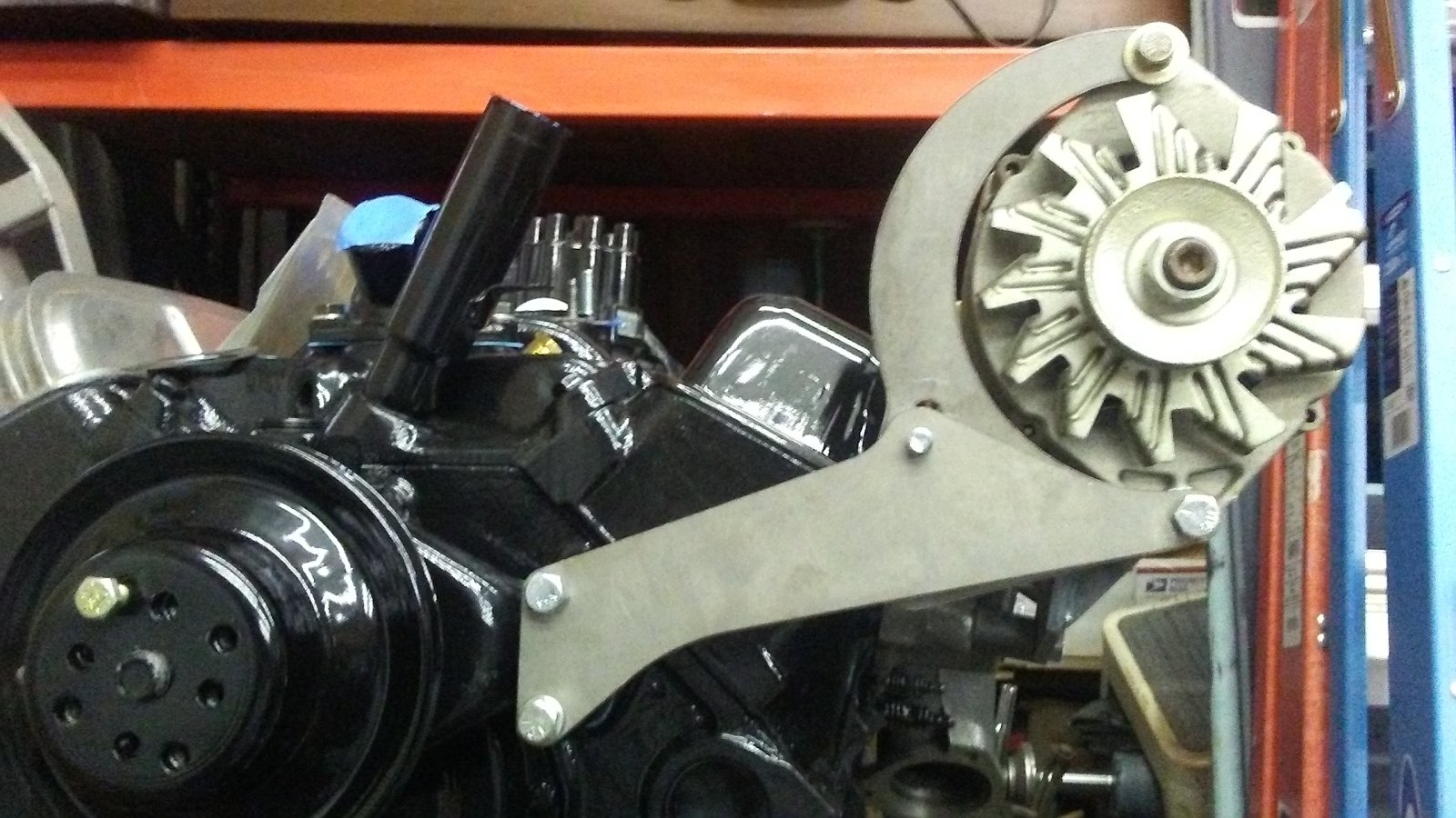

    Well, in the usual course of events on this adventure, something else has turned to s**t.
    After ALL the research, searching and measuring I did on it, the VA alternator bracket (below) won’t work.
    It’s designed to be used on no-hole heads, and mount on the left side exhaust manifold, (same as Alan Grove).
    Couldn’t use the stock ram’s horn mount since I’m using the C-10 right side, turned around to clear steering.
    The alternator hits the raised section of the inner fender panel.! Or the rocker cover! *******!!
    Since I plan to add A/C sometime in the future, I had this used combo mount stashed and mocked it up (below).
    Thinking that I would run ONLY the ALT for now.
    Can anybody ID it? Vintage Air?
    The ALT hits the filler tube, but I can slice and curve it, but I need to use it to run my early, no breather VC’s and early C4B.
    Will running just the ALT give me enough WP belt wrap? Obviously running ALT and AC with two belts would give enough, just not now.
    Or should I just get the smog pump bracket and use that for the time being? Position wise, it doesn’t look like it would add any wrap to the pulley.
    What say you? THANKS!

    Back to the fuel pump relief.
    Getting close. Bevel the edges and she’s ready to weld in.

  16. hotrodA
    Joined: Sep 12, 2002
    Posts: 7,332
    hotrodA
    Even a blind squirrel occasionally finds an acorn!

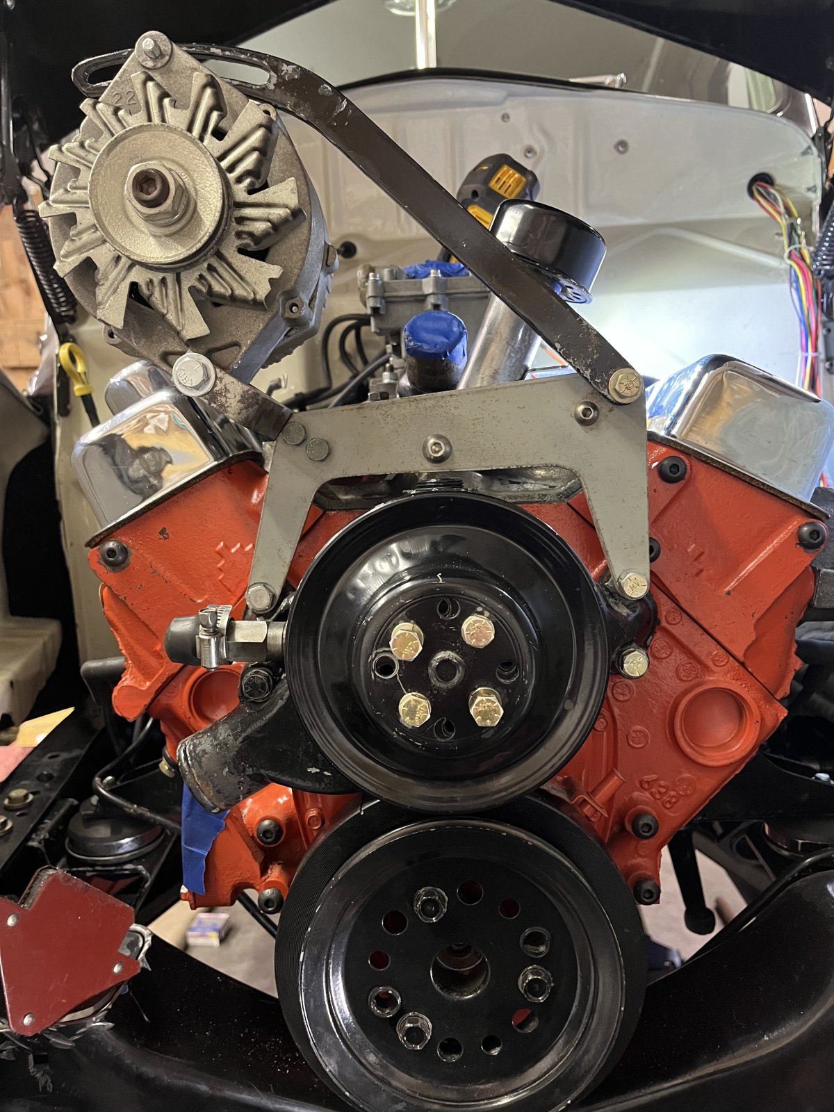

    Or, even an old man can find a solution to a problem, in this case an alternator mount, using what you have.
    I wanted to use the old combo ALT/AC mount I had saved, since the new Vintage Air ALT mount would not work! See above. $$ wasted!!
    But the combo piece let the ALT hit the rocker cover and oil fill tube!
    I had an epiphany last night and thought why not just turn it around? DUH!
    Did just that. Flipped the flat bracket over, put the ALT mount on the back side, removed the AC mount for later and threw on an adjuster arm I had left over from the 283.
    VOILA!!
    Now it clears the rocker cover and the oil filler tube!
    May need a liitle fiddlin’ with. Or not.
    It’ll do until I change out to the C4B.
    It’s hillbilly Engineering, and probably looks it, but hopefully it’ll work.

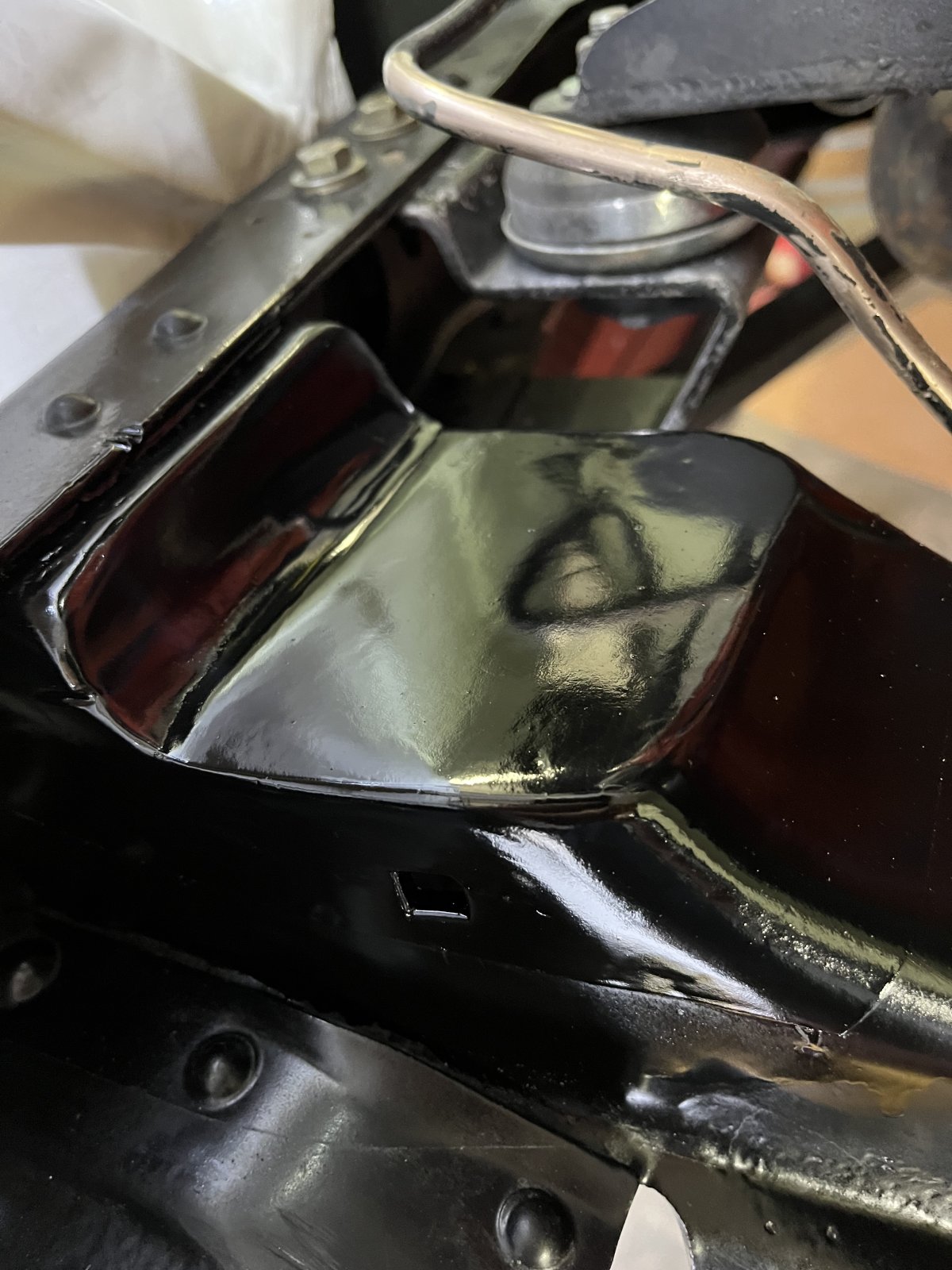

  17. seb fontana
    Joined: Sep 1, 2005
    Posts: 9,180
    seb fontana
    from ct
    When the patch is welded in an ground and painted it will look "factory". Nice.

    Trying to recover from the trip, but did get some more cleaning and picking up done.
    The fuel pump relief was finished and painted good enough for this heap before I left, so the aggravating but indexed pump and carb line got mounted for good, hopefully.
    With the relief and the M2468 pump’s side inlet and outlet, there’s plenty of clearance now.

  28. pprather
    Joined: Jan 10, 2007
    Posts: 8,914
    pprather
    hotrodA likes this.
  29. hotrodA
    Posts: 7,332
    hotrodA
    Thanks. Yes, that’s the plan. I’ll flip it back to the original configuration when the AC goes in.
    This is temporary to run the 2 bbl and that intake and speed up the swap. It will get a C4B.
    pprather likes this.

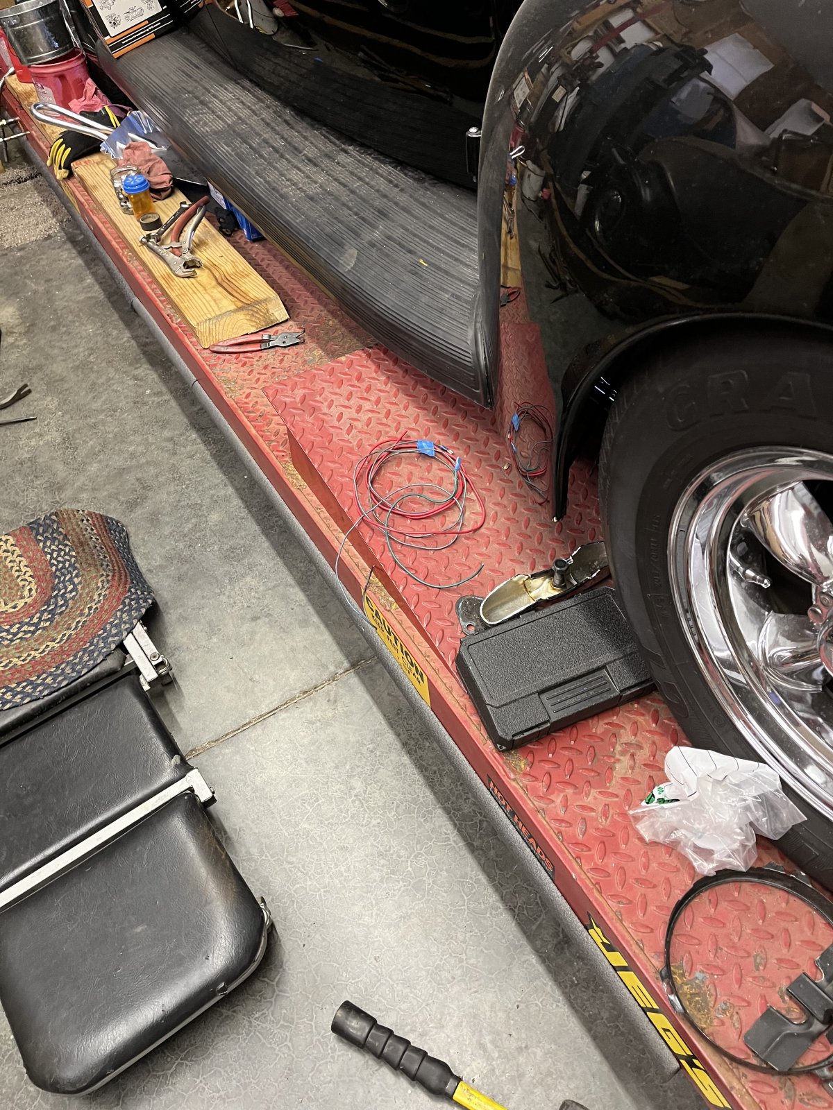

    Been inactive for awhile except for some fiddling with small things on the engine.
    Ran some gauge wires, along with under dash mechanical gauges to back up the Classic Instruments panel.
    Covered the wiring for the front with some vintage look woven loom.
