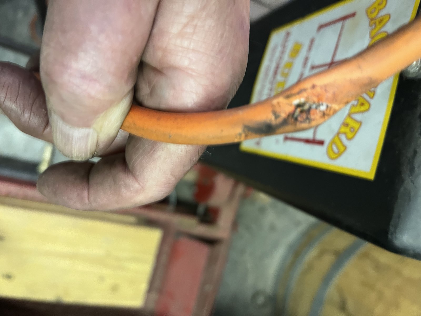

    Shop tip: Watch your lift’s power cord when you lower it!
    Pinched it!!
    Luckily the breaker tripped and I wasn’t shocked!!
    SOB!! The fun just won’t stop.

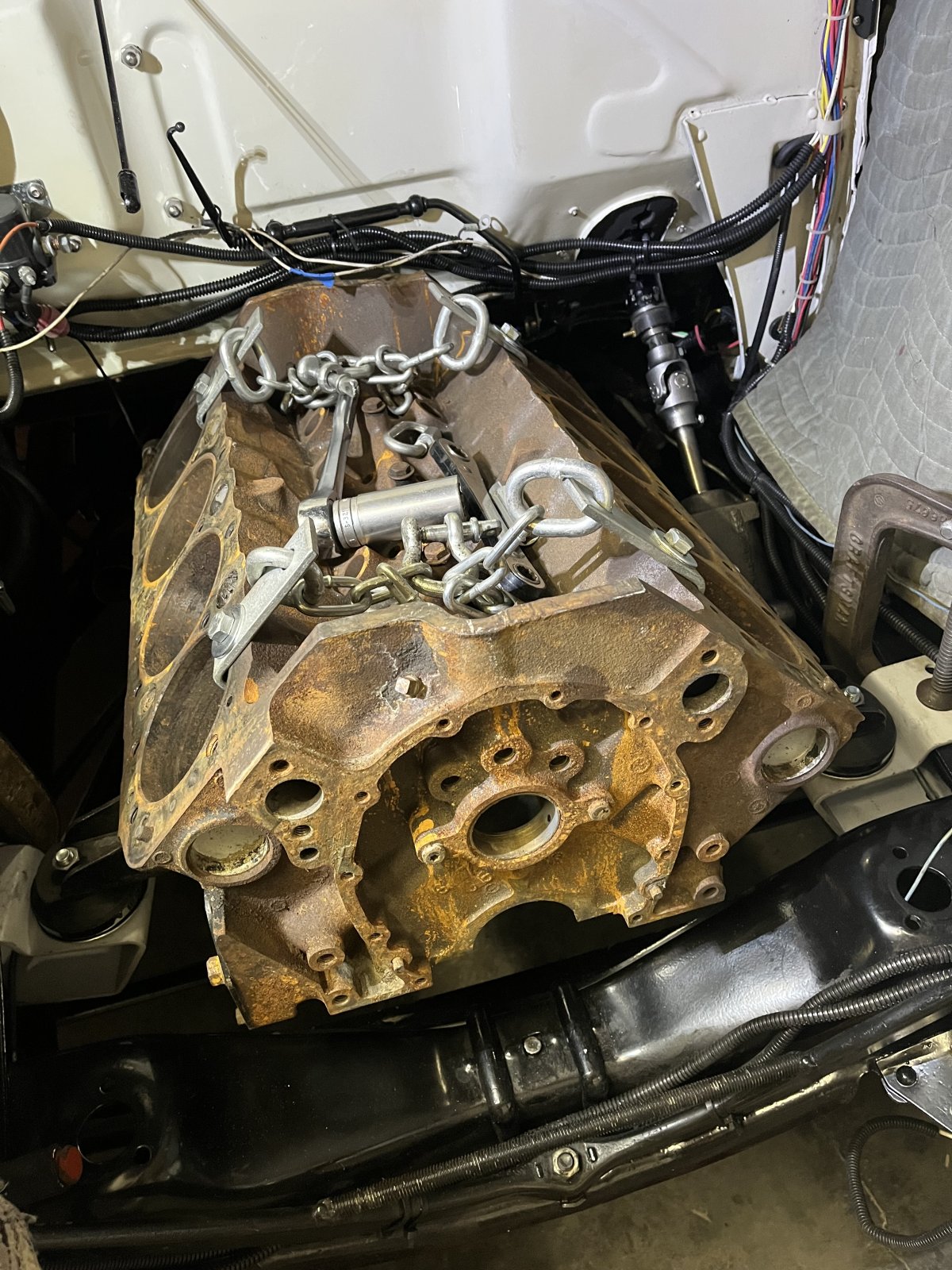

  3. Hard to believe, but there was some positive progress on the motor mounts today!
    Got the bare block slinged up, dropped it and the CE motor mounts in place (almost).
    “Almost” because the block won’t quite pull up tight to the Cragar trans adapter on the passenger side!
    I can’t tell if the bolt is binding or that block hole is a little shallow, or the block dowel is stuck.
    I’ll get it in the air on the lift tomorrow (fixed the cut power cord!), get a better perspective, and try a couple of fixes.
    One thing’s for sure, the bare block was harder to do than I anticipated. I should have pulled the front fenders. Every other time that I’ve installed an engine there was no front sheet metal. Using a complete engine would not have been fun by myself. Been done 1000’s of times though. But glad to report no damage, not even a scratch!
    Tomorrow hopefully get the holes marked and drilled and the lump back out.

  4. Well it was a combination of the block a wee bit out of alignment and binding the bolt and the dowel, and something in the bolt hole. Jacked up the corner of the block with the floor jack and a pipe, got a different bolt and everything pulled up tight, as it should.

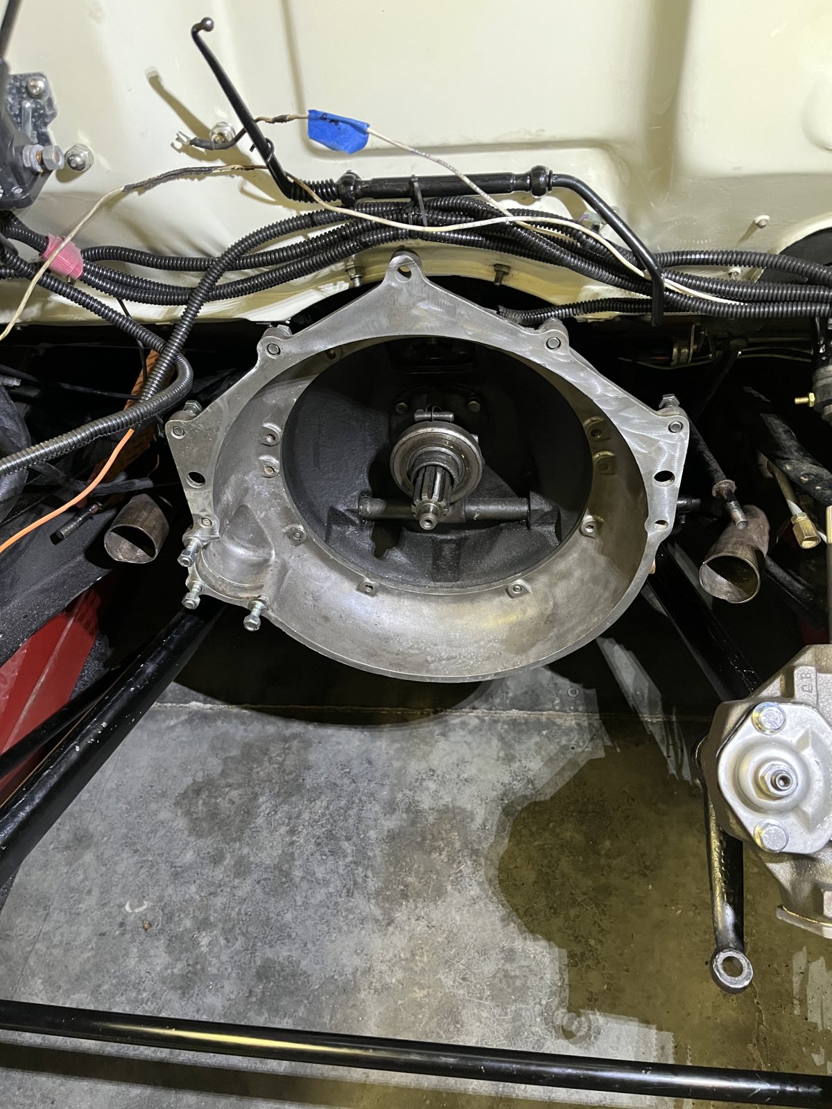

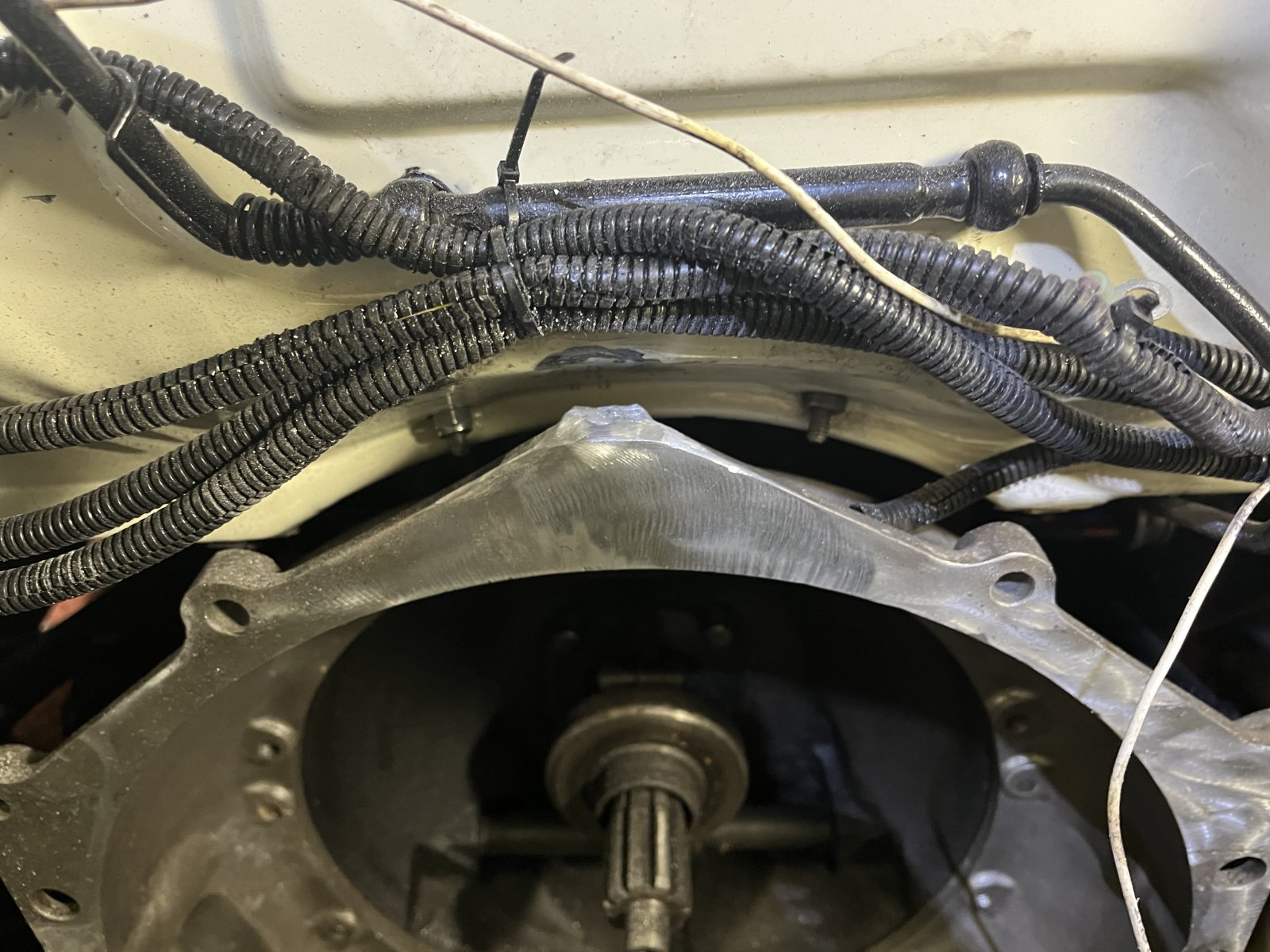

  5. Well, another toe stubber.
    The Cragar adapter has a TDC tab or ear to bolt it to the corresponding boss on the SBC. See on pic.
    The boss on the new engine is neither drilled nor tapped.
    It is just hitting the bottom lip of the firewall.
    Can’t lower front CE mounts any.
    Options:
    1. Move engine and trans a 1/4-1/2” forward.
    This would require trimming inside bottom flange on the CE adapters, as they’re hitting the inside of the frame rail.
    Trans support plate bolted to x-member would need to be remade or redrilled to match stock trans mount holes.
    Clutch shaft pivot arm ball might have to move..
    OR
    Trim off tab on Cragar adapter and don’t use that bolt. Use 6 bolts instead of 7.
    Leave CE frame adapters as is and carry on.

  8. Right now that’s the plan. It’s just scraping the radius on the firewall, as can be seen by the chipped paint. With it removed, there should be enough clearance.
    In fact, if there is enough room to raise the engine 1/4” with a spacer at the CE biscuit, it may give enough room to clear the fuel pump inlet.
    It’s awfully close as is. Sure would save a bunch of work clearancing the front crossmember!
    Just touch up the paint.
    And get rid of all that plastic loom!!

  9. chicken
    Joined: Aug 15, 2004
    Posts: 626
    chicken
    from Kansas
    Yeah, no need for that top bolt. Even the factory quit using it.

  11. Cut that top tab off. Had the same issue with my 39. I have nearly 25,000 miles on my 39 since it got back on the road and not one issue. Also look into a 55/56 small chevy distributor or, a Mallory distributor, they are a little smaller and give you noticeably more clearance at the firewall. A MSD or standard chevy points will fit, but it get tight quick.
  12. Got the top tab cut off without having to remove the adapter. It beat on the firewall more than I first realized but a little touch up primer and paint and it won’t be seen back there. Oh well!

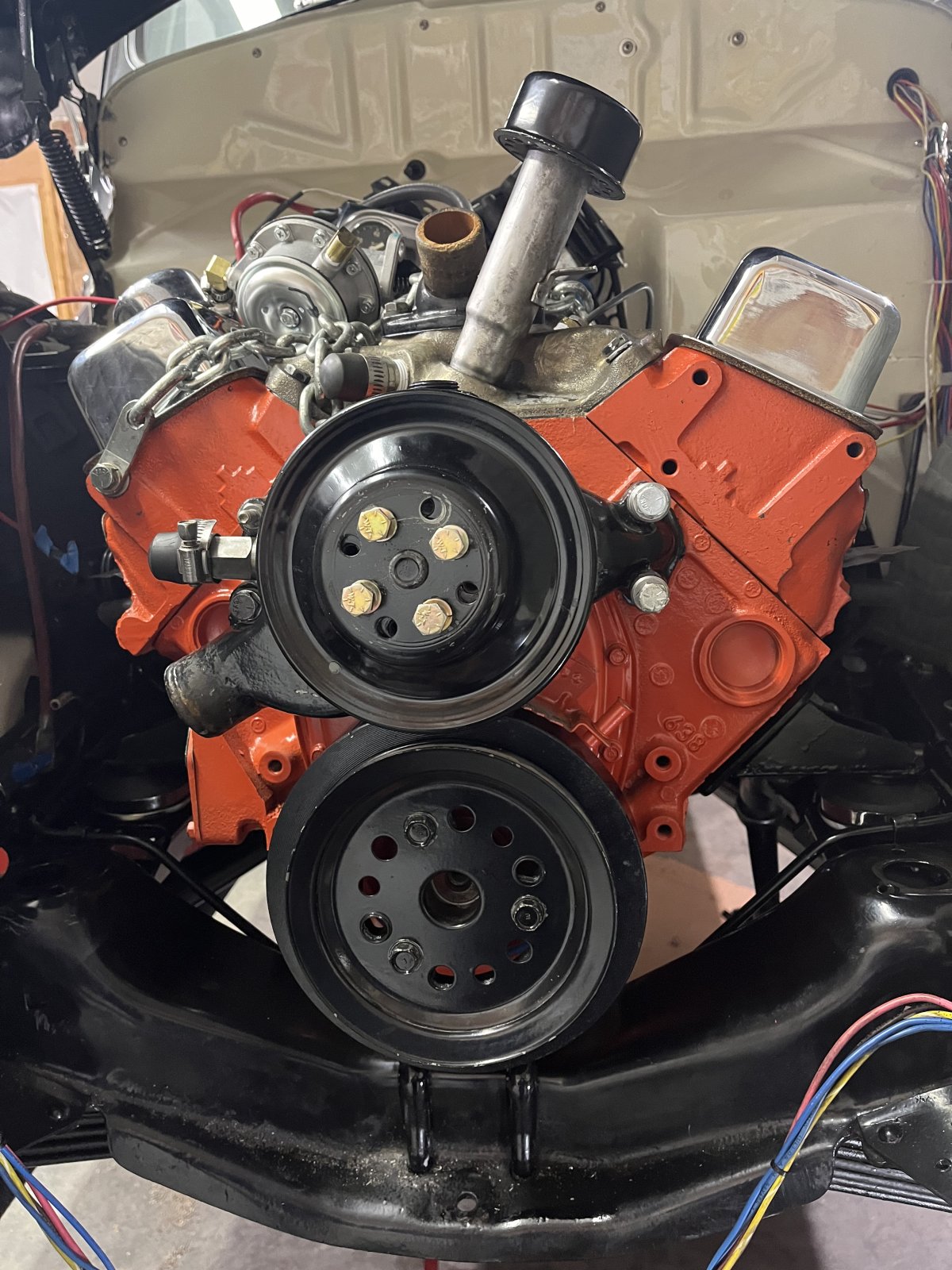

    I have a small Chevy points distributor as well as a Mallory so there should be good clearance.

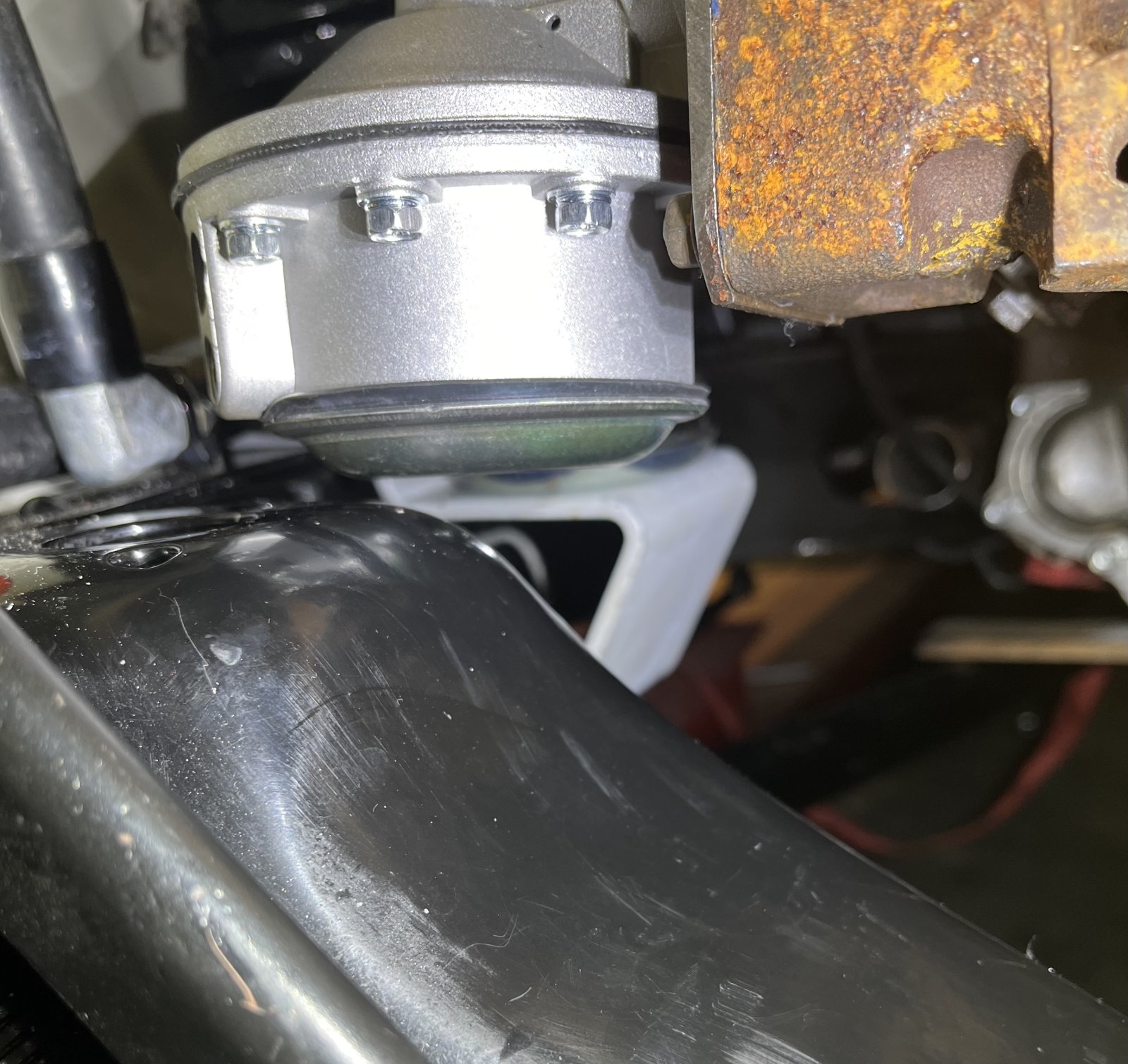

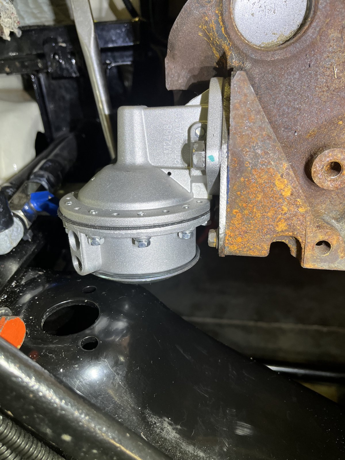

  13. I Got the CE frame mounts all in place and bolted down tight, and got the bare block back in.
    I had stashed away a couple of 1/4” thick x 1-1/2” diam. flat washers with 1/2” i.d. holes that came from who knows where.
    I placed them between the CE block mounts and the upper rubber biscuits, raising the engine 1/4”.
    I also picked up a 50-60’s Corvette (?) fuel pump to replace the one I had bought earlier which had bottom fittings that hit the crossmember. This would have required some crossmember mods. The new pump has a clean bottom and fittings that go into the pump body. It is also adjustable so the fittings can be indexed to the best spot.
    It’s a Carter M2468, or equivalent.
    With the spacers and the shorter pump, I now have 1/4” clearance between the bottom of the pump and the crossmember. All that’s needed are a couple of longer 7/16” bolts for the CE mounts.
    Now I don’t have to cut, weld and repaint the normally required step down mods to the crossmember!!! Moving on!

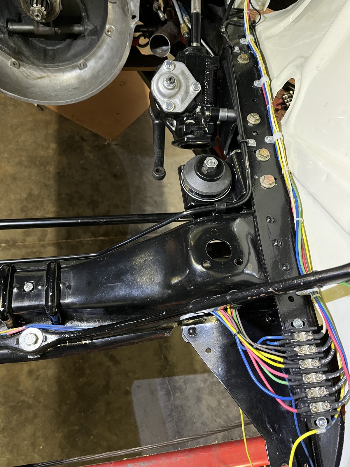

  14. Pulled out the bare mock up block for the final time (he says with fingers crossed)
    Started on the fubar wiring by stripping off all the plastic loom.
    Note: yellow wires call for yellow wire nuts!

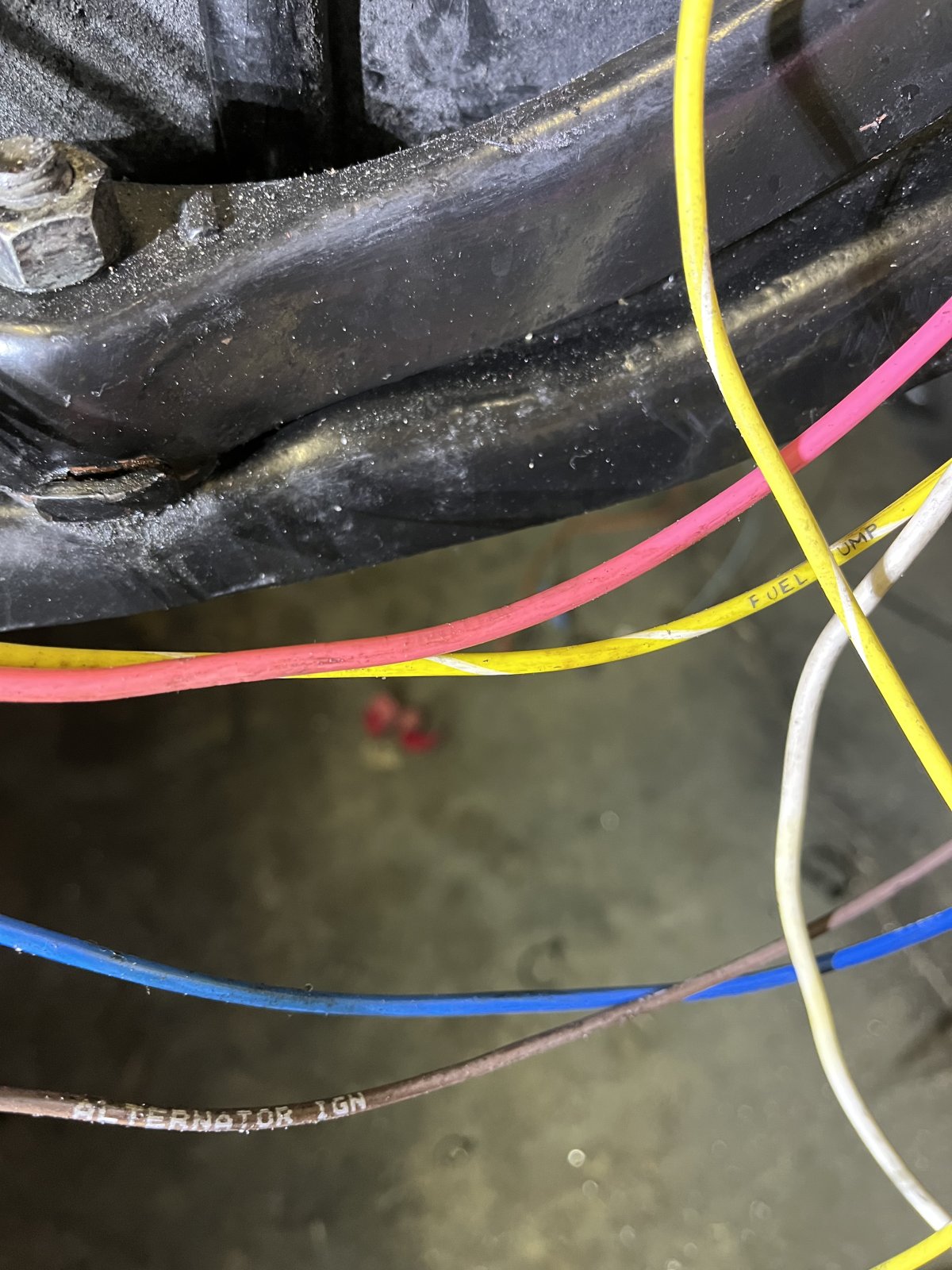

    That led to an interesting discovery of unlabeled and mis-labeled wire!
    For instance, these two labeled “alternator” and “fuel pump” run to the right headlight!
    No terminal blocks or Weather Pack plugs, just bullet terminals covered in shrink tubing.
    So NO disconnects for lights, signals, horn.
    More opportunities. RIP HAMTOWN AL!
    Bandit Billy likes this.

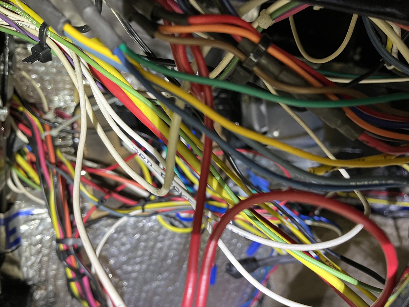

  15. It gets worse.:eek:
    Multiple wires spliced, making up a run. Different gauge wire in the same run.
    Different colors or the same color as an adjacent circuit.
    Not bullet connectors, but 10 ga. crimped butt connectors, neatly shrink wrapped.
    Still have to trace back the wires terminated with house wire nuts. WTF!
    It’s going to need at some point a TOTAL re-wire, just not now.
    Since everything is/was working up front, and it has a 10 circuit panel along with a couple of inline fuses, I’m going to tidy it up, cut off some excess, add a junction block, some woven loom and get on with it.
    The under dash is a worse cluster f**k, also with no I.D., rolled up excess lengths and crisscrossed circuits.:confused:
    A real snake’s nest! Yet every terminal end is neatly shrink wrapped.

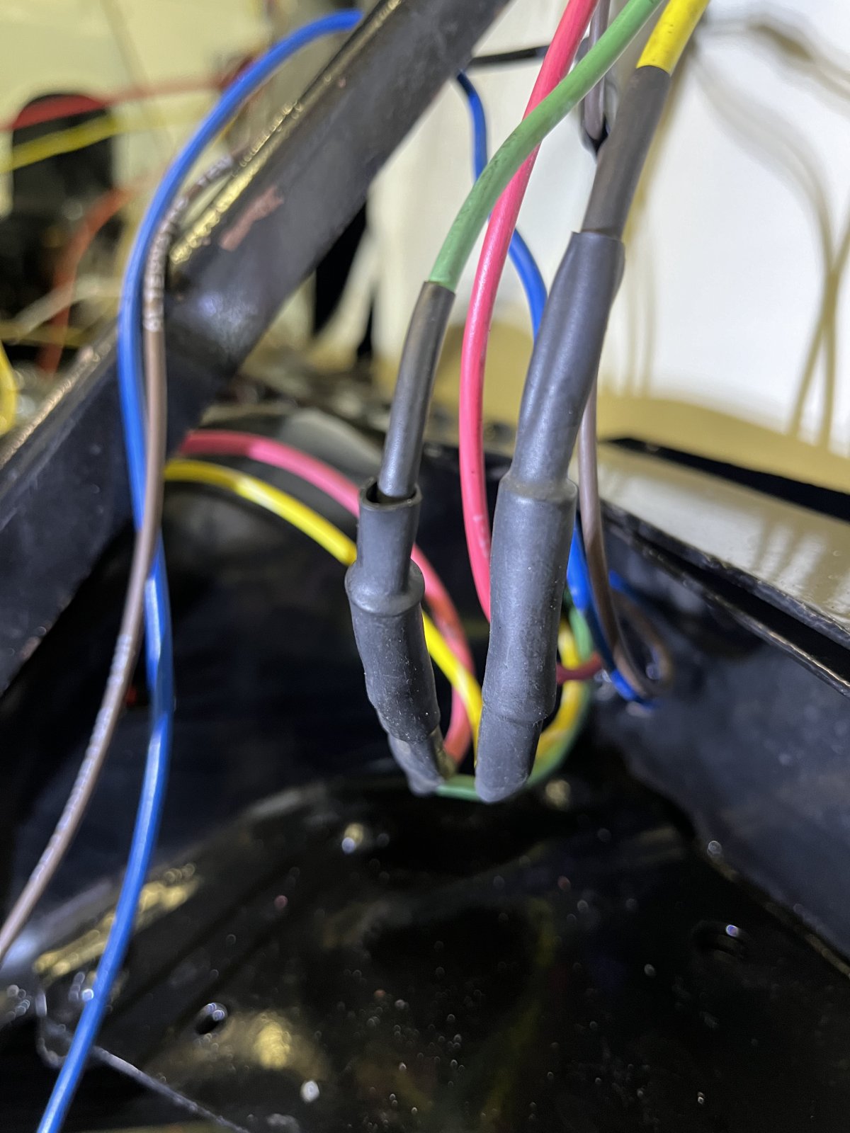

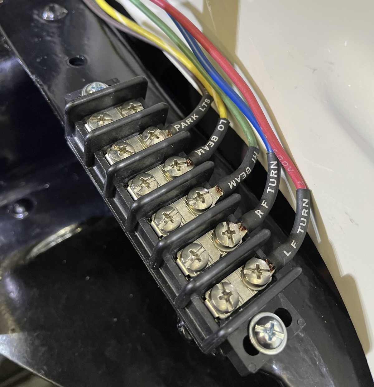

  16. I decided to use what was there to get Fatso back on the road, and let the rewire wait for some future time, as it looks like a total gut and rerun. But I had to strip it down to the headlight plugs just to decipher the colors of the spliced wires. Got it figured out, put in a junction block with the feeds marked. Just need some loom or lacing. Now I can redo just the front wiring if it comes to that. Still have that mess at the firewall to deal with. Press on!
    (OOPS! Two pieces of shrink tube are bass-ackwards.:eek: There goes the Riddler!):rolleyes:

  17. This mess of a wiring job by SOME fool is wearing me to a nub!:mad:
    Managed to finish up all the front light circuits and got everything working as it should.
    Traced down the the four long dead and mislabeled wires back through the twisted bundle, through the snake’s nest behind the dash and pulled them out. Also found two bare and burnt wires for the electric fan so I yanked that whole circuit. Not planning on running one.

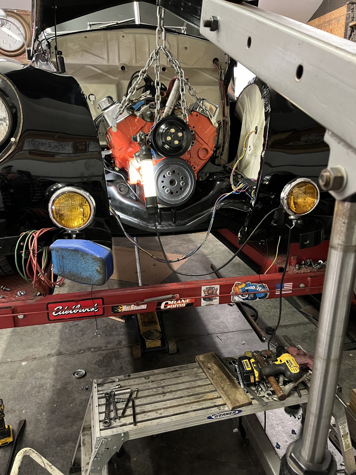

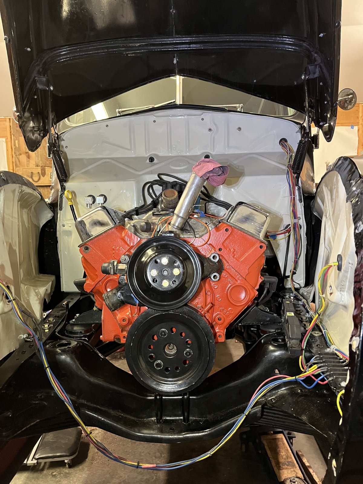

  27. Some long awaited progress!!
    Thank God for my good neighbor and friend, Bob!!
    He’s been turning wrenches on trucks for over 40 years, so it was time to put him to work since he’s also retired.
    With his help we got the engine bolted in.
    It was great to work with someone who speaks the language and knew what to do. I sure couldn’t have done it by myself!
    With the lift being stuck and the car three feet the air, the first challenge was having enough lift height on the engine hoist to get the oil pan over the crossmember.
    I ended up pulling the carb, shortening the chains and removing the swivel and hook from the hoist.
    With me on the engine hoist and Bob underneath we did a dry run and ended up pulling a few interfering bits off the engine. Then it was go for broke and after a lot of wiggling and swearing, we got the input shaft into the disc splines and the trans adapter tight to the block. The CE mounts wiggled into place and we tightened her down. YAAAAYYYY!
    Remember earlier how I got the fuel pump to clear, and saved having to cut and box the crossmember?
    Well, it doesn’t clear any more!! WTH,!!!!
    Surely the CE motor mount biscuits didn’t compress over 1/4” with the loaded engine!
    More opportunities!
    Stay tooned!

  28. Chasing my tail and going in circles this week. S.N.A.F.U.
    Not enough clearance between the distributor and firewall! Maybe only 1/16”!
    And the right rocker cover hits a heater mount stud! :eek:
    Decided to move the CE frame adapters and trans mount holes forward.
    Hooked the hoist back up but lifted it from the front of the heads, and raised it just enough to pull the frame adapters out.
    Moved them forward, lengthened the slotted holes in the trans mount and slid everything forward 3/8”.
    Also spaced up the trans mount 1/4”.
    Reinstalled the frame adapters inside the frame instead of on top which dropped the front of the engine down an extra 1/4”.
    Now there’s 1/2” clearance at the distributor and 1” at the right head.
    Clutch pivot is good.
    And the engine is now level!
    Lots of aggravating extra work, but I feel better about it all.:D
    Had some tight working quarters with the hoist boom and chains in place. Had to climb up on the bench also. o_O
    Deja Vu, all over again! All in and buttoned down for the last time, he says. :rolleyes:
