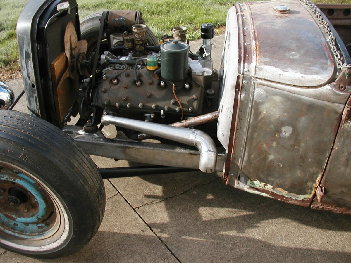

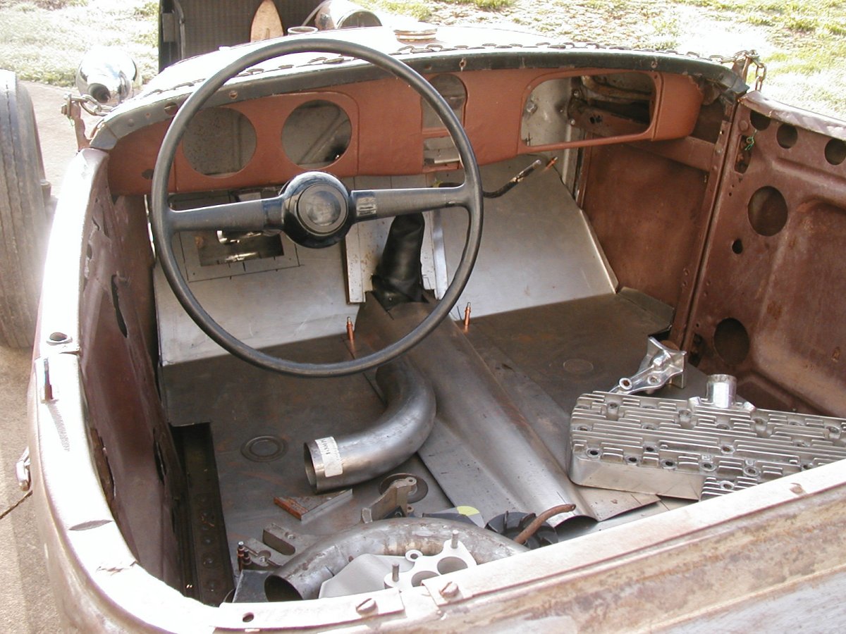

  4. You mean like this? Oh, and that's a 37 Dash so I could mount the stock column drop and run all stock Ford gauges. You can do it but things aren't just going to bolt together. The real driving force here was I wanted a Glove Box in the Roadster.

  17. Go to post #4 here and look. Notice the ear on the Frame rail between exhaust port #1 and #2 and then the steering column coming up between center exhaust port and rear port. NO pitman arm coming through the frame rail. That's cross steer with a 40 box.
