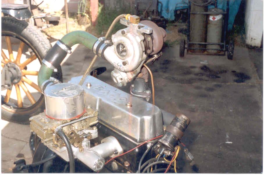

  14. Black*EyE*Bandit
    Joined: Dec 18, 2007
    Posts: 15
    Black*EyE*Bandit
    I would be curious to see how your build with the T-bucket goes while incorperating a 2.3! The blower doesn't sound like a bad way to go. I'm only using the turbo because it's what I have on the car currenlty and works rather we'll.
    Good luck and keep us in the loop.

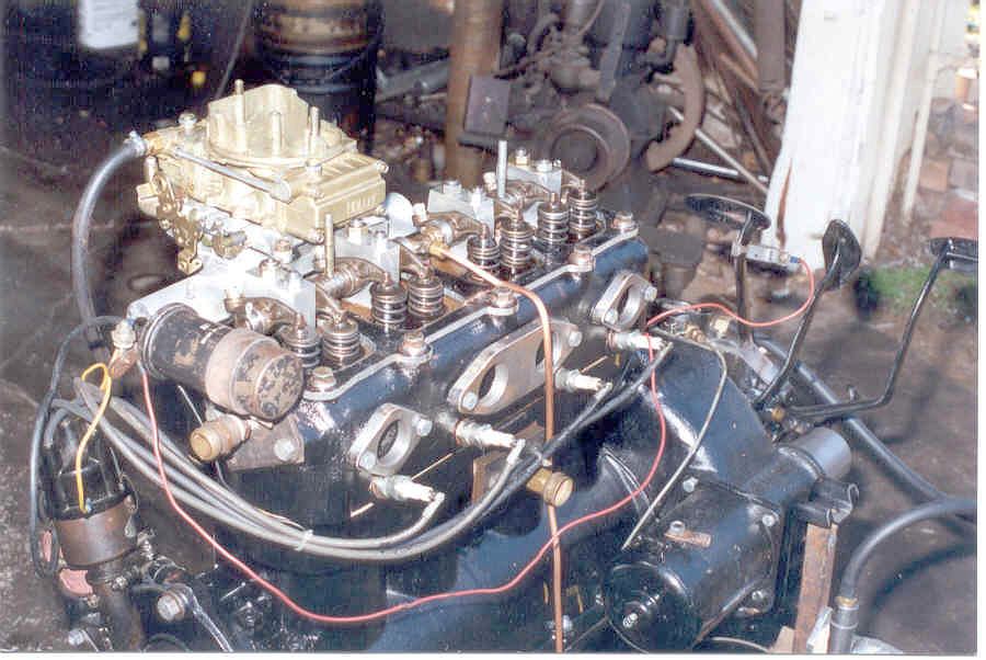

    I'm betting this'll be the smallest (dimension, weight AND displacement) 4 banger up here... This is the ***eol block I'm building up for my '51 Crosley roadster. ***eol bought out the rights to the Crosley motor in the late fifties and began bumping up the HP. Stock Crosleys were 26.5, ***eol eventually claimed 44. compression will be 11/1 with Zollner high dome pistons.
    I've got a Braje aluminum oil pan, water jacket covers and cam cover to go with the dual exhaust. Carbs are NOS Tillotsons rebuilt with new gaskets. Chuck Koehler designed the linkage, and I've also got a set of his headers ready to go.
    Not too far along on this, but I'm hoping to get a lot more done this winter.

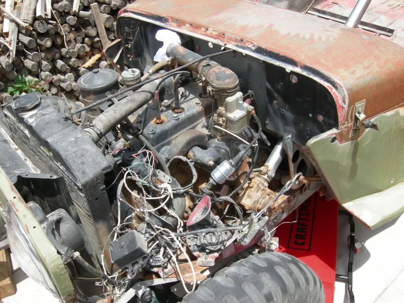

    Here's something I can fit in, I believe :D Willys Go-Devil Flat 4.
    Fresh from a side yard-[​IMG]
    And machined.
  20. Flat Ernie

    I was seriously contemplating a little Go-Devil for my Model-Y when I was in the UK - stock, they had 60hp from 134cu", so not too bad.
    A company called "Hickey" made an aftermarket hi-comp head for them too - very hard to find these days. Last one I saw on eBay went for about $700 or so...
