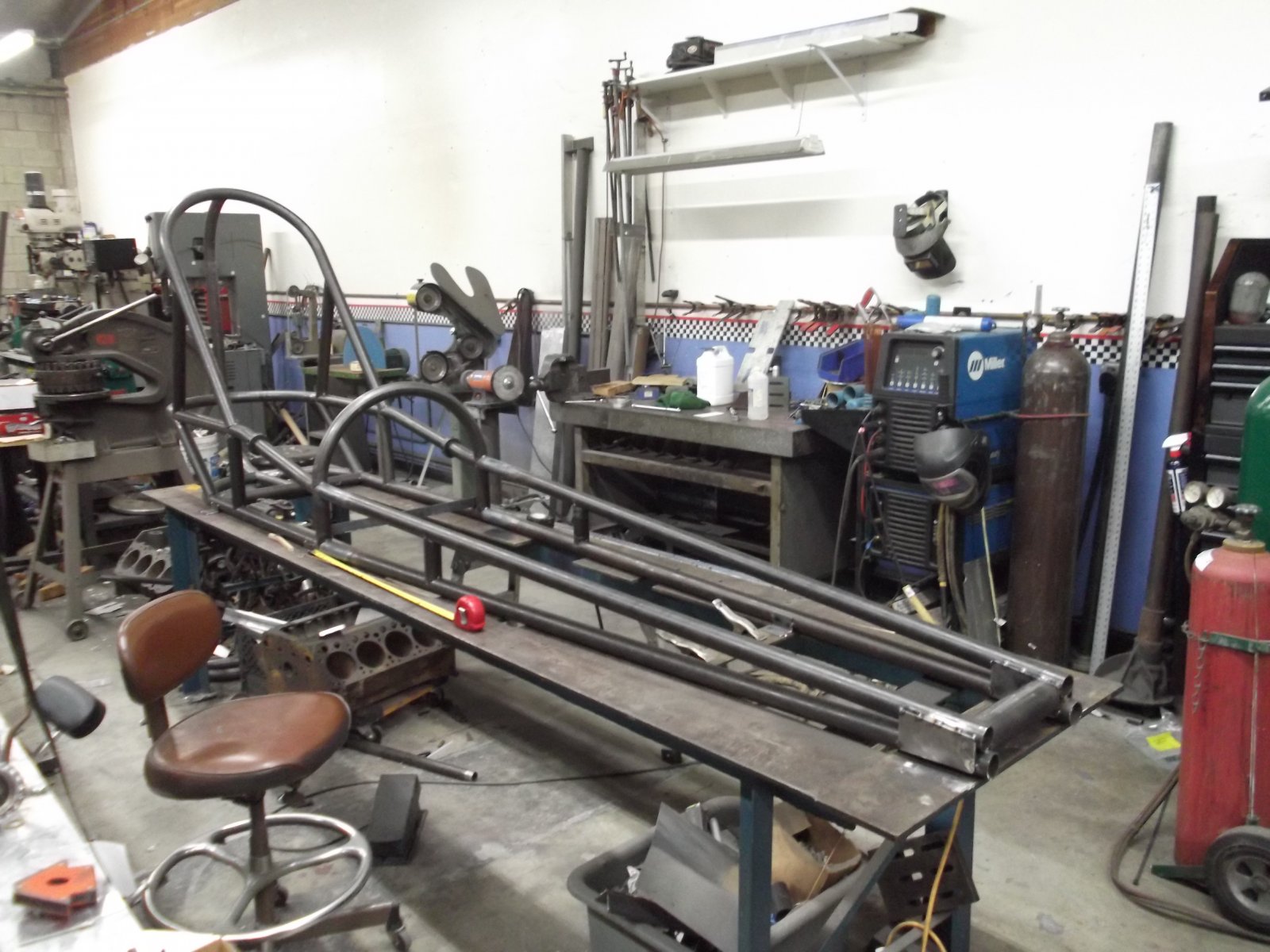

    On the build table right now using prints from 1960 upload_2022-2-25_8-7-33.jpeg hambster.jpg

    ^^^ thanks for the plans! Should be great for nostalgia events with thin wall tube, doubt if means “modern” rules but…. Would love to build 60s type junior fueler with modern type SBC tech. All about havin* fun raising hell

    I'm using .095 chrome moly because I found it to be a couple bux more the 095 mild steel, weight make no difference in what I am doing and did not want to build out of .065. Bending the 11"R was expensive as I could not find any local bender that had the dies, so I had to have it rolled into an 11"R. 8 bends were $500 and I did the "Z" bend myself on my bender.
    The purpose of this build is to show others that in 2022 , you can build a period perfect 1960 style dragster and using parts available within that timeframe. About the only modern items Im going to use are the rear axles, going with flange axles instead of tapered hubs on roller bearings

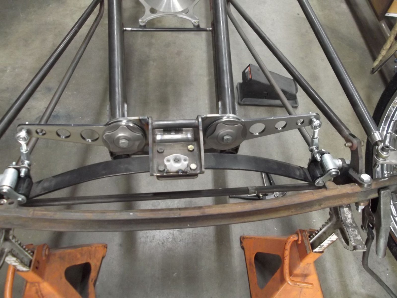

    Cute motor. Weber carbs?
    Where did you source those front friction shocks? Spiffy

    I used the VW Webber manifolds as they were cheap to build the manifold runners for a POTVIN style 4/71 blower set-up with Hilborn fuel injection. Designing the plenum as we speak
    The Friction shock deal is something I CAD designed and sent out to be lazer cut upload_2023-2-10_11-53-5.jpeg t
