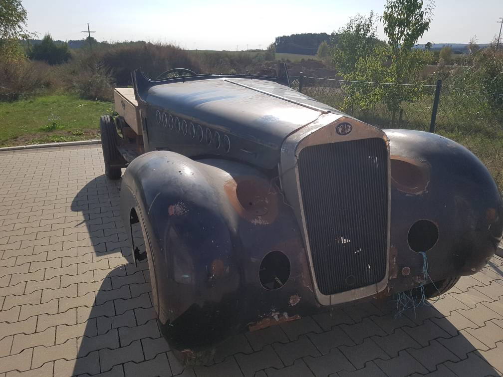

  28. rustmerchant
    Joined: Feb 26, 2008
    Posts: 84
    rustmerchant
    [QU
    hello Ed is the delage for sale thanks Tom
    OTE="rustmerchant, post: 14758475, member: 50571"][/QUOTE]
