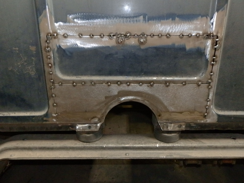

    Notched rear of cab, tunnel/floor support and patch plate for old filler neck hole.

    I agree with you about the chopping issue. These trucks have some of the best stock proportions out of all the early '50s trucks, but the lower the tuck sits the taller the cab looks, losing its balanced proportions, especially the windsheild. When it sat at stock height there was a good amount of negative space under the rockers that balanced the top of the cab, I knew I would need to chop it but not a lot. I did a series of photochops of different sizes and 2" turned out to be just right to restore what I feel is the proper balance.

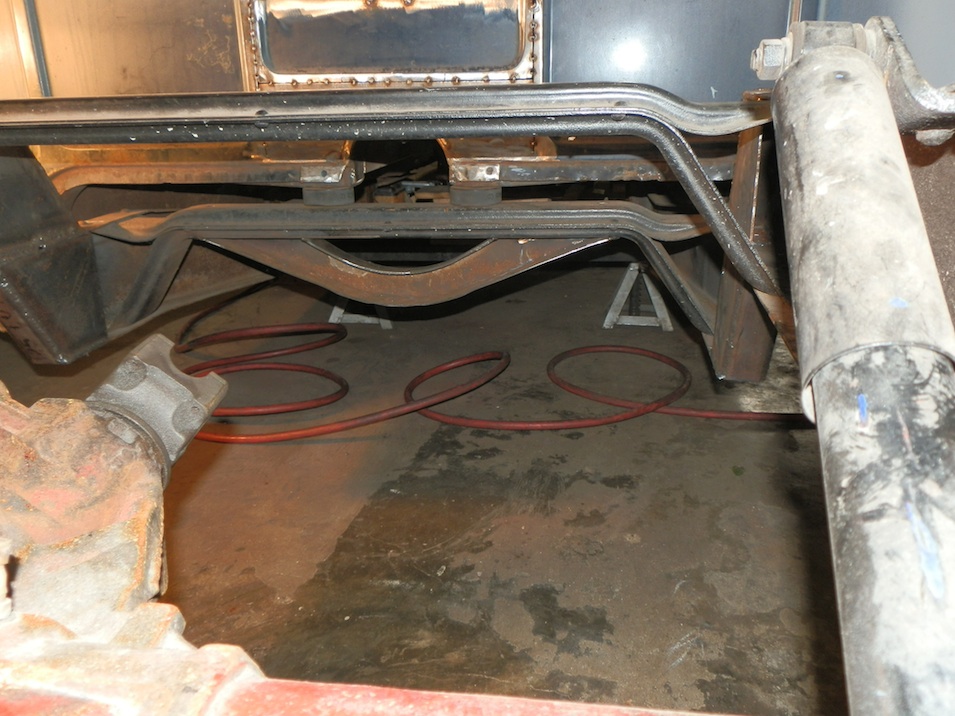

    We had a Club meeting yesterday in the tiny garage. Gave me some drive again, thanks guys. They started on the rear cab mount crossmember mods for the driveshaft and boxing plates for the rear frame kick. The cross member piece is a pre-war dodge rear crossmember from Rick's 46. I finished up the trans tunnel piece today.
