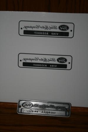

    Here's an attempt using the staples photo paper. Hopefully the PNP stuff transfers and sticks better. You can see where it lifted in some spots. The lines aren't very crisp either. Also need to find a good way to trim them.

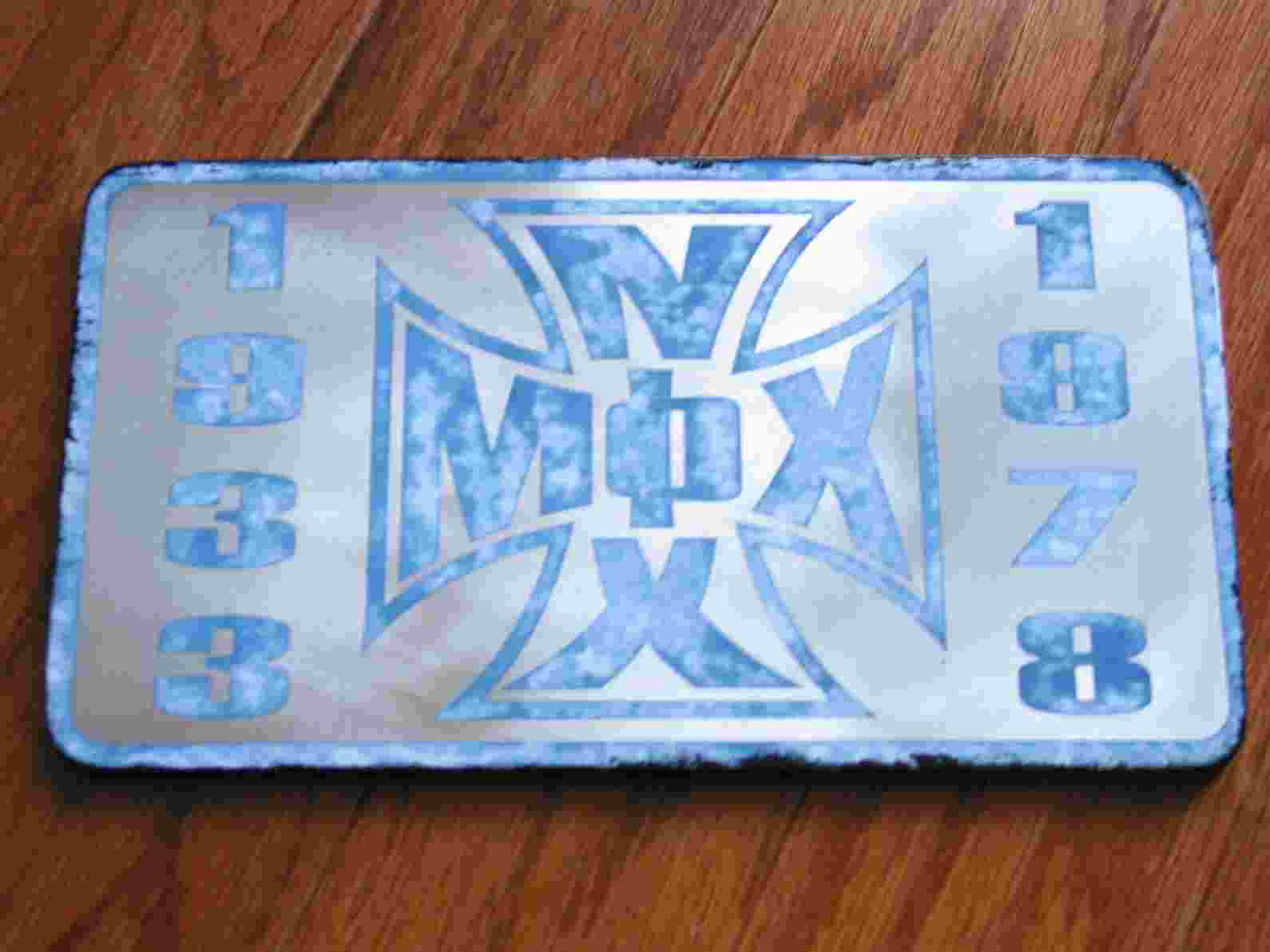

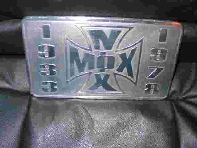

    I picked up some of the PNP blue last week and it very much worth the price. It's so much easier to use than inkjet paper. It took me a while to figure out the transfer process, but I think I got it now. I wasn't heating it enough. Now the designs come out crisp and clean. I'll have to take some more pics, but here are a few.
    And here are a few of the older ones that have the 'distressed/old' look to them:

    I tried the muriatic acid/hydrogen peroxide etchant. I like it better than ferric chrloride and it's much cheaper. Here are some samples. The br*** ones are .064 and I left them in for about 3 hours (it was about 40 degrees in my garage). The alum I left in for about 5 minutes.
    Does anyone know if there is a reason to not use this mixture with aluminum (in regards to safety)? I haven't found anyone else doing it. The reason why I ask about the aluminum being dangerous is b/c it etched so fast compared to the br*** and it generated quite a bit of heat.
