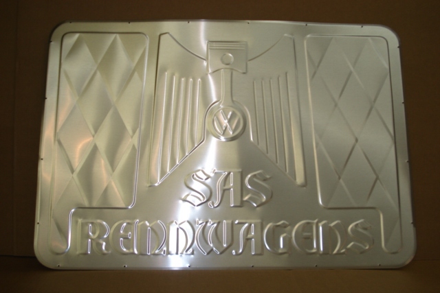

  15. BigWigRaceCars
    Joined: Aug 7, 2006
    Posts: 171
    BigWigRaceCars
    from Austin, TX
    Here's a new set of door & quarter panels I finished last week for a guy in the SAS RennWagens club in the UK.

  17. harrydude
    Joined: Jan 3, 2010
    Posts: 96
    harrydude
    from ab
    can you answer a few questions please?
    main uestion is how do you get the diamonds ?? what rolls do you use??
    can you post a picture of your roller?
    thnaks
    great werk.....I hope I get half as good as that
  18. BigWigRaceCars
    Joined: Aug 7, 2006
    Posts: 171
    BigWigRaceCars
    from Austin, TX
    Check back on pg 11 for a picture of my roller.
    For the diamonds, I use a tipping die on top and a very shallow V die on the bottom. The tipping die is standard from Mittler Bros or Pro-Tools and the V lower die is custom. I think you can use a soft lower die, like a skateboard wheel, and get a similar effect (still using the tipping die on top).

  25. BigWigRaceCars
    Joined: Aug 7, 2006
    Posts: 171
    BigWigRaceCars
    from Austin, TX
    That's done with step rolls. It doesn't take much of a step either. On the aluminum stuff, I generally step something around .040 or .050 in .032 material, so just slightly over 1 material thickness. The less you step it, the less it warps, especially when doing the complex designs.
    If you don't have step rolls, get something like an .090 or 1/8" set of steps, but you don't have to run them at full depth. That allows you to run two lines close together without squashing the first line.
