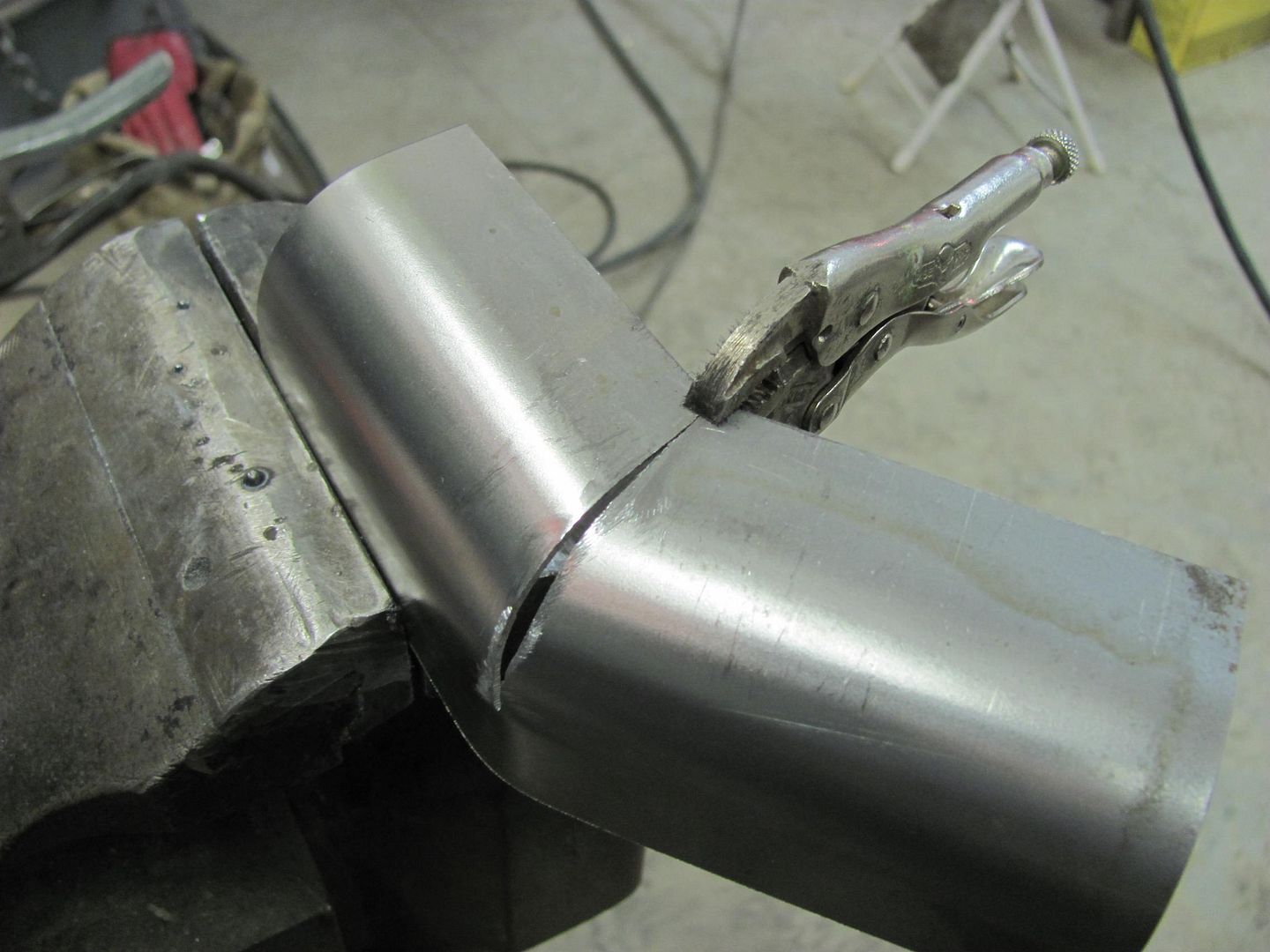

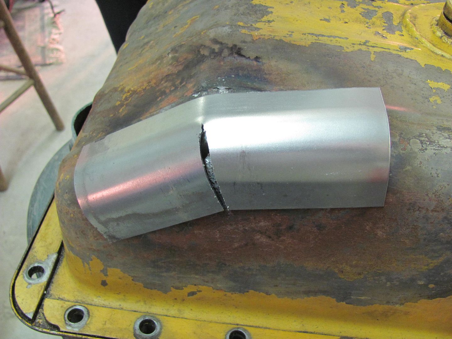

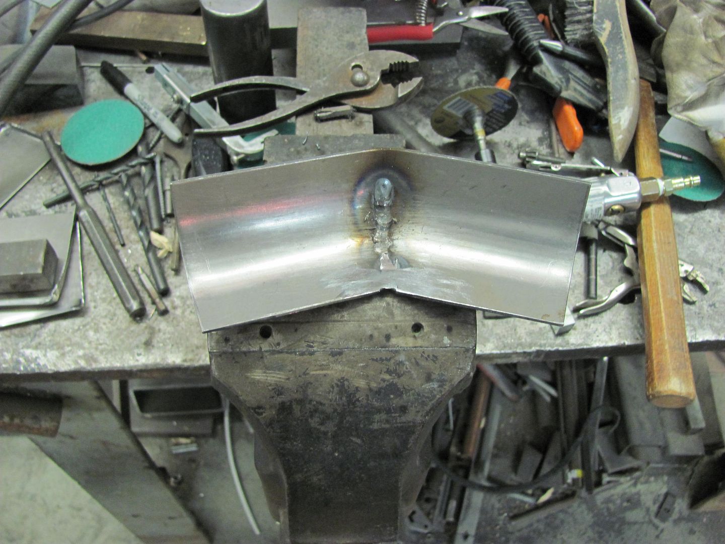

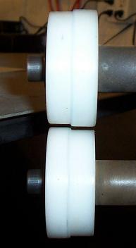

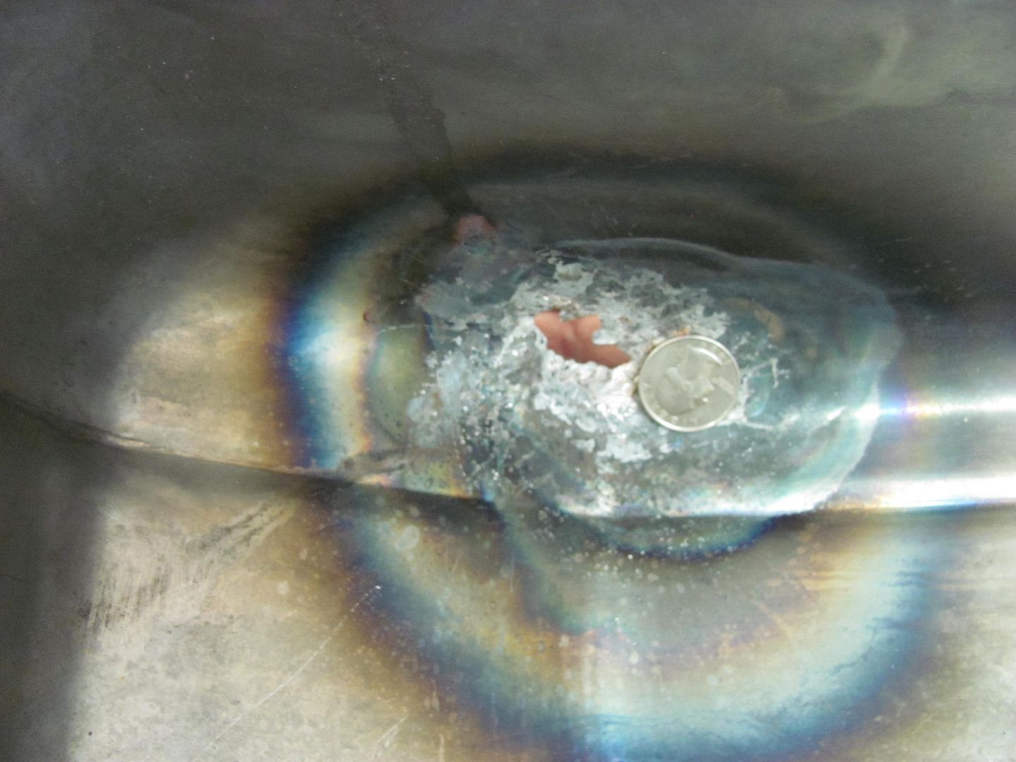

    Does a D5 Cat count as custom? Oh well, this will show you guys another option in using the bead roller....
    So today I got a phone call, and long story short, needed to do some metalshaping for a Caterpillar D5 dozer. No, really! The last time this same mishap occurred was over ten years ago in my back yard. It seems dirt/mud gets packed between the stump pan and the oil pan, until a hole rusts through the oil pan. Last time Paul bought a new oil pan, but it sounded like he needed to use the dozer this week, so he brought it over for repair..
    The heat marking is where he was attempting to braze it closed, with little success. Calipers showed the pan to be 14 ga, and I just happened to have some in stock. I've used the bead roller before to form a radius, but never on metal this thick before. This will be a good test of the fancy 75A durometer skateboard wheel to see how well it works.
    Took a few p***es, but worked real nice. Now for a relief cut and a weld...
    Rust hole removed, patch trimmed and fitted, then welded in place..
    .....and Paul cleans it up for paint..
    You never know what you see over here in the shop.... :eek:

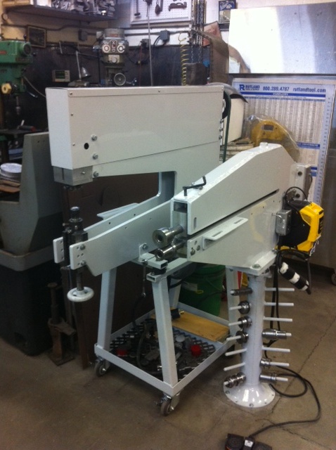

    Shot of the new power hammer and bead roller I just finished.
    Seeing what you three have done makes me want to get out there and use them.

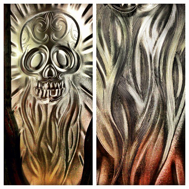

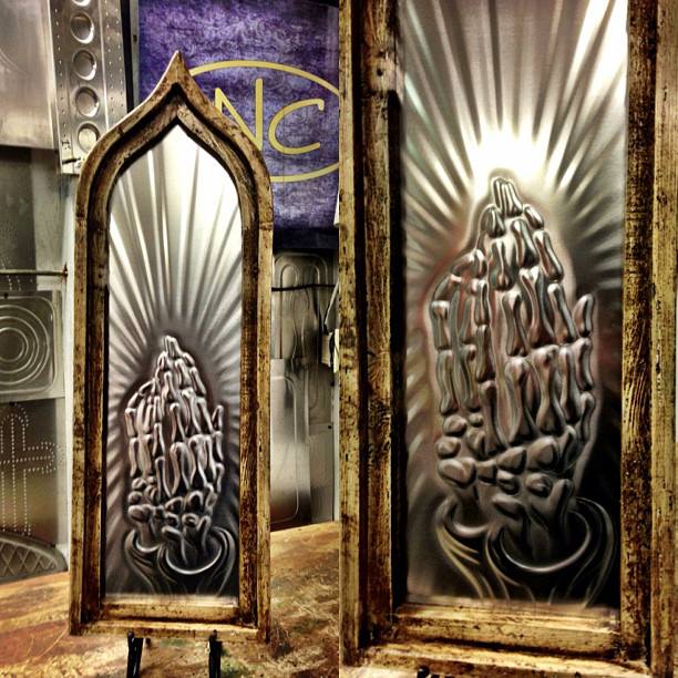

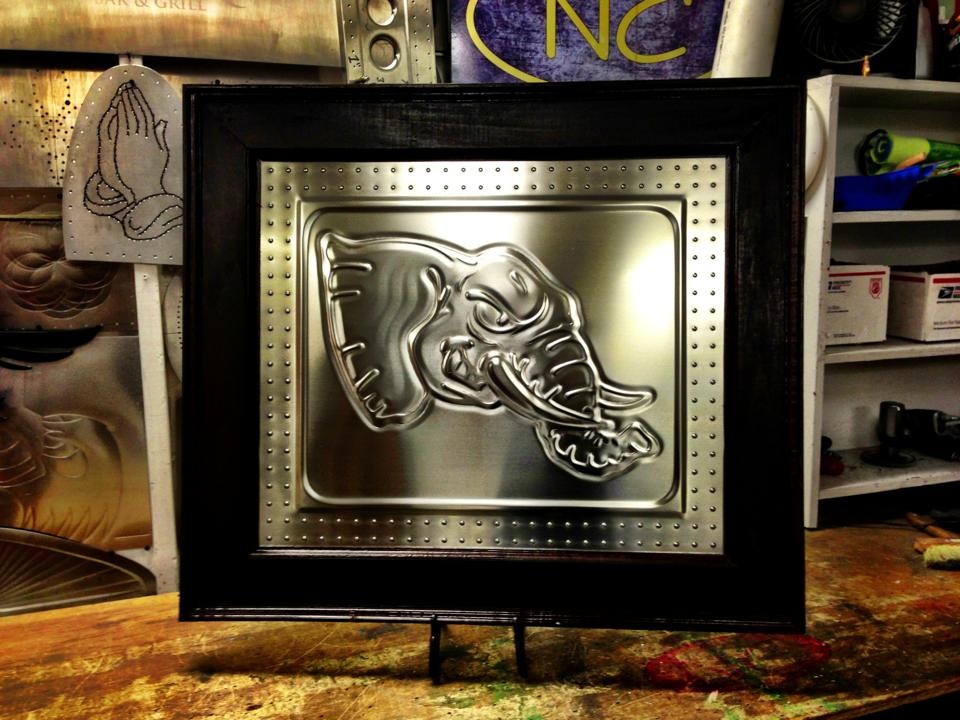

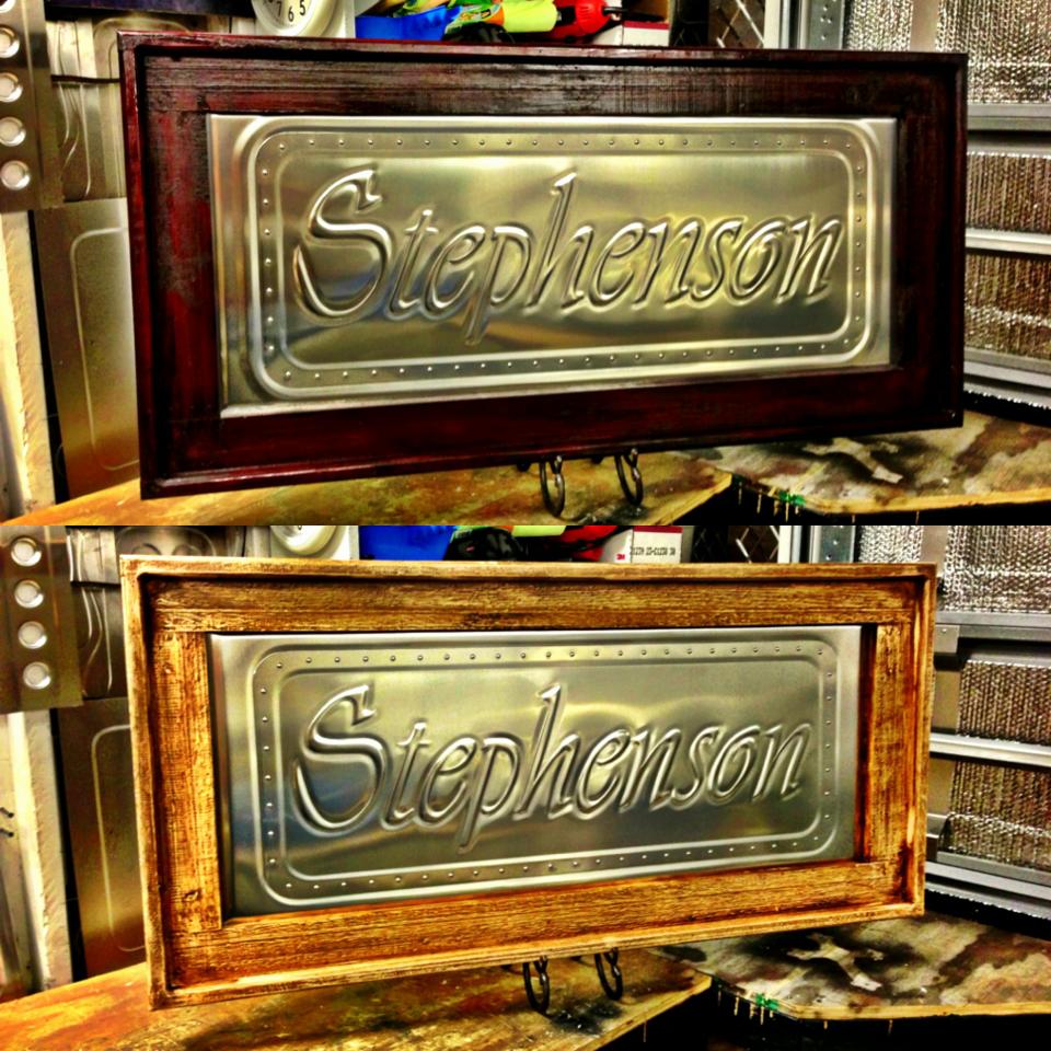

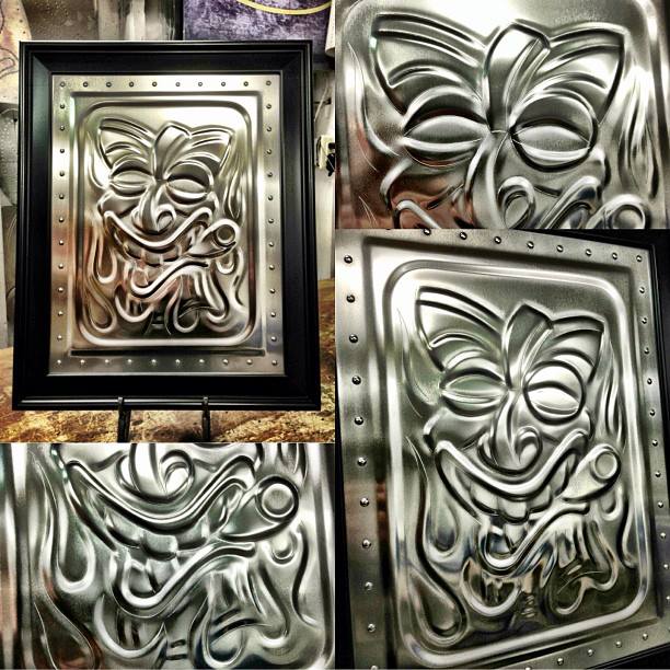

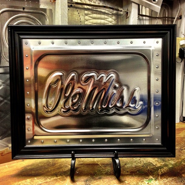

    Here are a few of the panels I have done the last couple months..

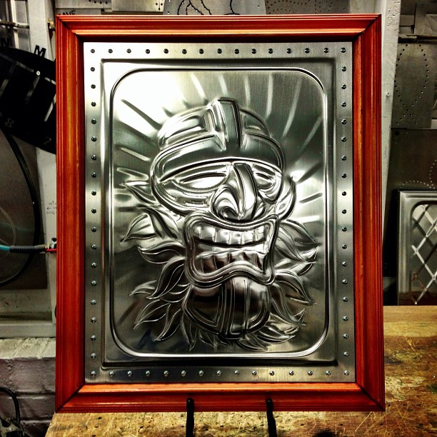

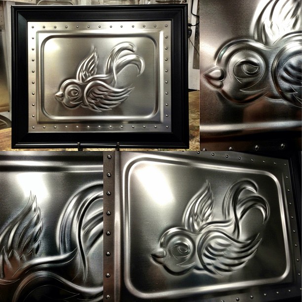

    Few more..

    All the work is do is done with the Mittler Brother - Jamey Jordan Signature Series 36", I use the MB-JJ Art Roll sets to do everything...
