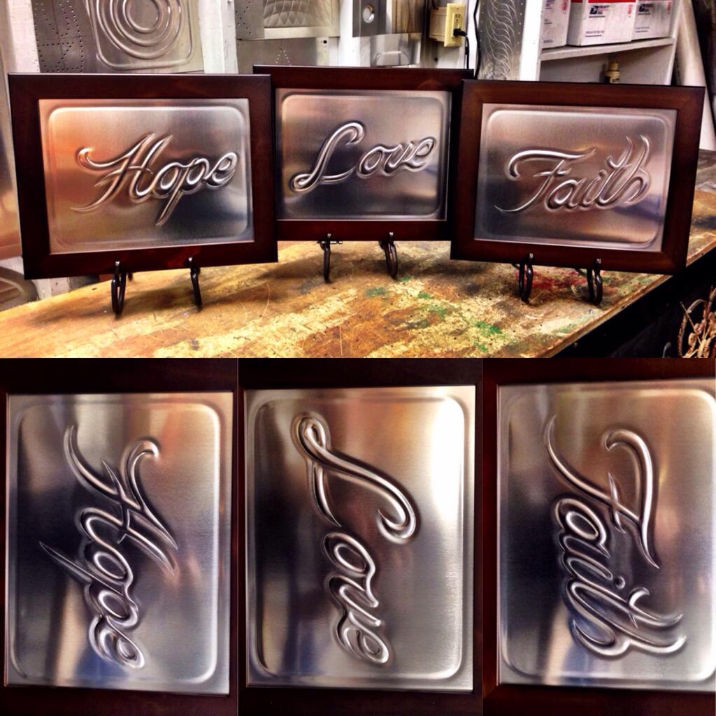

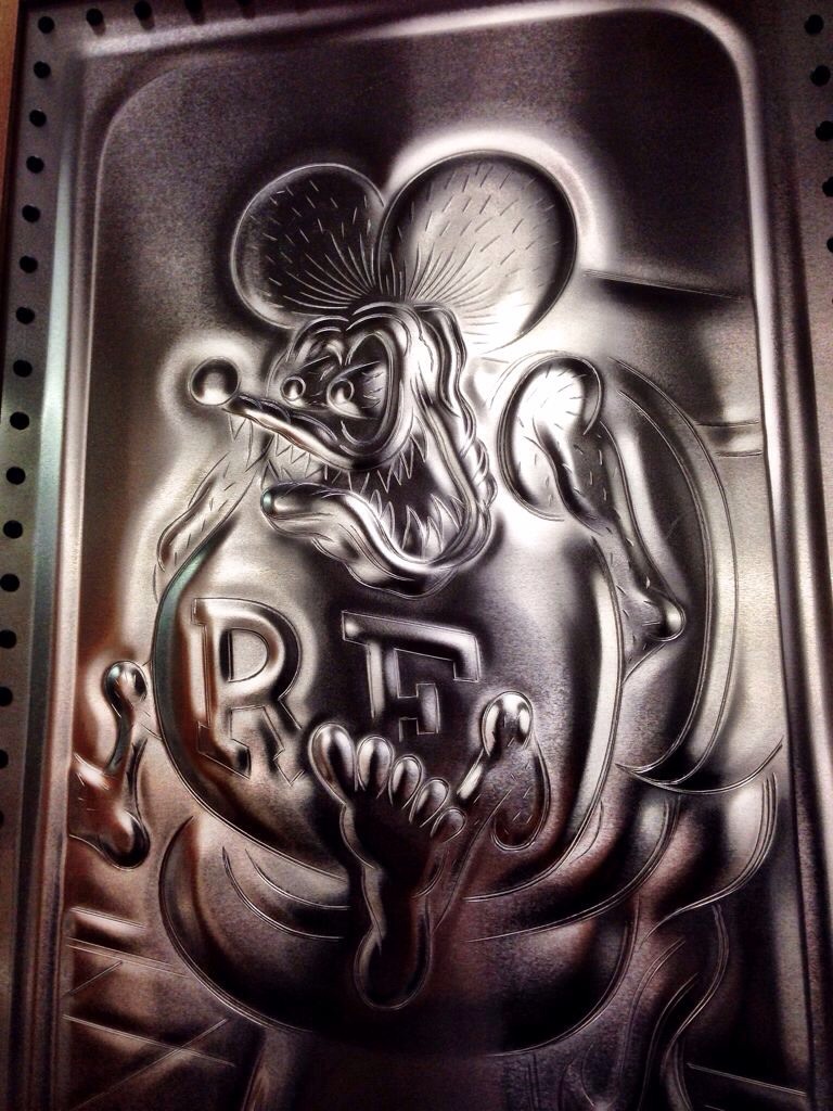

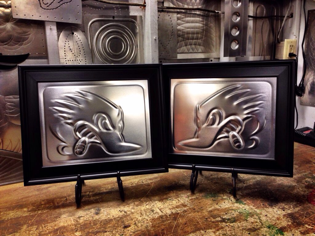

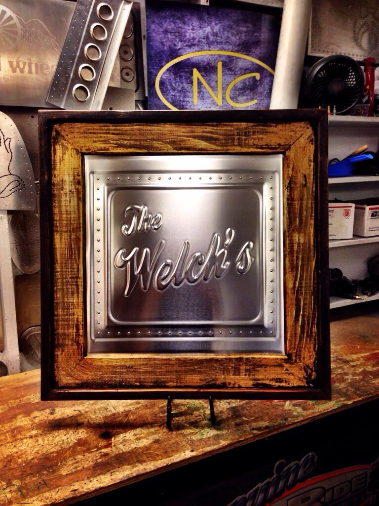

    ImageUploadedByH.A.M.B.1389833077.161131.jpg ImageUploadedByH.A.M.B.1389833099.145099.jpg
    Here is a copper Rat Fink...

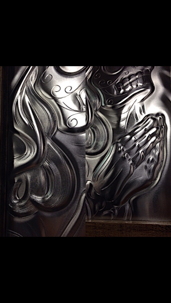

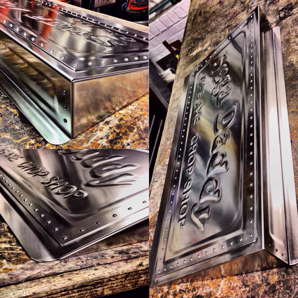

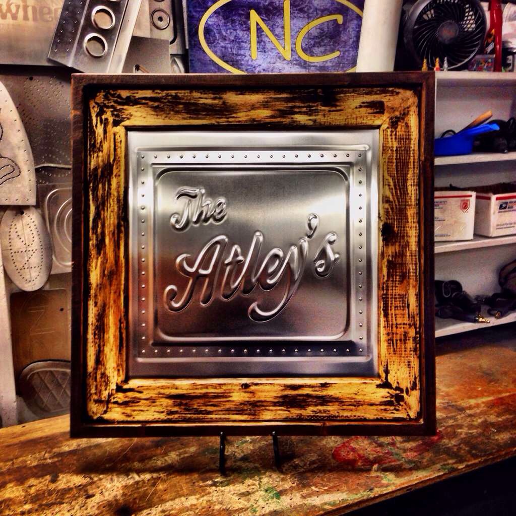

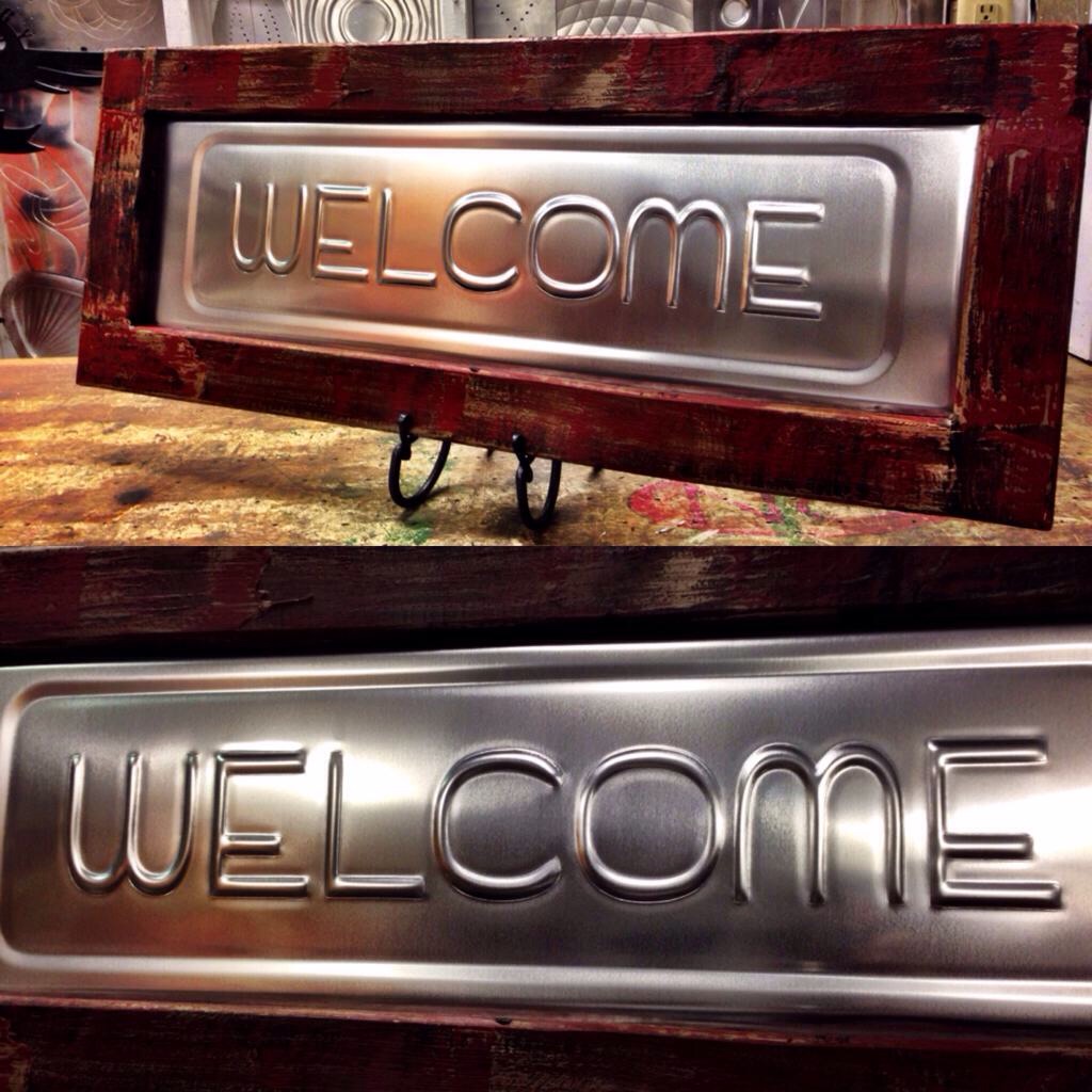

    ImageUploadedByH.A.M.B.1389833178.668489.jpg ImageUploadedByH.A.M.B.1389833202.462190.jpg ImageUploadedByH.A.M.B.1389833225.179259.jpg ImageUploadedByH.A.M.B.1389833252.162369.jpg ImageUploadedByH.A.M.B.1389833269.628327.jpg ImageUploadedByH.A.M.B.1389833296.812699.jpg ImageUploadedByH.A.M.B.1389833312.914843.jpg ImageUploadedByH.A.M.B.1389833340.931519.jpg ImageUploadedByH.A.M.B.1389833391.579350.jpg
    Few things I have done.

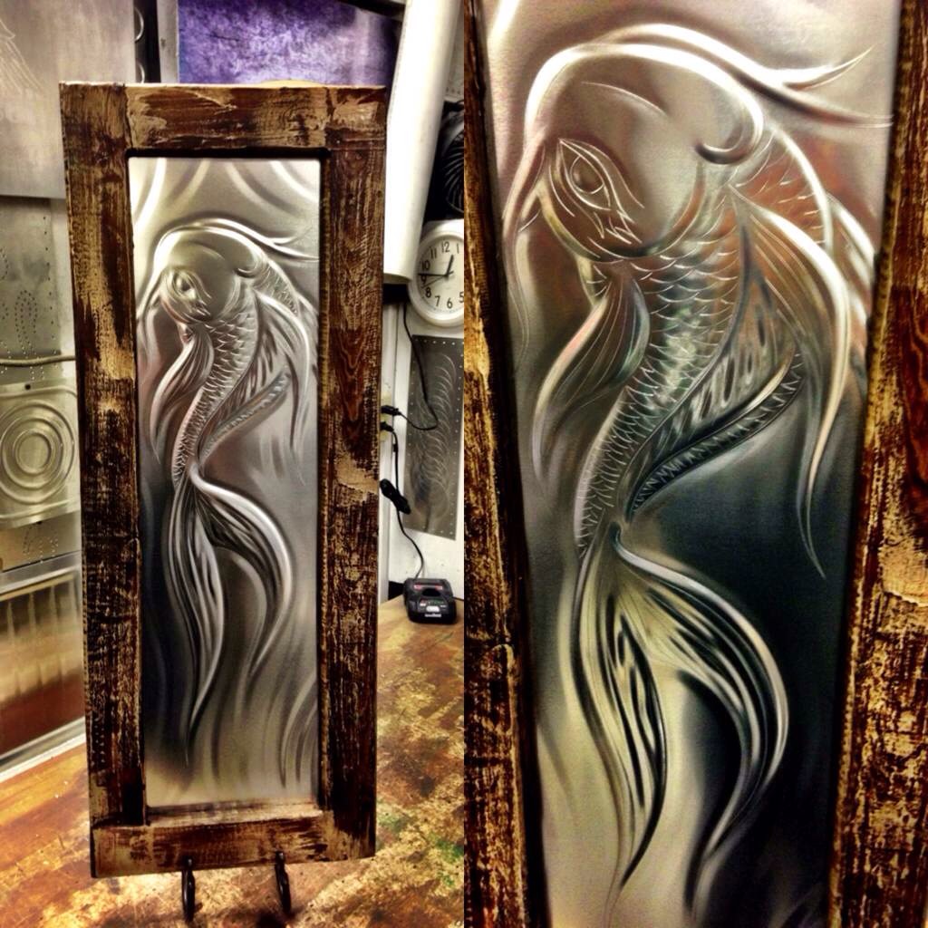

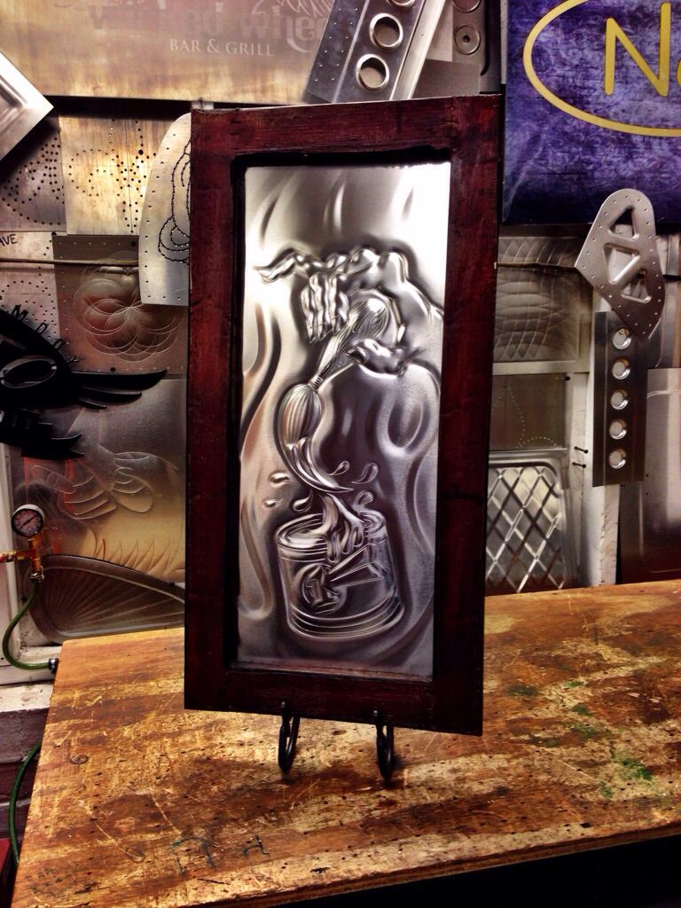

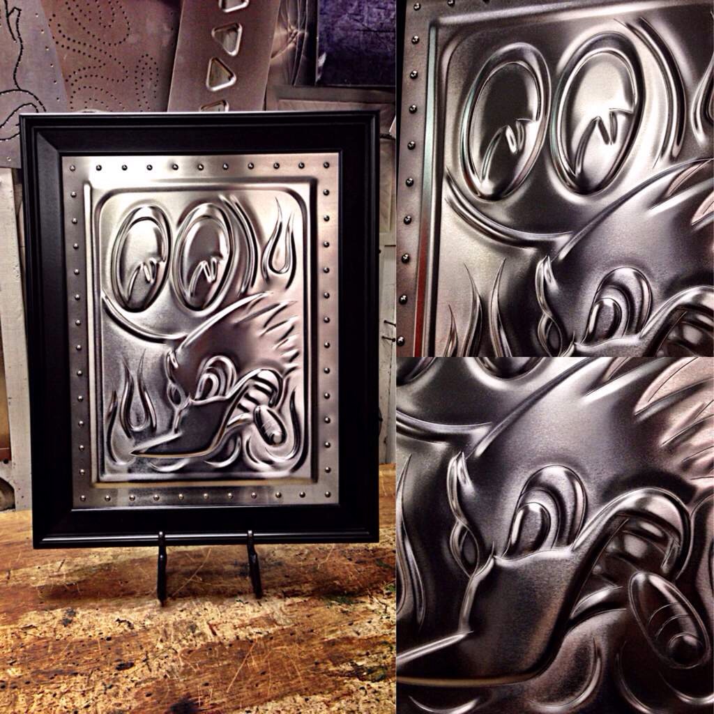

    ImageUploadedByH.A.M.B.1389957435.508861.jpg ImageUploadedByH.A.M.B.1389957465.677645.jpg ImageUploadedByH.A.M.B.1389957492.710800.jpg ImageUploadedByH.A.M.B.1389957534.728318.jpg ImageUploadedByH.A.M.B.1389957565.494809.jpg ImageUploadedByH.A.M.B.1389957597.245437.jpg ImageUploadedByH.A.M.B.1389957622.611155.jpg ImageUploadedByH.A.M.B.1389957693.180518.jpg ImageUploadedByH.A.M.B.1389957721.061570.jpg

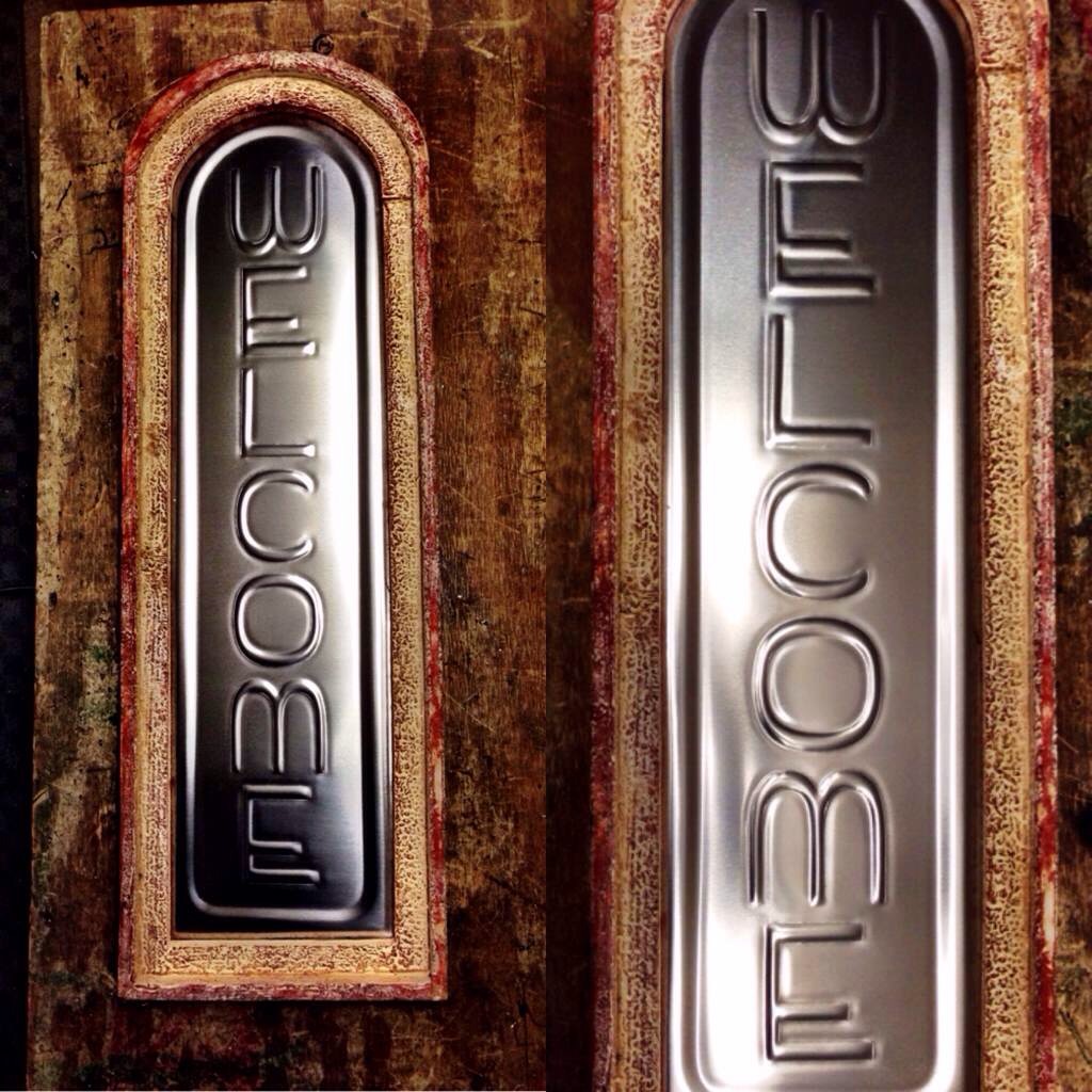

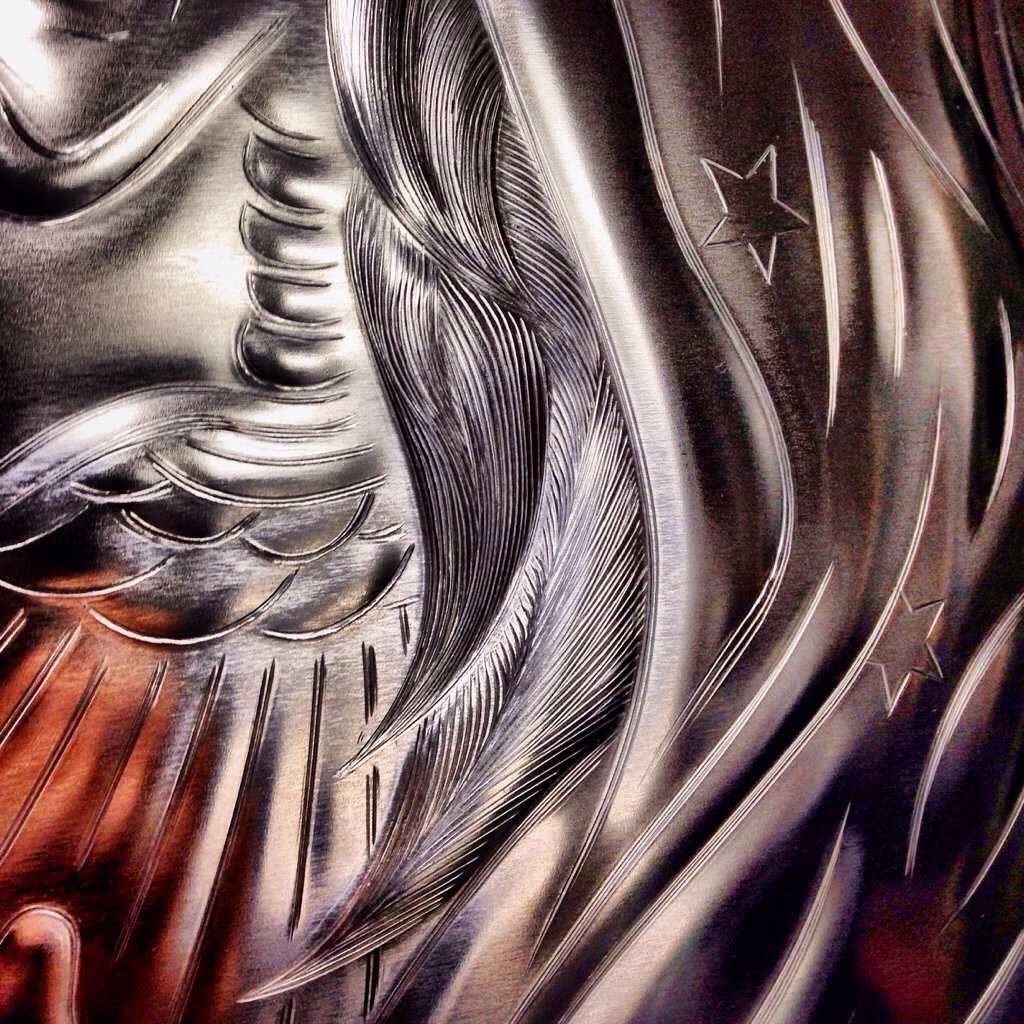

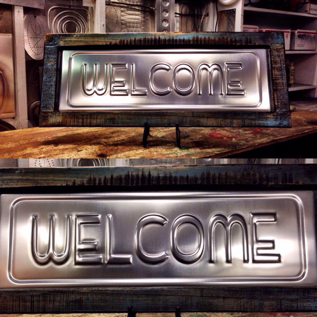

    ImageUploadedByH.A.M.B.1389957777.108885.jpg ImageUploadedByH.A.M.B.1389957820.496624.jpg ImageUploadedByH.A.M.B.1389957852.846567.jpg ImageUploadedByH.A.M.B.1389957883.845067.jpg ImageUploadedByH.A.M.B.1389957916.944459.jpg ImageUploadedByH.A.M.B.1389957940.264363.jpg ImageUploadedByH.A.M.B.1389958002.012922.jpg ImageUploadedByH.A.M.B.1389958026.146460.jpg ImageUploadedByH.A.M.B.1389958049.312239.jpg ImageUploadedByH.A.M.B.1389958077.895420.jpg ImageUploadedByH.A.M.B.1389958110.229076.jpg ImageUploadedByH.A.M.B.1389958147.048876.jpg

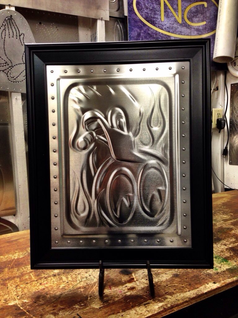

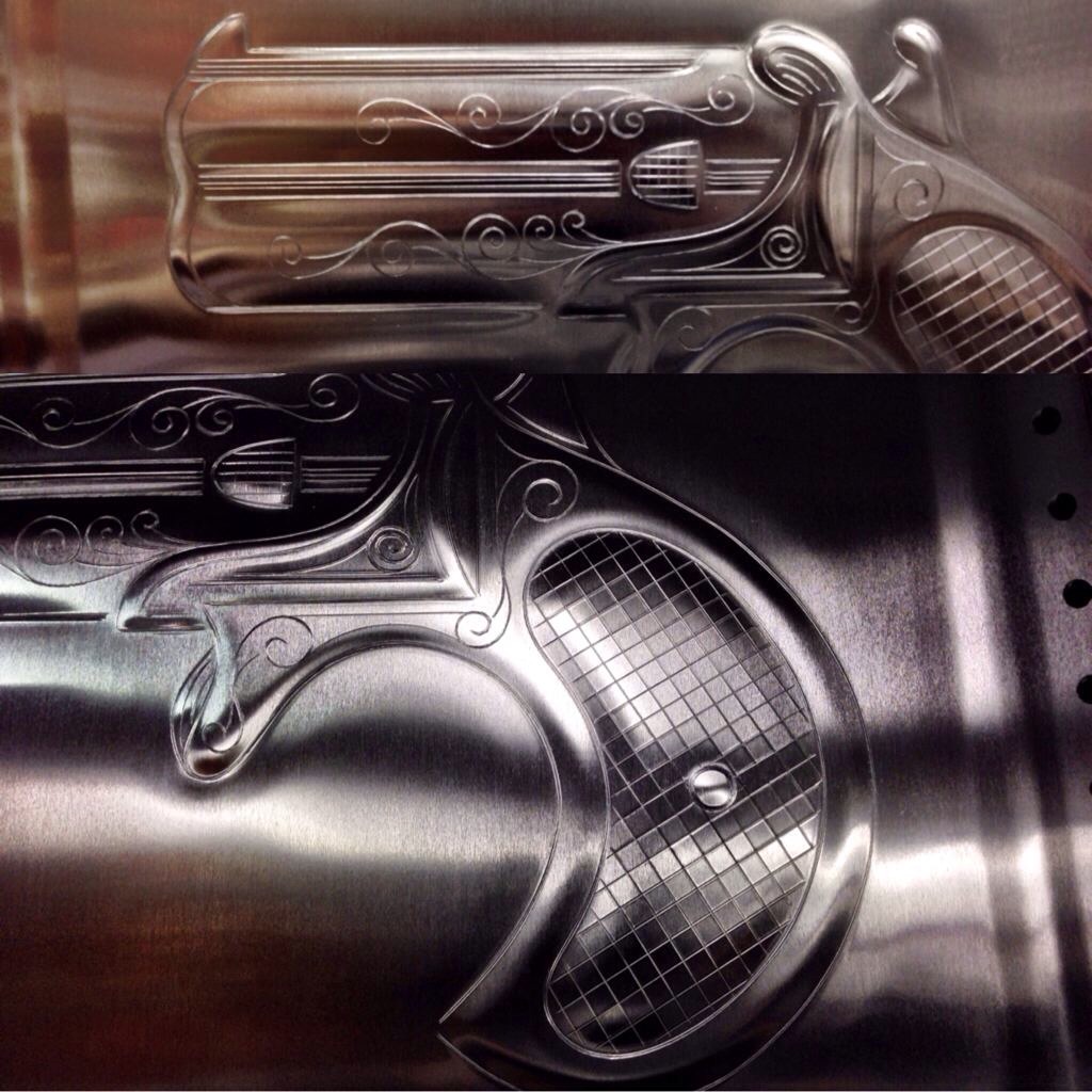

    ImageUploadedByH.A.M.B.1389958191.909906.jpg ImageUploadedByH.A.M.B.1389958220.793709.jpg ImageUploadedByH.A.M.B.1389958259.812861.jpg ImageUploadedByH.A.M.B.1389958304.296883.jpg ImageUploadedByH.A.M.B.1389958325.963641.jpg ImageUploadedByH.A.M.B.1389958340.163211.jpg ImageUploadedByH.A.M.B.1389958365.861816.jpg ImageUploadedByH.A.M.B.1389958379.995423.jpg ImageUploadedByH.A.M.B.1389958400.430656.jpg ImageUploadedByH.A.M.B.1389958414.845157.jpg

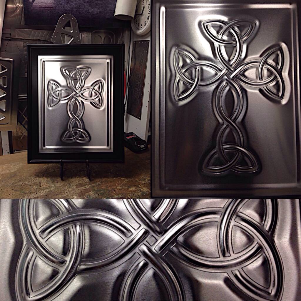

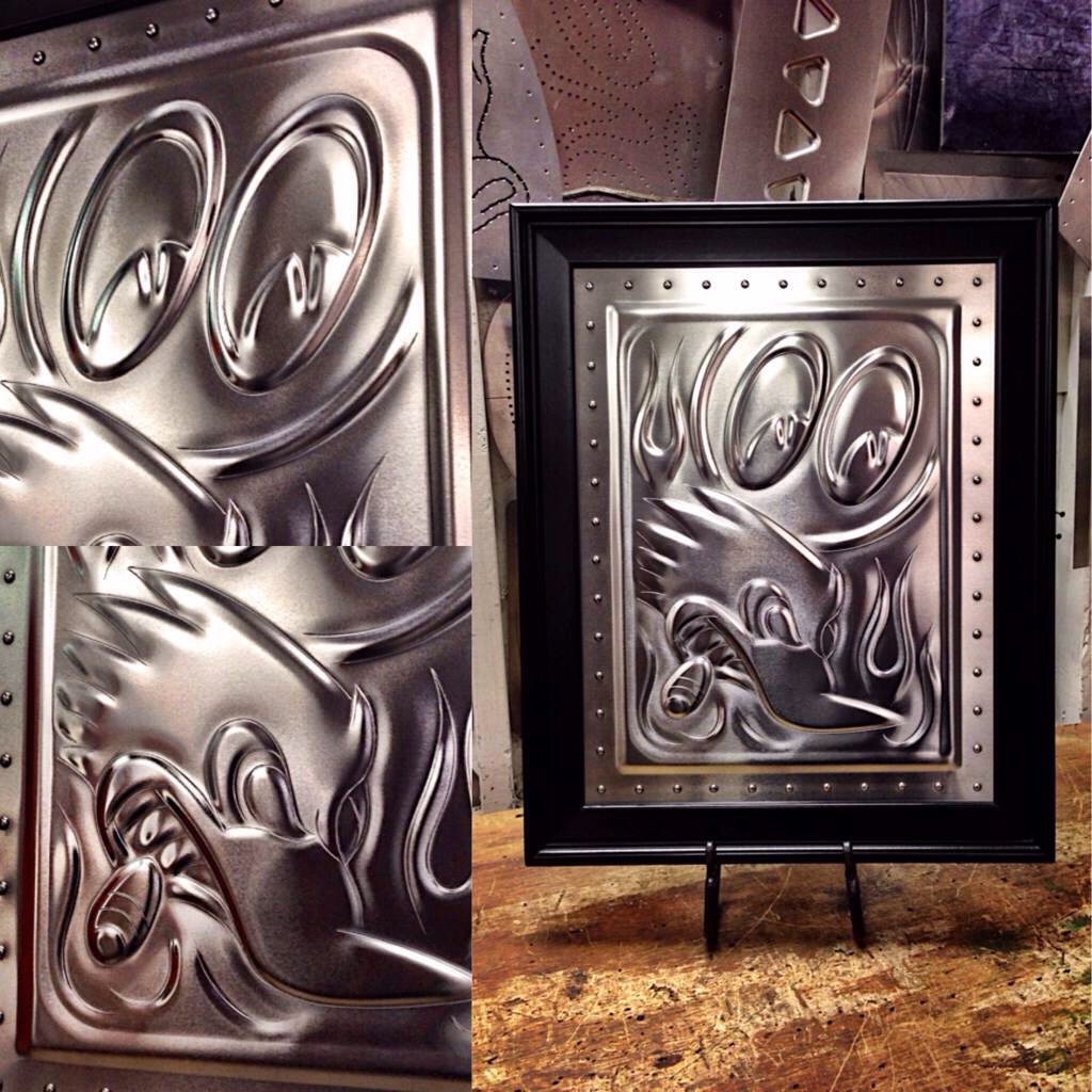

    ImageUploadedByH.A.M.B.1389958462.209566.jpg ImageUploadedByH.A.M.B.1389958477.327691.jpg ImageUploadedByH.A.M.B.1389958493.411566.jpg ImageUploadedByH.A.M.B.1389958509.012173.jpg ImageUploadedByH.A.M.B.1389958520.412386.jpg ImageUploadedByH.A.M.B.1389958531.745562.jpg ImageUploadedByH.A.M.B.1389958543.311592.jpg ImageUploadedByH.A.M.B.1389958553.211069.jpg ImageUploadedByH.A.M.B.1389958562.179418.jpg ImageUploadedByH.A.M.B.1389958575.463237.jpg ImageUploadedByH.A.M.B.1389958588.195850.jpg ImageUploadedByH.A.M.B.1389958598.195838.jpg
