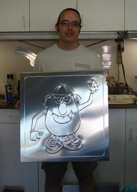

    Damn Kev, thats some nice work
  24. Nick Flores
    Joined: Aug 13, 2009
    Posts: 1,358
    Nick Flores
    Mr. Potato Head. Awesome. All of the panels on here look GREAT!
