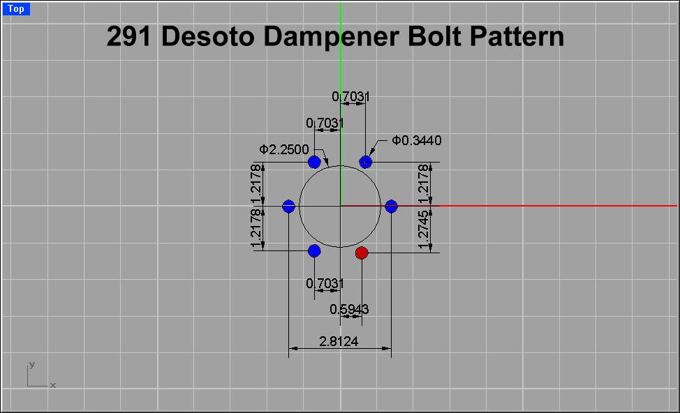

    I was going to wait to post when I had the more pictures, but I had some information about the crank dampener that may prove useful to some.
    The bolt holes used for the pulley on the dampener is 6 holes on a 2.812 BHC. The interesting thing is that one of the holes is rotated 5 degrees from the rest of the holes. It's still for a 2.812 BHC, but just rotated. I believe this is so you couldn't mount the pulley on the dampener backwards. So it's 0, 60, 120, 180, 240, 295 degrees...
    Here is a photo of my handy work converting a 3 groove SBC crank pulley to a Desoto. The other photo is actually a drawing for people who need help with the dimensions of the holes.

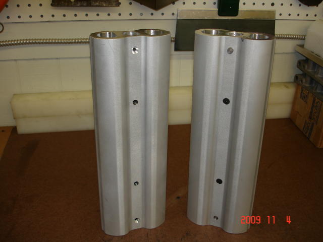

    All the machine work for the new billet rotors have been completed. Yes, each set of rotors and shafts are lighter than the stock pieces. They are 2.25 lbs lighter per set for a total of 4.5 lbs total.
    However, the shafts still need to be ground, splined, and pin hole drilled and reamed. That will be taken care of after anodizing due to the small amount of surface building that takes place. This is usually .0002 to .0008 during the normal anodizing process. We desire a metal to metal press fit to no more than .0002 press.
    Each rotor has four 5/16 lock pins which are pressed thru the rotors and shafts. There will be two pins drove from one side and two pins drove in from the opposite side in a blind flat bottom hole, which is fully reamed to press diameter. This should help keep things really secure and minimize unbalanced weight. This means that each pin will be driven into the holes down to a 1.300 inch depth and not all the way thru the rotor. The pins will fully engage the rotor pin hole to depth on the other side of the rotor shaft more than .125 inch. Then the pin will be locked in with a flat head screw with a little bit of thread locking compound. The rest of the balancing issues will be addressed later during the dynamic balancing of the ***embled parts.
    Hopefully you can understand what I've just said.
    The pins haven't been taken to length yet. Just in case your wondering...
    Here's some photos of the work:

    Why not drill and ream the pin holes thru, then countersink both sides, and use two keeper screws.
    That would not only positively retain the pins, but solve your balance issues (or very nearly so).
    Any particular reason why you're wanting to go with a single keeper? Is it just to keep the weight down?
    EDIT: I may have asked this before, but how were those rotors made? Extrusion? Cut from bar stock? Something else?
    If you machined them from bar stock, how did you cut the hollows in the ends of the lobes? Or for that matter, the center shaft hole? Long bores like that are always a ***** to bore accurately, so I'm always interested in seeing how different guys go about doing it.

    The rotor shafts will be indexed and splined to match the drive gears. On The driven side (left facing front), there will be a .25 thick ground steel washer that seats down inside the gear that has a thru hole for a 3/8-24 bolt for the end of the shaft, which holds the gear in place (near stock configuration). On the drive side, the coupler bolts to the front of the drive gear with four 1/4-28 bolts and one 3/8-24 center bolt which is also piloted. So, to answer your question... The gears are indexed, splined, and bolted into place on the shafts.
    Although the coupler is not complete, here's a pic. I hope it helps.

    @ Coolhand:
    We played around with the idea of using double screws. There are several reasons why we chose this single screw design.
    We wanted to be able to use "off-t******lf" parts as much as possible especially when it comes to fasteners in this build. We are using 5/16 X 1.5 case hardened pull dowels cut to 1.300 length with 10-32 flat head alloy screws. If we used two screws, we would have to make custom pins with threaded holes on each end, which would also require grinding the diameters. Would that out of the realm of possiblilties? Absolutely not.
    However, the head size of the screw is about .377 diameter X .130 long at 82 degrees included angle. The dowel is .313 diameter. The wall thickness between the shaft bore and the valley of the rotor is 1/4 inch. If we reamed the hole all the way thru, that would only provide about .120 inch on each side for the pin to engage the hole in the rotor. This is not to mention that you would lose at least 2/3rds of the chamfer for the flat head screw.
    Are method allows for full pin to bore engagement at least on one side in the rotor and .125 seated on the other side, while still giving us the full chamfer for the screw head. The chamfers double as a locator and as a strong clamping point due to more surface area.
    We also did the opposited pinning for two reasons. First, to minimize stress in the design. Two, to equalize weight distribution.
    Yeah, we could have just reamed the holes thru and just pressed the pins in, but I wanted a bit of insurance that they were not going anywhere...
    As for the rotors, they are CNC machined from billet solids using the original rotors for measurements. Measurements were taken on a CMM.
    The bores were indicated centerline. Center drilled, drilled, bored (Criterion head and 5 inch long boring bar) leaving only about .005 in hole, and Wickmen Reamed to size. Wickmen reamers are nice because they cut really straight and leave an excellent surface finish especially in aluminum.
    The bore is only held to about 5 inches in depth of the material. The remaining 3 inches or so is actually clearanced to about .010 over the bore size in order for the shaft to slip all the way thru. Bores are inline within .001 concentricity.
    Does this answer your questions?

    We've been watching and following what 345 Desoto has done with his 291 Desoto blower motor. I must say it's has been very informative for us as far as what choices there are for motor internals. Well, at least the cam and lifter options we could go with.
    Falcon Bob has been in contact with Donny Johansen for the last couple of weeks. It looks as though Donny will be grinding a hydrualic roller cam for our motor.
    I don't know all the details as of yet, but it looks like we will be running the cam along with the same LA style lifters 345 Desoto used, and a set of custom length hardened push rods. Of course, this means doing the same clearance grinding to the lifter access holes that 345 did on his 291 motor. Well, unless someone tells us differently.
    I guess from talking with Falcon Bob, the cam specs are pretty fat. Donney will be grinding us something that's really crazy. Bob seems to think we need to go with a set of custom Ross forged slugs fitted to the new cam specs. I guess there may be a valve clearance issue he's worrying about. :eek:
    We also decided to upgrade the old stock crank hub to a fluid dampener setup. Might as well after doing all of this work so far... I also suggested going with a different crank pulley. I think the one we are using may be too big for our purposes. I only plan to overdrive this blower to only about 10% anyways.
    Once we get all the cam and valvetrain issues worked out, I will be posting a complete detailed list of components and proceedures.
