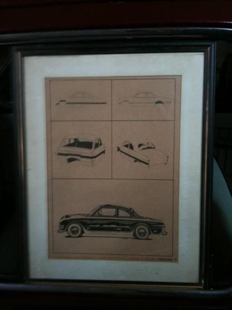

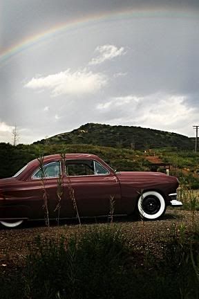

    Had to Chime in with some Things I got from the Weesner Sale recently, Me having a shoebox I ******ed these up quick. I would have to believe this drawing and mag article were based on the Bragg Shoebox... Not sure the dates that Bragg Finished the Shoebox.... Also here is a pic of my shoebox just because!!! That is Junior Conway & Myself!
    This was No Photo Shop Either.... Right place Right time!!

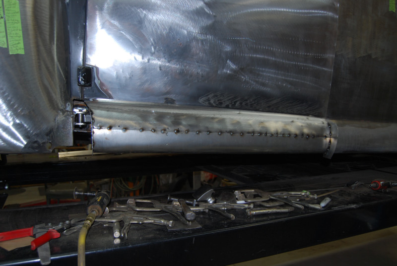

    Paul realized the photos he send before where nice, but did not really show the new hidden hinges to well. So here are 5 more to show them...
    Pauls words to go with them...
    "The photos I sent were not too clear. These may clarify.
    It is essential that replacement hinge bore exactly match bore line of and level and square with old hinge bore. If not hinge will bind and eventually break. That is the reason for the alignment rod shown."
