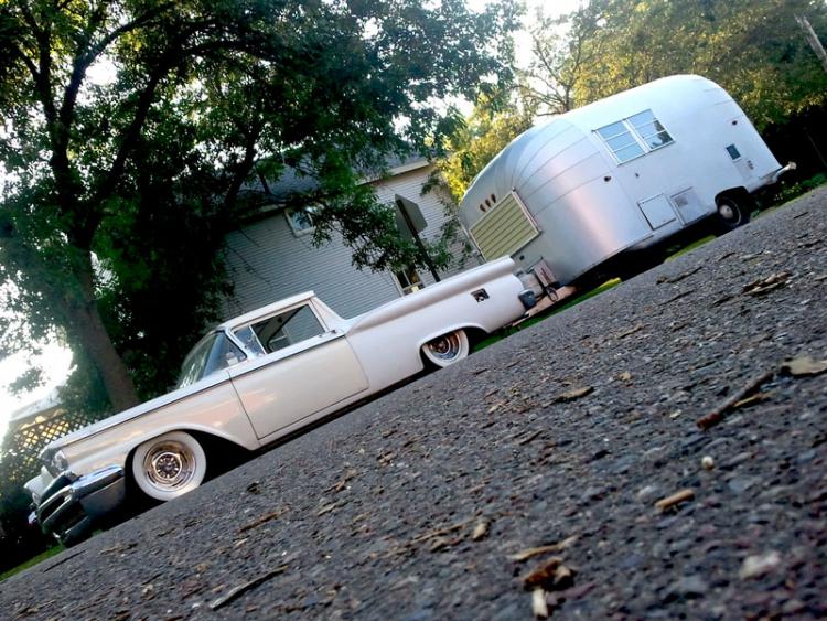

    SO... this is a pic of it with weight on the rear axle... but it had a torsion bar hitch that would level it out and the damn thing road better down the road hitched to this with that hitch than without. It splits the weight between the two axles bridging them- for those that havent used them...
    since then I've used a torsion bar hitch on my single axle too- its awesome. I've even blown a tire and just pulled over no handling crisis... :) I haul everything with my Kustom
