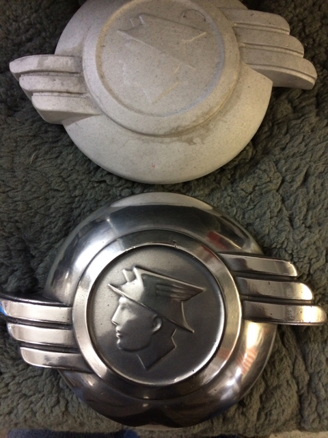

    That's what I'm talking about! Olskool how did you go about that? I have a buffer for polishing, but what wheel and grit of rouge did you use?

    I used a palm sander with various grit paper, 400, 600, 800, 1000,1500,2000. being careful not to press to hard around the face. Now in all honestly, I did use a flat file in some areas to knock down some high spots before sanding. Once I finished sanding I used White Diamond alum polish and rubbed it on the cap and then began working it, in about a 2" area at a time with a table top mounted grinder with a buffing wheel on it. It went very fast. No rouge used, only aluminum polish.

    I started on mine, using a buffing wheel and fine sand paper. Still aways to go, but much better looking. [​IMG]
