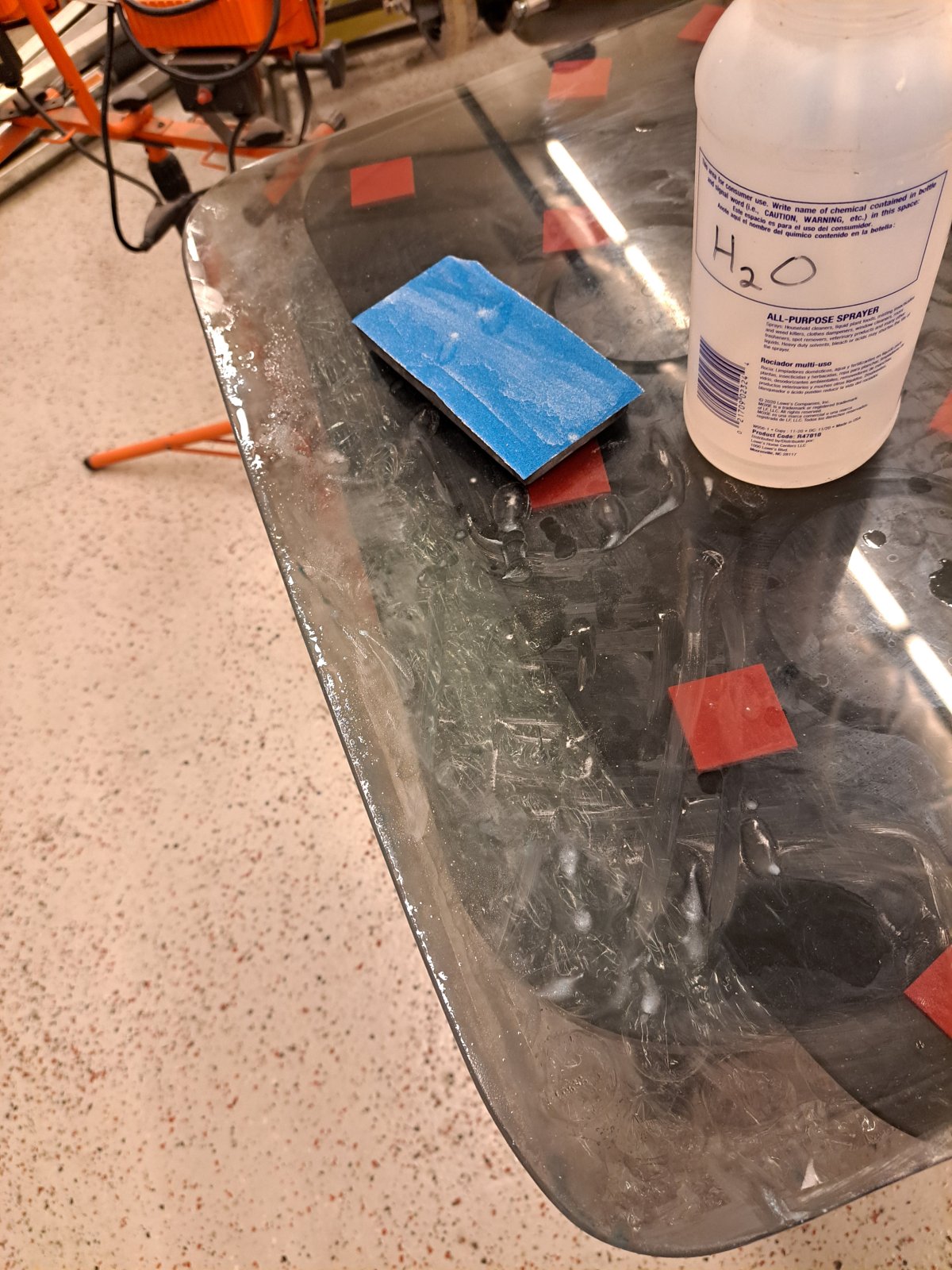

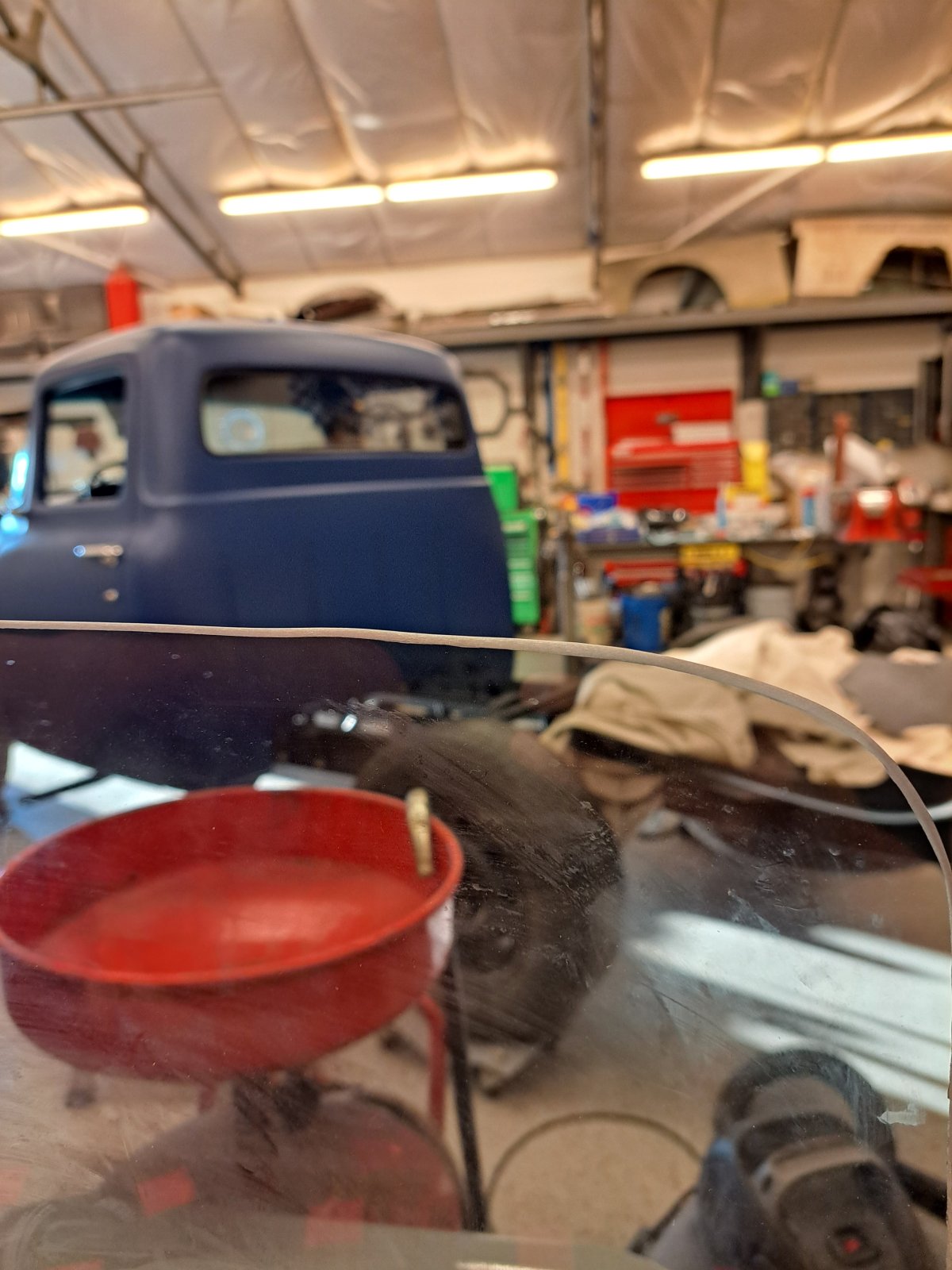

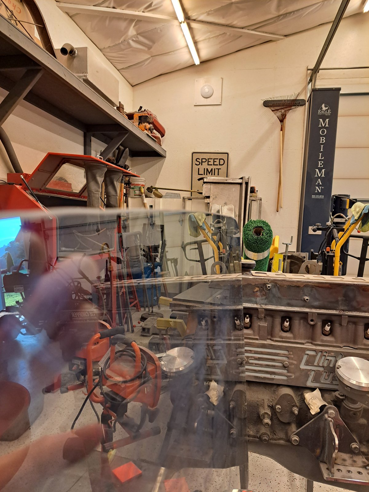

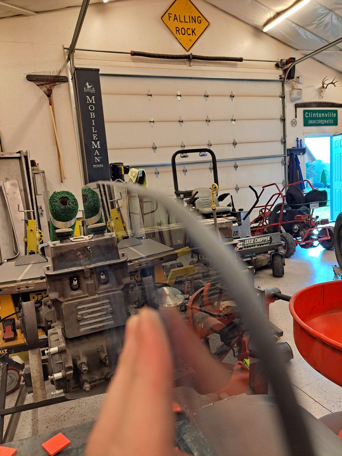

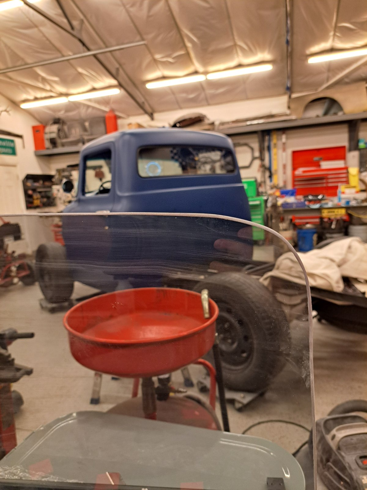

    20240821_192702.jpg Well guys they offered to refund it. But, I stood there looking at it and decided to give it a go.
    Spray bottle, durablock and 80 grit...
    Ill be danged...no issues, only had about 10 minutes in it.

    Make sure to send the pics of your work to the company to show them how it should look....;)
    Only thing that worries me is how quick and easy it was to sand the edges. Makes me wonder if it is actually tempered gl***. Are there any "standards" marks etched into it?

    Vehicle side window gl*** typically has a ground "pencil edge", and @tlmartin84 has done a good job of it.

    really hard to believe you sanded with 80 grit if that gl*** was tempered, if it is tempered it will have a logo on bottom not just a sticker

    10 minutes sanding on one or two spots with 80 grit...not exactly what I would I cl***ify as easy...ha
    And no, there are no markings, but if this was cut from a large sheet, would there even be markings? Supposedly these are cut and then tempered at their business.
